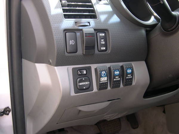

    Here are some of the smallr mods I did.

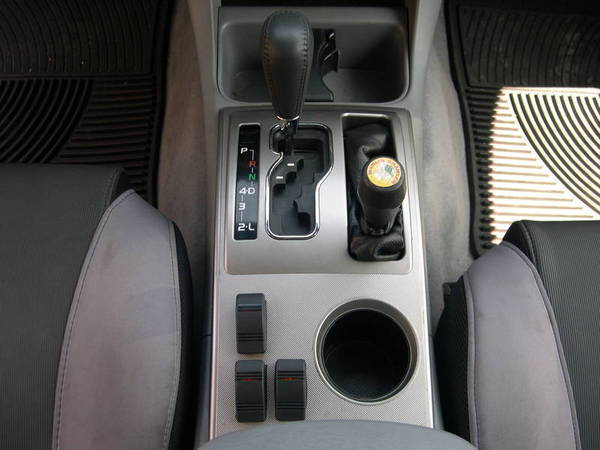

    These are te switches for the ARB lockers and ther compressor.

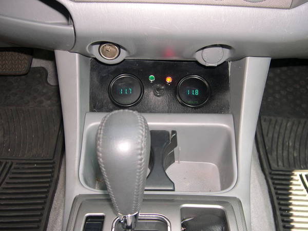

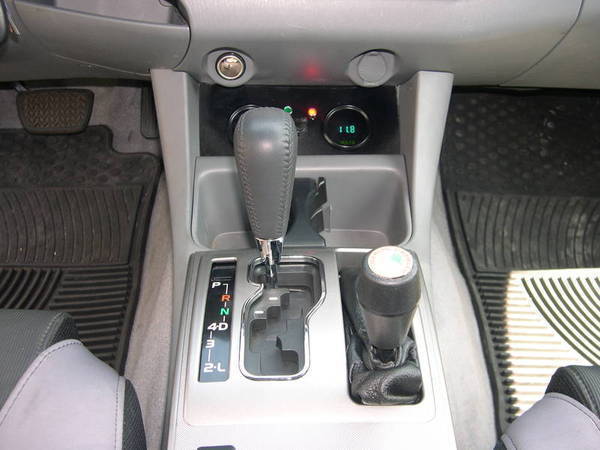

    These are the volt meters that moniter my dual optima batteries. the switch in the middle is a battery isolater. It lets me choose between the two batteries, or allows me to use both at the same time.
    These three switches are for the rock lights and the rear amber lights.

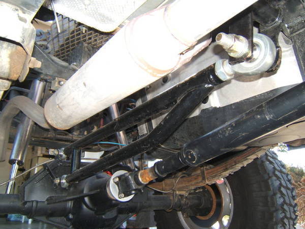

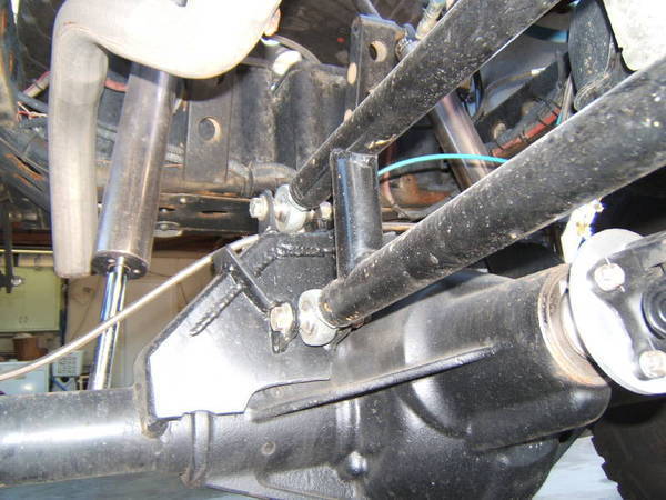

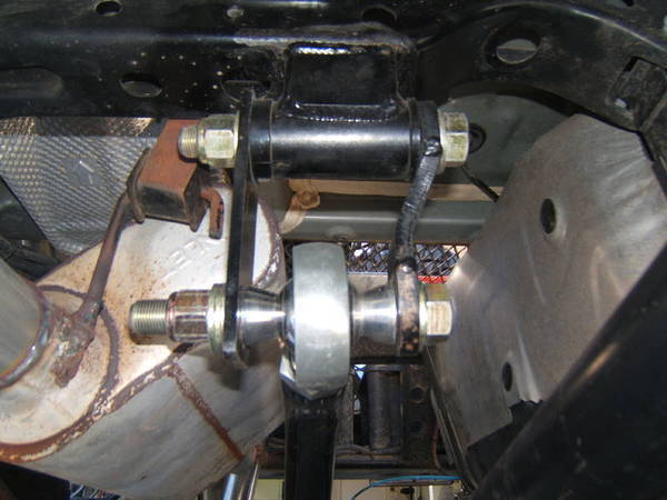

    With all the torque this truck has I had to add a track bar to stop the rear axle from wrapping.

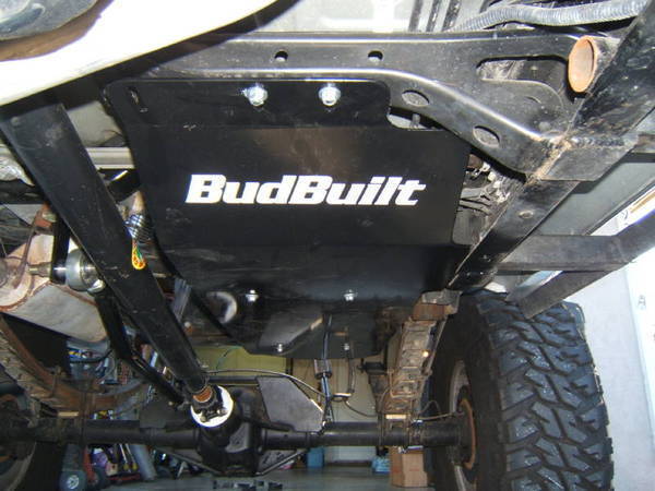

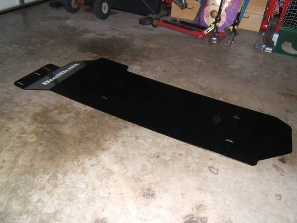

    Since I have he sport model, it didn't come with a skid plate and I needed something super strong. I called up Bud at Budbuilt and he fixed me right up.
    I first had to go to Toyota and order these straps that have the studs and nuts so I had something to bolt the plate too.
