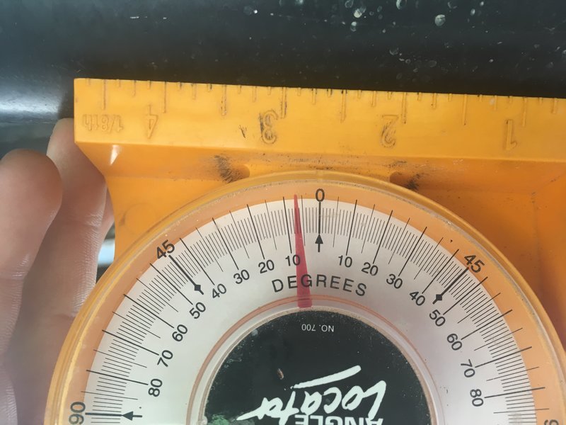

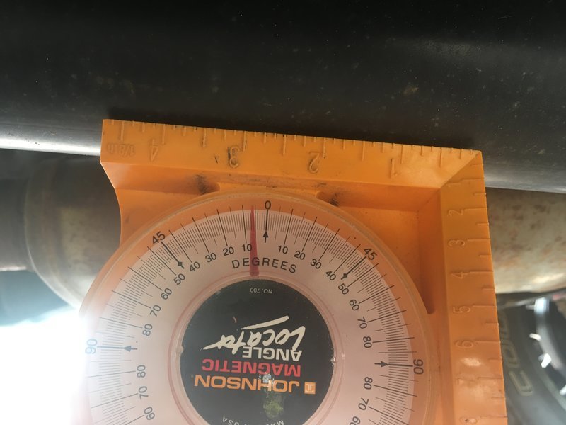

  15. Apr 16, 2017 at 8:22 AM
    #2035
    AR15xAR10
    AR15xAR10 [OP] AR10 is 5 ARs better
    Apr 13, 2013
    #102024
    56,572
    08 SR5 4x4 V6 IndigoInkPearl ACLBFTMFW
    Rear shaft angle:
    Front shaft angle:
