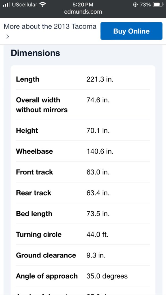

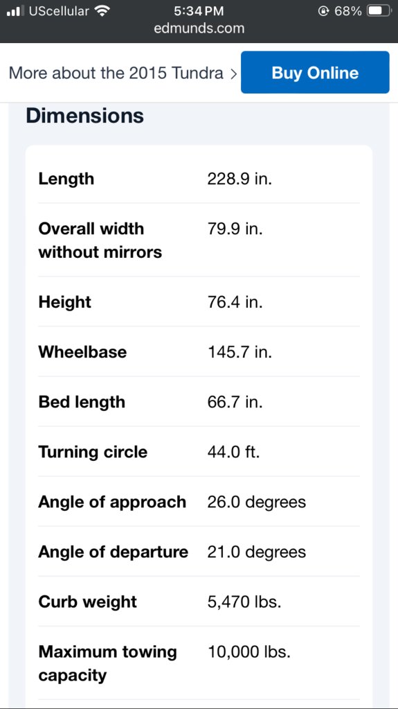

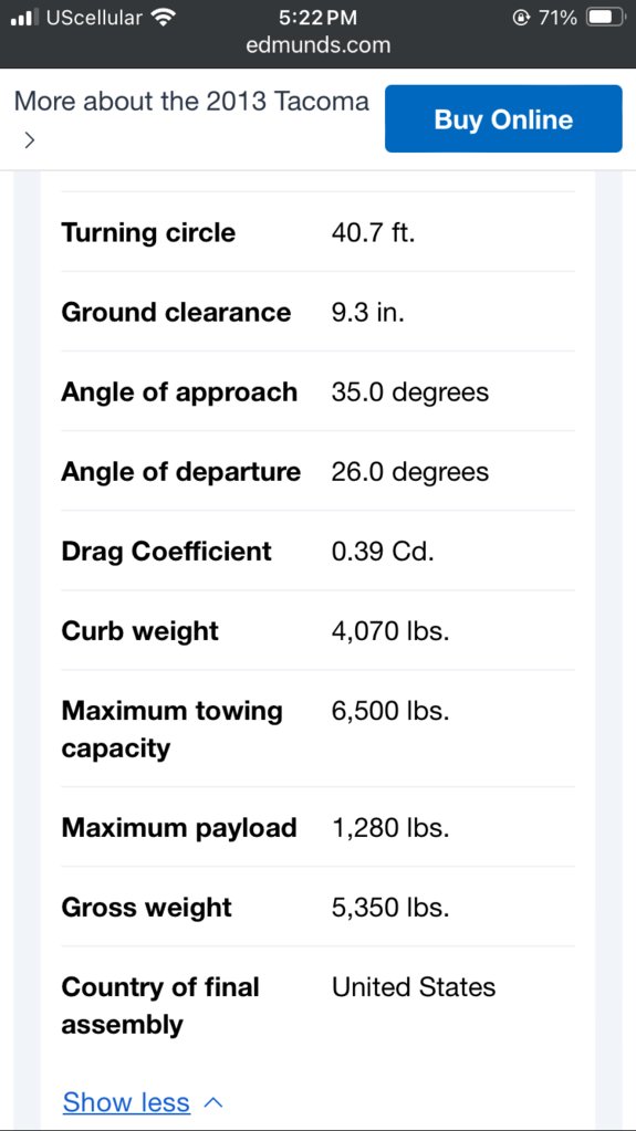

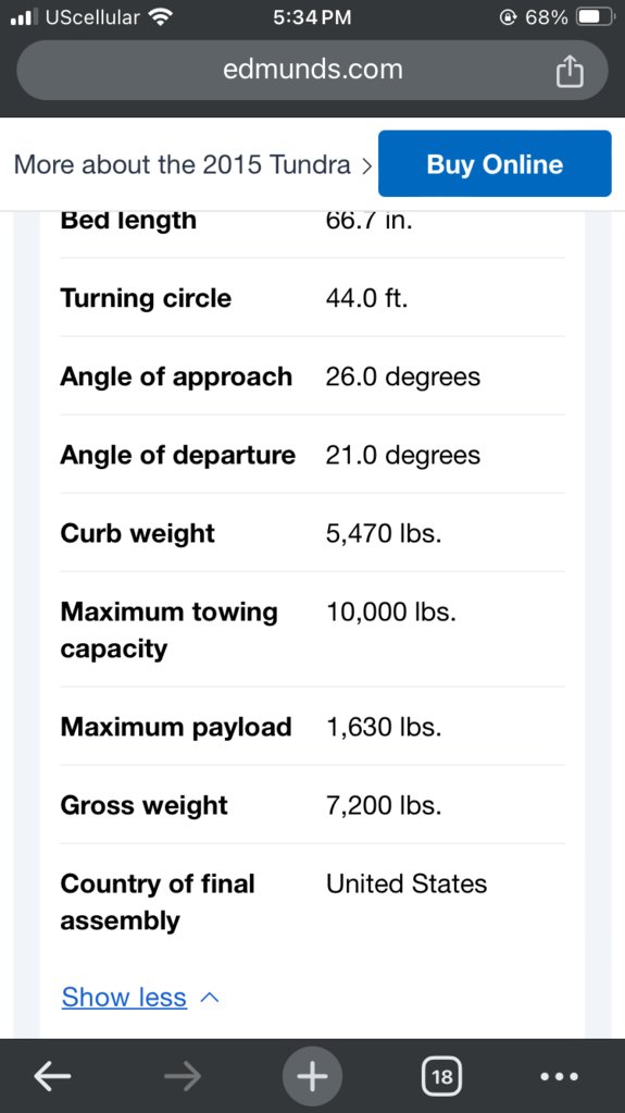

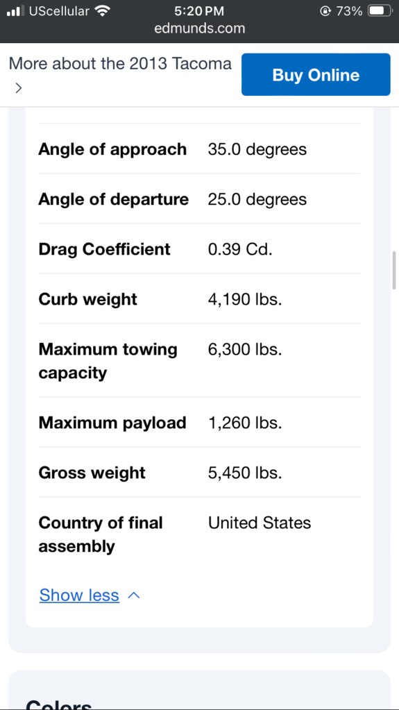

    Specs for a 2013-15 ACLB:
    Specs for a DCLB 2013-15 tacoma:
    ACLB 2015 Toyota Tundra:

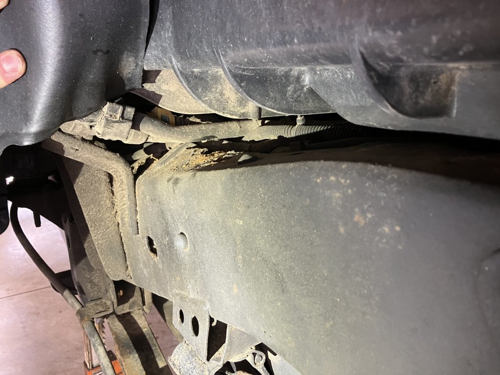

    Found more frame damage to document. Looking more like i’m going to have to go the FULL part out route.
    Frame is severely buckled and delaminated on the Driver’s side right next to the fuel tank:

    Coastal HC Front, 6112s+650lb King Coils, JD 62 Swap + 14" Fox 2.0s
    food for thought, since you were thinking about rebuilding it and keeping it. The part at the rear can be hammered out and rewelded solid. The cab mounts can be replaced with a mount replace kit, pick your brand on that one. The front end, just do a front end chop of the lower bar, then straighten the horns out and weld in a solid piece between the horns, higher up. I believe Warfab has a kit for that, or maybe Coastal?
    The inner fenders and front subframe can be replaced with a trip to the JD Fabrication website and some fun coupons.
    As far as long term rigidity of the rear, if the above wasn't enough to put your mind at peace, JD also has their SUA kit that is also a frame brace/shock relocate all in one.
    Yeah, it'll be some money, but it'll live another day and be way better than OEM.

    I spent a lot of time thinking about it and to me its not worth all the cost to save it. Everything I priced out put me just north of $15k to still have a totaled truck but on the road with a rebuilt title.
    At one point in time I had all the links saved and deleted it all to not tempt myself further.
