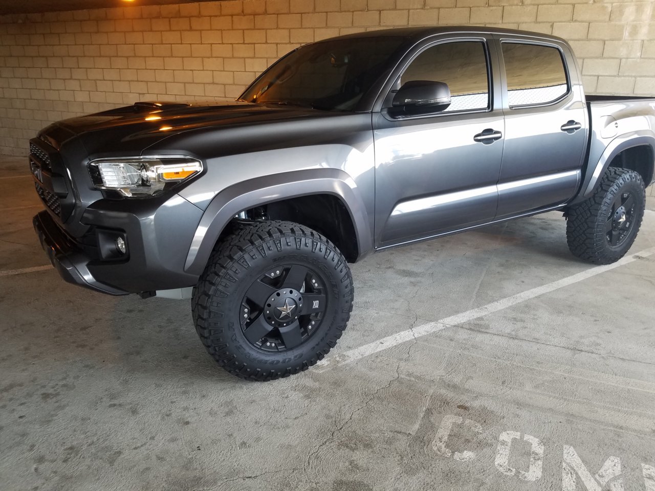

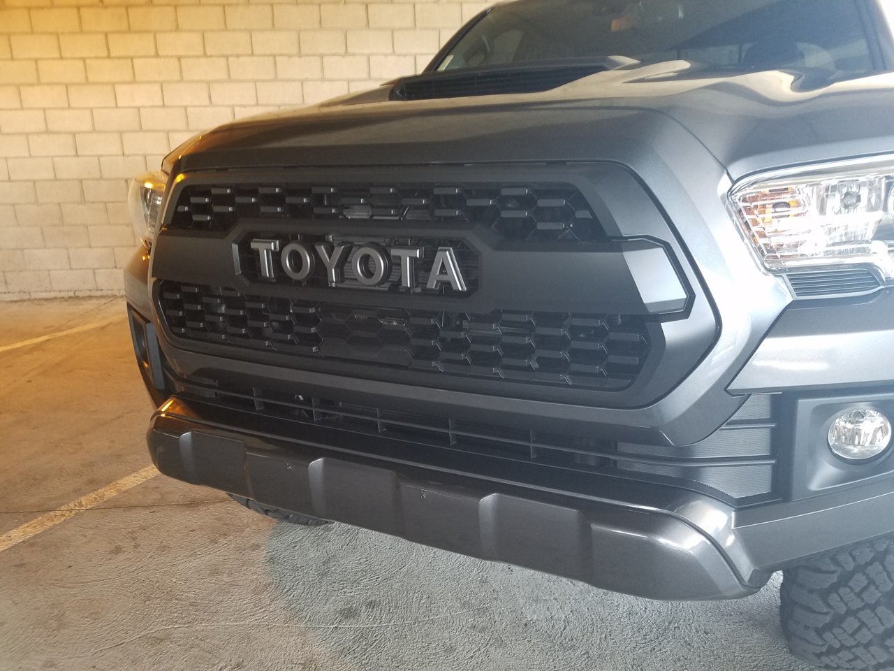

    I have a 2018 TRD Sport with Fox 2.5 coilovers(front set to almost 3 inches up) and a 2 inch block with Fox 2.0 shocks in the rear(all work done by 88 Rotors in California). Drives perfectly and no sensors or dash lights. I did the TRD Pro Grill swap($300 installed through 88 Rotors in California) as well with no issues whatsoever. Cruise control works perfectly with no re-calibration. My goal was not to have warning lights going off on my dash but as far as having a functioning radar while using cruise control, I still rely on common sense and not a computer when driving. Toyota's historically don't like to be level or nose up. My '14 Tacoma had endless ABS activations(I drive mountain roads with lots of curves) once you go above 30mph. I learned how to defeat the computer and never had an issue but if I applied the brakes above 30mph while in a turn the ABS computer would override and activate. I just had to learn to brake before the corner and not during the corner. My '18 has no ABS issue whatsoever due to the factory rake(front slightly lower than back) and the TSS-P is functioning perfectly. Don't over analyze all the posts on here it'll drive you nuts. Don't skimp on your lift, spend the $ to do a good system.20180712_142351.jpg 20180712_142332.jpg 20180712_142351.jpg 20180712_142332.jpg 20180712_142339.jpg

    Truck looks nice! How much did you spend total?
