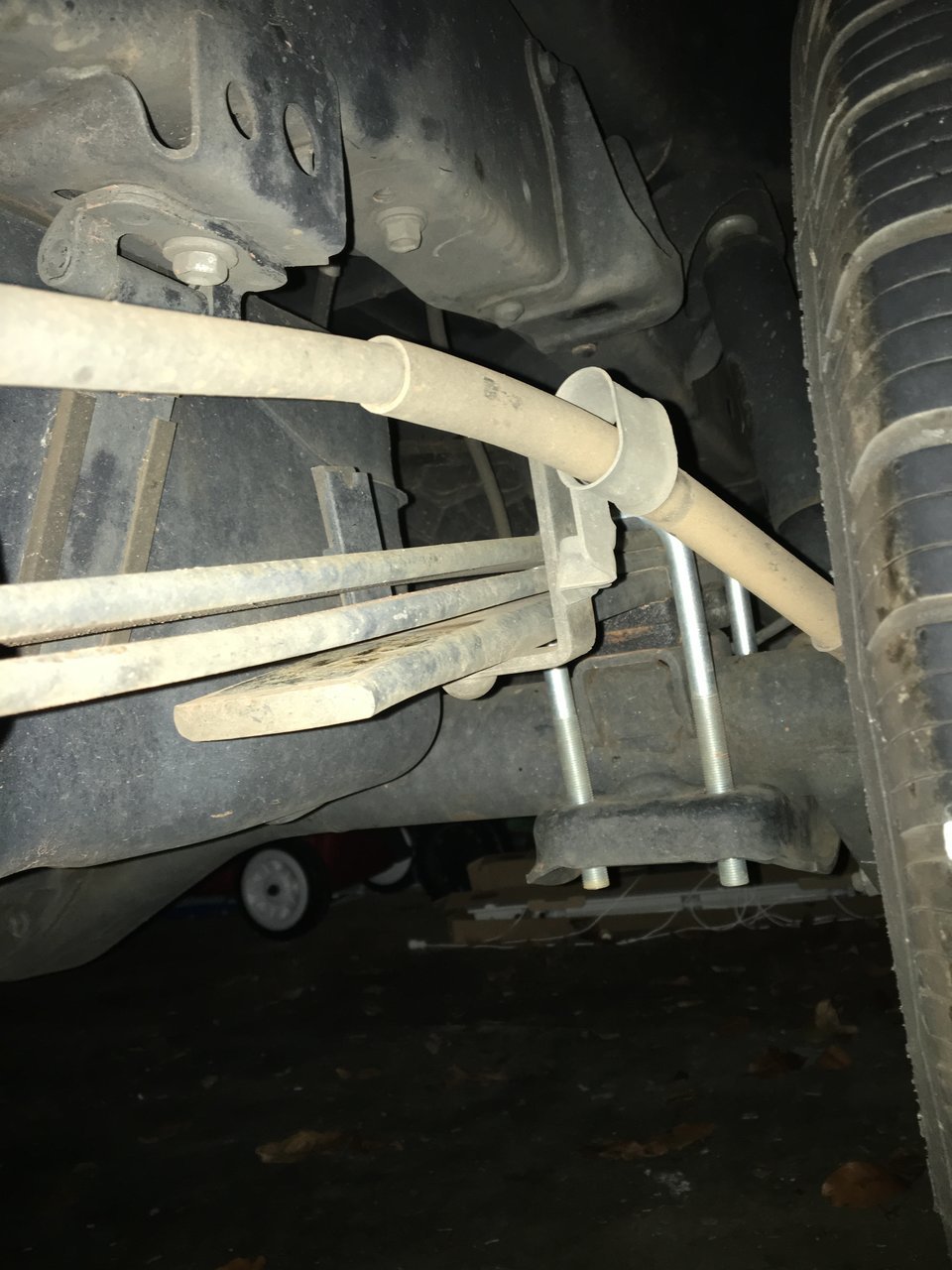

    Any recommendations on spring clamps? I’m definitely going to try that. Are you thinking that could help the vibes? This is what my springs look like right now. Is there any way that dropping carrier bearing could help the “bump after stop”? I know these are 2 different things all together but I’m certain that got worse after I put the 1” blocks in the back. It was noticeable before but much more now.

    I bought some leave Spring clamps and sinched them down tight with my impact drill. Seems to be doing the trick so far.

    I’m here to tell you inexperienced the bump. I followed what poster “splitbolt” recommendation and bought an $18 pair of leaf spring clamps. Cured my slight vibes and bump due to axle wrap. It’s due to weak springs.

    Not really.
    Under deceleration, the rear of the leafs are pushed together anyway.
    The front of the leafs want to come apart, thus the clamp placement.

    I felt very very very slight nudge after stopping yesterday. Nowhere near like I have felt in the past and this is after I put on the Spring clamps. Just a question where should the Spring clamps be installed?. Close to the end of the bottom spring towards the front or closer to the axle itself?

    Probably not. The simple answer is you would have the exact same shot as you did right now that the shaft would come perfectly balanced out of the box. My toyota driveshaft was unbalanced from the factory, but I took mine to a loal driveshaft shop and had it spun up and rebalanced on a driveshaft balancing machine and now its good to go. You MIGHT also need rear axle shims to rotate the diff snout more up towards the transmission, sometimes weird driveline angles are the source of vibrations and shudders too.
    EDIT: I forgot, at that same visit that driveshaft shop told me that another thing that sometimes causes a 'clunk' when stopping is the driveshaft returning to its resting position and having to fight against rust, dirt, and debris to get there. He said that regularly lubing up the driveshaft connections can help.

    Closer to the front...remember the front wants to seperate during decel. You're trying to reinforce the main leaf; you might need a couple to get the leaf or two below it.
