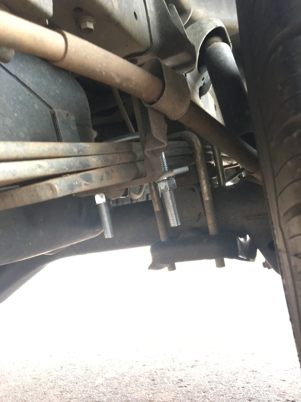

    Would you mind posting a photo of your leaf springs so I can get an idea of where on the leafs you put the clamp? Also, any recommendations of which clamps to use?

    Sorry to take so long. Didn’t see this reply. I bought my first set at advance auto. They stripped out. Then I bought this set at autozone. For whatever reason these threads are thicker and stronger. This is how i have them. I notice a very slight nudge/bump occasionally. I put them here so they’re hidden so to speak. I had the others very close to the end of the overload spring towards the front. That cured the bump 100%. I may move these back to that spot. Or I might be putting AAL then reclamping.
