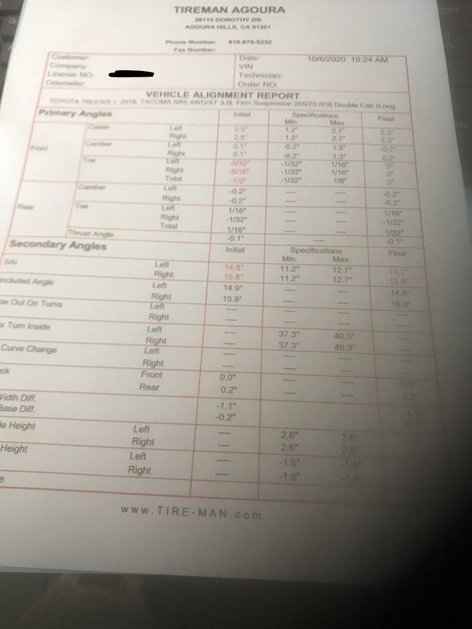

    Just got my 2020 DCLB TRD OR lifted and mounted up on new wheels and tires, and am having minor issues. Main problem is some bumpsteer/tracking issues, especially notable at lower speeds (5-20mph). Alignment numbers are below - the high caster seems to be in line with what most people on TW recommend. Any recs on getting this stamped out would be appreciated.
    Here's what I'm running:
    Toytec Aluma Boss 2.0 front Coilovers
    SPC UCA's
    Toytec Boss 2.2 rear shocks
    OME Dakar HD Leaf Pack
    Diff Drop
    Sway bar relocation kit
    NO shims, spacers, or drive/brakeline changes.
    Method 701 with Toyo Open Country AT 3 285/70/r17
    All other components stock.

    Imo. If you have after market ucas, I’d bump up caster to 3-3.5 personally.

    Have more caster added and check your tire pressure. I was getting annoying bump steer because the shop inflated my E-rated tires to 35psi, I dropped it down to just 32psi and it made a world of difference

    Appreciate the responses. Will get some more caster added! My LT rated tires are at 37 as of yesterday, so may play with that, too.
