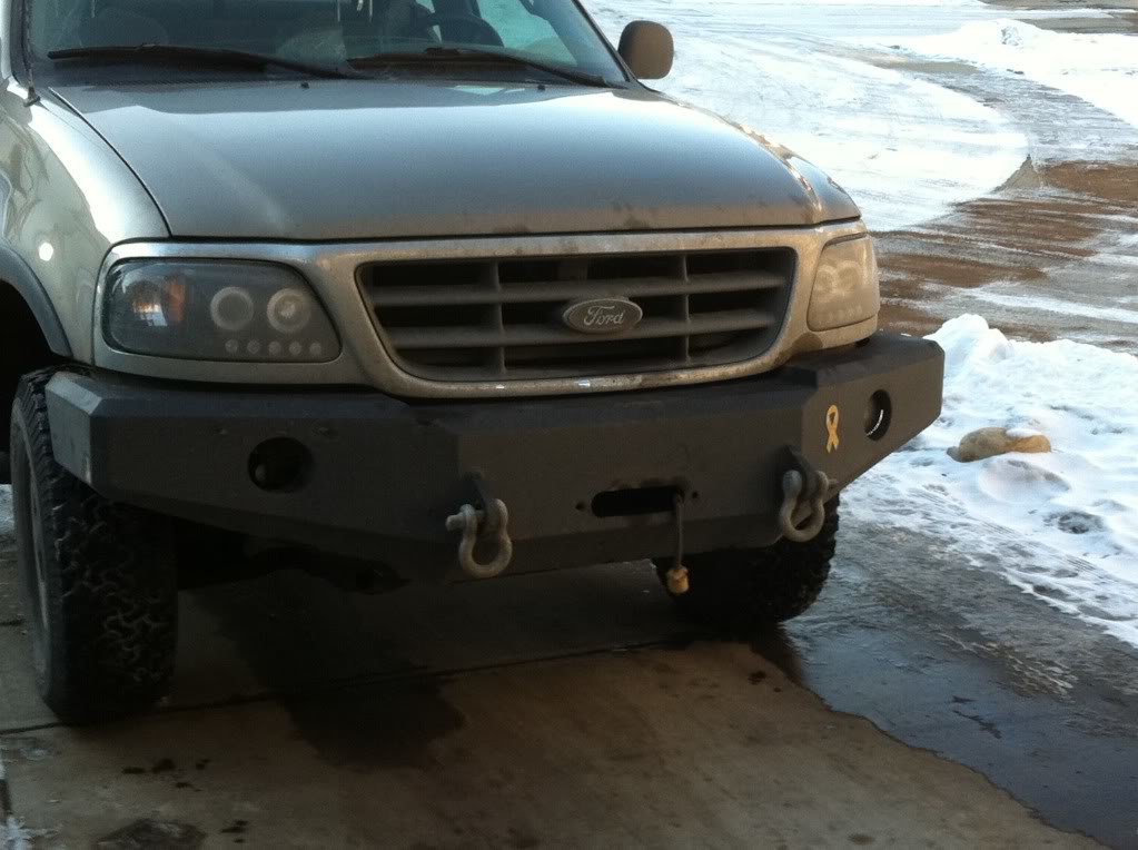

    Here is the last bumper I built
    The taco bumper will be a mix of CBI and brute force style, a little lighter than the ford bumper it will be 3/16 for the center section and 10 gauge (just over 1/8) for the sides, since I don't do any heavy offroading I don't need it to be extremely heavy duty, ill be buying material on Saturday and starting Sunday afternoon, lots of pics and details to come

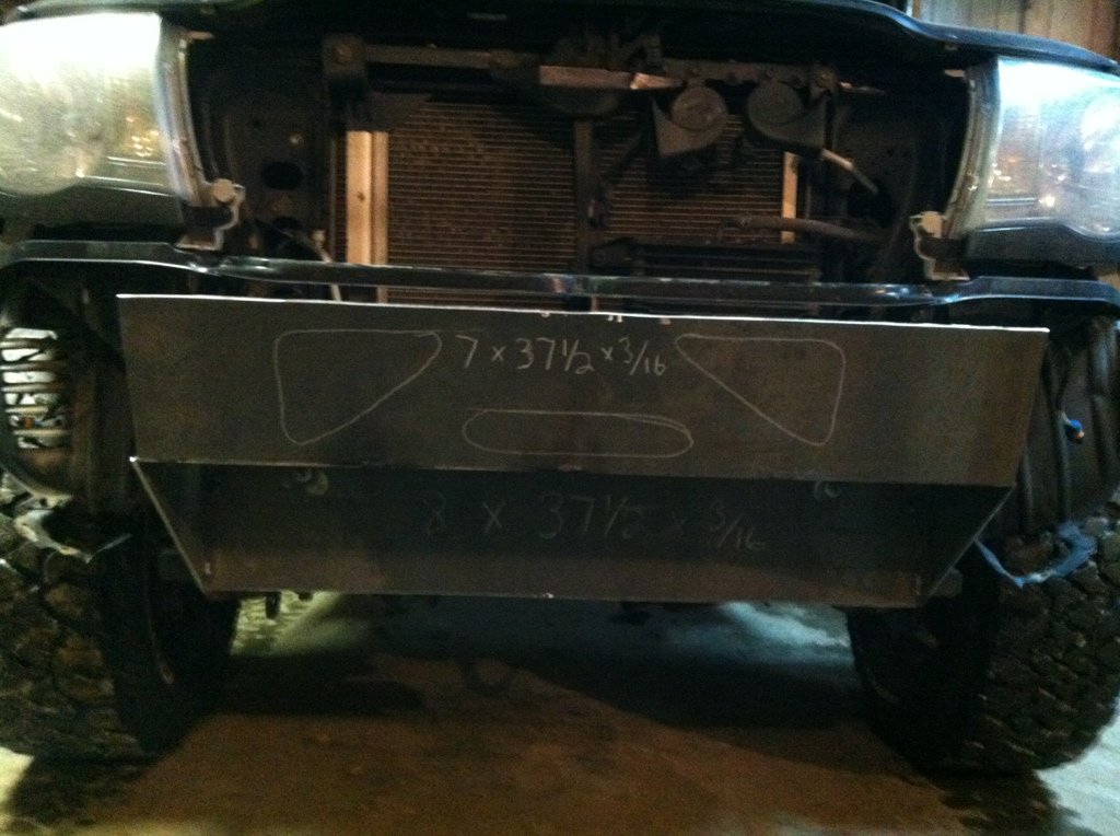

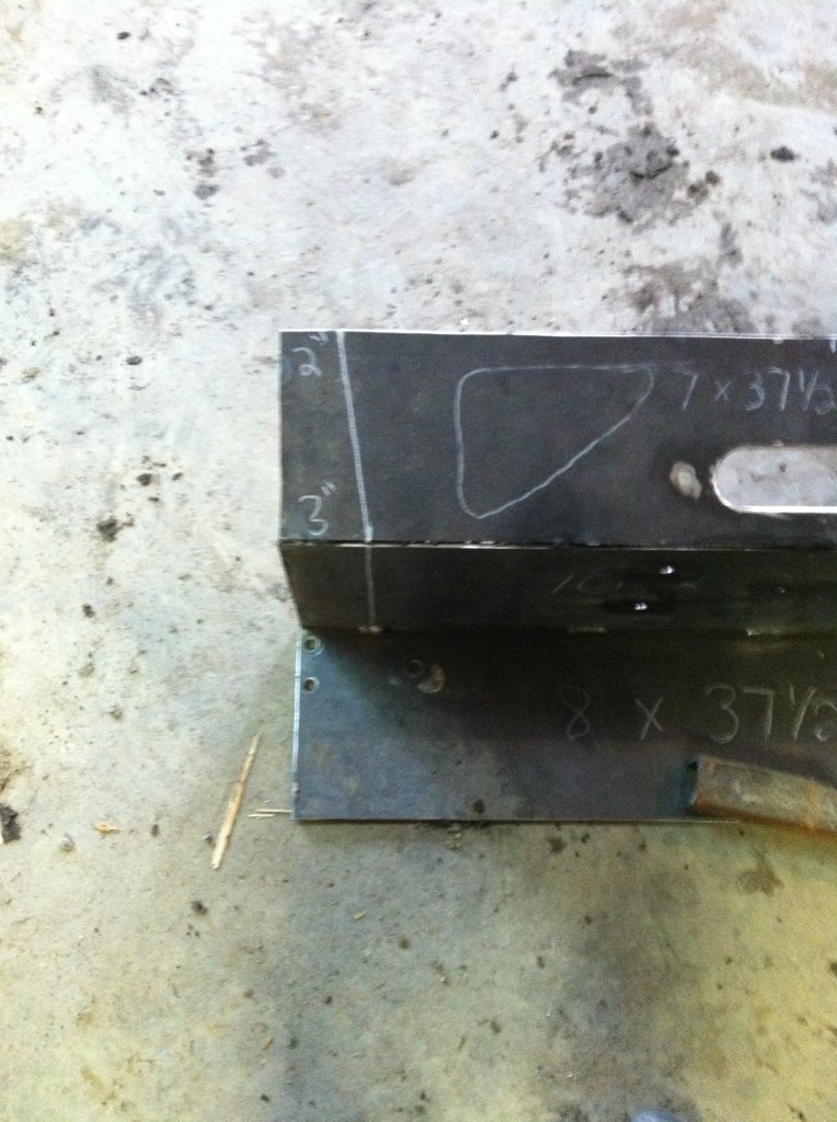

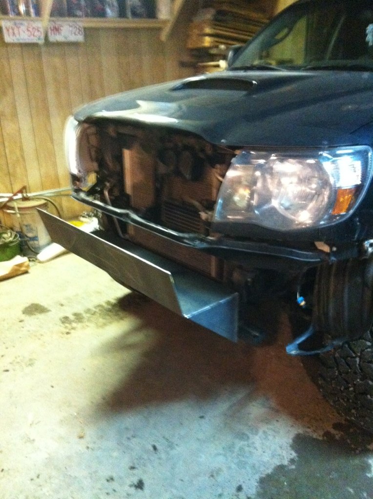

    Something to go with your popcorn
    AFF5040B-7486-4619-B361-F00160DED41E-147_0a49b76437eb58b67498f9f11b71406f561b7a58.jpg
    6DB3D709-5D43-48D2-8B3F-67FF88D978A7-147_f85b838c292a5e0fe0cfa44713edfa393d396e29.jpg
    The first peice cut and drilled :D
    A4247FE5-6E6F-4756-9110-C946E1D91CC8-147_83222104c942353029cfe9e4e837114f7c7a73df.jpg

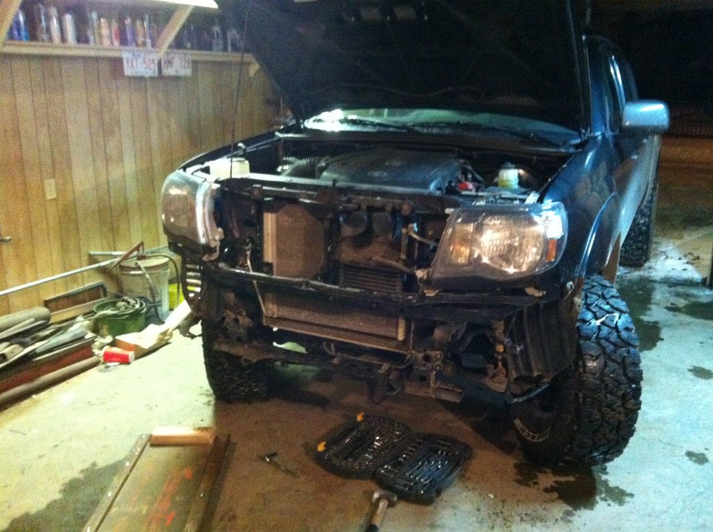

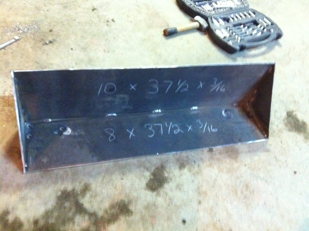

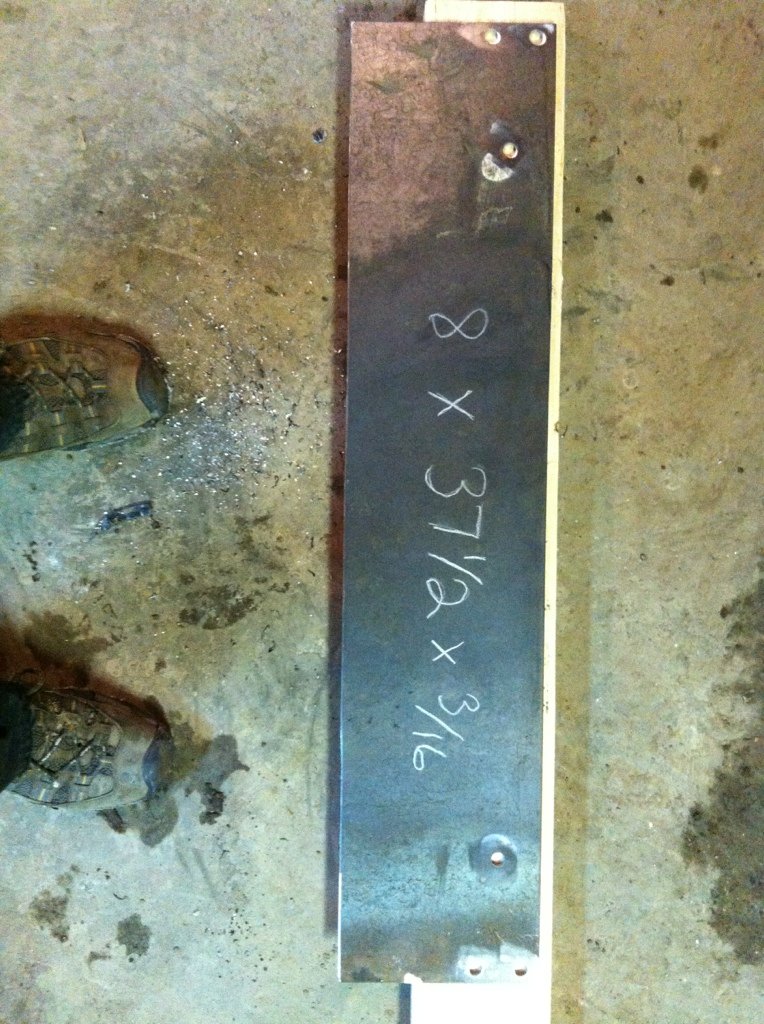

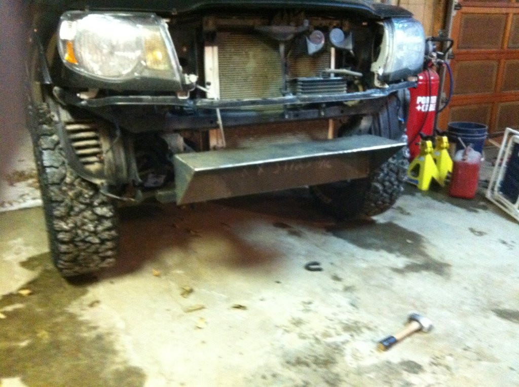

    3301D618-B527-45EC-AA30-1A430134CAC7-147_bcdf719e2fd4d848fb266507934c770925c33199.jpg
    95916E47-1E9C-44B6-B292-990B37E6DFF3-147_3b3517a1e4749b0efb2cdea461670d3420f77fa6.jpg
    0A1071D3-C74C-4CF6-A800-F709FAF975AA-147_98dc1b51463df73674954c051ad71eec95c33025.jpg
    502AAF61-5B45-4B77-BD48-FF3EF9C023B5-147_055c09e1e47bdf8849dda916aedc9bf84360193c.jpg
    7192E679-7555-4335-AAAC-3430E7477492-147_fc484203277b293c52b58237388f0feeffd04fbb.jpg
    I think that's all for tonight...maybe

    FYI The front plate is angled out 2" at the top

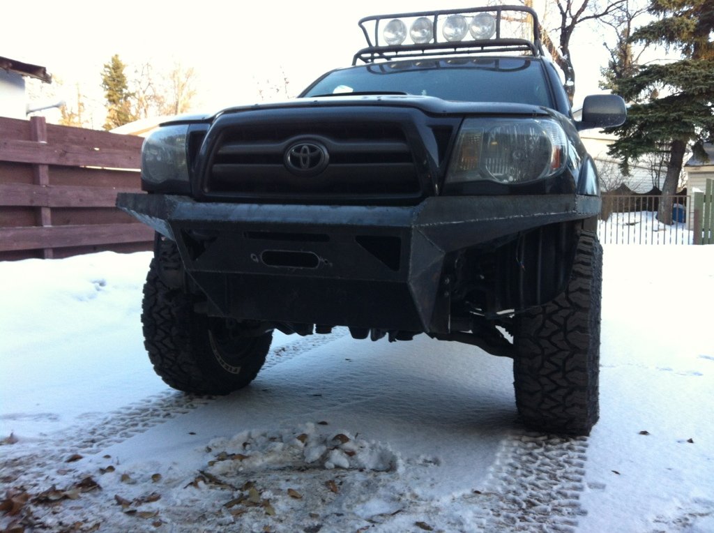

    Unhappy with the look of what I had I cut off the gussets and gave if some shape
    055B9422-69B8-44F2-A2C5-5A4E12148596-147_141d984dc9af652b5052204dd66dcaf884a8d58e.jpg
    7BE59A08-D20F-421B-8550-787D627E4CEB-147_f466ae75ecf4d05b9bd2b57775b32d42b7a6be03.jpg
    EBD22FA2-E524-4AB9-9EFB-E9838275B223-147_5fa78bdeb1d69ea856da118fdb8e651e0e4f561f.jpg

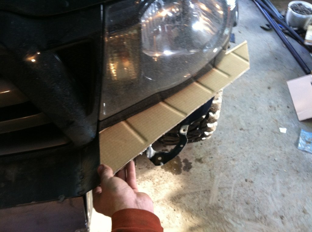

    After I was happy with what I had I started cutting cardboard to shape around the headlights
    ED7416F4-DDEE-4B8C-BE09-9B3828B6A6C0-147_fa40d662a607e26559fc089fc9dff48e6721dab7.jpg
    And then start cutting steel and filling in the gaps to a shape I was happy with
    2F35662F-6F4C-4379-9C60-6ABDE35435B1-147_21be558c29545d04602071c9e31f02c44a98792f.jpg

    Looks like some fab stuff straight off pirate 4X4... and that's a compliment. Your finished prod in the 1st pic looks kick a$$!

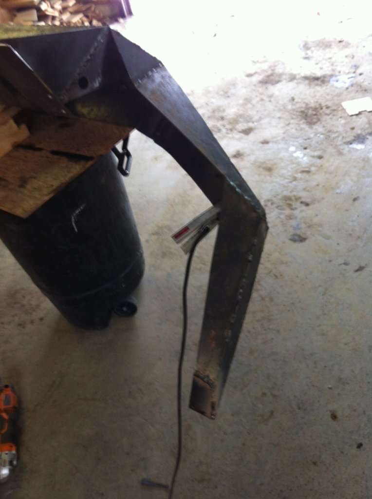

    Finished up the side profile and added a few triangles. 8 more pieces to cut and it will be ready for welding

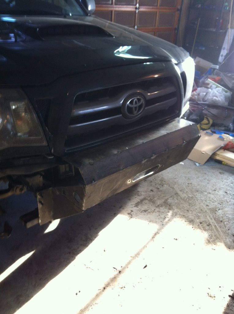

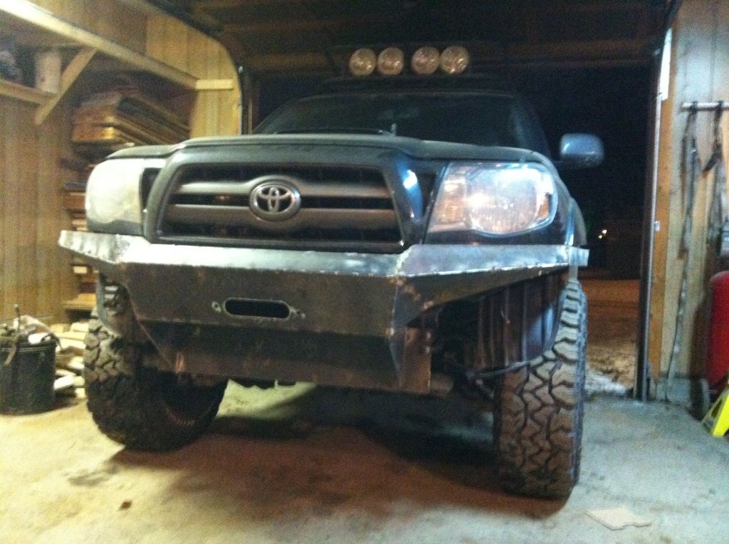

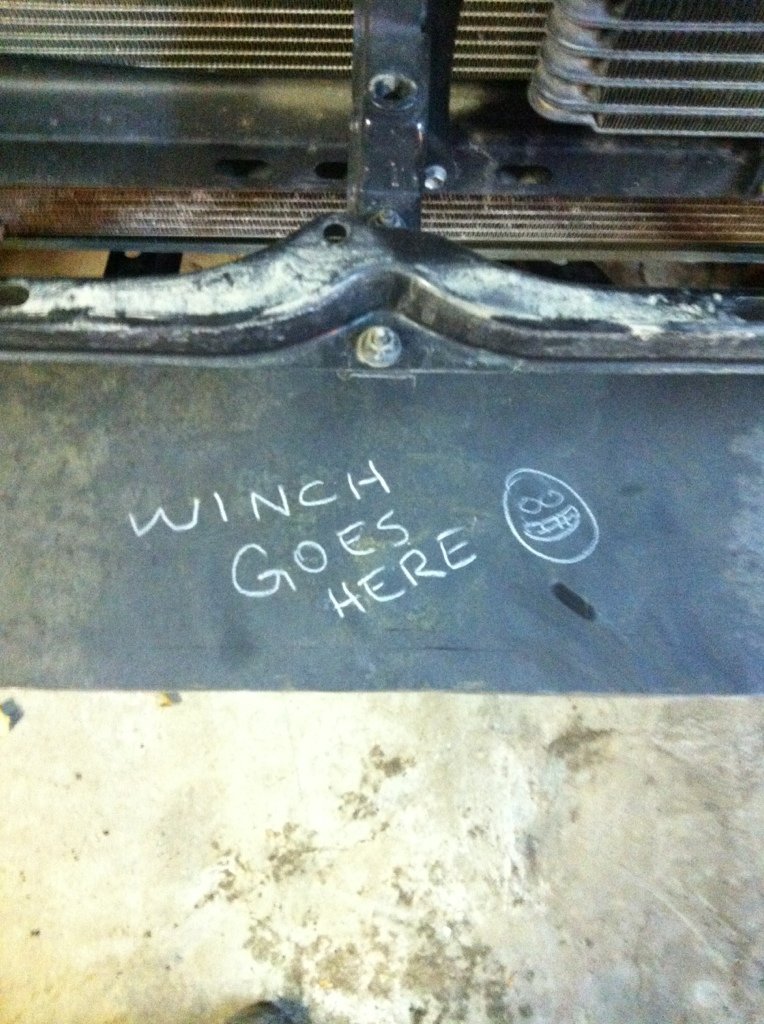

    I cut a few more plates and started welding, then ran out of wire so I cut the access holes and a viewing hole for the winch, I still need to cut the 2pc skid plate and tow points
    5B20B449-507F-4B17-A875-BABC870C03D4-159_510e8fc3b61ed2cd68bf6fba24707695842197e5.jpg
    12D0A89B-9DF7-4F75-81A1-7791C92ACB1E-159_e90b2cc2c000bb9568a8230a631f53ac0acb3abf.jpg
