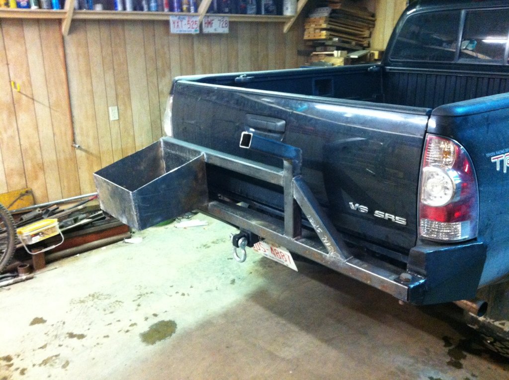

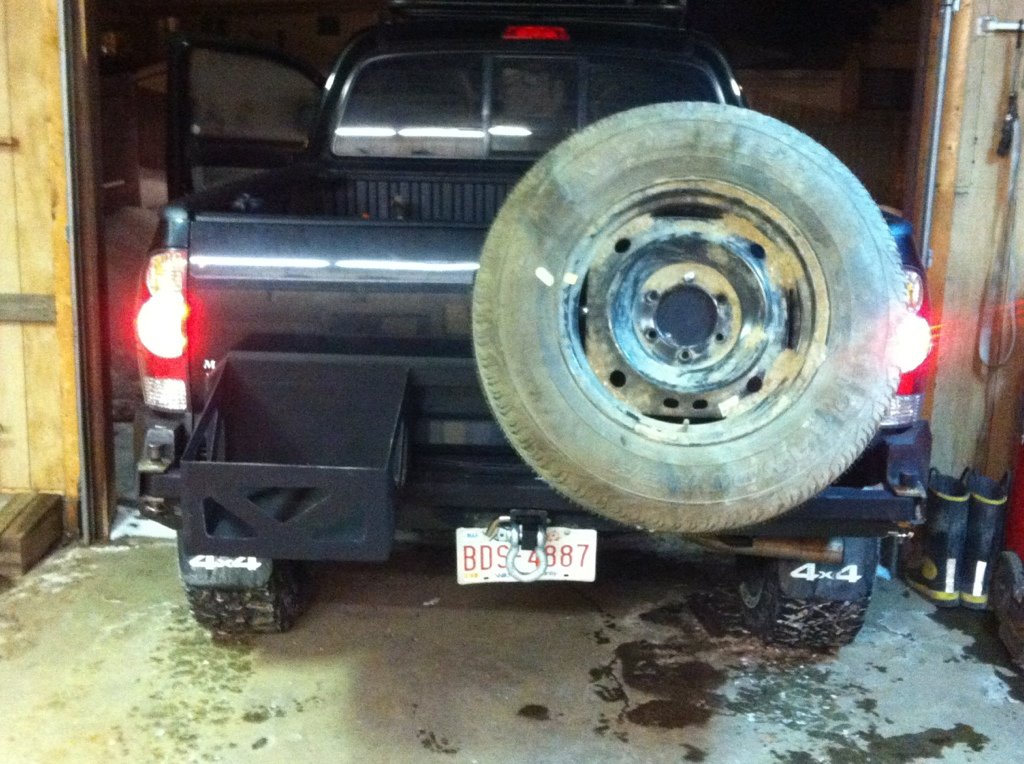

    I still need to build up some of the low spots on the corners, make the filler plate for the top and the swing out.

    One problem I had, I could not get the spare tire off, I don't think it has ever been off and it's stuck pretty good, any ideas on how to get it off without taking the box off?

    Looking good! Can't remember exactly how it looks but if you can get some penetrating fluid up into the little winch for the tire and work it back and forth a bit that might do the trick. Might be able to get up thru the rim of the Spare. Also make sure you have the tire winch captured completely. I thought mine was broken when I tried to get it down but it turned out that I didn't have the tool onto the tire winch correctly and it would just spin. Good luck!

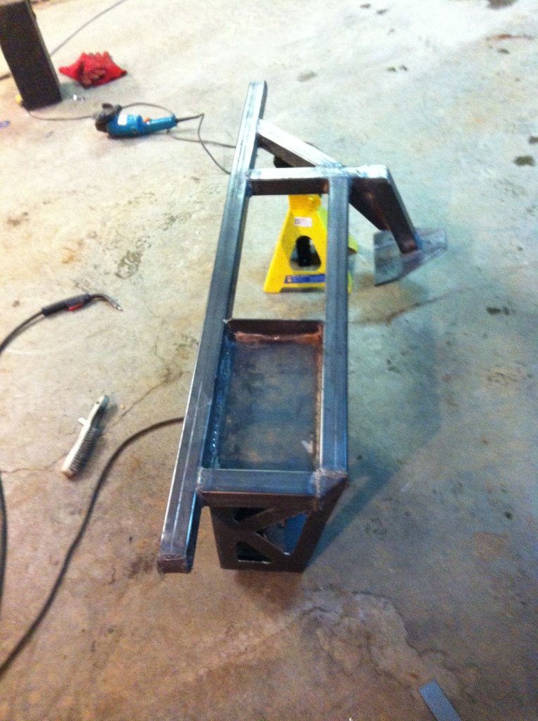

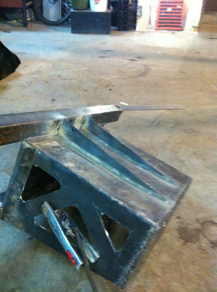

    Started the swing out today
    C43DBF2D-CA73-4F79-A1EF-5FD7662C0640-286_4ff18eeadc612b3676c1d6d9e072405480ec375a.jpg
    8F77505D-2761-4A38-9A53-510C3870E521-286_1dac0846930d571a6d2b0a14e0ea5611d1c55e6e.jpg
    And then tragedy struck, I ran out of welding wire...

    The license plate will be mounted either on the rear of the gas can mount, or on the frame between the tire and the gas can mount, ill punch a few holes in the sheet metal to lighten it (and holes look cool) I still need to add bushings and pins in the pivots, it will be able to open from both sides

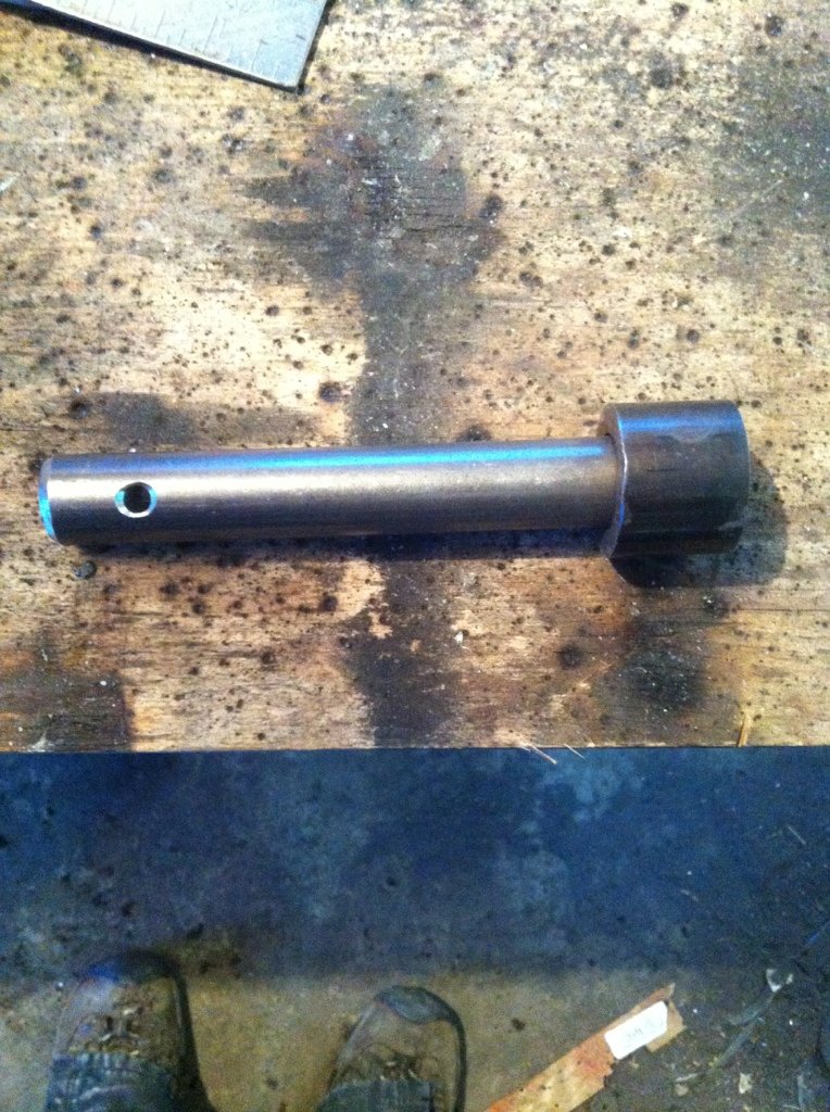

    Well I got the spare tire out after a lot of grief, I made some pivot pins and started cutting holes

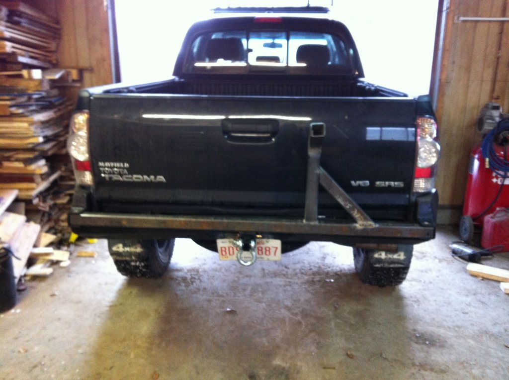

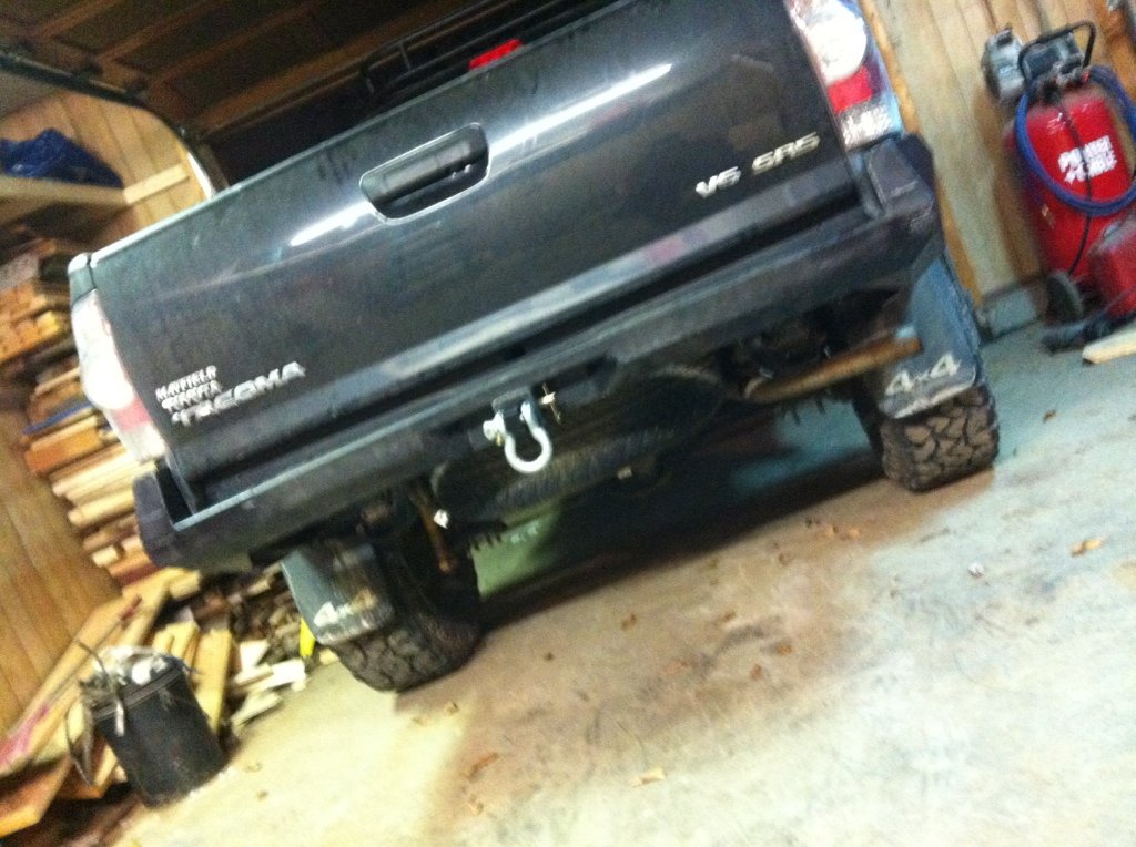

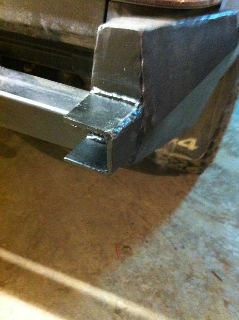

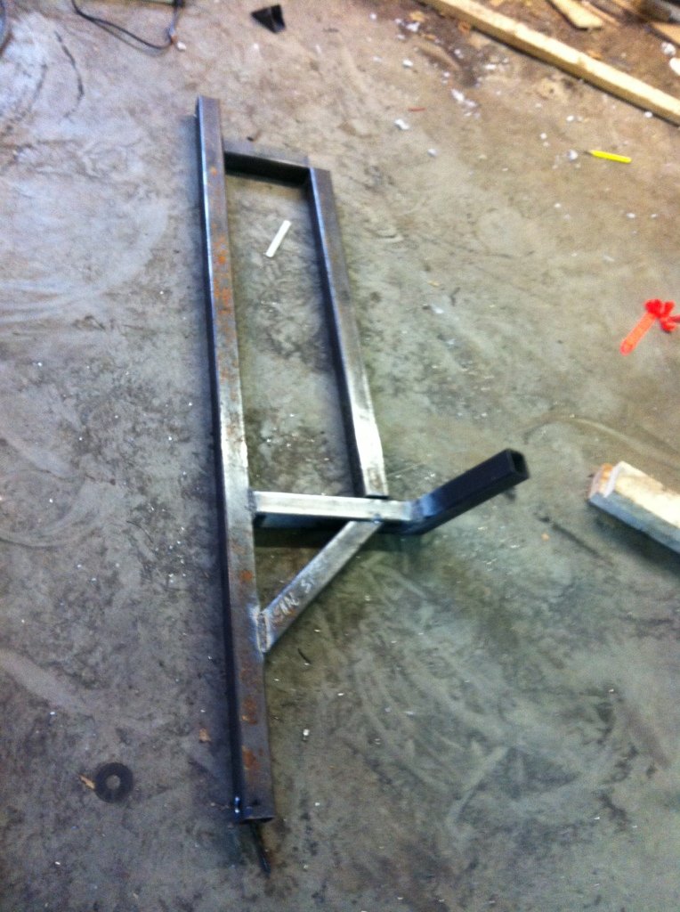

    Okay I added a brace behind the gas can carrier, gussets to the bottom and sprayed some primer, the sleeves for the pivots are not tight enough to support the weight, the swing out rattles when closed and sags when open so ill have to deal with that at some point, I need to finish the bumper mounts and make the filler plate for the top of the bumper along the tailgate, mount the license plate higher and mount the hitch plug, along with a few little things to tidy it up, next pics I post should be the finished product

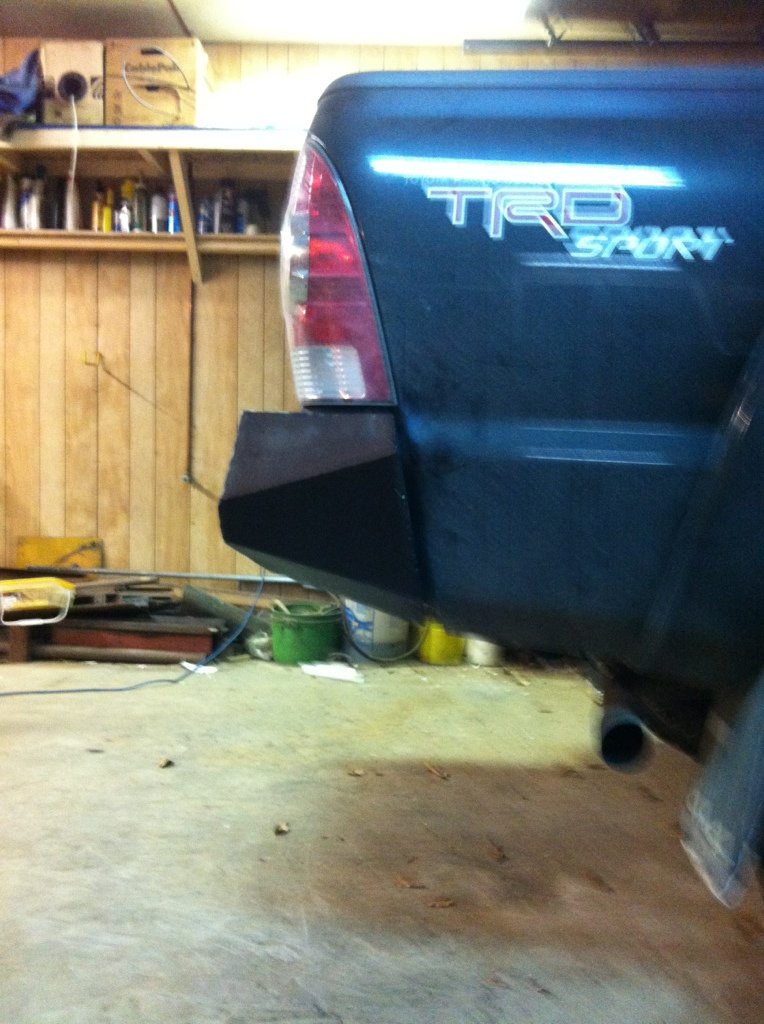

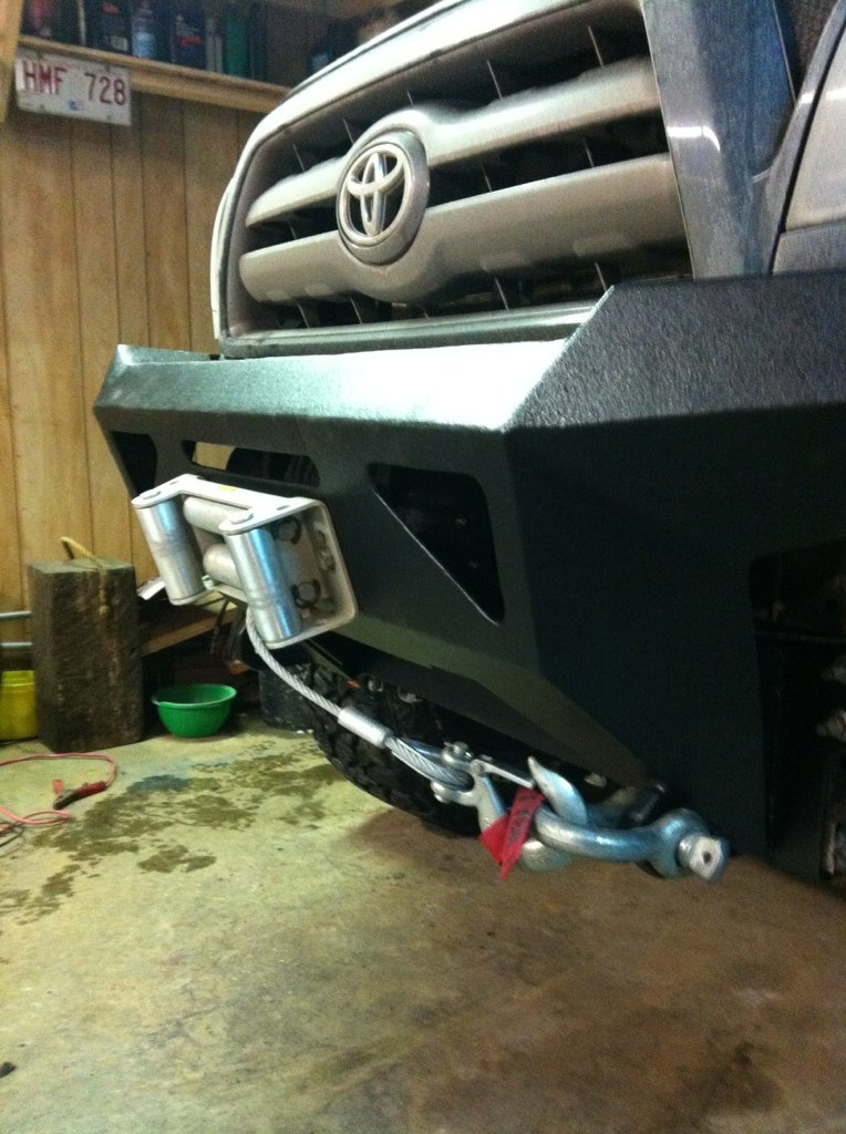

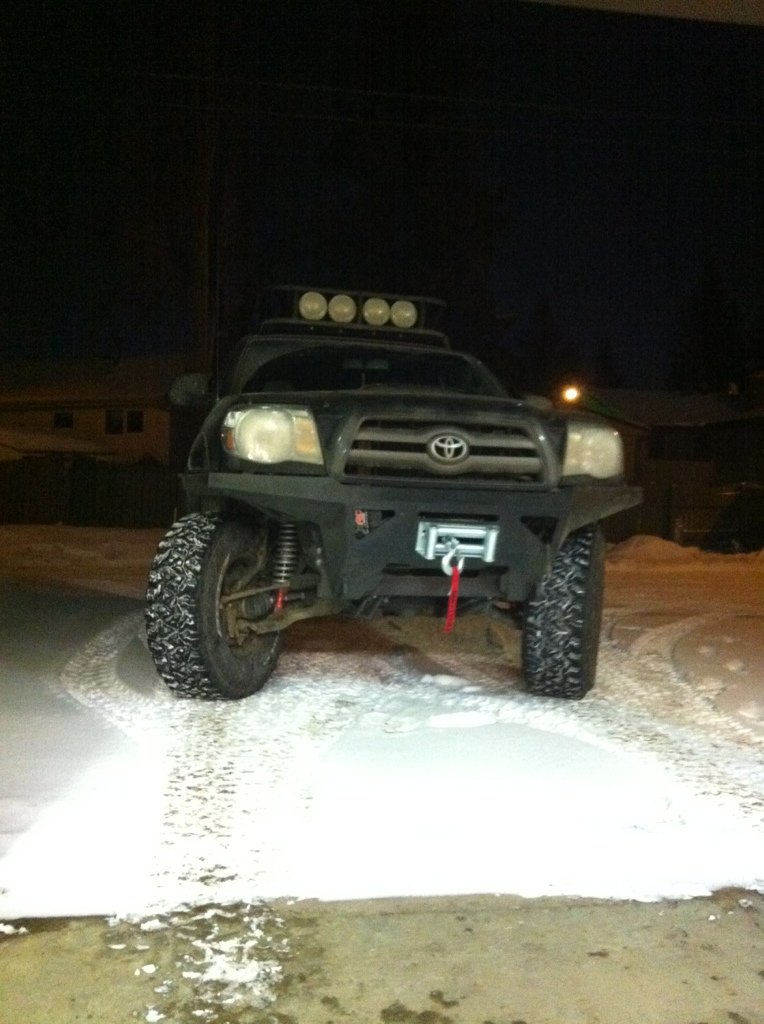

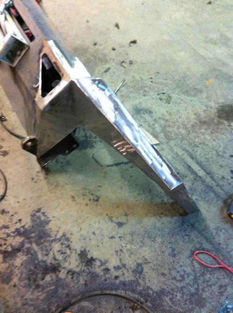

    Well the front is as good as it is going to get for a while I had to box the sides to stiffen them and get rid of a vibration I was getting, I smoothed out all the grinding marks, cleaned up the corners and hit it with primer/bed liner and got everything put back together, all that's left is the skid plate
