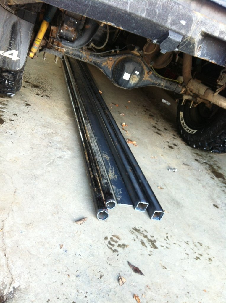

    Ok so this thread will need a new title after today, I debated starting a new thread but I don't see why I shouldn't continue this thread for my fabrication, that being said, here come the sliders :D

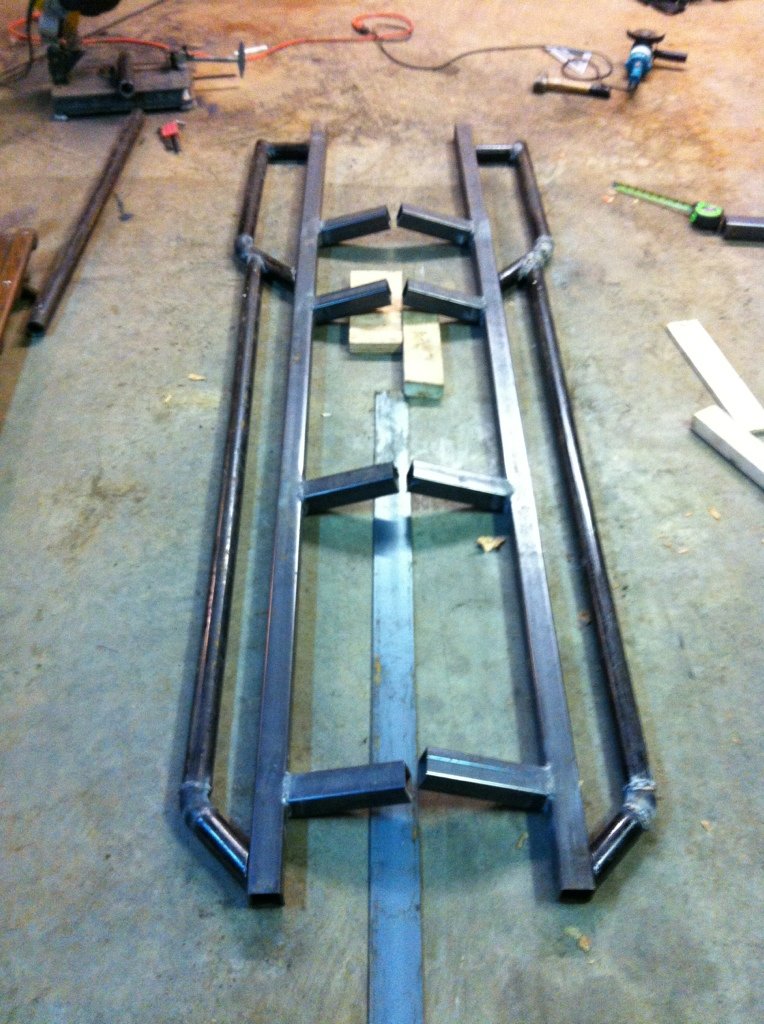

    Starting to take shape
    706216AA-DA1D-45E1-BDB6-EC8E4A2726FD-174_31a12a2ef006553b58b92cbbb02cb70d6736b4b0.jpg
    Before you start hating, I didn't plan on using manufactured bends, the bender at my shop was missing a part for this size so in the interest of a speedy build I opted to go this route. I may replace this when we get a replacement part for the bender

    Those are sweet! I like the angled look!

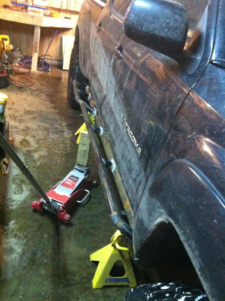

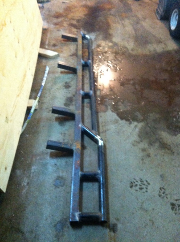

    Passenger side is about 75%

    how are you making those bends?

    Not making, I bought manufactured bends and welded them in, it's not the way I wanted to do it but the bender at work was missing a part I needed
