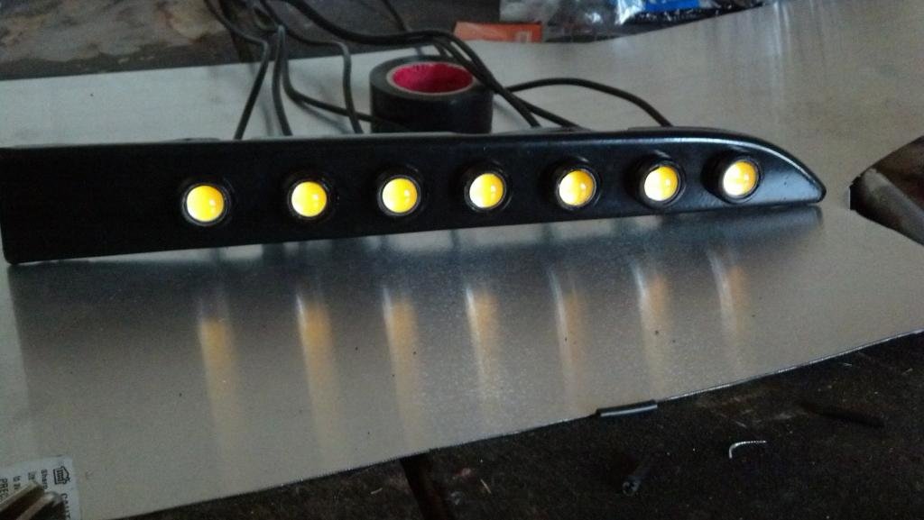

    Yup. I mean, if you're that worried about shelling out the cash, spend a little more and save in the end. By buying another set and painting them whilst using all the paint instead of letting the rest of it go unused. Then if/when one pops off again, bam you got it ready. Or try selling them. I ended up powder coating mine, only because I had black powder and the tools to powder coat:D Mine have become a little loose again over time. I just bent the clip on tabs a little to make it tighter. But now they're a bitch to get back off if need be. On a side note, I also installed bolt leds inside them for turn signals :cool:
