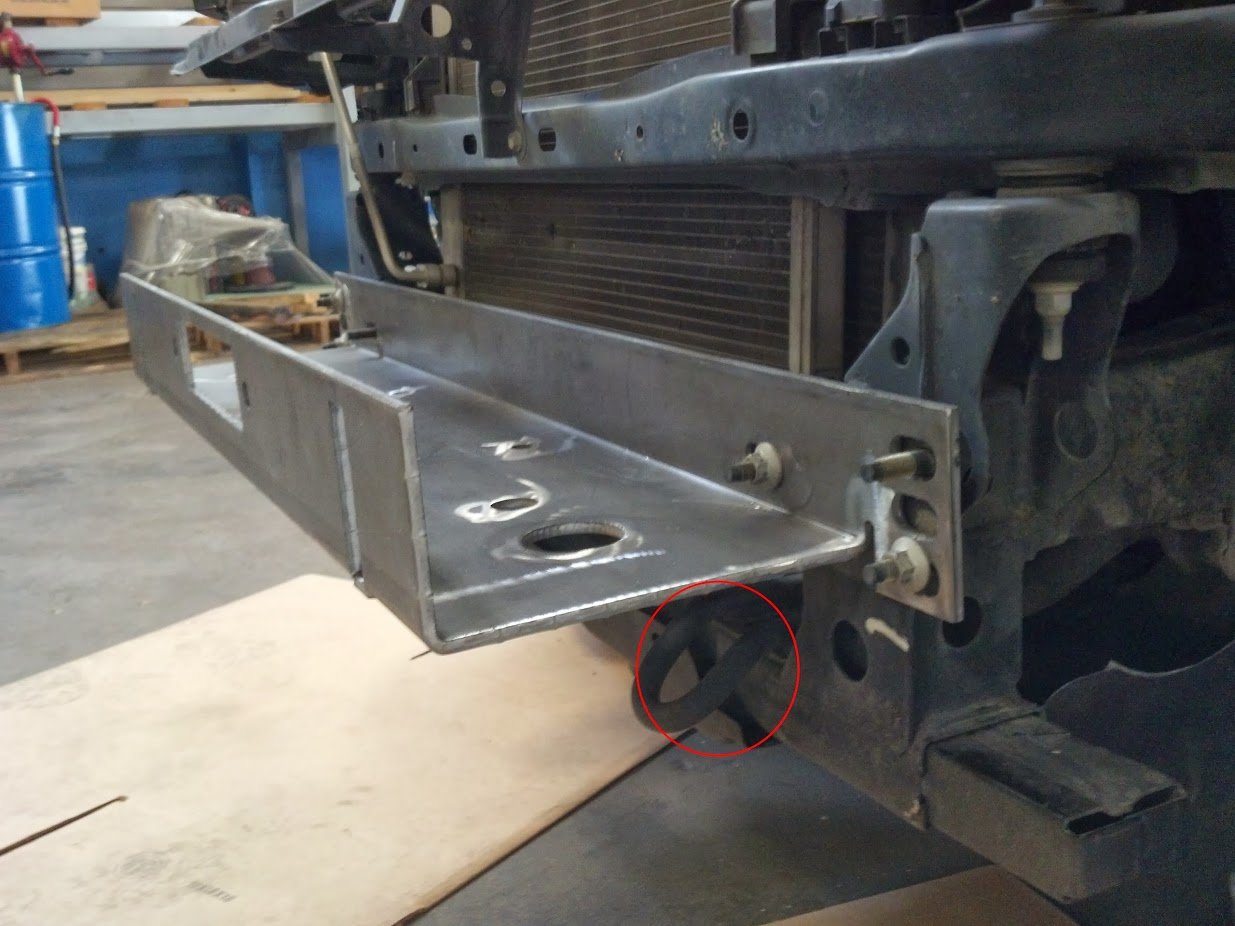

    So.. the customer has to cut off the recover point or design around it? This is your chance for direct product input.
    Just cut it off close to the subframe. A 4" cutoff wheel on just about anything should do the trick.

    my 2 cents.. customer cuts off the recovery point..

    customer should have to cut off the recovery point...

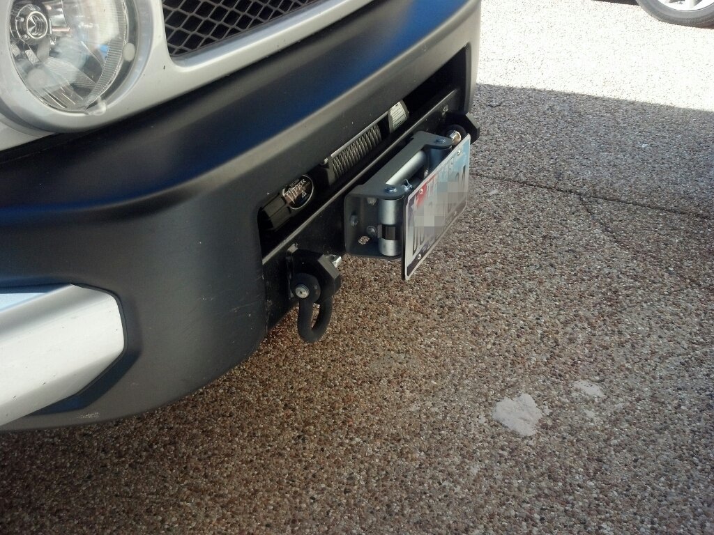

    If you run a roller fairlead then use this:

    As someone without the garage, tools, or ability to fab anything... I'd rather not have to cut at all. I also think the person looking for this kind of a winch mount vs. a plate bumper is trying to stay as stock as possible.

    cut it off, its not that hard, a monkey could do it

    You'll need to cut your bumper though.

    i do not have a roller... i have a hause fairlead.
    i do like the setup easyrider poster a link to..

    I like that. I hope you sell it all together when you get this thing done. :)
    And yeah, I'd probably be fine figuring out how to cut off the hook and cutting the bumper a little bit if that means I can avoid the full on plate bumper option.

    Ok.. so, this is a single product concept that will entail removing the center section of the bumper cover.. that means you cut it out.. .then replacing the stock bumper tube inside with our mount... just like on the FJ. Bash plate protection, winch mount tray.
    If you want a behind the cover mount then there is one on the market. Although.. .I guess we could offer both. : )

    Agreed. Even if you just get a 4" cutoff wheel and put it in a decent drill.. it will get it done. Pretty simple.
