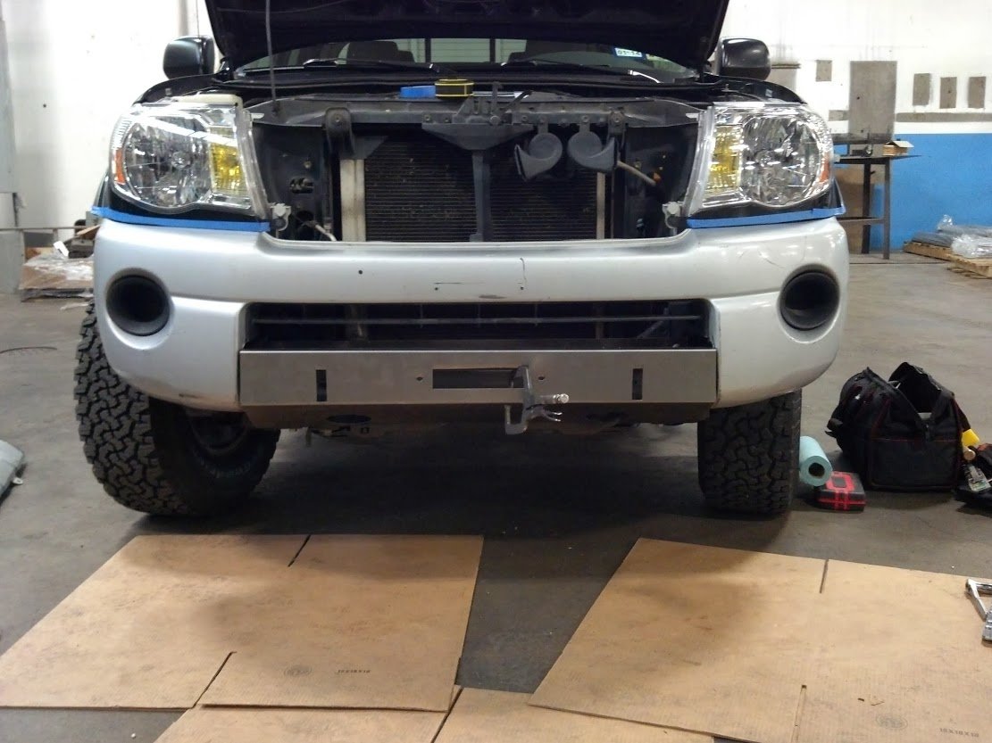

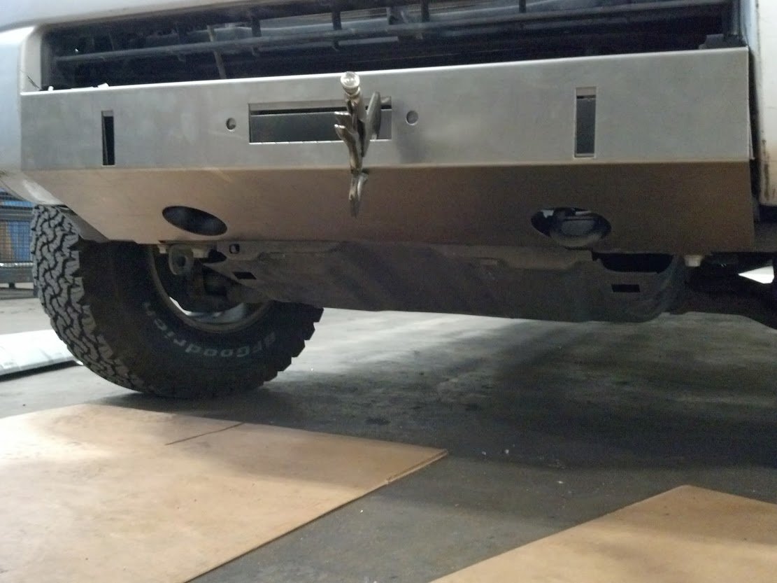

    Ok. We have what we need to create a valid prototype. Thanksgiving will put a kink in our schedule but maybe next week we will have an installable prototype.
    Here's a few pics and some more info. The pics make it look flatter and more square than it really is. There are quite a few complex angles and bends in this to be done right.
    We had just removed a few of the clamps before I thought to take a pic so the fascia is sitting about an inch lower than it should. Keep in mind we used very thin 10 ga steel to do the mockup so there is a bit of flex. We have all of the angles and mount points established, quantity and location of gussets (4), light bracket positioning and so on.
    Again, when I shot these pics it was barely mounted so it's not an accurate view of how this will mount but you get the idea. The two large holes ... well the driver side was there to clear his tow loop, we cut the passenger side for... well, we just did. However, after doing so I think I may leave them in the design, this way you can cut off your tow loop or leave it even though you can't really hook much to it.
    As far as the hidden version goes. I'm not going to say it's impossible but it's going to be a tough one primarily because of space issues.. not enough from from the back of the mount tub/frame mount points to the front to get behind the cover and still accommodate a winch. I have an idea but it will likely make it a complex production process which can jack up the price. So, patience, let us get the full version out then we will take a closer look at the hidden version.
    Aluminum. They will work up a quote on 6061 aluminum.. heat treated, before production. We feel it will require heat treating because of the quantity and spacing of bends in conjunction with the required thickness.
    Overall this is more difficult than I imagined because of multiple complexities regarding space, alignment and strength. I will NOT build it if it's weak just to accommodate the design. Quite frankly there are a few design changes that I will incorporate in to our FJ design.
    I hope to have the prototype installed on John's truck next week late or early the week after the start production from there.
    As soon as I have pricing I'll share it with everyone and start a group buy accordingly.
    Again, I want to publicly thank John (jjew18) for the use of his truck. He was gracious enough to let us keep it until today. Not a simple task with kids, work and this is his driver. He will earn a mount out of this but I might suggest a pat on the back as without his truck this wouldn't be possible.

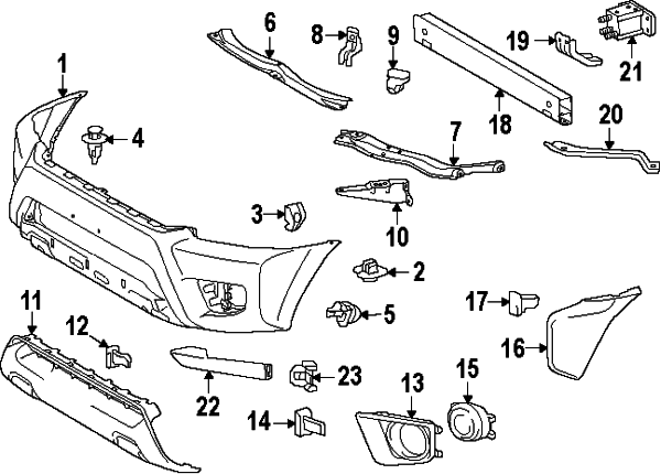

    So, obviously the exploded view below shows the cover of the lower fascia comes out with the grille above it then all you have to do is cut the piece behind that so it should be a real clean installation.
