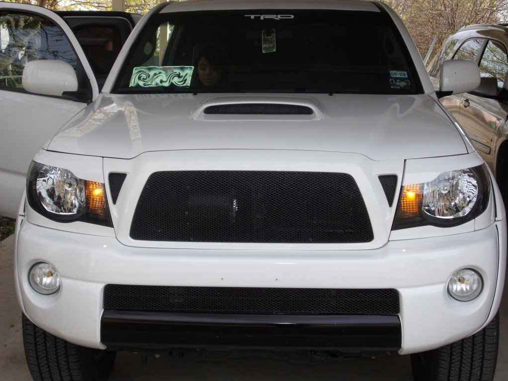

    I had the same problems as OP.... I finally had a friend that puts decals on motorcycles install the vinyl. He had a hard time with the contours of the bottom... a couple wrinkles, but nothing noticeable. I installed an X-Runner bumper piece, and it gave it an OEM look.

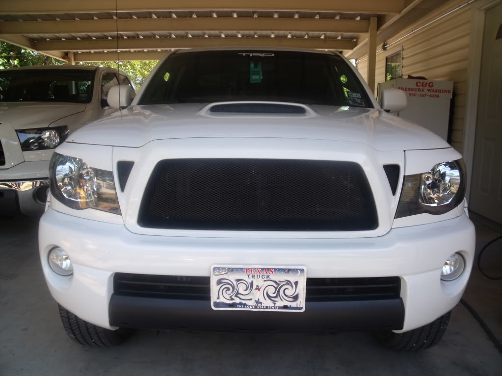

    XR Valence Piece:
