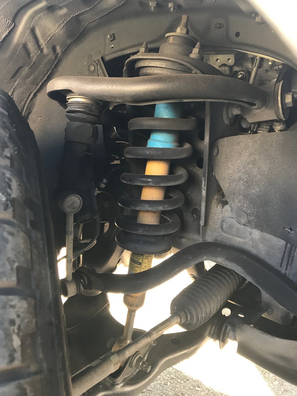

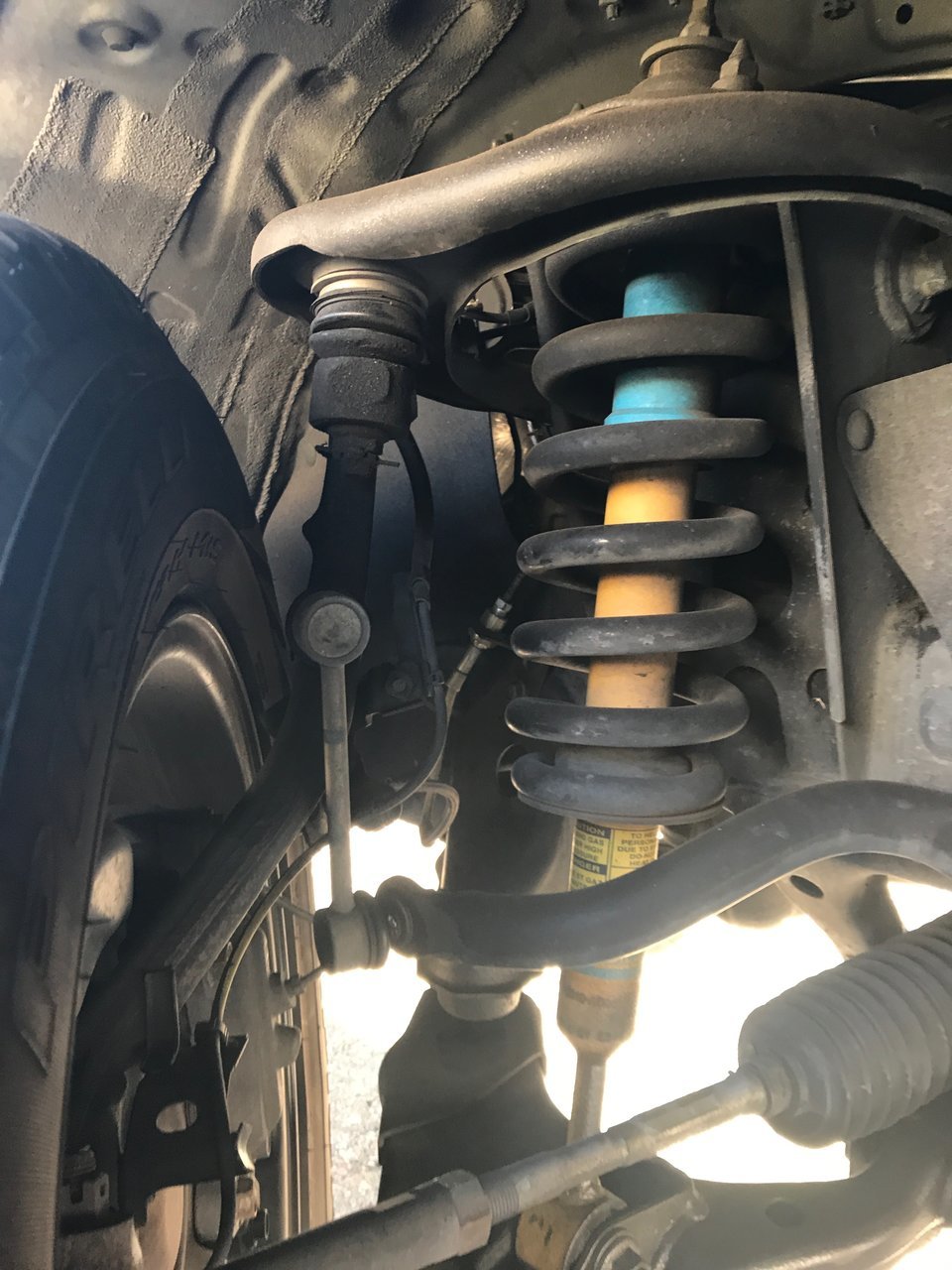

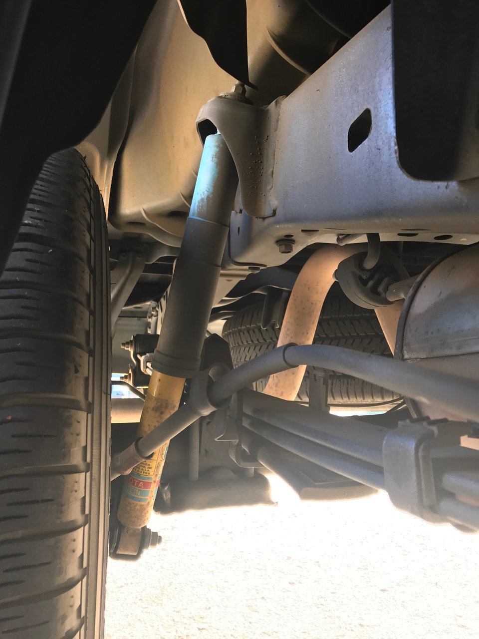

    71F58059-F872-45B1-9874-7F51660B3028.jpg722BF80A-3F5E-4A4C-AE60-B8CAADC62BD6.jpg E4DF9E6E-6B6A-4331-98B5-7CA45511634C.jpg

    Interesting, doesnt appear to have a coil spacer.
    Did the dealer say it had a lift?​

    looks like you got some steel braided lines up front...

    I could be wrong, but looks like you have stock TRD suspension.

    Looks stock.....

    Maybe, to me that looks like the original suspension with 88K miles on it. What frame damage is he claiming was there?

    Im pretty sure it's stock suspention. Maybe it has a body lift? but it does not have a suspention lift. Dealership Jewed you.

    Yeah you got taken for a ride at the dealer. There is no lift on that truck. If you paid more for such said lift I would ask for a refund and tear up whatever you signed about possible frame damage. Ask the sales man to point out to you the lift. Educate yourself on the front end parts breakdown of your truck. All the parts on the picture are stock.

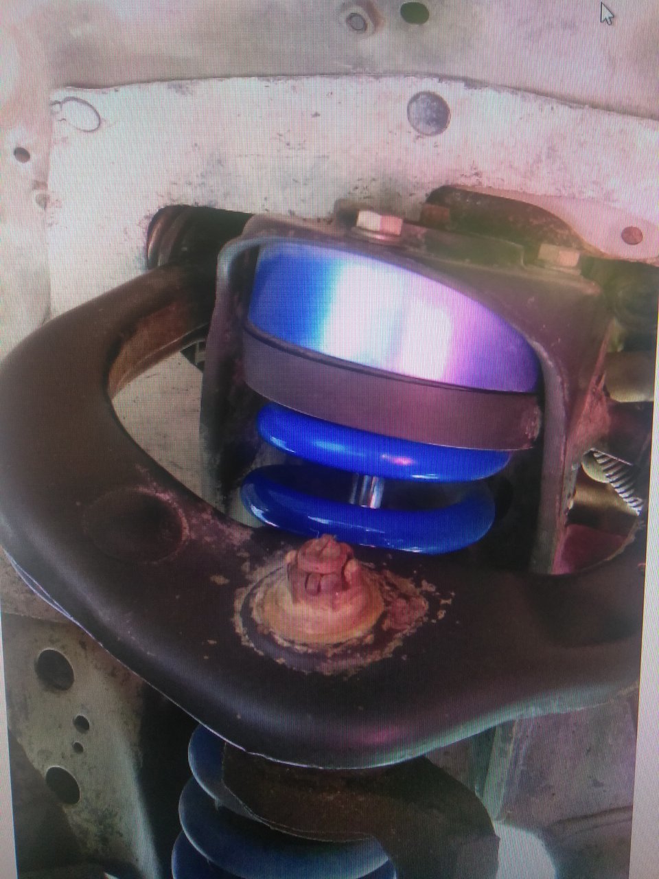

    My spacer looks like this on top on my Fox coil overs.
    nickfromsd[OP] and ChadsPride like this.
