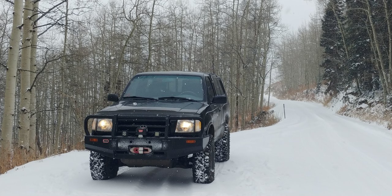

    Burt: 1998 2.7 Regular 5 speed 4x4
    Bilstein 5100, ARB Bumper, Warn VR EVO 8, 34x10.50 Toyo 4.88s ARB Locker
    Enter Burt, my 1998 Tacoma, originally bought as a daily driver.
    As of 2023, I am building the truck with some harder trail and trips in mind, I have a Ford F250 (Daryl) with a Four Wheel Camper on the back for longer trips but with a long wheel base I try to reserve some of the harder trails for Burt.
    Current Parts/Stats.
    As of 10/1/2024
    As of 3/15/2024
    Current 8/21/2023
    How Burt Sits As Of 9/20/2019
    11/29/2019
    As of 2/19/2020
    *Engine
    2.7 3RZ-FE
    Anti-Deckplate Mod: "More Power, Less Dyson"
    Ebay Snorkel Cyclone Pre-filter
    296,325 Miles as of 7/8/2025
    5K Oil Interval: 90915-YZZD3 Filter, Mobil 1 5W-30 Full Synthetic
    High Mileage Blend
    Coolant Flush and Thermostat 275,200 Toyota Long Life coolant
    Toyota Mini Header Swap
    *Drive-train:
    W59A 5 Speed
    80W-90: Last Changed 4/6/2025 294,685Mi
    *J-Shift Transfer Case
    Front Output Shaft Seal Replaced PN#9031141012
    80W-90: Last Changed 4/6/2026 294,685Mi
    *7.5" Front Diff
    4.88 Gears
    Self Install 285,000Mi 7/2023
    80W-90 Last Changed 7/2023
    New Aisin FHT-019 Hubs 296,000Mi
    *8.4" Rear Diff
    4.88 Gears
    ARB Air Locker
    Self Installed 285,000Mi 7/2023
    80W-90 Last Change 7/2023
    *Suspension
    Bilstein 6112 6/5 Notch
    1/4 Top hat Spacer
    JBA Upper Control Arm
    HFW Spindle Gussets
    EimKeith LCAR
    Moog LCA W/EimKeith STR
    OEM LBJ 294,800
    Perry Parts Front/Rear Bumpstops
    ARB CS046 Leaf Spring: Minus Short Overload
    Factory Shackles Modified To Use Wheeler's Off Road Shackle Bolts
    ARB FK-21
    *Armor/Recovery
    ARB Bumper,
    Warn 9.5XP-S
    Factor 55 Flatlink W/RopeGuard
    Custom Rear Bumper With Dual Swing Outs
    *Electrical
    Optima Group 27F
    Custom Dual Battery System, ML-ACR, Optima 35/78 Battery
    OGE Mil-Spec Terminal Conversion
    Blue Sea Aux 12 Circuit Fuse box
    Voltage Boosting Fuse
    Dometic CFX-35W
    Baja Designs Squadron Sport Combo
    ARB Single Air Compressor: OBA
    Kenwood kmm-bt328u
    Kenwood TM-281A Ham Radio
    *Misc
    Full Frame Strip and Repaint 1/2023
    Various Body Rust Repairs, Kinda
    Sold and replaced***Raven Topper W/ Carpet Interior, Climbing Anchors, Yakima Roof Rails***
    *** Soft Topper Tan*** Storage/Winter
    Custom Bed Rack 1.5 1/8"
    23Zero Walkabout 56
    Blue Sea Dual USB Conversion
    Interior Voltage monitor
    Cruise control Removal
    OEM Lower Ball Joint Replacement
    Seat Covers, "Motor Trend" Neoprene
    *Wheels/Tires & Brakes
    Refinished factory Tundra 17x7.5s
    Toyo Open Country AT3 34x10.50R17 D Load
    Tundra Brake Conversion 13WL Calipers
    Napa Premium Pads/Rotors
    AdventureTaco Hardlines

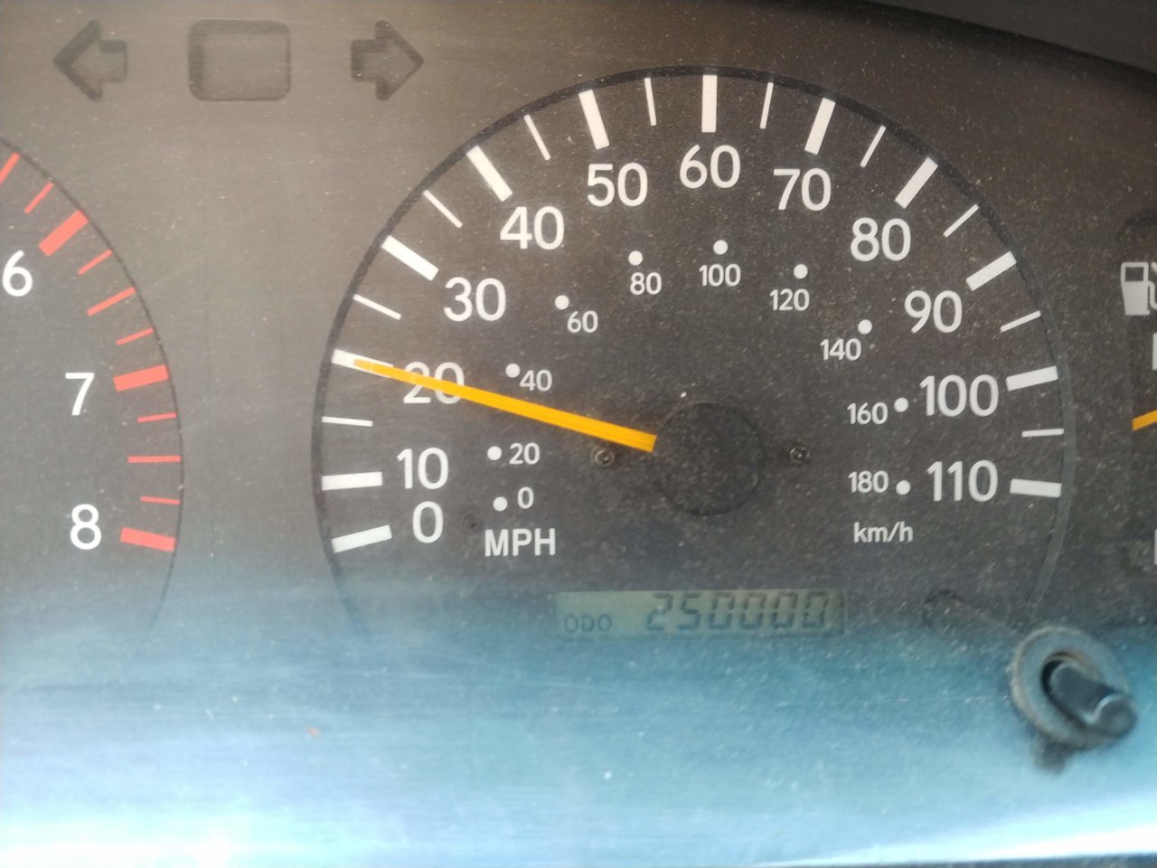

    250,000 miles! 1/4 million club! Still summer of 2018.
    Burt got a full oil change to celebrate and reset the maintenance schedule exactly on 250,000 miles. 0707181236.jpg

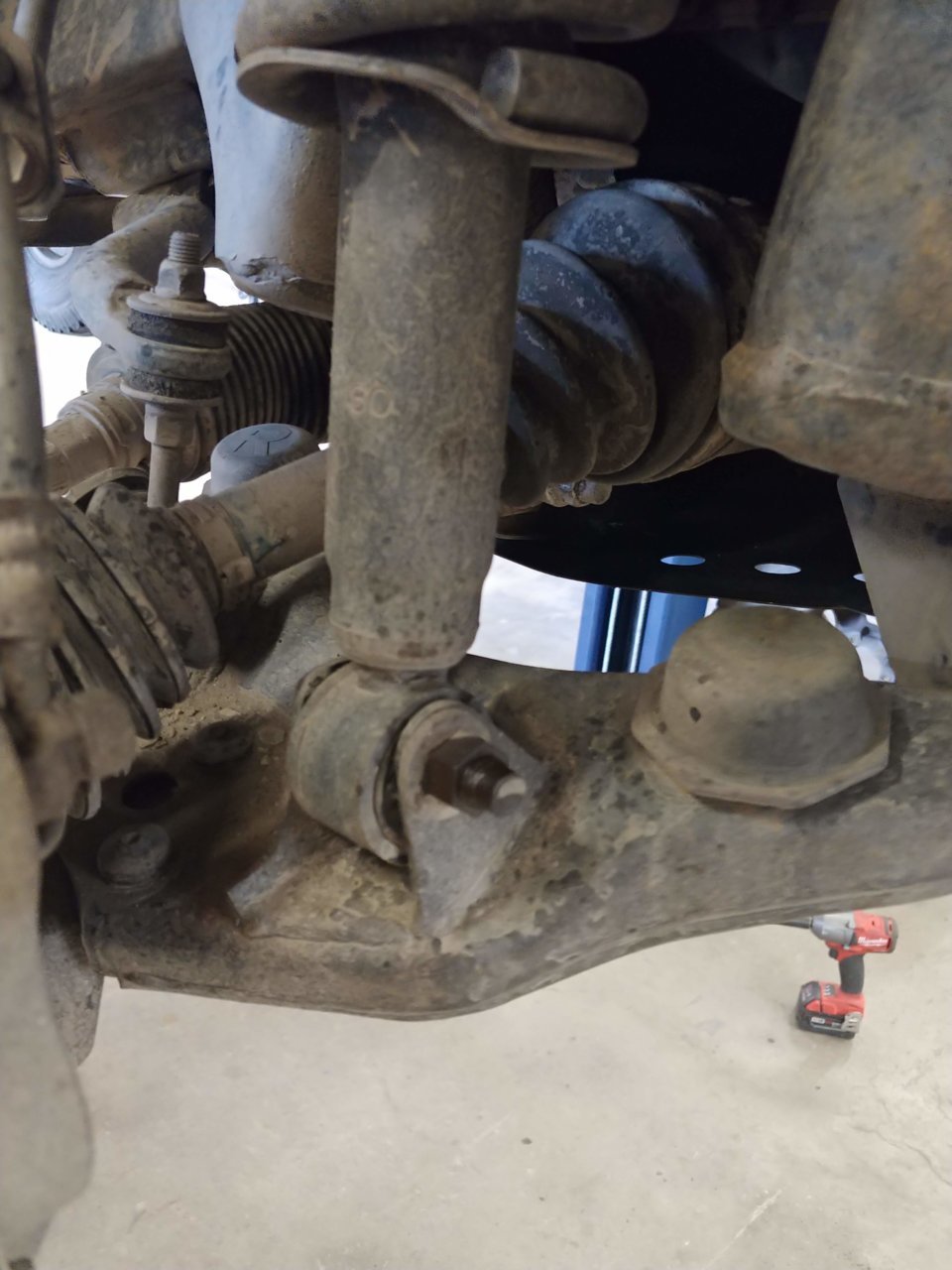

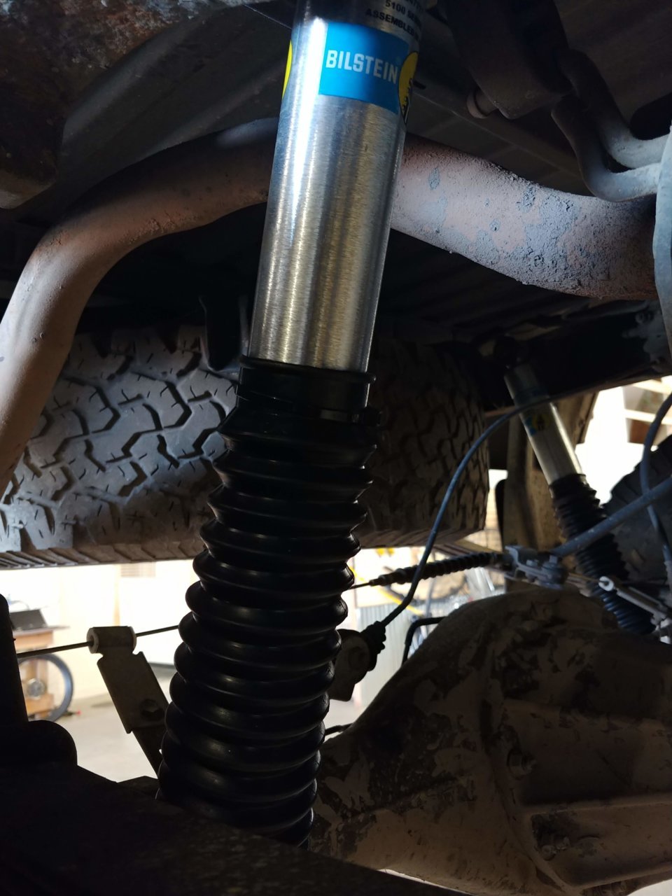

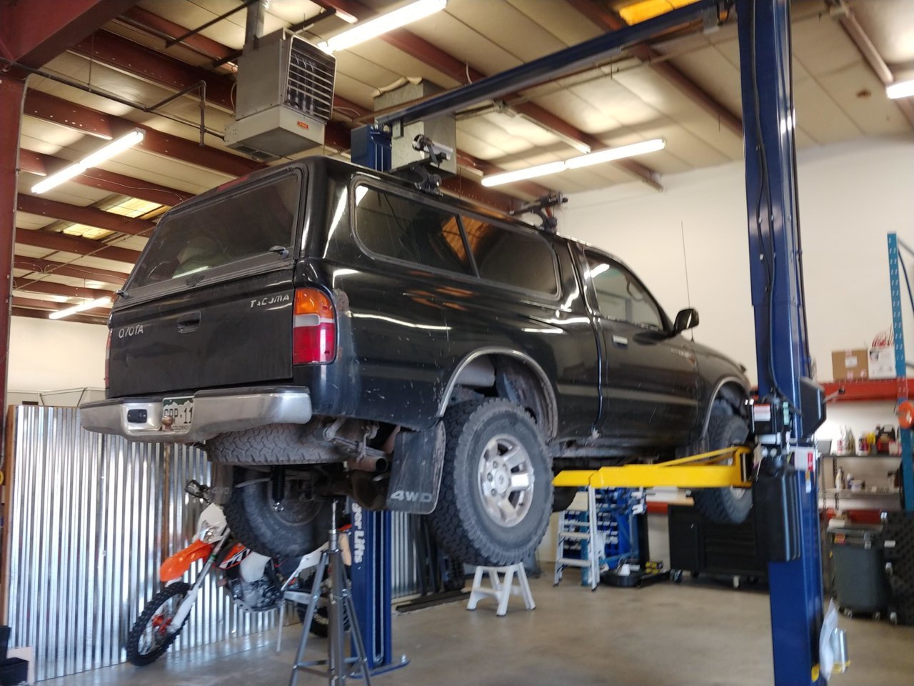

    Upon purchasing Burt I put him on the lift at work to give him a check up. I noticed that the front coilover lower bushing was completely worn out. Which explained the clunk I got if I hit a pothole reasonably hard. The interesting part was that they were Toyota Shocks and I believe they could be OEM, maybe someone can confirm or deny this, the shocks still rode well but the bushing toast. So I took the opportunity to give Burt a bit of an Upgrade, and a set of Bilstein 5100s all the way around sounded good to me, I loved them on my 4runner, hated them on the rear CoWj (Too soft), and decided they would be a good replacement of stock on Burt without requiring a lift.
    Due to the 2.7 I didn't want to go with tires any larger than stock, granted it had 31x10.50R15s but I know some Tacoma's came with 265/70r16s which were bigger, hmm...
    Down to business, The old shock was looking a bit old and that bushing is not even close to being in a healthy condition.
    So with the old shock removed I kept the factory coils and swapped over to the nice shiny Bilsteins.
    Fronts done, now onto the rear.
    Now for the best part! No, it's not the ride which is very good both on and off road, it is the fact the not only did I not have a single bolt break of be rusted and seized, they all came out easy as working on a new truck, just dirtier. I should buy a lottery ticket, especially since I checked all the LCA camber bolts, all broken loose and could be turned to adjust the camber. Talk about a good day!

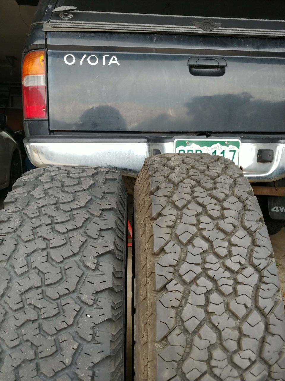

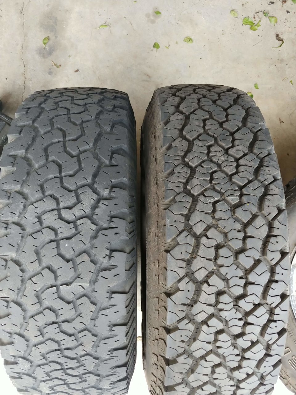

    New Tire Day!:
    Ish...

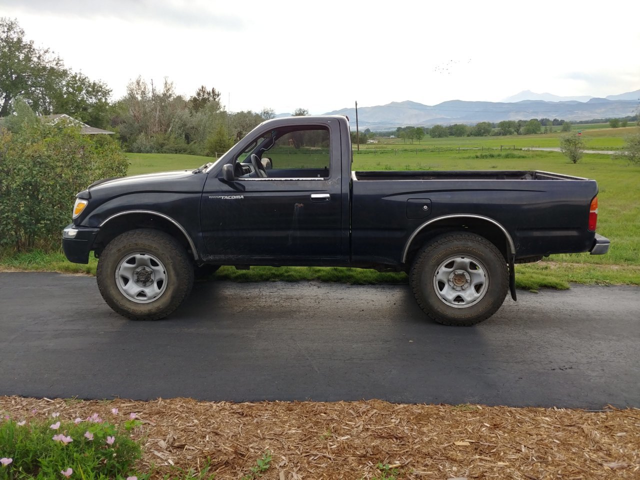

    When I purchased Burt he had a set of 31x10.50R15 Bf Goodrich KOs on the factory wheels. I think that is a great combo, I love the look of the wheels and find the BFG KOs a good all around tire, granted I ran than them a few years ago on my Zj back when they didn't have a KO2 option. But the tires on Burt were about to hit the end of there life cycle, poor wear, and dry rotting were the main issues that they had. I would have loved to pick up a set of 31x10.50s and slap them on the factory wheels. But what made more sense was to pick up a set of 2nd gen Steelies in a 16x7, and use the perfectly fine set of tires I had in the garage. the tires in question were a set of 235/85R16 General Grabber AT2s, which had less than 10,000 miles. These were the tires I had previously had on CoWj before switching to Falken ATW3s for a better winter traction when I moved to Gunnison for school and needed a winter focused tire.
    I did a quick size comparison before picking up the steel wheels for free.99 and learned that the 235/85 is an inch taller than a 265/70, however it is also an inch narrower, and well with 1st gen and no lift they clear with mudflaps and no rubber at all. So on went the Generals to the steelies, and then they went onto Burt. But not without a quick side by side comparison.
    Tall and Skinny just the way it should be on a single cab!
    A test drive was in order, and of course I had to go find the closest dirt road to take some photos.
    Digging the look of the new wheels and tires, eventually I hope to return the factory alloy wheels, and have them in the garage for when that time comes.

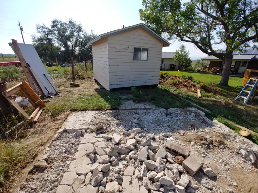

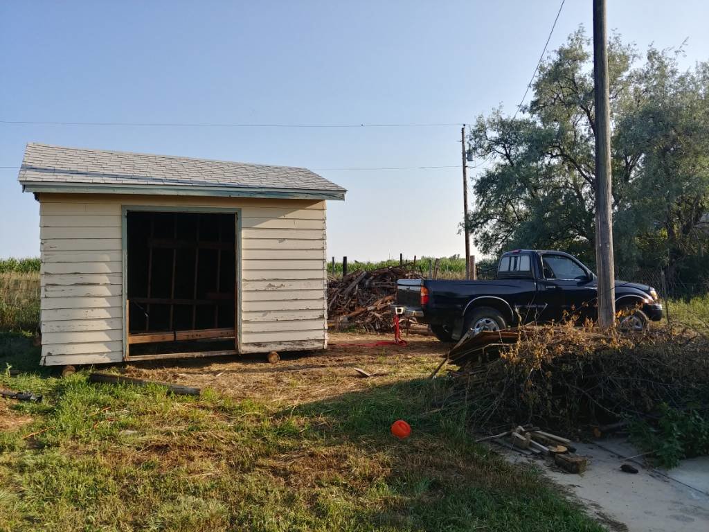

    **Note I Do not recommend this as your method of moving the shed**
    The Move:
    82BTNCkN3FBe0sWNYDtxkgfDGiH_p6uPRguzEnUQ_ebf28a2282b673eb7c0a3c6ccfa276cbb48bc72f.jpg
    My mom gave my dad and I a list of things to complete on the house before I went away for college. While we had completed nearly all of them including taking down a large loafing shed left in the field by the previous owners. Next was to move the shed across the yard.
    Only a matter of 100' or so. The ground was mostly flat and all we had to do was rotate the shed 90° in the end for it to face the right way.
    My dad and I spent a good 4 or 5 days coming with ideas of how to move it. And until the day we started we planned on lifting the roof off and taking each wall over separately. The night before the weekend we planned on moving it my dad and I were sitting and watching an Episode of 4WD action and I jokingly said " hey, why don't we just pull it across with Burt."
    We kinda of laughed at the idea for a bit but then figured out that it might work. We formulate a plan to cut up some of the old telephone poles and use them as rollers to move the shed Easter island style.
    The day of the move...
    We started by bracing the walls of the shed, adding horizontal pieced about 3' off the base board to give the walls some structure. Then it was figuring out how to lift this shed, it sat on a concrete foundation that had been broken up previously, but it had about 16 bolts that were set in the concrete to make sure this shed never shifted in winds or hell even a tornado.
    QqZ2ZRwBGNflzzM28h3VZhY-Jhfwf5EOyvm6hwyx_c74b6f684abaca7e822726a4570f3bbc9774a036.jpg
    We used two Hilift Jack's to lift half of the shed a couple inches up then set it down on some wooden planks and moved to the other side where we did the same. Eventually we had it a good 6" off the ground and could fit out smallest rollers underneath it.
    8V0t0QNkoyMfXY3JAmCImio-_ikAOIqvYFImixjn_67fe5018535f5319582d7155f33a4c88c3e16bcb.jpg
    Next we had to over come the fact that one side of the foundation was 10" off the ground, so we build a ramp with a 16' 2"x10" and hoped it would work.
    Next it was time to prepare the move. KP0W27fj2firRu74I1F1ZhaE1cJMa1HJ23m08ffM_b501c66e475e5f13c0e47e56524602c60b8abf6d.jpgsrgiJkT_tqLFPSDDjQoUNsEmSqm-h6MBSO9m97iO_c057dccb1737aac5c3681663c927eeea5beb6487.jpg
    The strap was hooked to a cross brace in the door. I had Burt in 1st gear low, and the hubs unlocked as traction was not an issue but control and slow pulling power was. We start to slowly pull and move the shed inches at a time. Slowly counting down until the ramp, my dad was poises and ready with a couple more rollers for when it hit the ramp.
    It inched forward, it hit the ramp. And all of a sudden the shed kicks sideways and goes down the all cockeyed, amazingly it made it to the bottom, no rollers, it didn't collapse or anything. My dad and I were shocked.
    --lsVlUpX9y_KL7aIOacdk3qmazBIPy7ng2BpTD3_a23306e6ec0976cb6567632898e1872710a8aecf.jpgYr293zP8J6su6SGTxxkzjrtfV20p7gUx9JJxUptT_3c8abde42ade3b9d46444a1ec4e2d79fe4e56063.jpg
    Next came 2 days of moving a couple feet an hour. Slowly making our way across the yard. Moving rollers digging out part of the plant berm to fit the shed through. Hoping our measurements were correct that it would fit between the live power pole and the scrap wood from the loafing shed that we had yet to get rid of yet. Slowly but surely the shed made it's way across the yard to it's new home.1SJeYrg2R5EleBmyT37-Em2UN4olXX4OUuBBJrBt_293847eb0c52ee6ba04d110090ae34238b71953f.jpgvyRz1HuqfdQuwAzyxToG6iMZcQzASrqwiVpnSLtj_a2a0c9dfb4232143a20507c4869047f44b86170d.jpg
    Finally we had to turn it another 90° and get it seated back into the spot next to the garage where is would stay.
    Eventually after 6 hours of slowly spinning in a few degrees at a time and moving Burt around three dozen times pulling from different angles and my dad and I pushing and rocking it on rollers we got it into the spot that it now sits. ONCBplPZuwQ9DC-BywhRjZCZGmXiMTUUsJBB_Tkr_38be30d7f3b4f92e29b26a91bd4bf5879cb459b0.jpg
    Now we quickly leveled it with some flat sandstone rocks until we build a concrete base. Next was to go out to dinner to celebrate the fact that nothing broken the shed didn't fall apart and our crazy idea actually worked without disassembling the shed.
    My mom came home from vacation a couple days later to a moved shed which made her happy! Win win!
