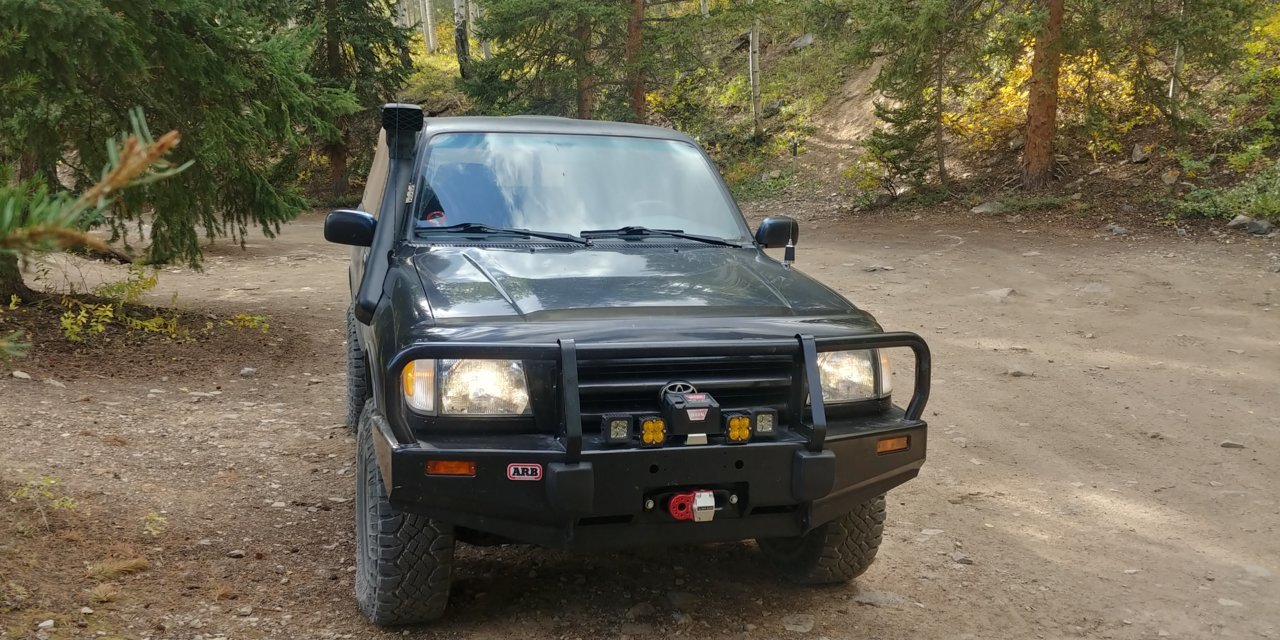

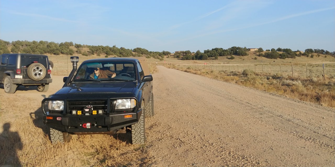

    A couple weekends ago we took a trip up Schofield pass to Emerald lake. Then decided to head back down through the Paradise divide and down by Oh Be Joyful

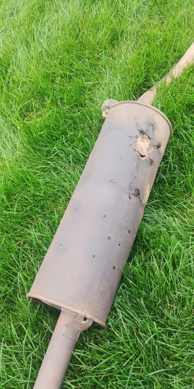

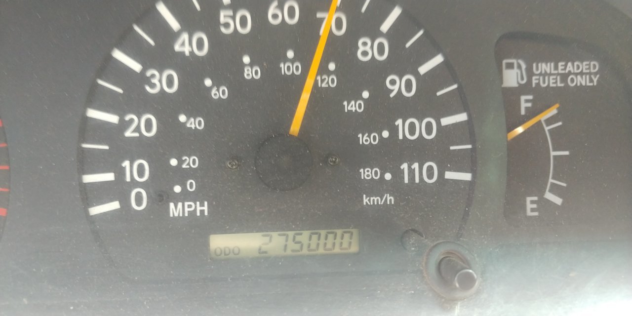

    Happy Birthday to Burt! 275,000 Miles!

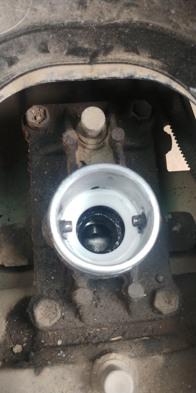

    It is time for a bit of maintenance.
    In the last couple thousand miles, I started to notice the temp gauge slightly climbing after long climbs into the mountains, I noticed it leaving Denver on 285 that after a few miles the temp gauge would start slightly pointing up. Last time I just "left it because its not overheating" it resulted in a warped head on my Jeep. So I made sure that I was going to take care of this asap.
    To do that I did a few things:
    A full coolant flush, I ended up flushing it 3 times because the PO put green coolant in after I presume the radiator cracked since it was replaced at some point.
    I changed out the Thermostat as I found it looked to be the original and was pretty crusty from the years of green coolant.

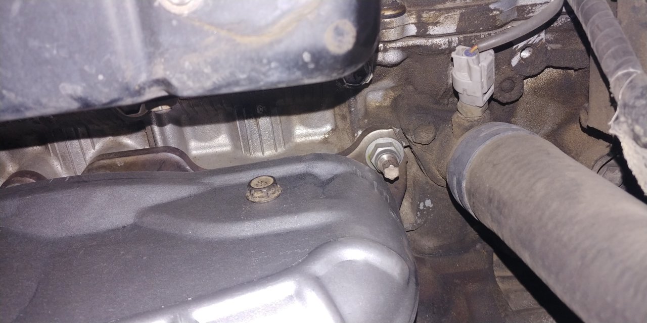

    And I finally put a Heatshield on the header, which cylinder 1 conveniently is about 3" from the Coolant Temp Sensor, which after a few miles at 3000rpm probably doesn't help the situation.
    So after all that. In the places Burt usually got warm, the temp gauge stayed rock solid no matter how hard I was running the motor. WIN!

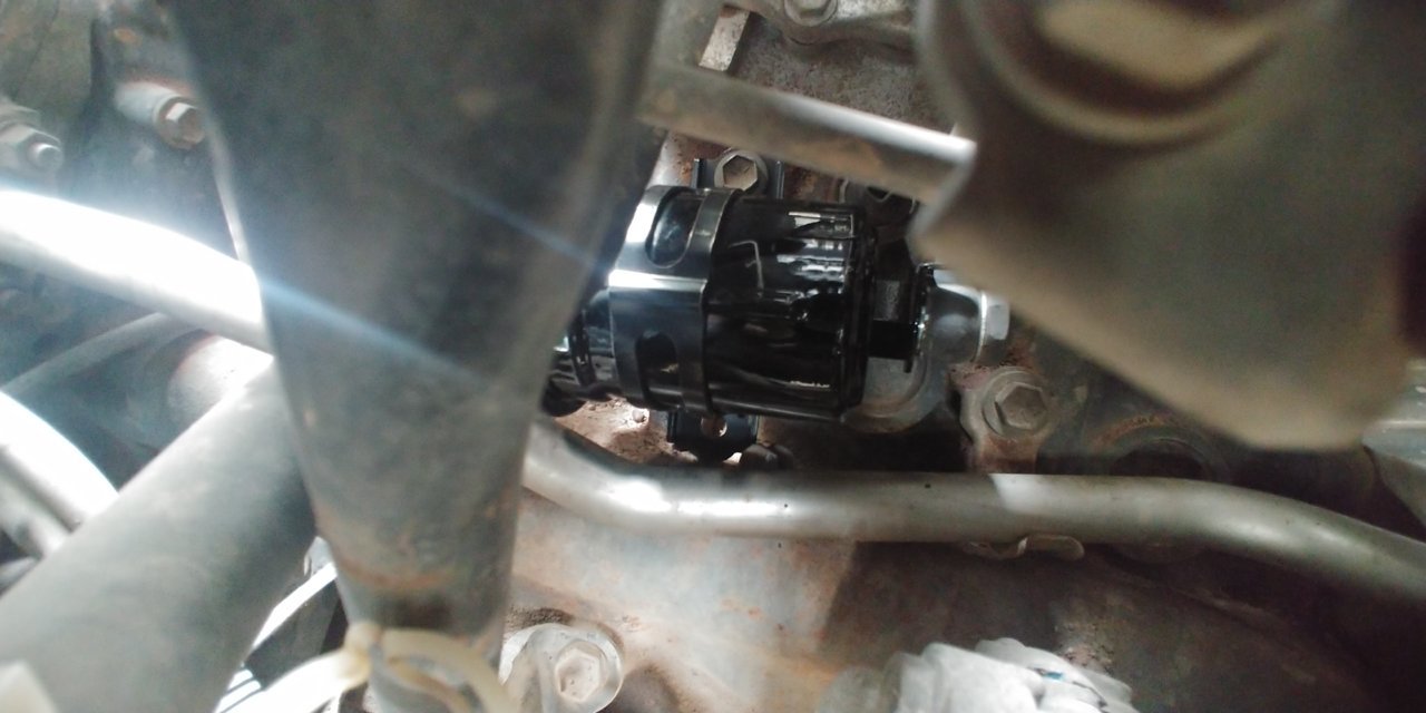

    Next Up, I thought that it was about time to do a fuel filter, not a hard job but a bit of a pain to do. I think that the fuel filter is the original, as they normally don't get changed too often.
    Next up, Sloppy shifter bushings, as with most first gens. My shifter had the same amount of play in gear as it did in neutral. So I put in a new Marlin Crawler heavy duty shifter seat to replace the rubber crumbs that came out of the trans. And a New OEM lower shifter bushing to replace the heavily grooved one. Burt now feels better than any new Tacoma I have ever driven, similar to a Subaru STI trans with how notchy the new set up is. Its so much easier to grab gears on a climb.
    I Highly recommend this to any first gen owners, its cheap too, around $25 for both bushings and about a half hour worth of time, and a Philips head screwdriver.
    DO IT!

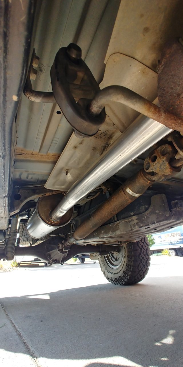

    A New Exhaust since mine has slowly been falling apart since before I owned it.
    After

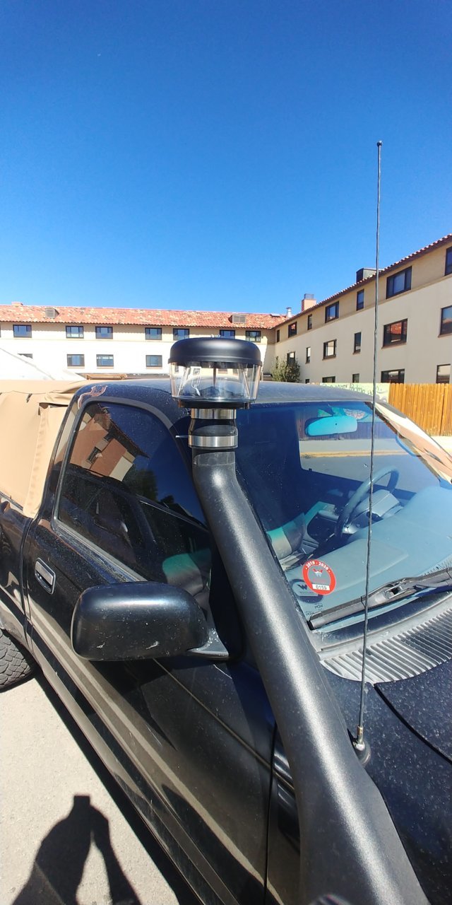

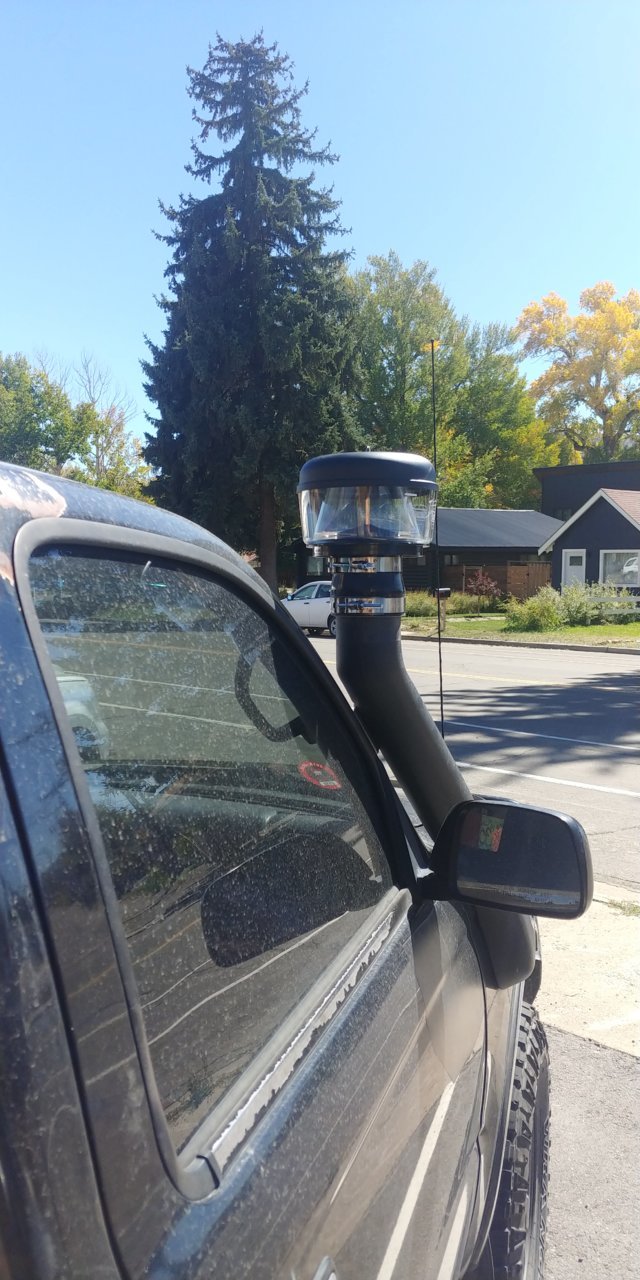

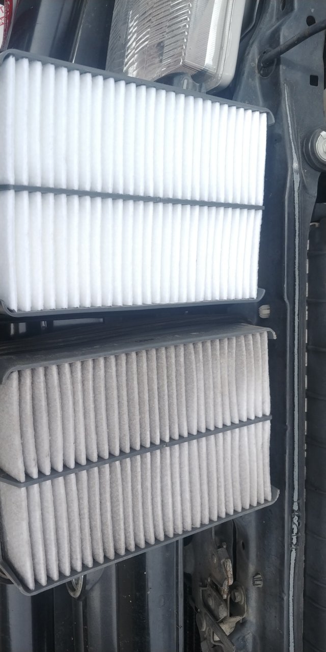

    Then the Usual Oil Change (I do 5k) and Air Filter Change (15k or until roached by dust)

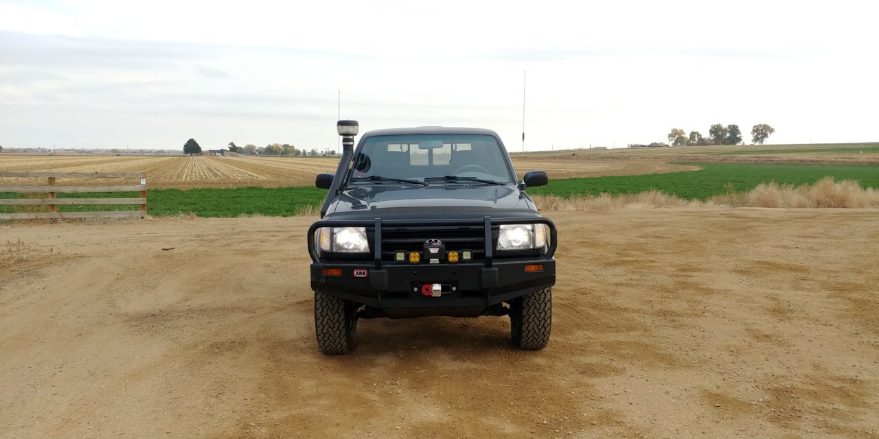

    the old filter had 9k on it and was gone. All the fires in Colorado have meant that Burt's been sucking in lots of ash, and being that I try to hit dirt at least once a week, I have been going through filters quickly, even with the Snorkel.

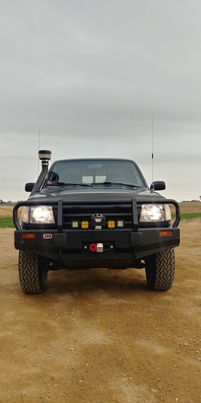

    On the topic of snorkels, to reduce the crap sucked in, especially insects, specifically large insects:annoyed: I decided to switch it up to a cyclone pre-filter.
    I'll report back how long it takes to fill this with crap and how well it does when the snow comes.

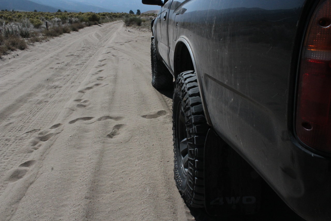

    1004201054.jpg It was prime leaf viewing time, mixed with a few nice water crossings it is a trail that I highly recommend.

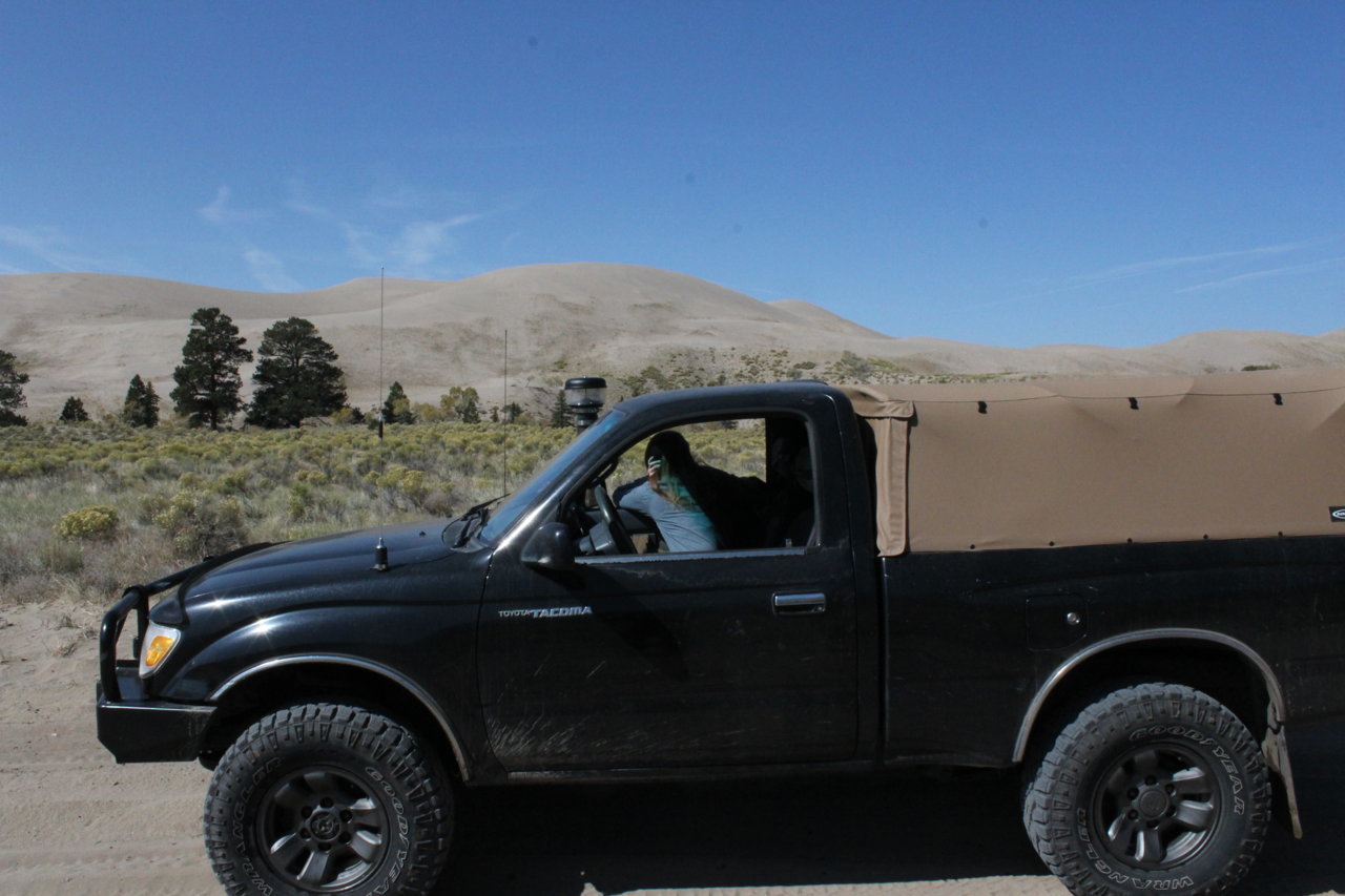

    IMG_5862.jpg Made it to the Dunes! Sorry about some of the photos being a bit crap, I haven't used my DSLR in a while and I think I didn't have it in the right mode.
    IMG_5864.jpg Duratracs down at 8psi, with a light truck the sand was not an issue. Burt floated over even the deepest sections. 3rd Lo was the best mix of power and control on these tracks.

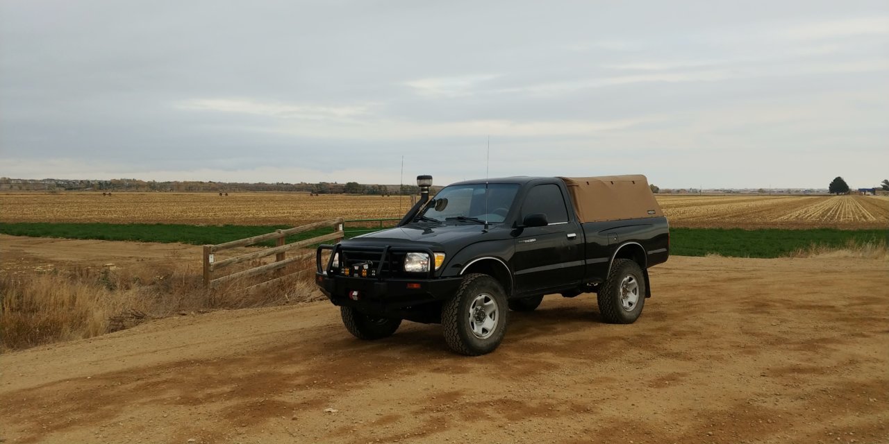

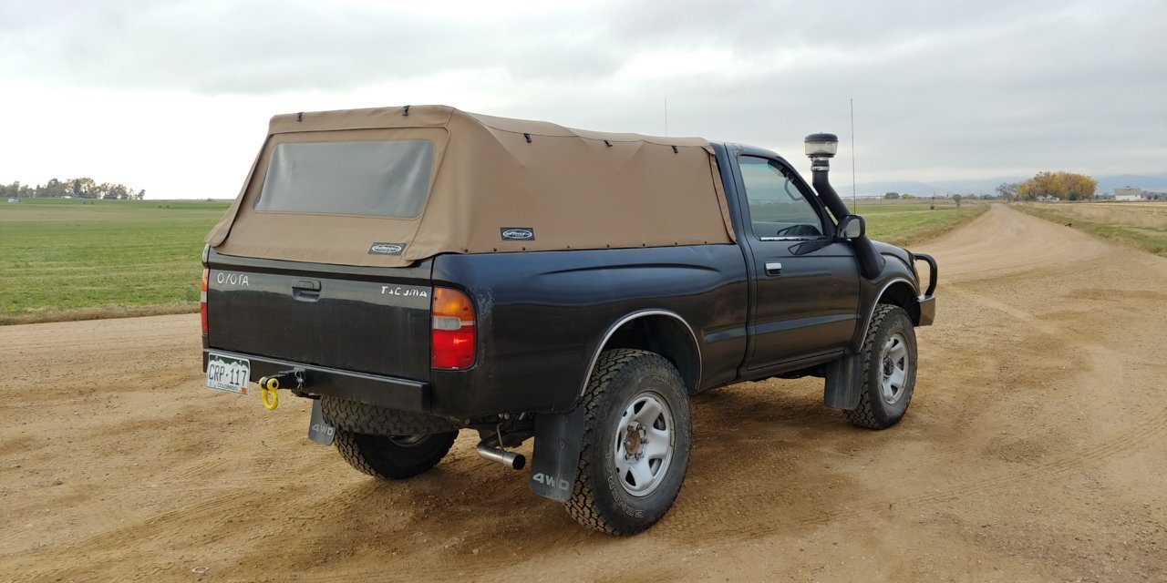

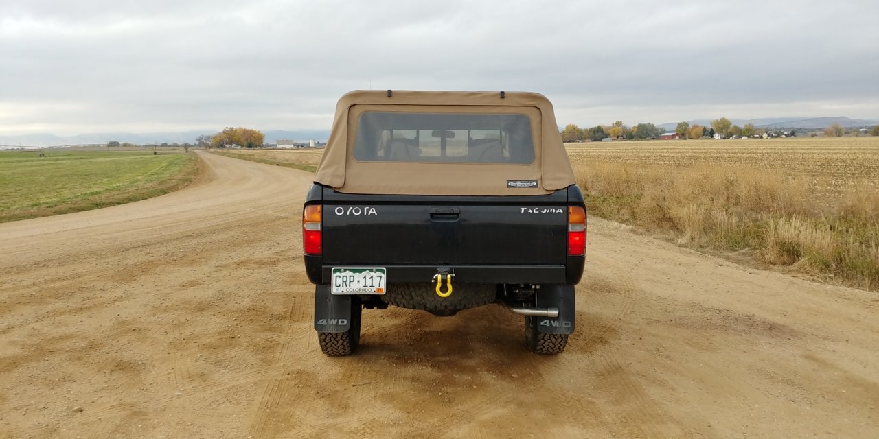

    On the topic of the 235/85r16s. I actually mounted them back on the truck for a kick to see how they looked with the build.
    1018201540.jpg 1018201540a.jpg 1018201541_HDR.jpg 1018201541a_HDR.jpg 1018201541b_HDR.jpg 1018201541c_HDR.jpg 1018201541d_HDR.jpg 1018201542.jpg
    They look good, I always loved the tall skinny look. But after using C-load Duratracs the last 16,000 miles. Those E-load Generals rode extremely rough, smooth in terms of the rolling resistance but rough as hell on any bumps.
    I'm still surprised at the amount of tread left on these Generals after 40,000 miles (ish).
    If only they made that size in a C-Load they would be on Burt right away.

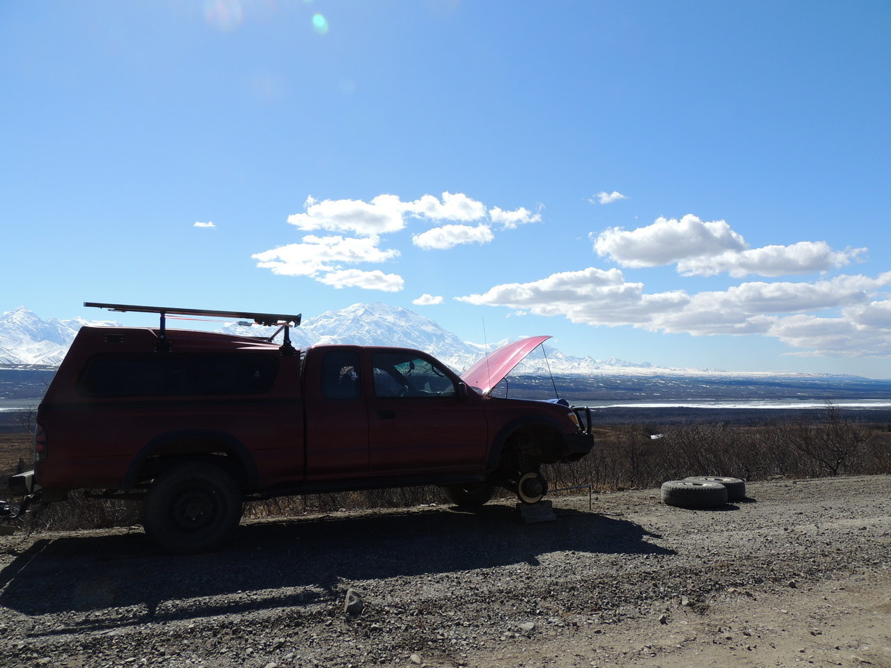

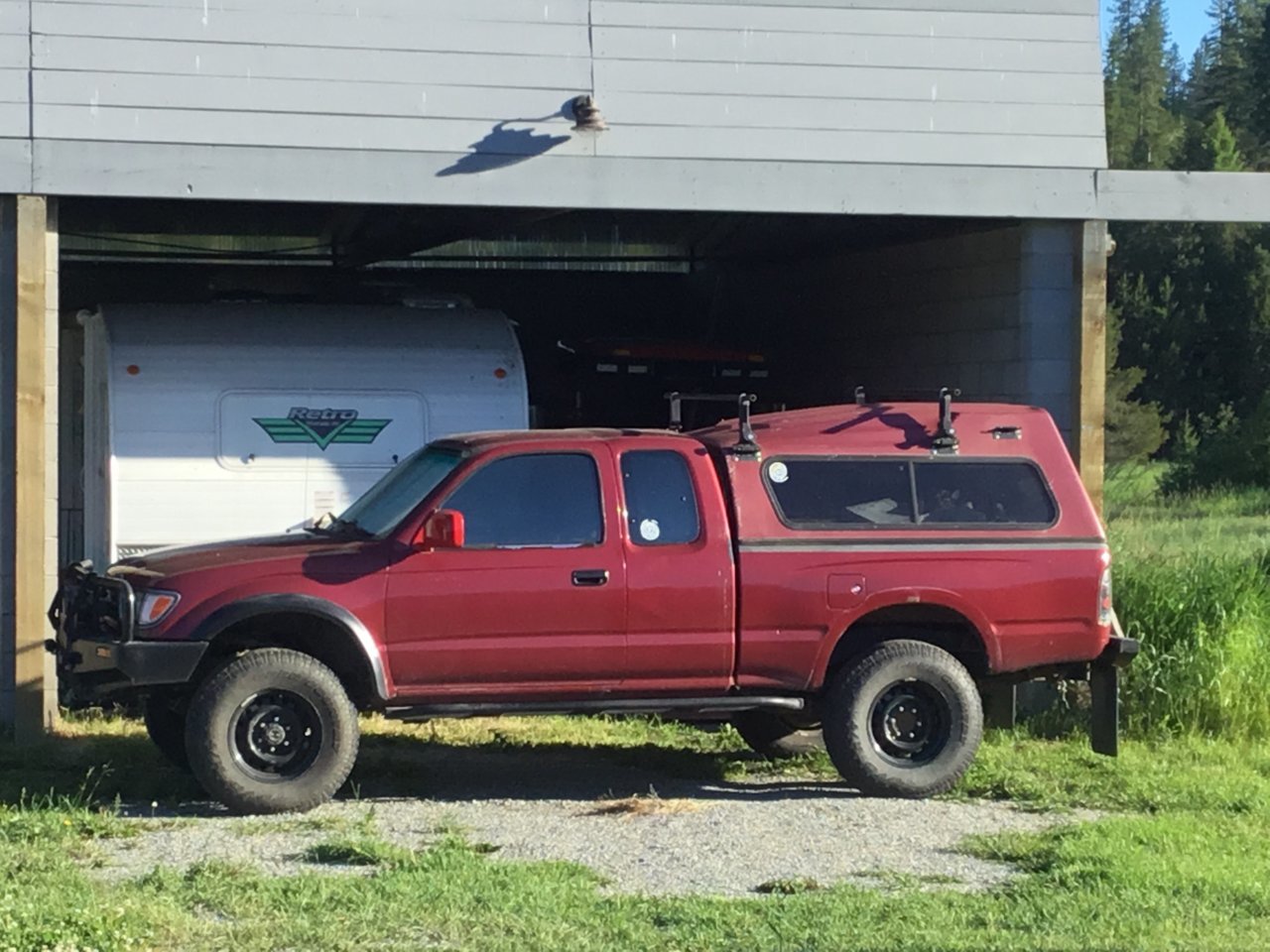

    They do look pretty good, not fond of those early steelies, they always held chunks of ice that made life way to interesting. I hear you on the load range C tires, I would like to be able to go with that light of a tire but they don’t hold up in my commute:
    The road eats lesser tires. Here I am heading out to work for the season, day one- 2 flats.
    Withe these wheels and the Toyos, should be good for awhile, I finally found these 16x7 and swapped the. 8” Tundra wheel for another set, might put them on the 85, or use them for studded winter tire.
