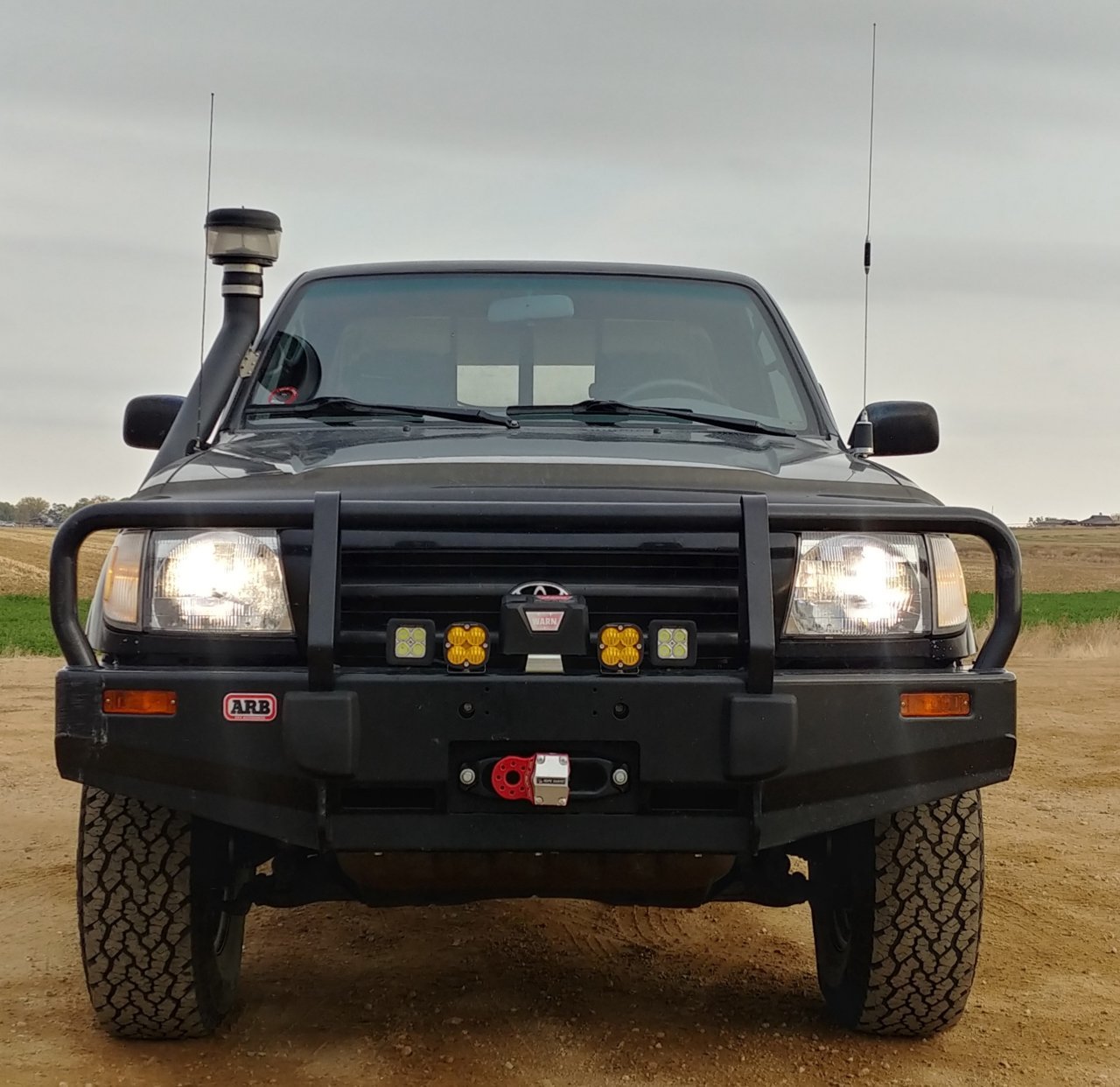

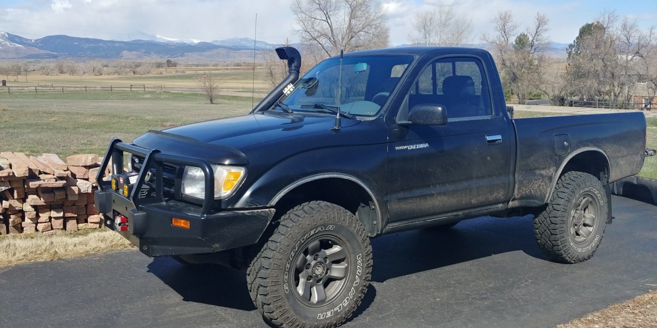

    Yup, and it can be seen pretty easily when I switch from the 2nd gen wheels to the 1st gen wheels. The center line of the tire is that 3/4" farther out with the 1st gen wheels.

    No the last picture is the 1st gen alloy wheels they are the 15x7s with the 31x10.50s 0325201104_HDR.jpg
    DJB1 and jubei like this.

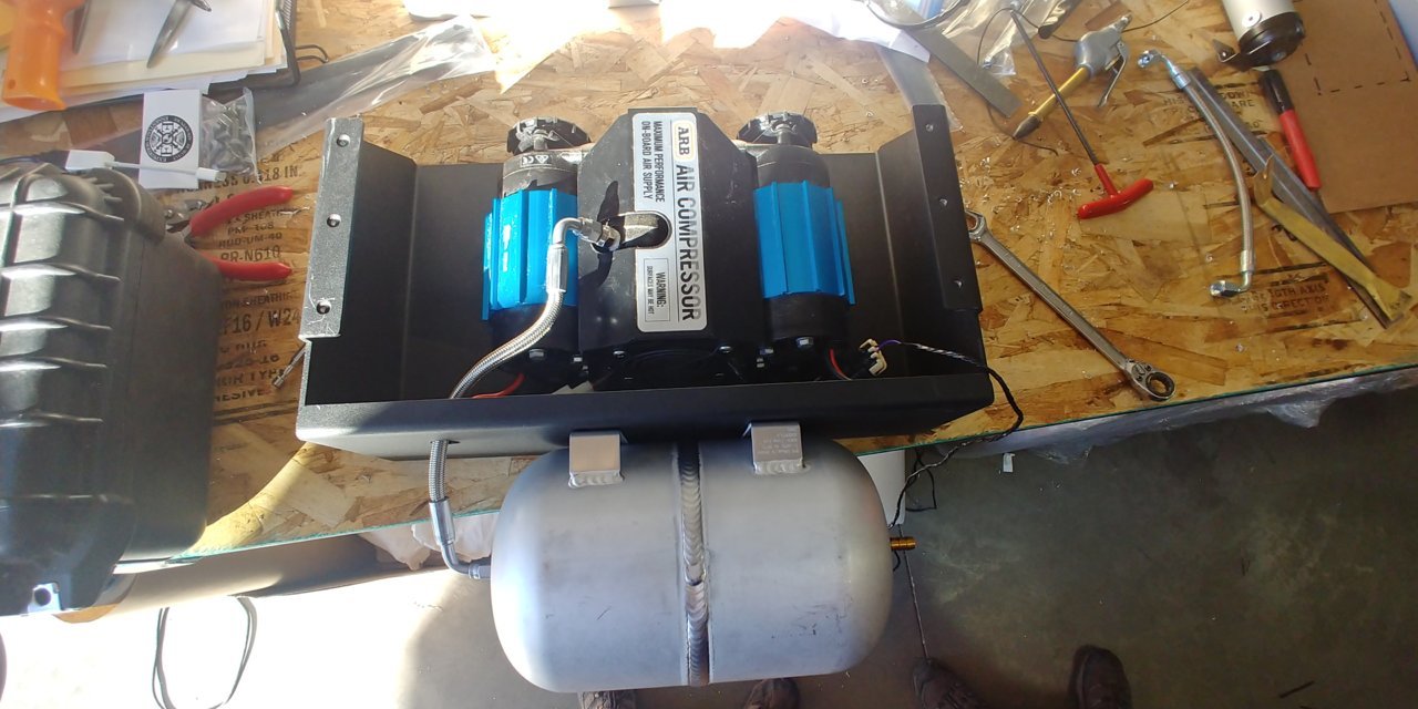

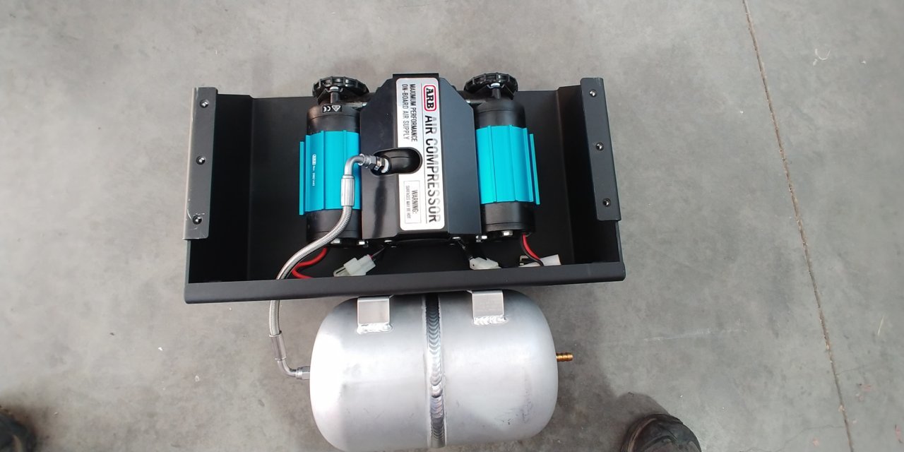

    I went down last weekend to help install a OGE dual battery system in this 08 Tacoma, along with a Arb Dual Compressor and Air Tank on an Expedition Essentials Bed Cubby Mount.

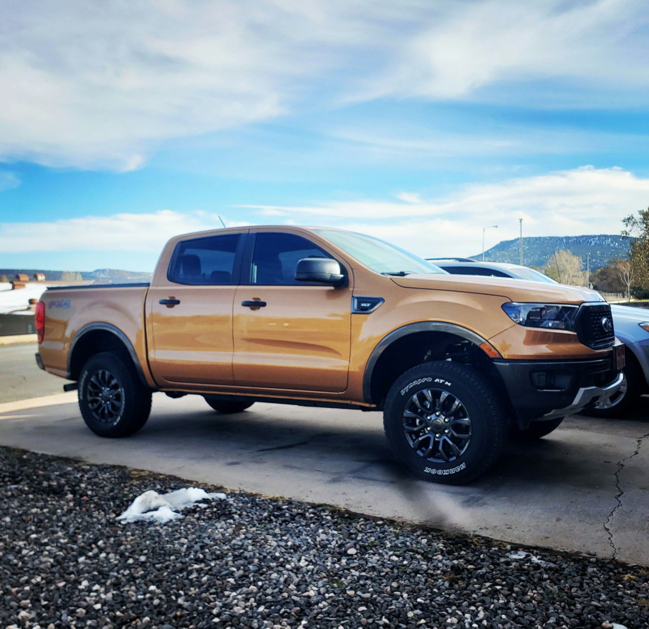

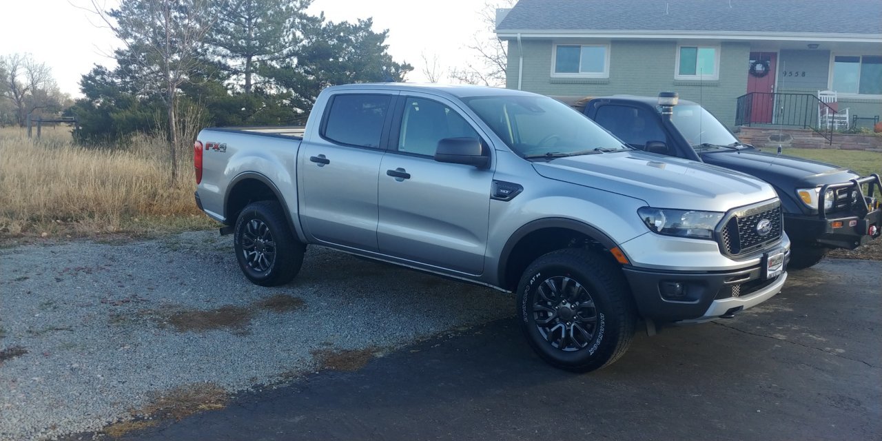

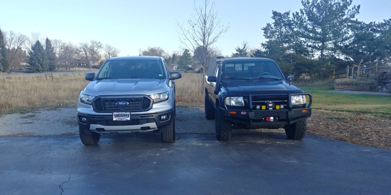

  12. Nov 21, 2020 at 9:30 PM
    #212
    CoWj
    CoWj [OP] Lost and Found at the same time.
    Feb 8, 2019
    #282309
    803
    Wyatt
    Northern CO
    Burt: 1998 2.7 Regular 5 speed 4x4
    Bilstein 5100, ARB Bumper, Warn VR EVO 8, 34x10.50 Toyo 4.88s ARB Locker
    Burt got to meet his new companion today.
    DJB1, aknickyota22 and Phessor like this.

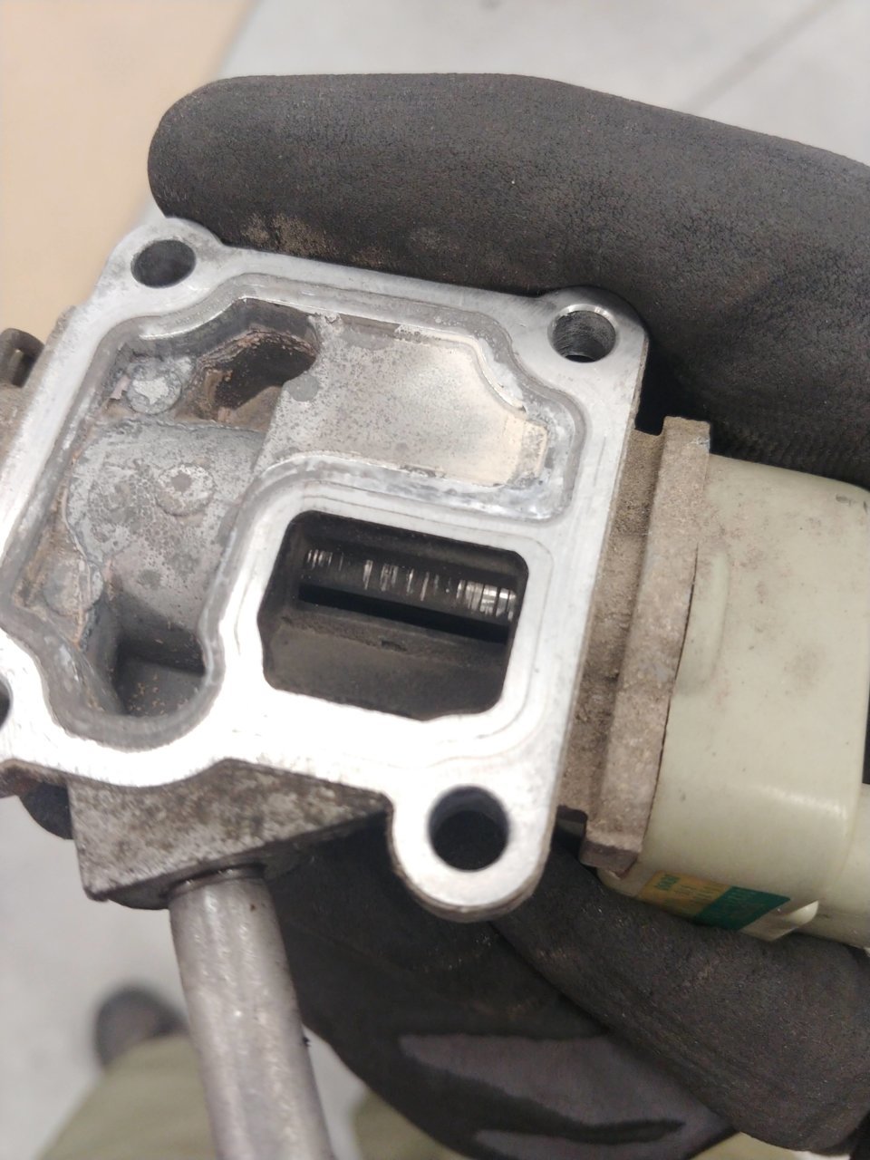

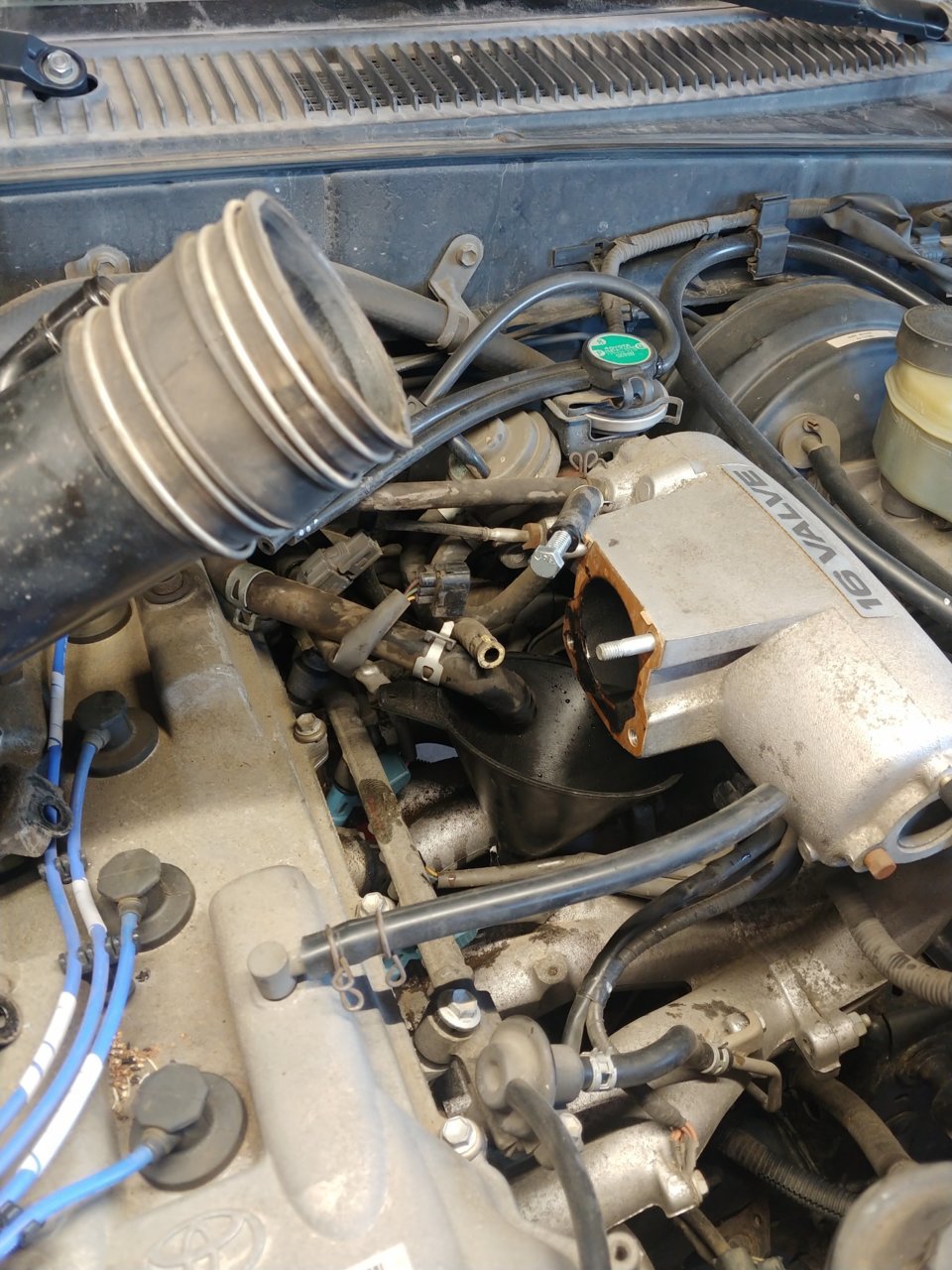

    Been a bit absent from the forum lately with work and other things. So here is a bit on an update.
    Burt has taken a bit of a side spot now, with having the new ranger, and going to work and back. The Ranger is just so much nicer to have for commuting every dat, especially since I am in my final semester at school, and every other weekend I am driving 8+ hours down to work.

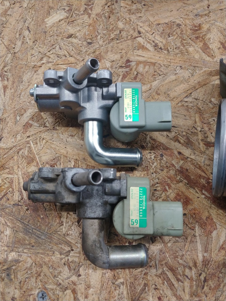

    Burt is also still having the rough start issue and is feeling down on power from what little it had to start. I am starting to suspect either a cracked head, or a lose of compression in some other way.
    My dad has been driving Burt around a bit lately and is also finding some other issues that I was already aware of. So I think come this summer its finally time to do a bunch of work to Burt, now that I have the ranger as a daily and an overland rig, but can turn more into a resto project for the next while. I still plan on keeping Burt for a long long time, but Burt might not be getting a lot of work or going out of trips for a couple months. I need to figure out the best plan of action and where to take the truck for now.
    In my search to find what was wrong I ended up replacing the IAC and while it helped it wasn't the be all end all. It definitely wasn't functioning perfectly and seems like it was binding.
    In looking at it, I learned a very interesting thing that leads to these failures. Dust, and not just dust, the IAC is operated by magnets, meaning over time the steel valve also becomes magnetic, thus allowing any piece of magnetic dust to stick to it. Making it heavier, and bind up eventually leading to failure. So Keep the Air Filter Clean, and make sure there are no leaks! I presume over the 278,000 miles tiny bits of dust have slowly made their way into the intake and thus the magnetic material ended up on the IAC.

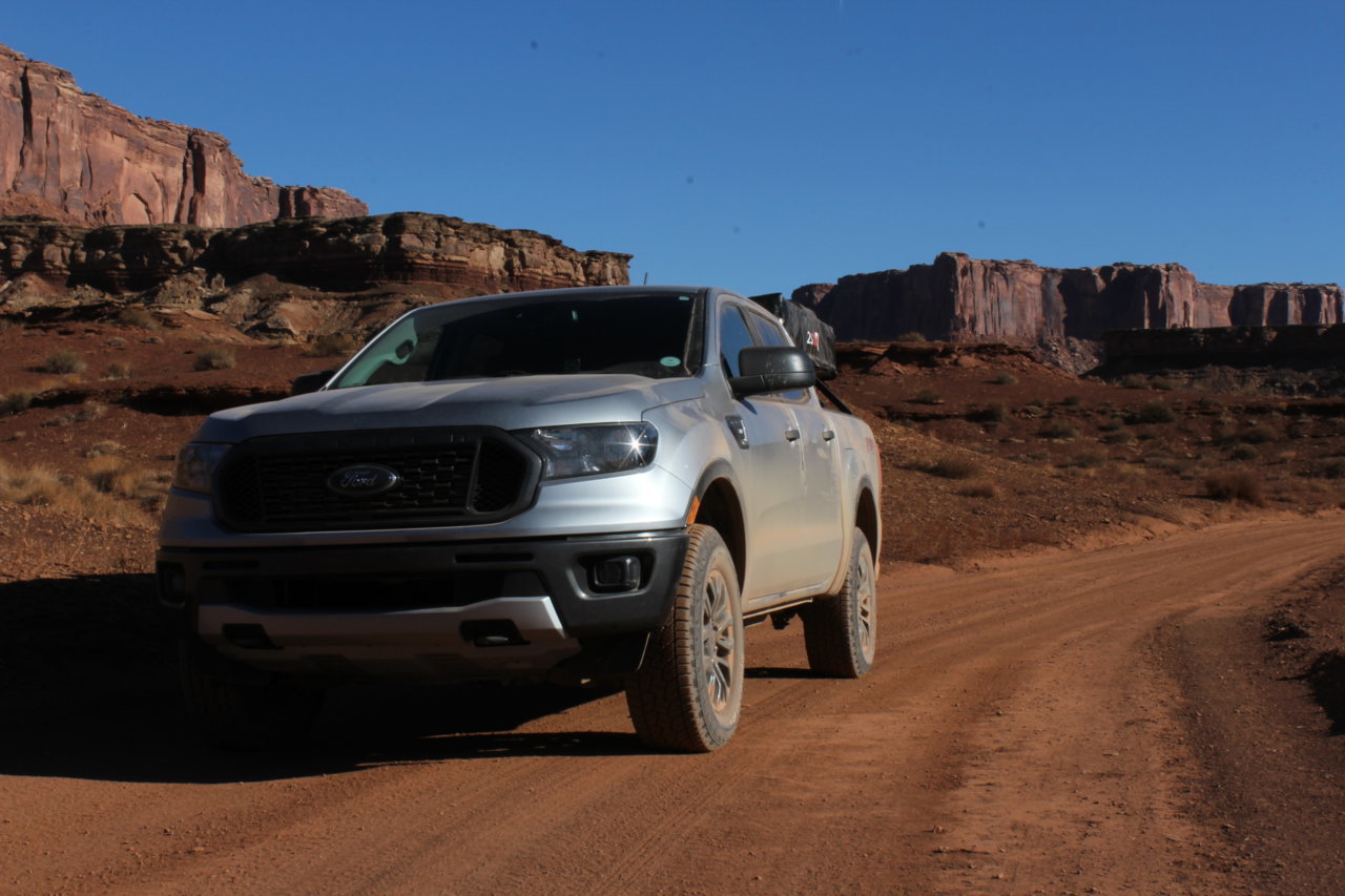

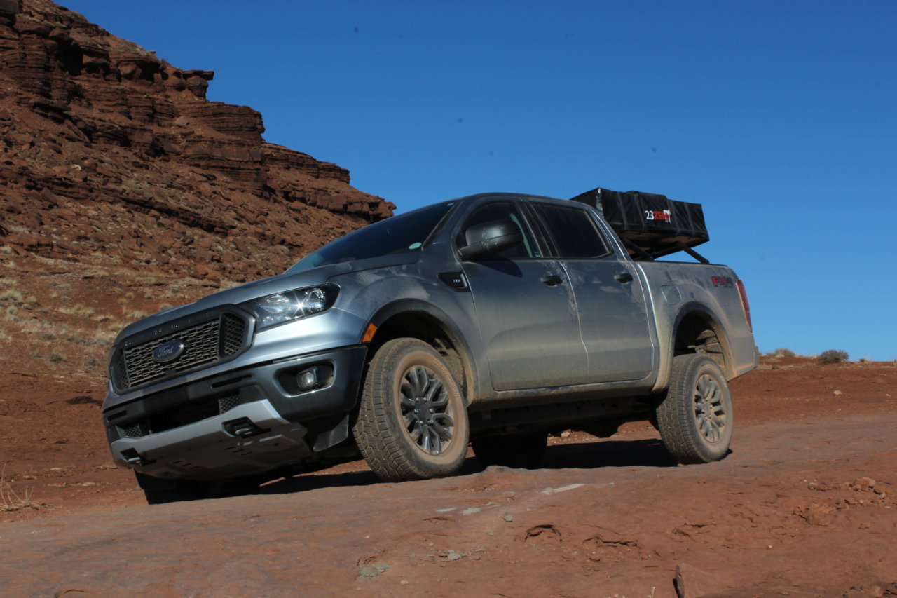

    I did get to take a trip to the White Rim, but with the ranger due to Burt not quite running right and being a very slow vehicle to drive. While I would have preferred to have Burt on the trails, I really did prefer the having the Ranger for the 1000 road miles there and back. It's nice to be able to not only keep the speed limit of the mountain passes, but be able to haul a$$ if I have to pass someone.
    Seriously, these Rangers are stupid fast, and do it so effortlessly, I have driven 2nd and 3rd gen Tacoma's, and they almost always are sitting in the 3-4k rpm range up these hill, the ranger can sit a 2k in 9th or 8th gear, and can pass people with just a slightly push of the gas and not even needing to downshift.
    But I digress, it was a good trip and it was nice to return 5 years after my first time on the trail. I think next time I do the trail, I want to try to do it in one day on my KTM.

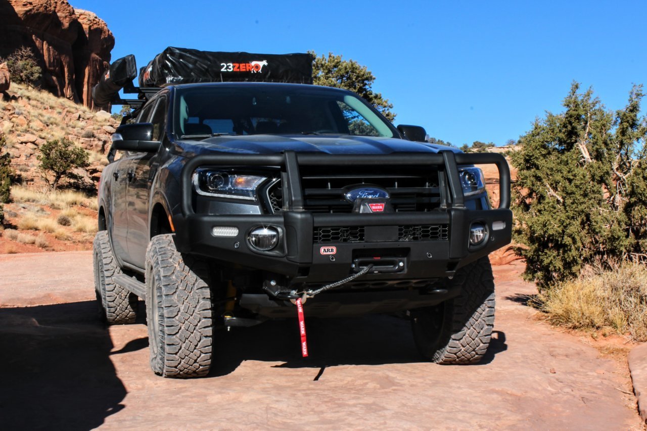

    IMG_5889.jpg IMG_5892.jpg IMG_5894 (1).jpg IMG_5904 (2).jpg IMG_5907.jpg IMG_5919.jpg IMG_5951.jpg IMG_5963.jpg IMG_5970.jpg
    jubei, DJB1 and Phessor like this.
