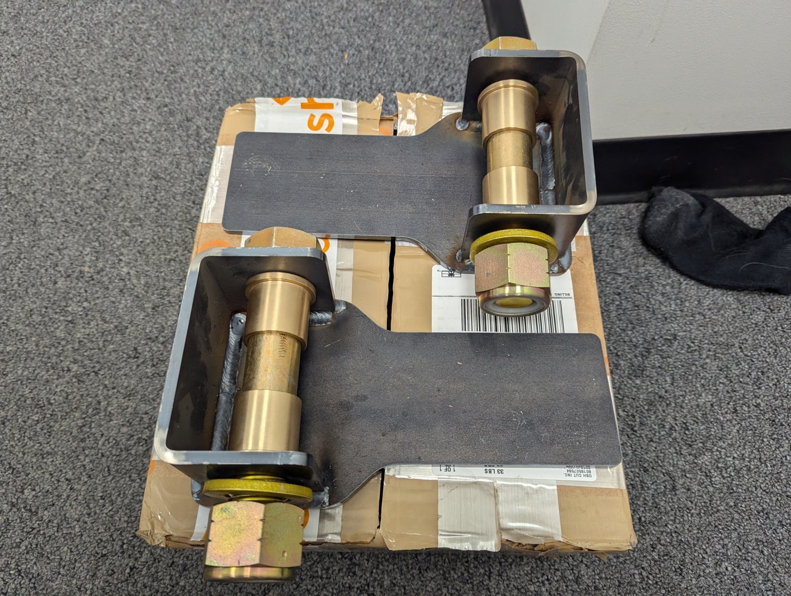

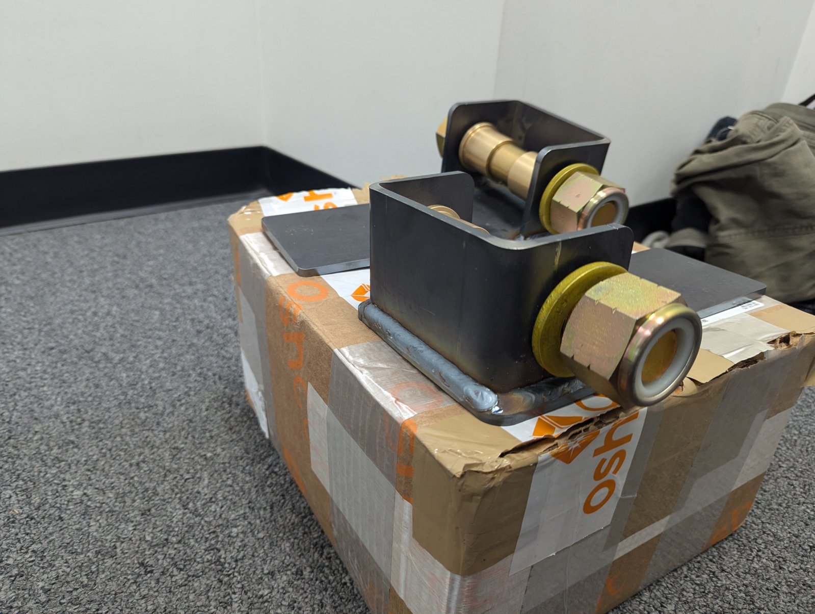

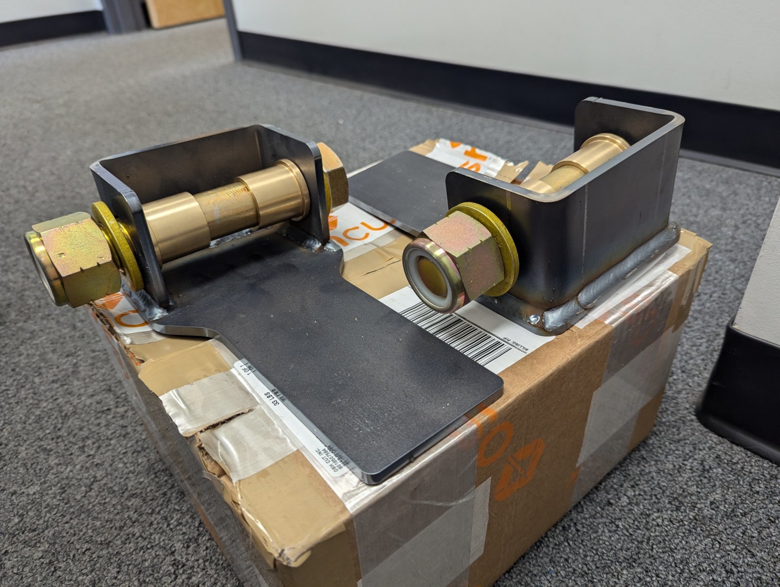

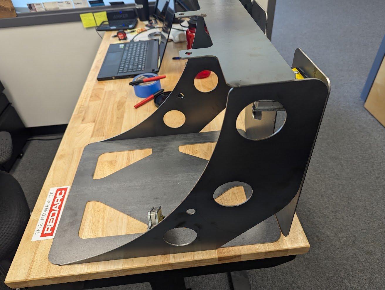

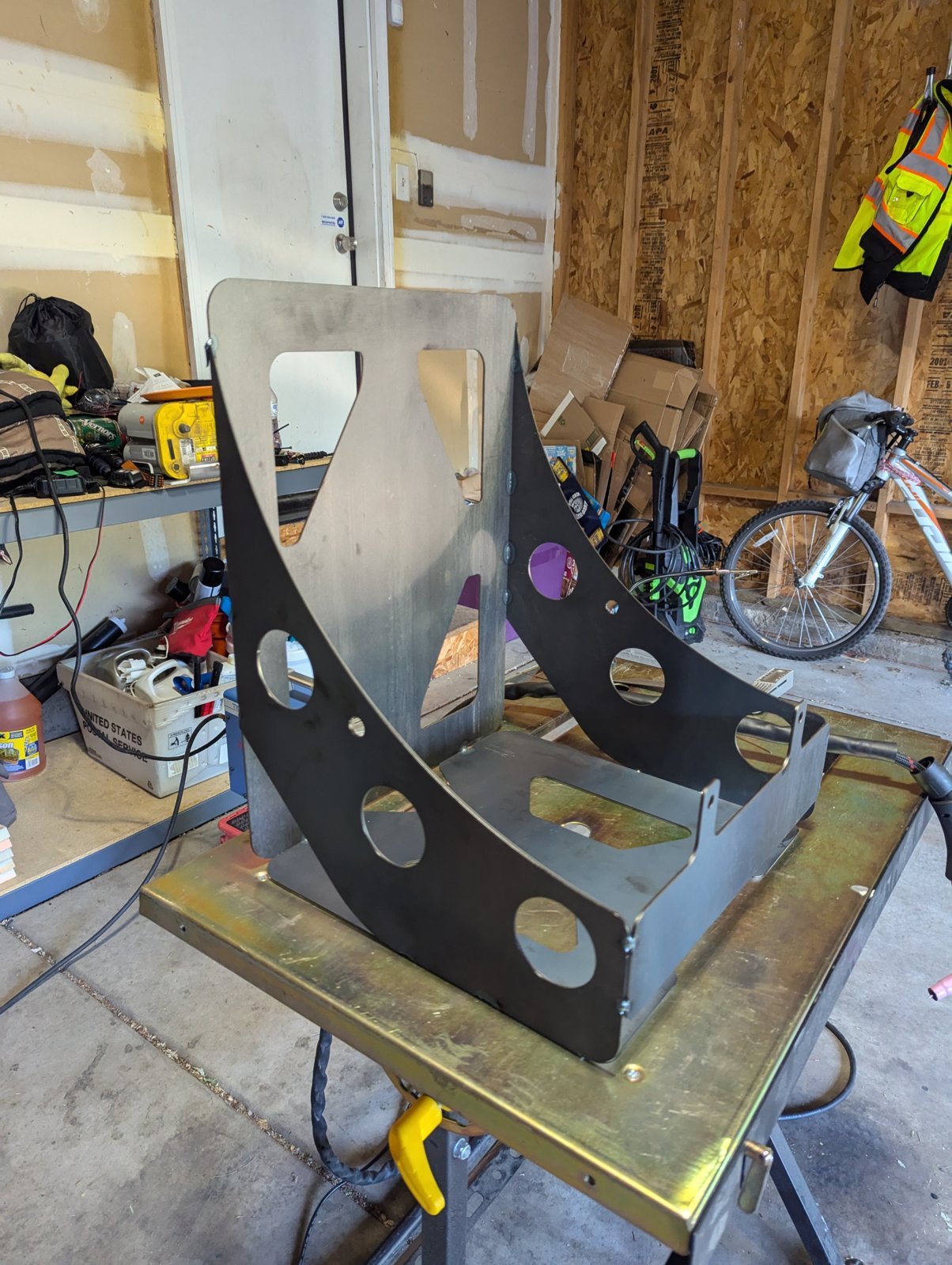

    Got my Laser cut pieces in for my Dual Swing out build.
    Build a dual Jerry holder that it wide enough to Nato Style, Scepter Style, Water cans, ECT. I plan to use a dense foam to take up any additional space and use a ratchet strap to hold them in place.
    The CAn Holder is .12" and I plan to Tig it together to practice.
    AP1GczPQoPlzx24H6Pe5PDHNUi7vE1fwTC6uji4N_6d8579cc5f2b7963252daa355e04833bef0e523c.jpg
    1/4 Cut and Bent bracket that Keys into the back plate that will get welded to the bumper.
    7" 1.25" Grade 8 Bolt, 1.5" OD Bushings, that will go into 2" .25" wall DOM Tube to make the hinge. I expect these to wear out about every 2-3 years.
    All the 1/4" Steel will be MIG welded

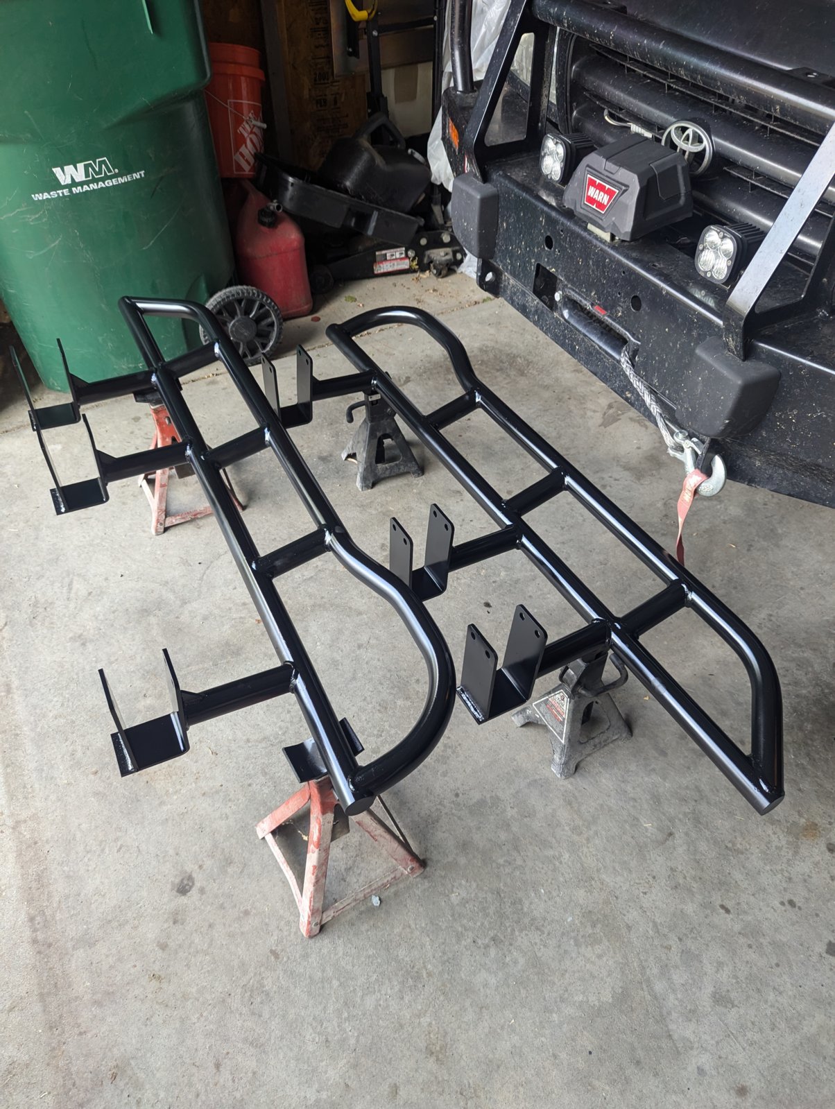

    Worked more on the sliders tonight, Got the Mounts welded and the sliders tacked into place on them to unfortunately run out of Wire on the Mig. Just my luck yesterday. I designed them to be able be able to adjust to the width of the frome in any location that they would fit. I have 3 frame mounts on each side, the front being much wider then the rear two and the middle one being a hair widers that the rear most. So I mocked them up, clamped them in place and welded them up to fit the frame. It works pretty well.

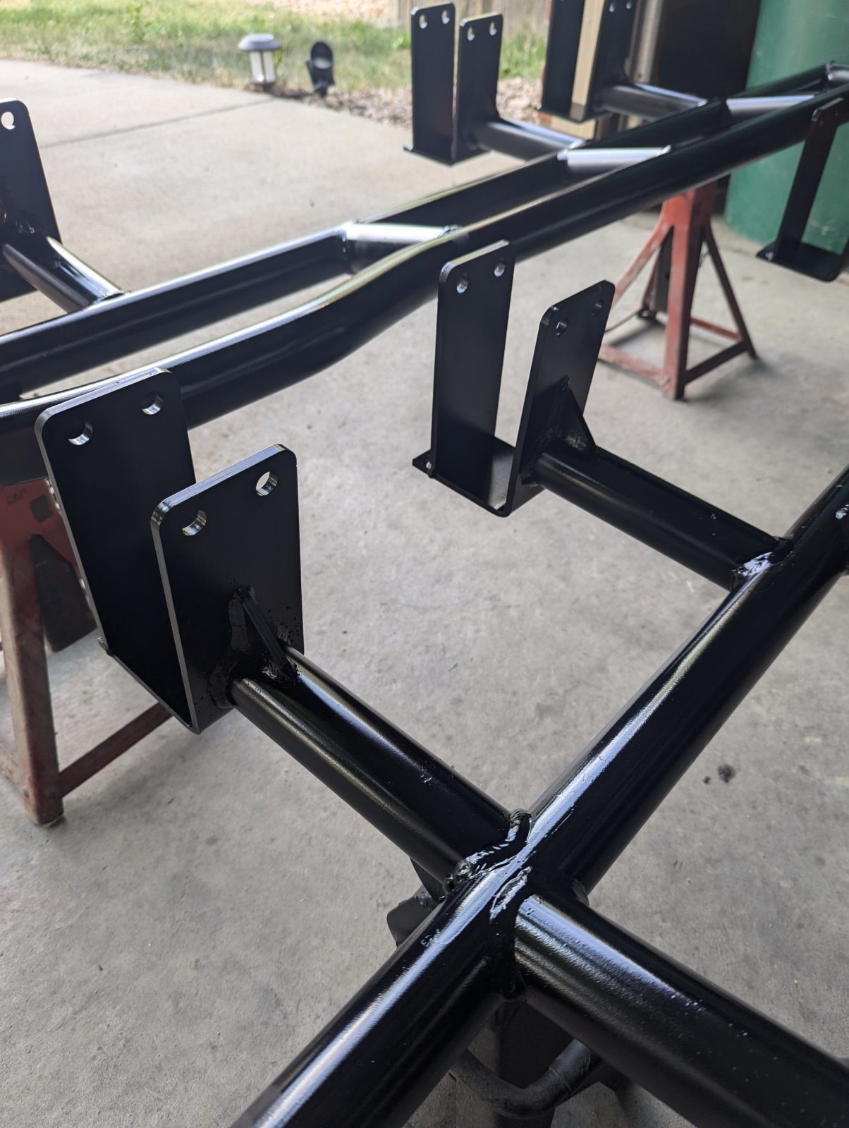

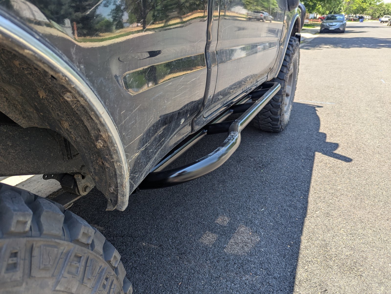

    Grabbed my Mig this morning and brought it to work. Been a couple years since I used that being without 220v at my current house.
    But I was able to knock out the sliders at lunch, slap a coat of paint on them at work and once again at home.
    They will cure tonight and be ready to go on tomorrow and hopefully hit the first rocks tomorrow afternoon.
    I'm very pleased with how they came out.
    They clamp the frame using 1/2 grade 8 flange bolts and nylock flange nuts.

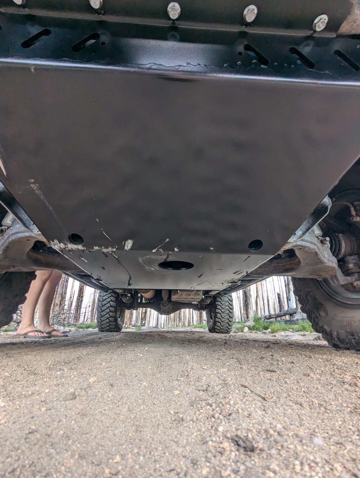

    We got out Friday and Saturday in Northern Colorado to a local spot. It was supposed to be 102 at the house so the mountains and 87 sounded much better.
    I woke up early to get the grass watered and to finish the install of my rock sliders that I had finished on Thursday and painted for Fridays install. The Cradle Mounted worked perfectly and the sliders are super stout, I can also pull them off in about 45 minutes to repaint them.
    They fit right up thankfully.
    The Nice Black Paint Lasted all off 4 hours before we were on the trail sitting on the sliders.

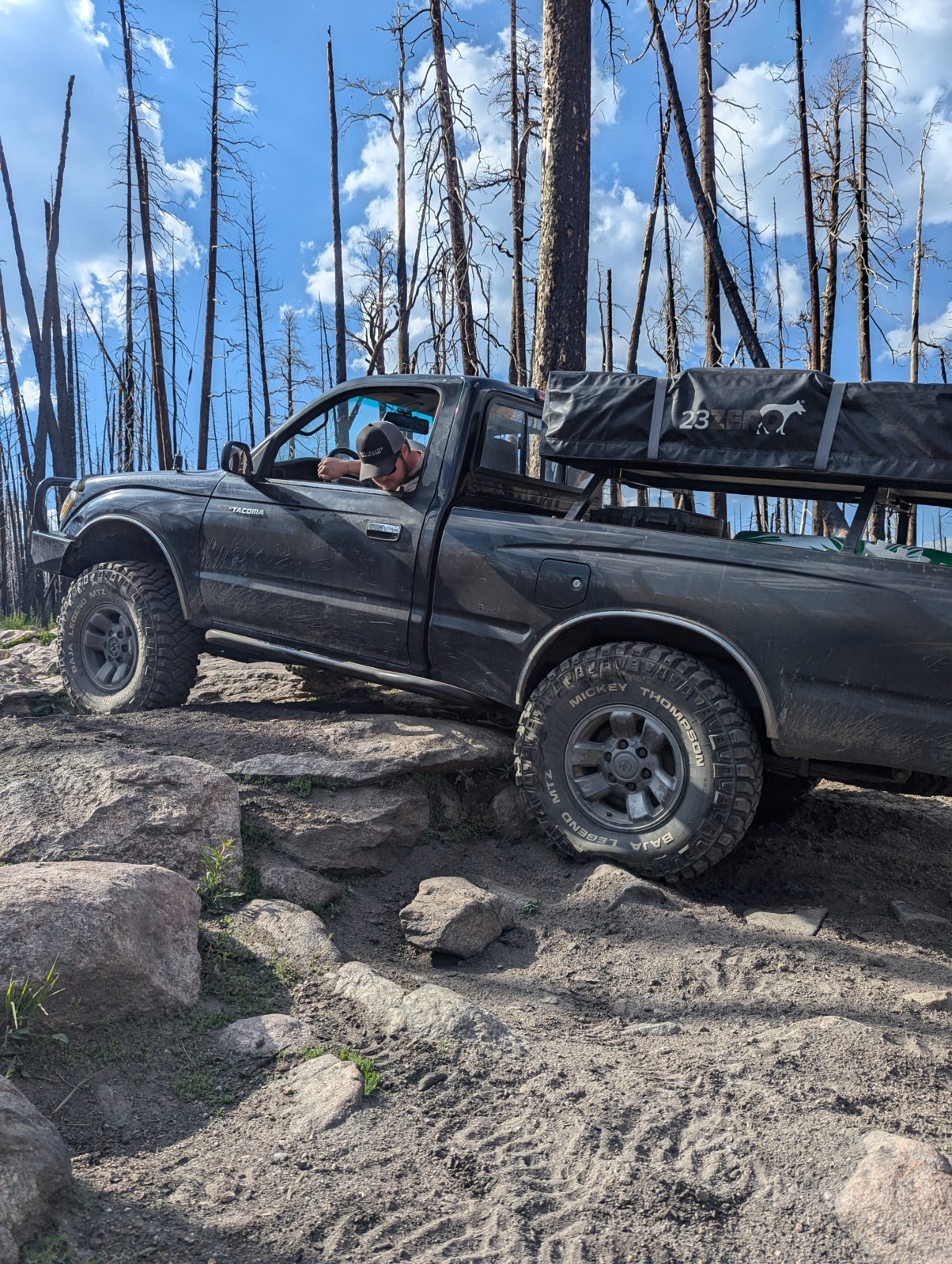

    We headed up Bald Mountain a 7/10 here and one I hadn't done before. But I figured I have new armor and a trail that's basically a boulder field would be a good test trail for them.
    Not the first hit but a nice slide on the IFS Skid.
    Then to a Ledge.
    With a Hair of tire spin as the truck walked passenger as we went up.
    Fresh Paint didn't last very long as we got a nice slide along this rock, a couple times.
    Skids also got a few tags.

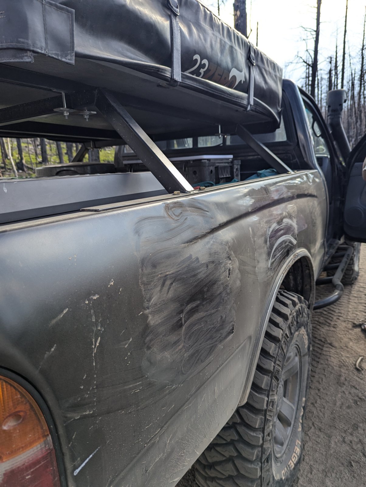

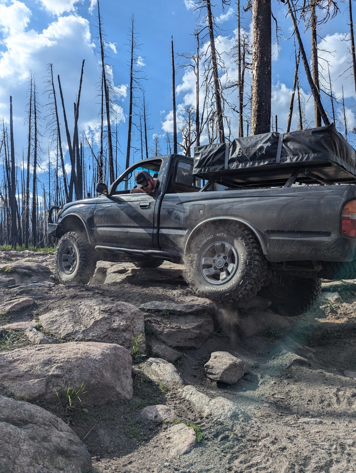

    On Bald Mountain we did end up getting a little close to a tree. A rock pitched us over to the passenger side and we tagged the snorkel, mirror and the side of the bed. Right in my newly repaired paint. :annoyed:
    My Fiancée made it sound like I caved the entire bed in. Luckily that was just an illusion from dust. There is a tiny dent but its honestly not even the largest dent in that panel. A bummer, but I can repaint that side. It did bend the fender flare which made it look much worse.

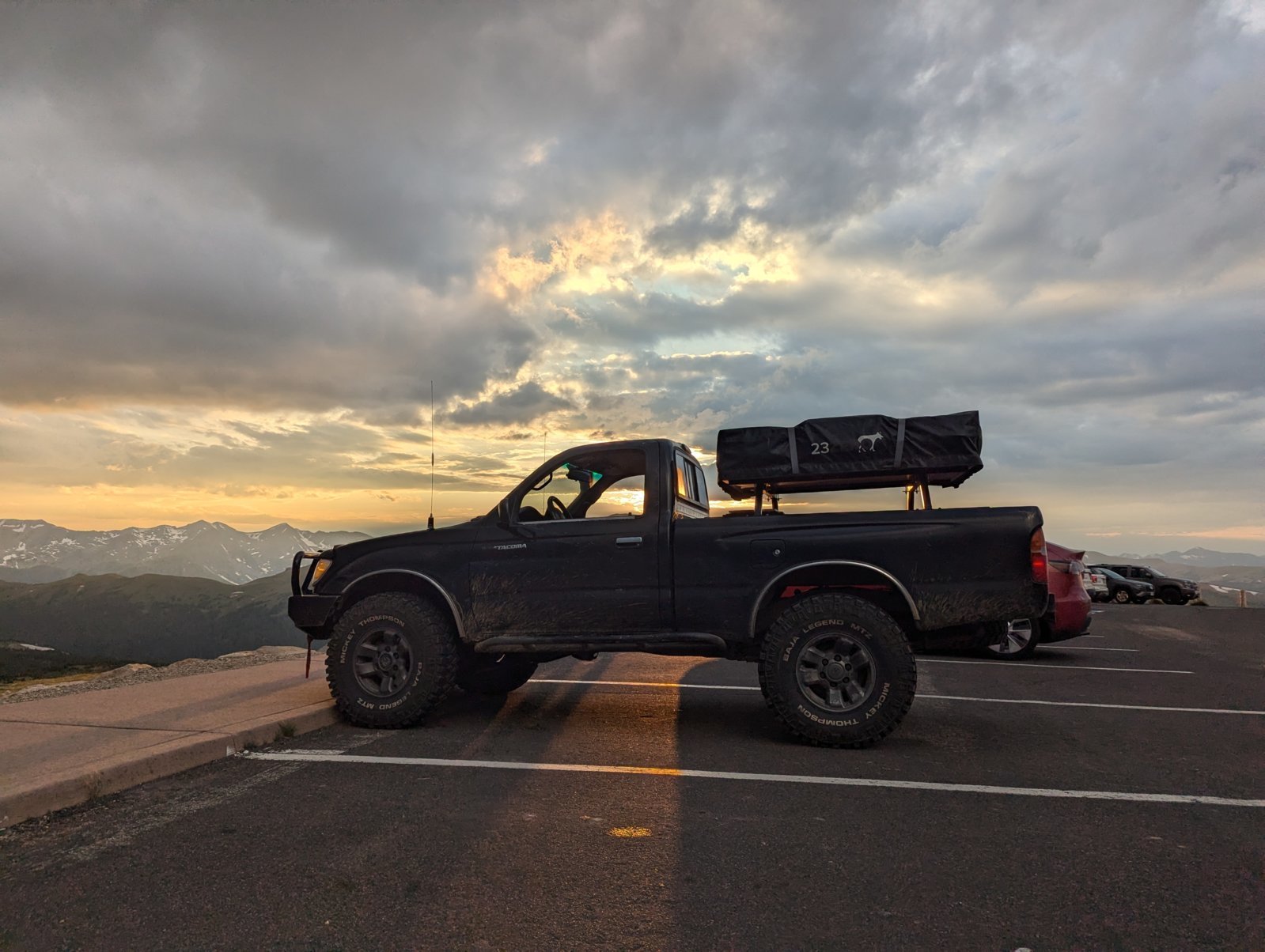

    Its time once again for the annual trip up Old Fall River road in RMNP, its something I have done in burt for almost all 6 years of ownership. I think I missed 2020 cause you know, National parks were zoos for tourists.
    But anyways I have been going up here each year as its the only dirt road really in the park and a nice road to make a sunset cruise out of. So we went up there last night and enjoyed the sunset after a thunderstorm rolled through a half hour before.
    Its really amazing to live an hour from this place.
    Its a fully graded and compacted road so its all for the views and wildlife.
    Still some snow up towards 11,000 feet.
    You end up just a hair under 12,000 feet up towards to top, but a little ways above treeline.
    There are hikes that continue up to a hair under 13,000 but with more storms coming in and the sun setting it was time to head on to the top.
    At the top you are met with some of the best views in the part and you connect back to trail ridge road at the top.
    Of course we stopped to enjoy the sunset.
    It soon was dark and raining so we headed down. Where Burt made it ever closer to the 300K Club.
    Who knows if that will be hit this year or next year. I have been driving it a lot more lately, but it still sits out some of the longer trips.
    Calamity_taco, jubei and Phessor like this.

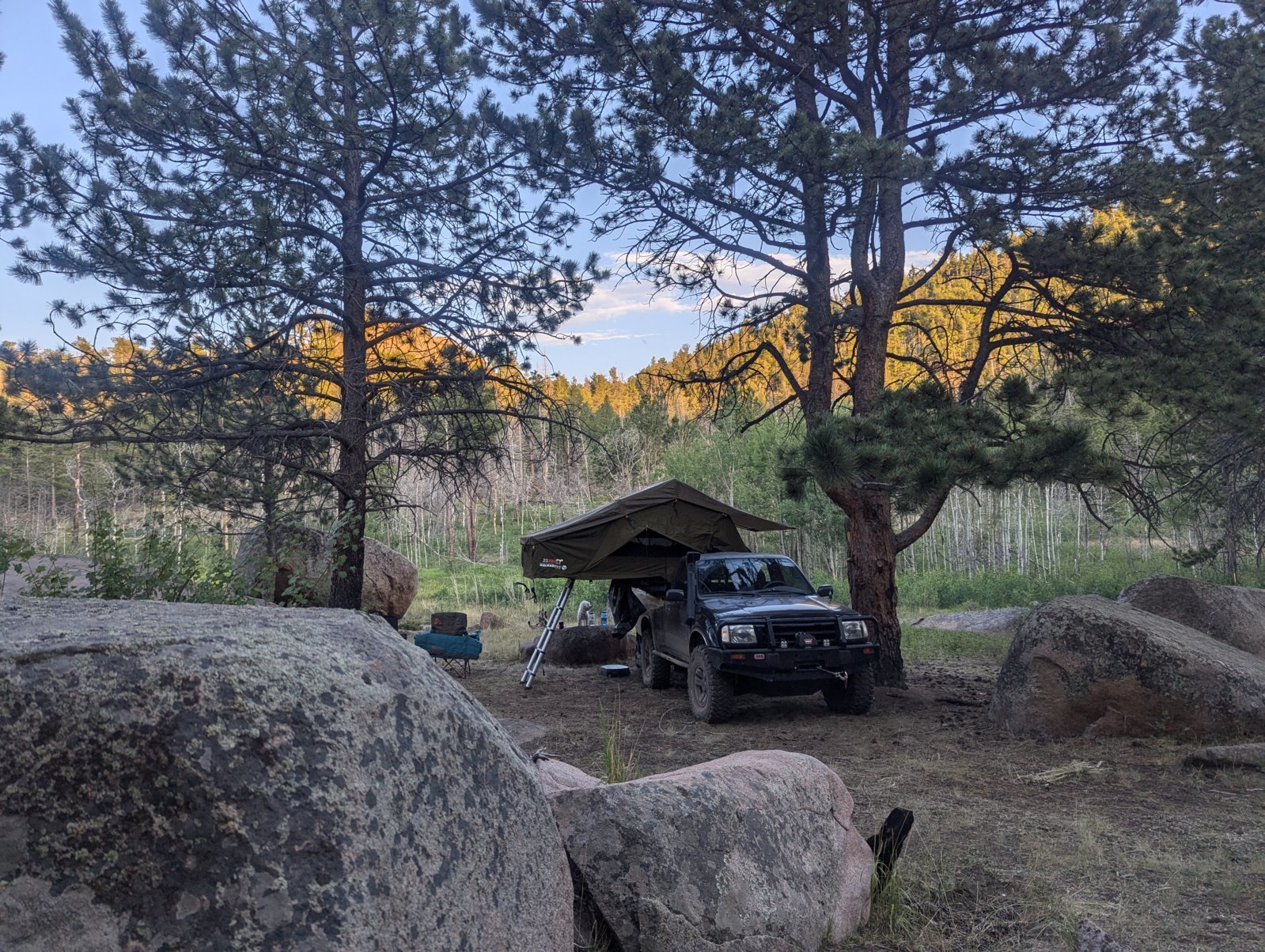

    Went up to the Snowy Range this weekend. Finally got to run a trail I have been wanting to. Unfortunately it is over run by side by sides, which I wasn't super surprised by but was disappointing nonetheless, but we were then able to get out on some named but not rated trails and see nearly no one, even running into some good rock gardens, door deep river crossings and a slider deep mud holes. One of which was too much with at least 2' of silt under the water, that the stick test showed me would shallow the truck, being alone we took the bypass.
    Photos were limited but it was a great overnight and Laramie is a place we are now considering moving as Colorado is pricing us out.
    Coming up to the Snowys is always worth it just for the views.
    If only we hadn't come upon this lake spot at 2pm we would have camped here for sure.

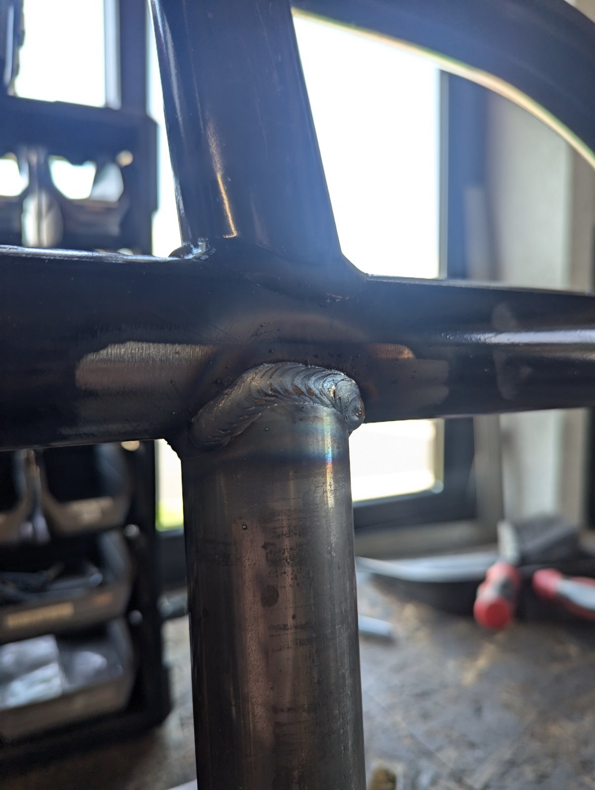

    Finally got some more progress on the rear bumper.
    Got the hinges welded together, I need to weld the arms onto the Tube and the hinge to the at work but can then start mocking up things and tacking pieces together. for the swing arms.
    PXL_20240806_175756386.jpg PXL_20240806_175800441.jpg PXL_20240806_175804647.jpg
