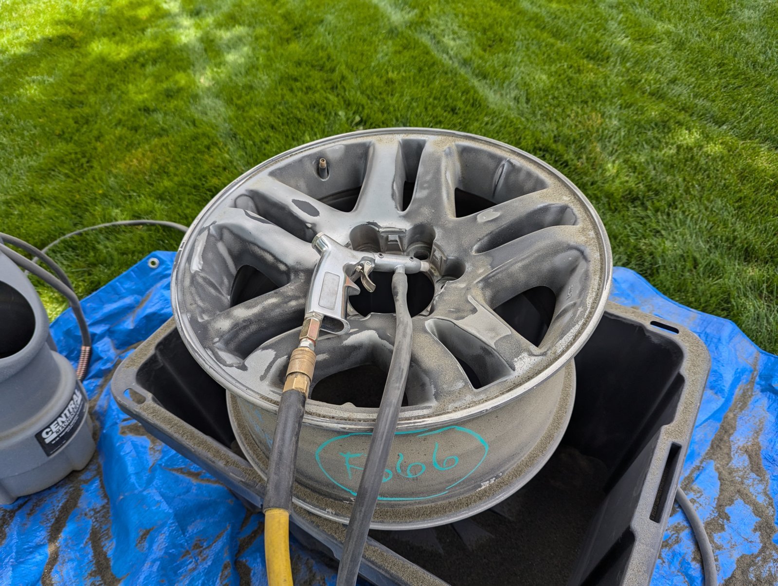

    I did sand blast the Tundra Wheels, still need to paint them. I will be going with the same gun metal grey I have on currently.

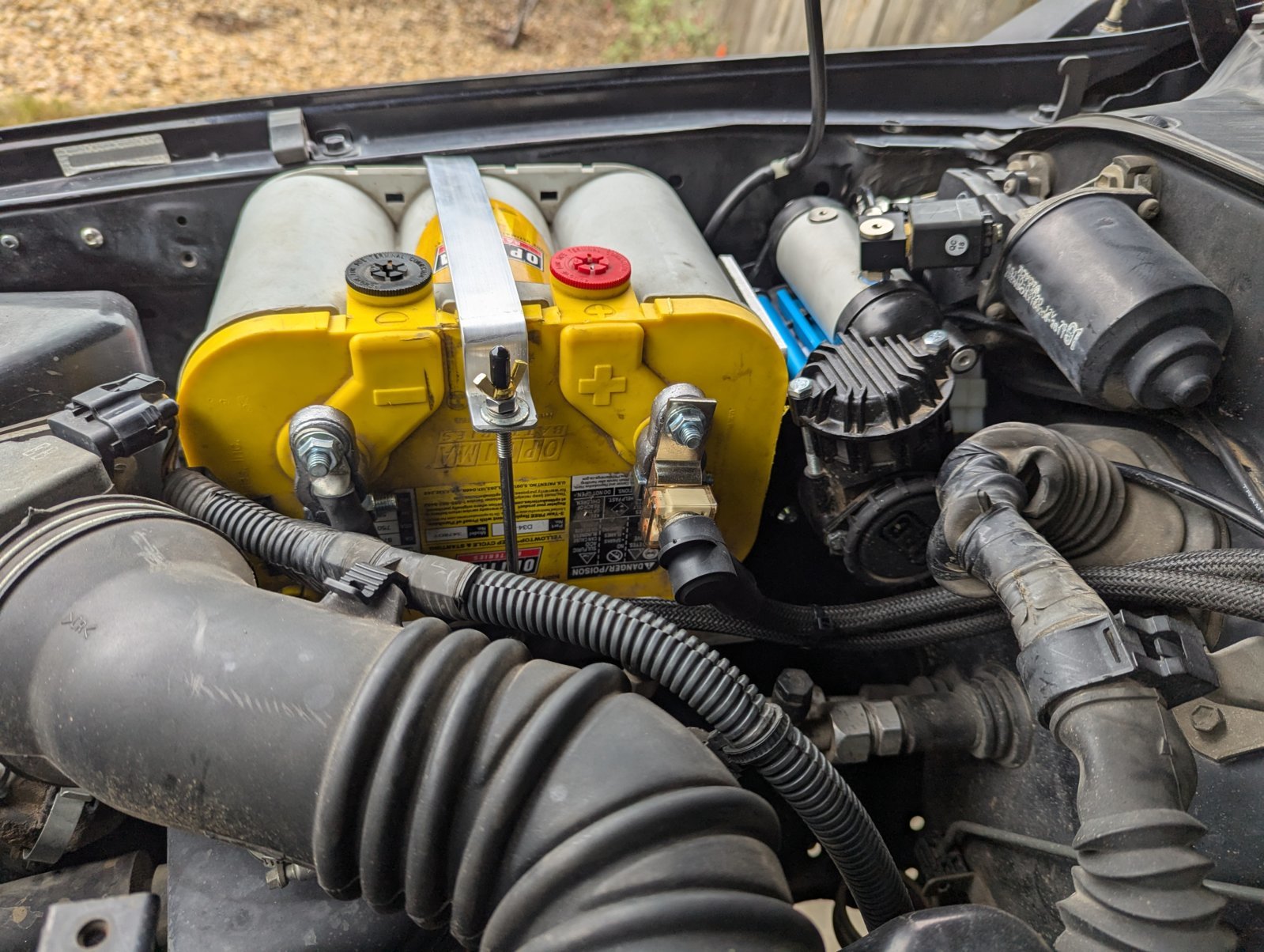

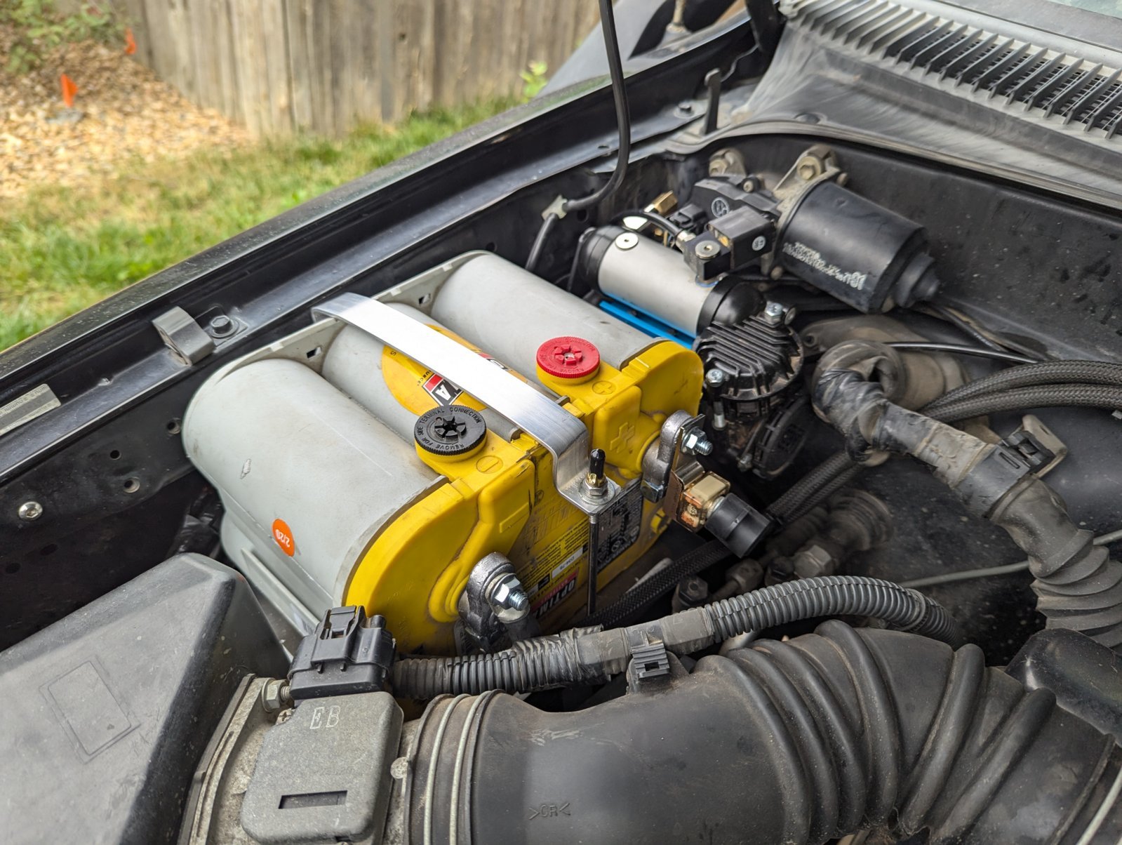

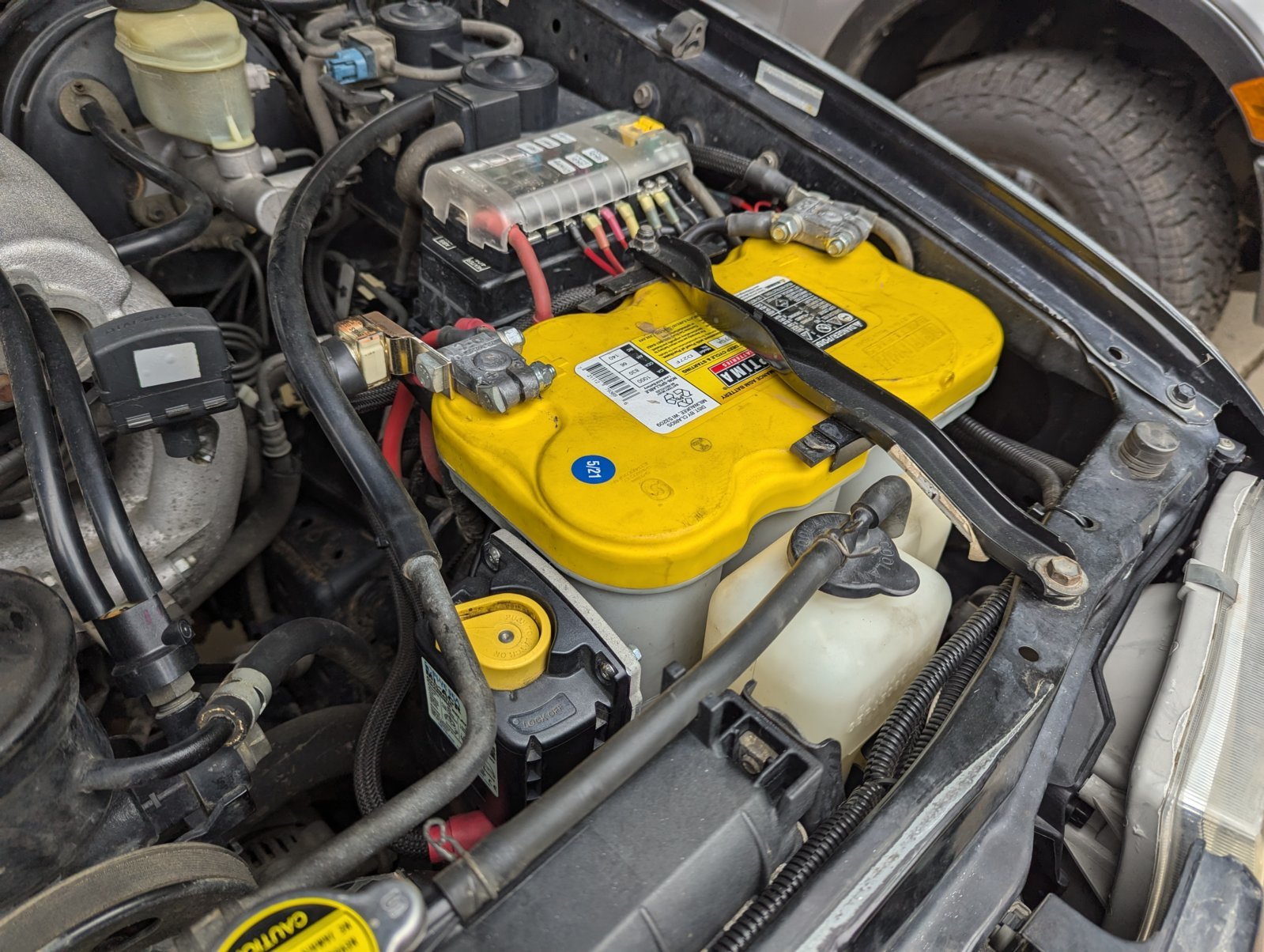

    But I was able to finish up the Dual battery system under the hood, relocated my air compressor, and plumb the air compressor to the front bumper.
    The Starter battery is on top of a Tray to Mount a Blue Sea ML-ACR, a Automatic Magnetic Latching 500amp relay, it waits till the truck starts, seeing 13+ volts for 30 seconds then latched the batteries together to charge. This works perfectly in this truck since I have a Voltage boosting fuse and the alternator charges at 14.2-14.8V, perfect for AGM batteries. My Rangers dual battery system uses a Redarc DC-DC Charger to charge a lithium house battery. This is because new truck often charge in the 12.9-13.5 Volt Range which is too low for AGM and Lithium Batteries.
    The power cables are fused on Both ends with MRBF fuses at 225Amps.
    The Compressor was moved back to just in front of the wiper motor, everything fits with just a little bit of clearance to spare.
    The Tie Down is not Permanent but It was 10 pm before I had to leave for the airport at 4am. But it hold it nice and tight but I want to do something nicer in the future.
    My Air Chuck is now plumbed to the front bumper and has a cover over it. Something I have wanted to do for the last couple years. So I don't have to open the hood to air back up.

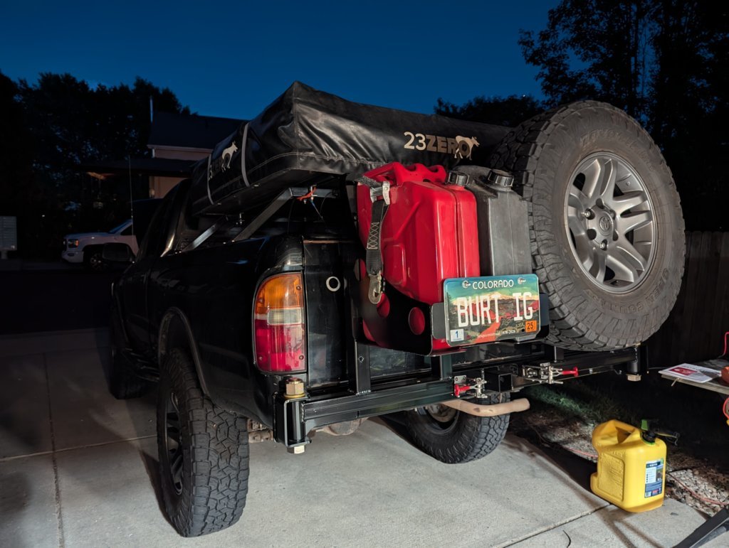

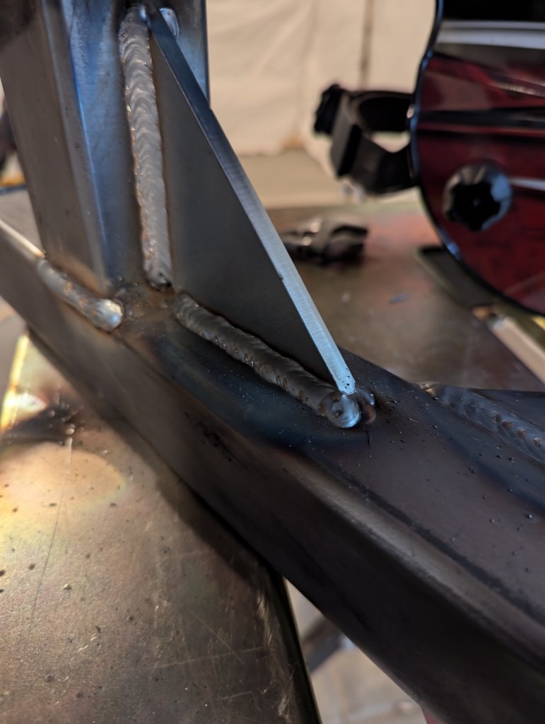

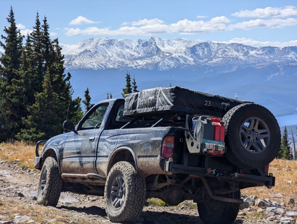

    Been slowly making progress on the Dual Swing outs. The Mounts are all welded to the bumper. The Tire Carrier Arm is welded up and barring getting the studs pressed in is ready to go. I am using Weld Nuts for anything that bolts to the carrier such as the latch so that they are fully replaceable in the future as latches always eventually fail.
    I was able to test fit the tire last night.

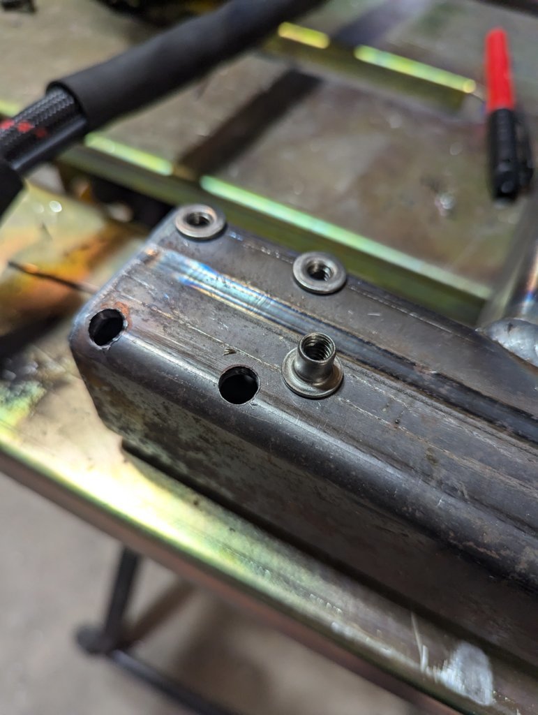

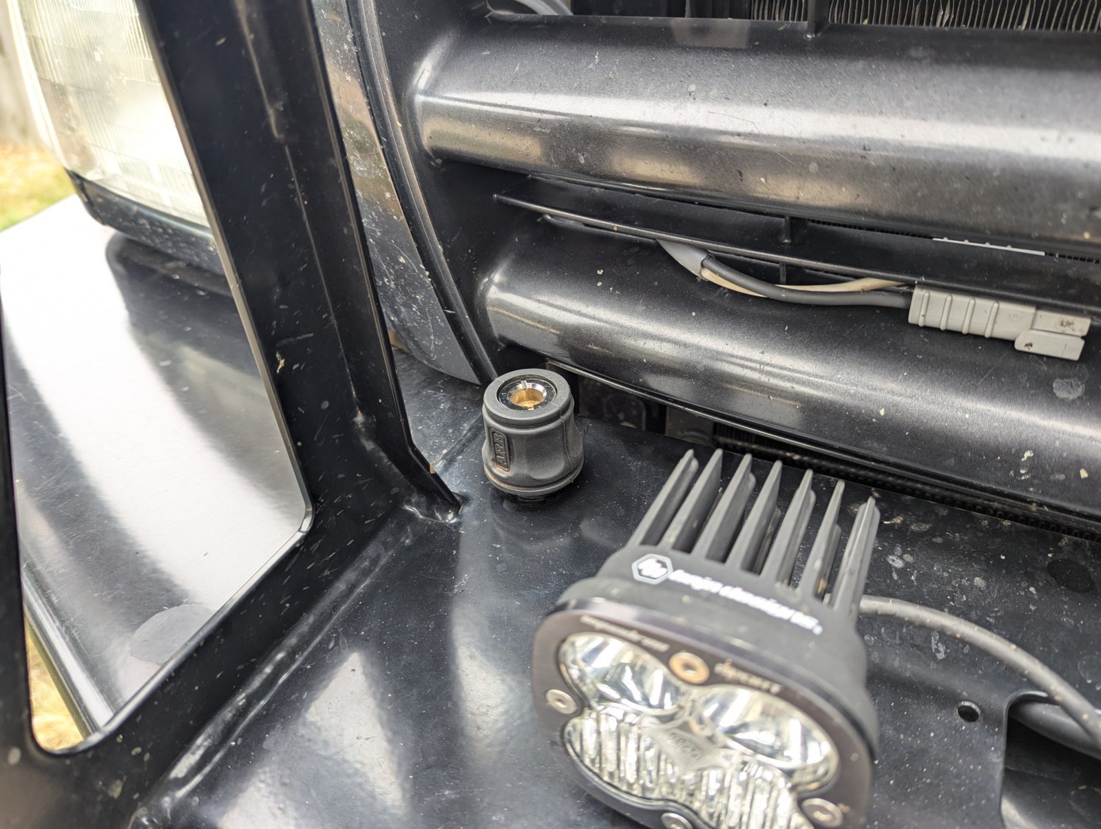

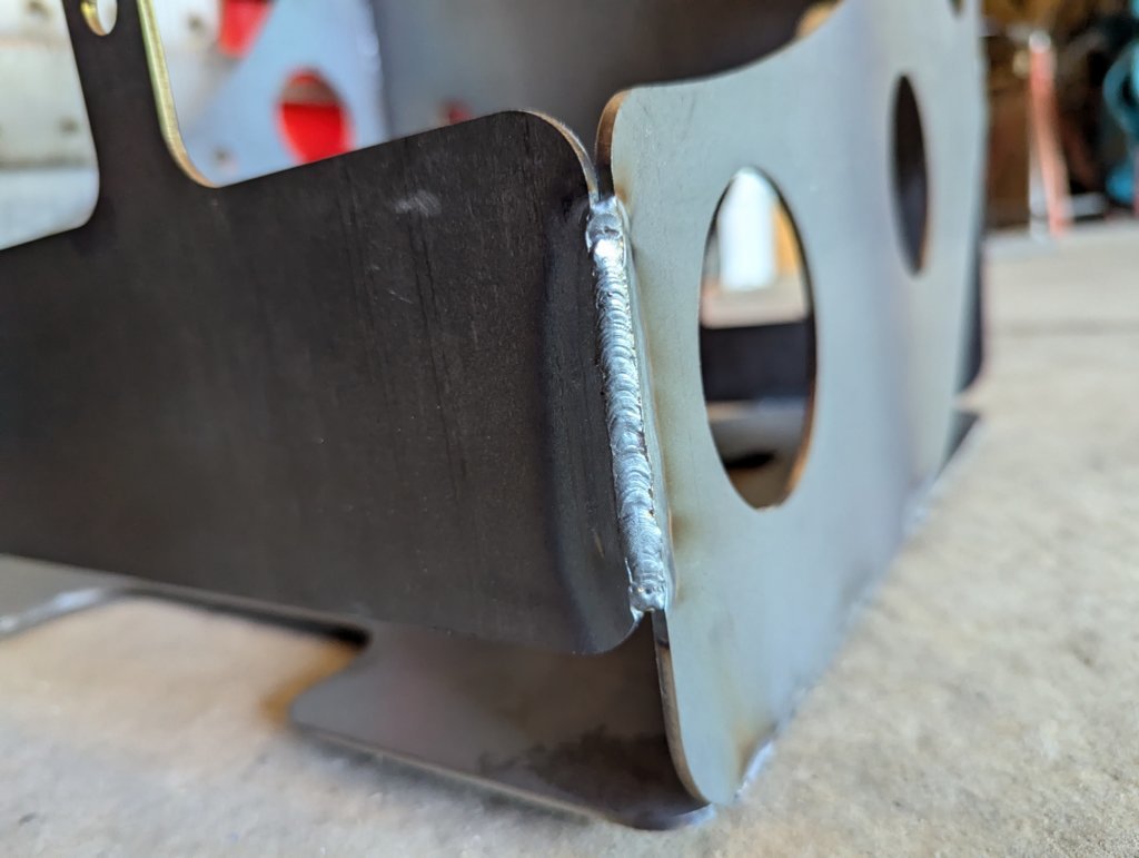

    I was showed these Weld Nuts while helping Prep the Sherpa Motorsports 4600 car for KOH this year and knew I had to use them on a project, I picked them up off Stock Car Steel, Then provide a much longer thread than tapping the .125 wall tube I am using. However, these are the biggest PITA to Tig Weld so if you use them stick to Mig. I tacked them in place with Tig and mig welded them in for the latch Mount.
    The Carrier arm is always what fails on these bumpers. So I always brace mine with a large .25 gusset.
    The Dual Fuel can holder is almost finished up and I will be building the arm for that one this weekend. The goal is that it can be changed from a fuel can holder to a storage box for trips that don't require high fuel range.

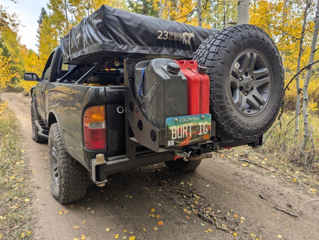

    Finally an update with finished photos and trip photos!

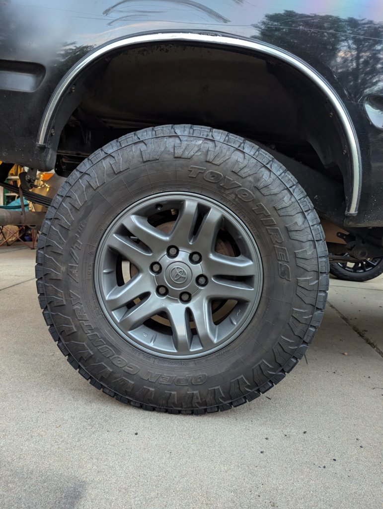

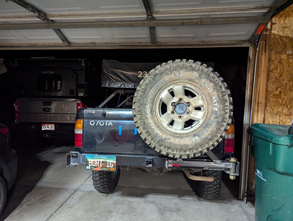

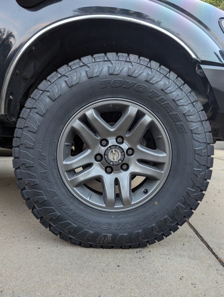

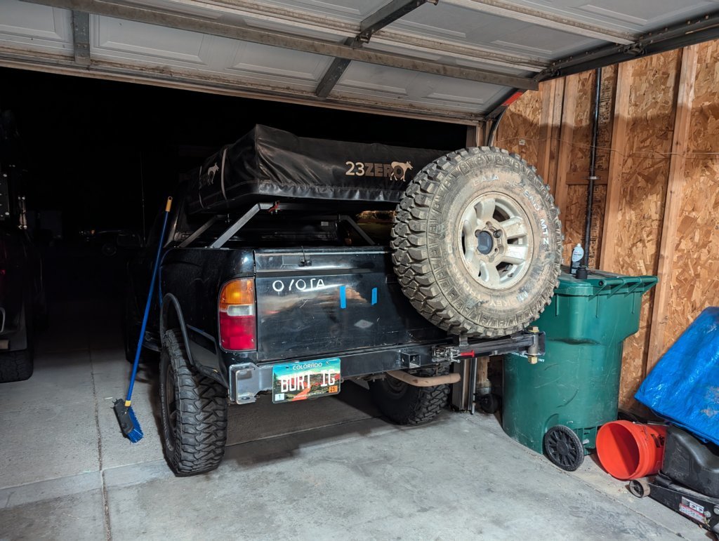

    I finally finished up the new wheels and got the 34s mounted.
    I got the swing out wrapped up the night before leaving for a 3 day trip.
    I also Flexed the truck to check where I need to clearance for the tires, the same front spot on the front of the rear wheel wells still hits. I need to push my axle back a 1/2-3/4" soon.
    and there is a tiny piece of plastic on the front of the front wheel well that needs trimmed.

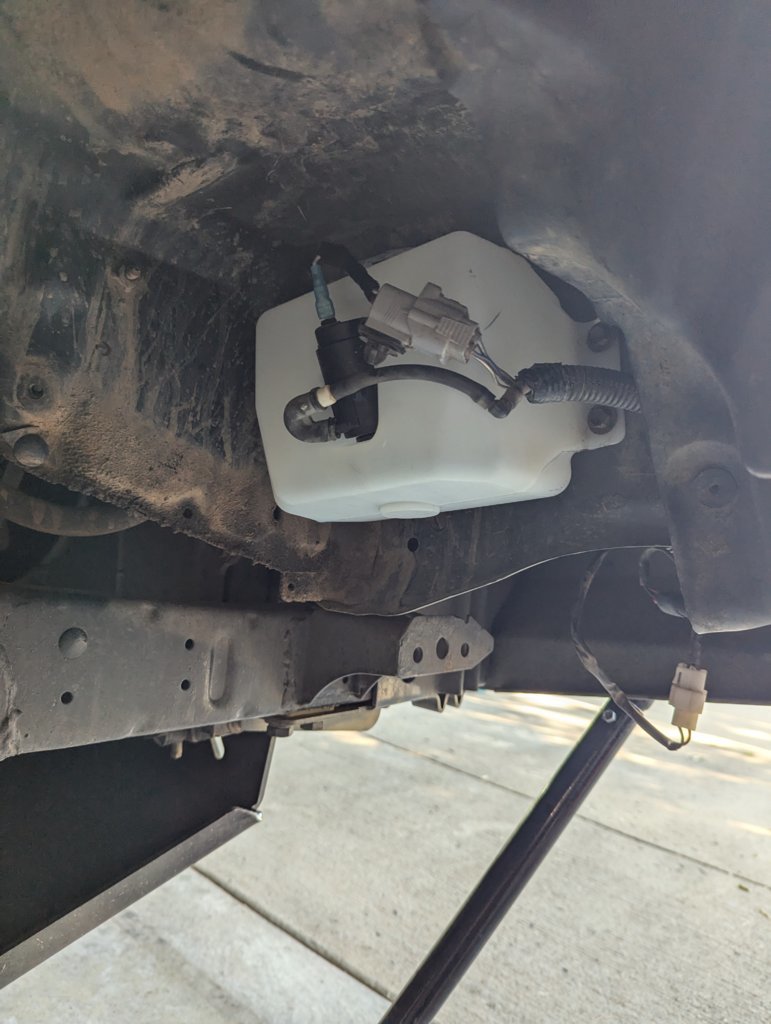

    I did have to change my washer fluid reservoir to a smaller unit.
    While is looks like something other than a washer fluid container its been working perfectly. Its around 3/4 gallon so its not as big as the factory tank but not a terrible size either.
    Looks kind of like a Geoducko_O
    It only took one trip to home depot, not 3 like my usual projects.

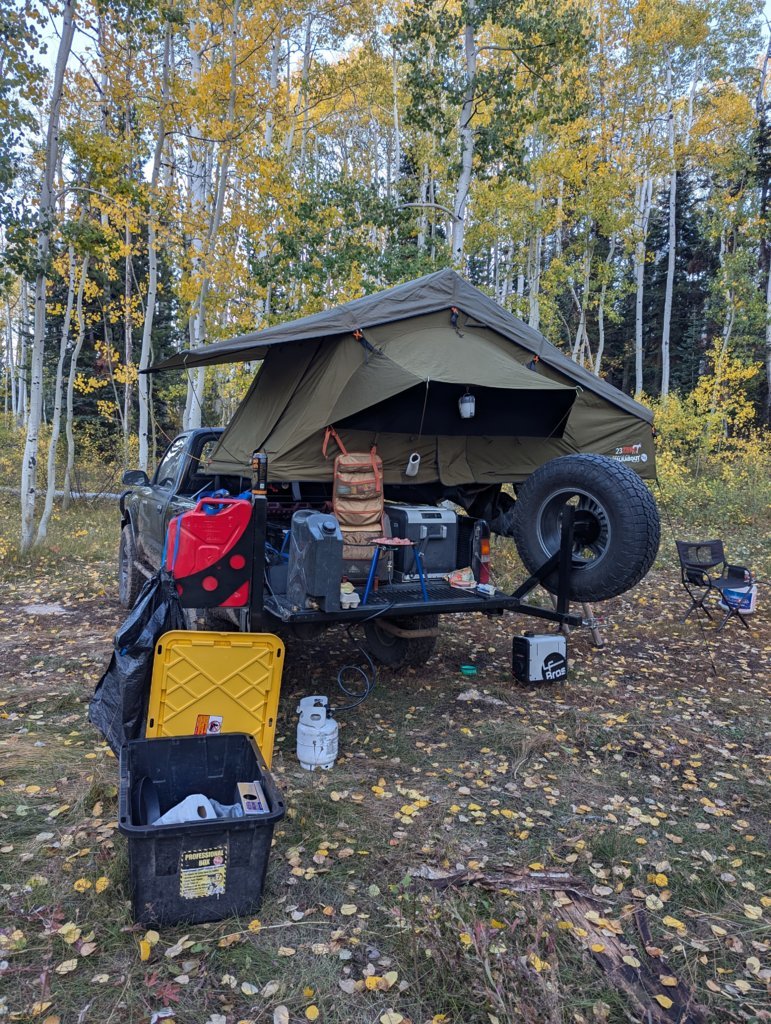

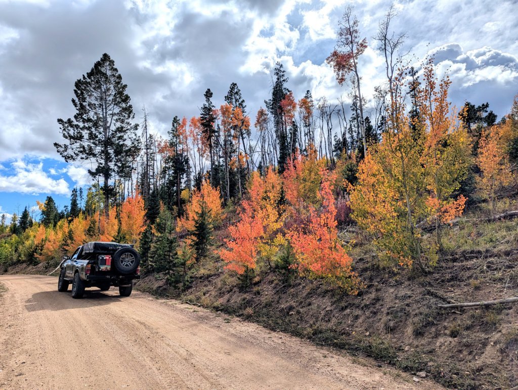

    Fall colors trip!
    Fall colors are just about in full swing and with snow in the forecast we shot up to north of Steamboat and tried to get some camping in where we would wake up to snow on the tent, which failed. Weather called for rain, snow, high winds, and cold temps. We ended up with no wind, nearly no rain, and fairly nice temps the entire trip. No complaints here.
    One of the big upgrades we did for our camping gear was the addition of a diesel heater, the CDH (Chinese Diesel Heater). I want to do a bit of winter camping this year, so being able to preheat the tent while we get ready for bed is the goal. I use a -20 bag in the winter and with long johns and a blanket I really have no complaints down into the -5 degree range. But getting changed, climbing in and out of bed is where it does get less fun.
    We left Saturday morning and headed up to the Colorado Wyoming Border, a place I have really come to enjoy over the last couple years.
    There was a road we marked as it was full of aspens and we knew it was going to be the best place to see the color changes.
    Color did not disappoint.

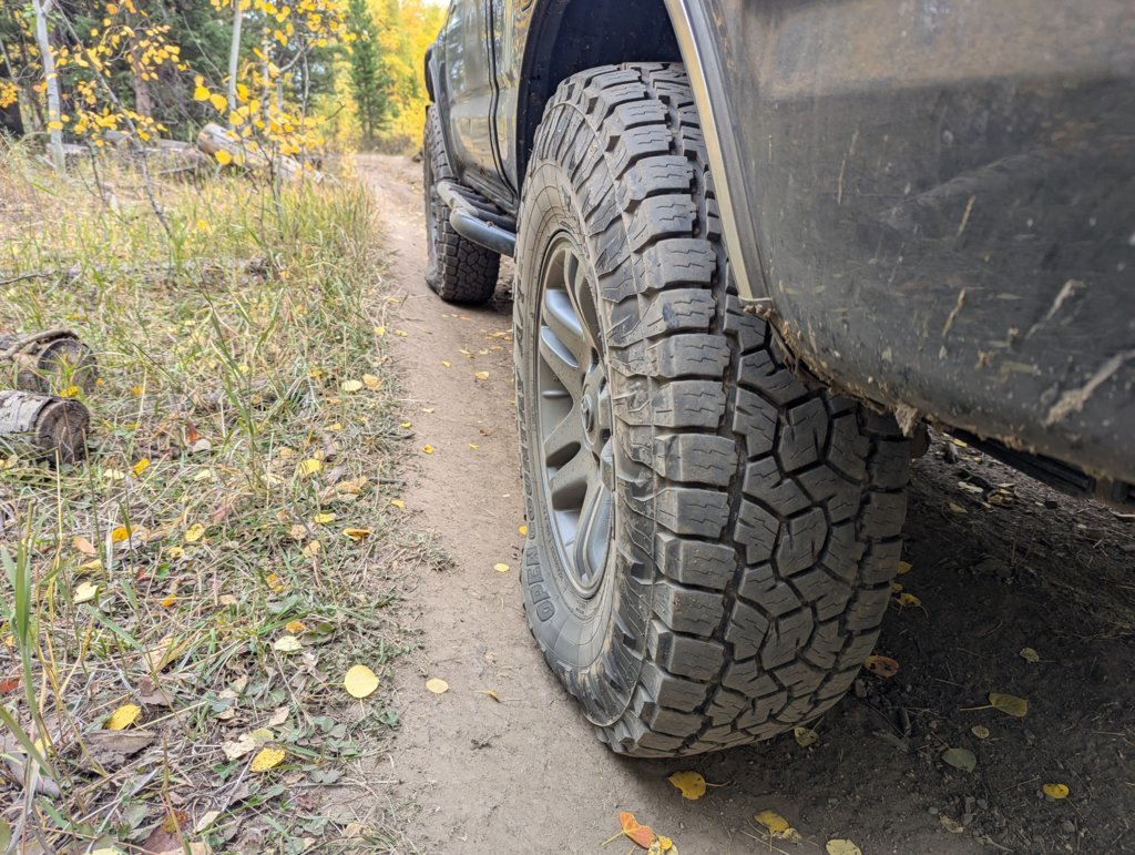

    I dropped down to about 11psi which provided good sidewall flex but still felt comfortable on higher speed dirt roads. In the rocks I think I will go down a bit more to 8Psi. I ran these at 16-18 on the Ranger which I would guess is about ~
    twice the weight.
    The First Trip with the Dual Swing outs, it was perfect, though I forgot to throw my old Trasharoo on for this trip.
    The Colors in this area were just about perfect, though in other places we may have been a hair early since there was still a good bit of green around.
    Burt got to wear a Starlink for the first time. Something I have been running on the ranger for the last summer but with navigation, music, and my Fiance working remote some days it got thrown on the roof for this trip. The paints already destroyed and been redone once so I don't mind if it scratches on the magnets.
    A hidden cabin, I unfortunately didn't find any additional info on this one.
    PXL_20240922_004856778.jpgI happened to pass a buddy of mine on the trail that was taking his Son up for a weekend of fishing and exploring so we ended up camping with them, a round of Kielbasa and mashed potatoes was in order. Lots of laughs were had around the campfire catching up with friends.
    We had a great view of Hahns Peak in the morning, even being able to see the Fire lookout at the very top.
    We decided this morning to run the northern few sections of the Colorado BDR. Having come up here more or less without a plan we figured since we had already hit the Wyoming border the night before we should make our way south along the BDR Path. Let me tell you, Section 7,6, and 5 contain a hell of a lot of pavement, and as someone that explored these areas quickly, there are dozens of better ways to get from I-70 to The Wyoming Border.
    Leaving the border all the way down past steamboat we were basically in neighborhoods, some dirt, some paved. We had one 15 miles stretch through a ranch that started to feel more remote but quickly dropped us off into a paved neighborhood again.
    Colors started becoming more Orange and even a hair of red, some trees looking as if they are on fire.
    Lynx pass was the first time we started getting away from people, however leaf peeping season has tourists on any dirt road they can find. Sadly the BDR sticks to fully maintained roads as far as we followed it.
    From Lynx Pass you drop on to Blacktail Creek, the highlight of the day just for the views and lack of people, nothing difficult and could be driven in any AWD Vehicle. But very pretty overall.
    We went through a few more small dirt roads, mixed in with paved roads, ranch properties.
    My Windshield is looking a bit haggard at this point.
    Once we hit Highway 131 we decided We had enough of the BDR, it had taken nearly all day to travel what a couple other dirt roads in the area cover in a couple hours.
    Around 5 at this point the BDR also went into a stretch of towns and highways that wouldn't have camping along it.
    So we bailed to the east and headed up Muddy Creek, knowing we wanted to be in Leadville the next day to get
    We found a perfect little campsite tucked away in an aspen grove.
    Dinner was Spam Fried Rice. A Favorite of mine. Before bed we preheated the tent, it was really nice crawling into a warm 65 degree tent and sleeping bag. With temps dropping into the Mid 30s we were comfy.
    Propane Fire Pits also help keep warm.

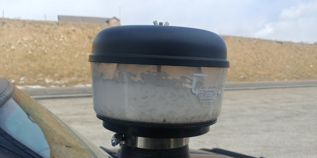

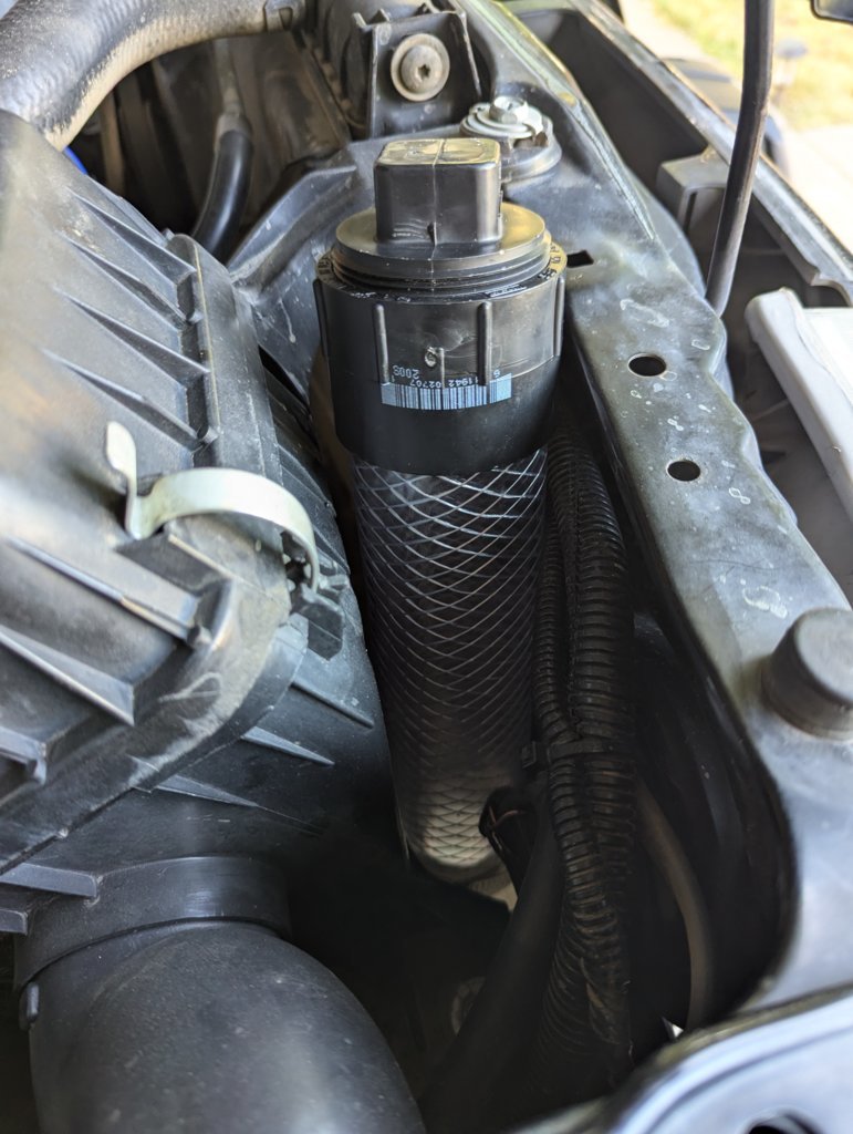

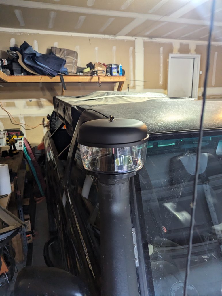

    With winter coming up and hopefully a good year of Snow Wheeling on the horizon. I wanted to switch back to a Pre filter on my Snorkel. I have never had an issue with rain getting in the ram air head but I have had snow build up in the back of the tube. Previously when I put one on I had ordered the 3" model and had to run a adapter to make it work. It eventually sun faded and I got rid of it.
    I picked up the 3.5 this time and with the truck now living in the garage when I'm not on a trip it shouldn't yellow nearly as fast.
    My last one helping to filter out snow

    It's less Tacoma and more mod
    I always thought they were supposed to be yellow :anonymous:

    Give Colorado 6 Months with the sun and it will be yellow.
    This was a little under 2 years of sitting outside every day.

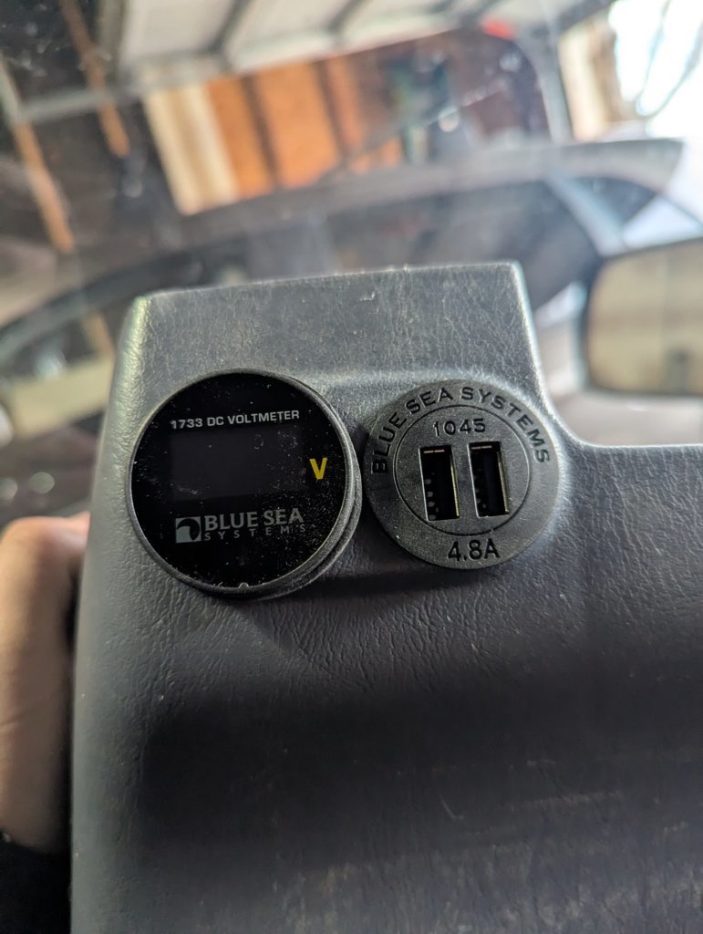

    Nothing major lately on Burt, I've been caught up on trips in the Ranger and starting a new build on our F250.

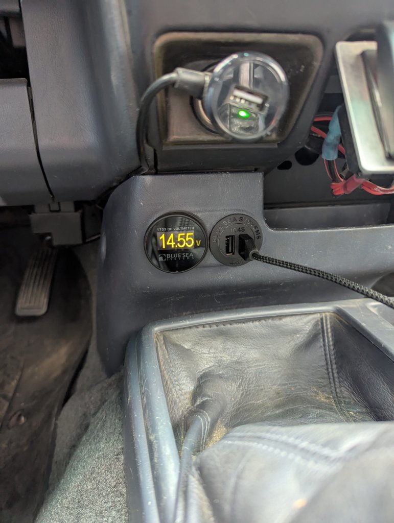

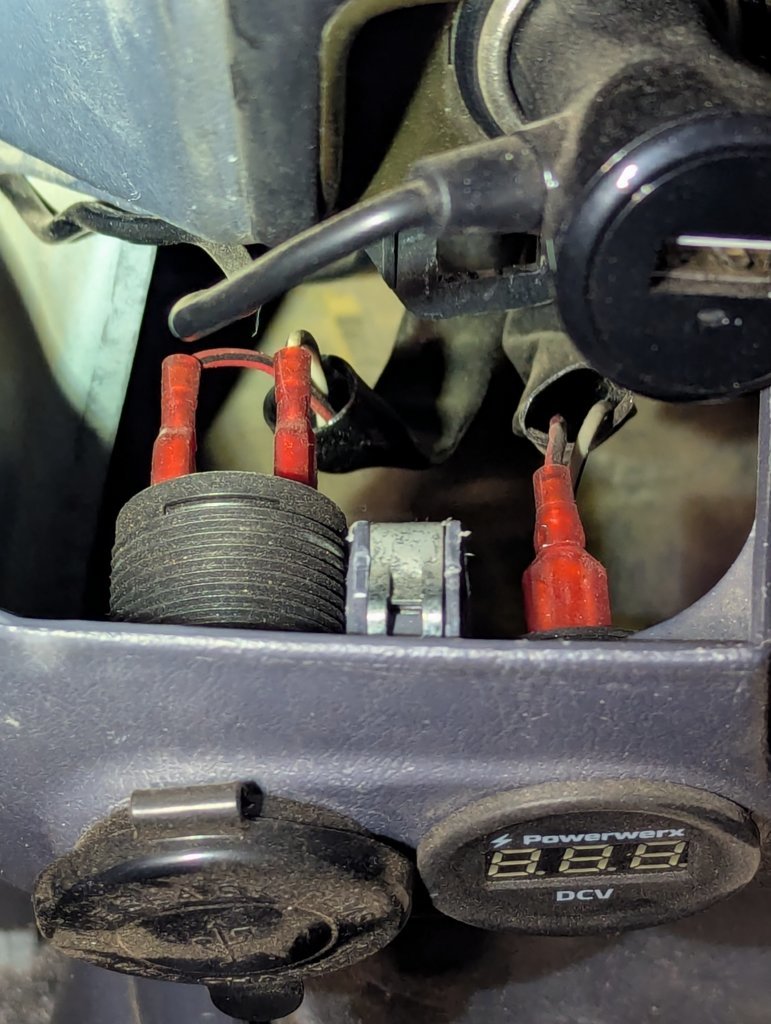

    But I had time to swap out my Voltmeter with a much nicer one.
    The Powerwerx one is great but a bit bright at night and hard to see during the day. The Blue Sea OLED one is super visible in both conditions and not bright at night. Also reading to .00 instead of just .0.
    This was a good update on one of my Oldest Mods I have done.
    Its nice having a Voltmeter to keep and eye on the alternator, and the Fast Charge USB has been flawless over the last couple years.
    PXL_20241208_175845407.jpg PXL_20241208_180349142.jpg PXL_20241208_181440523.jpg
