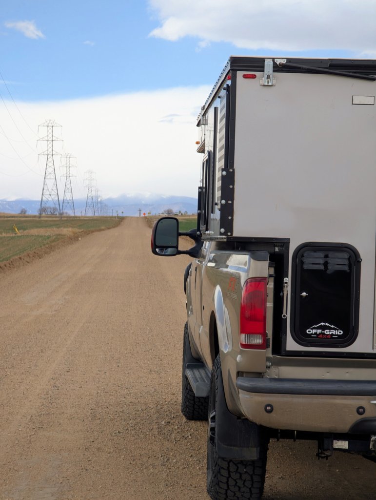

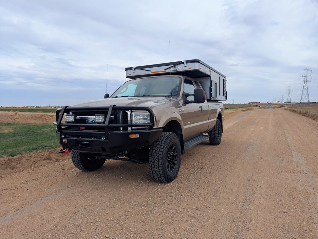

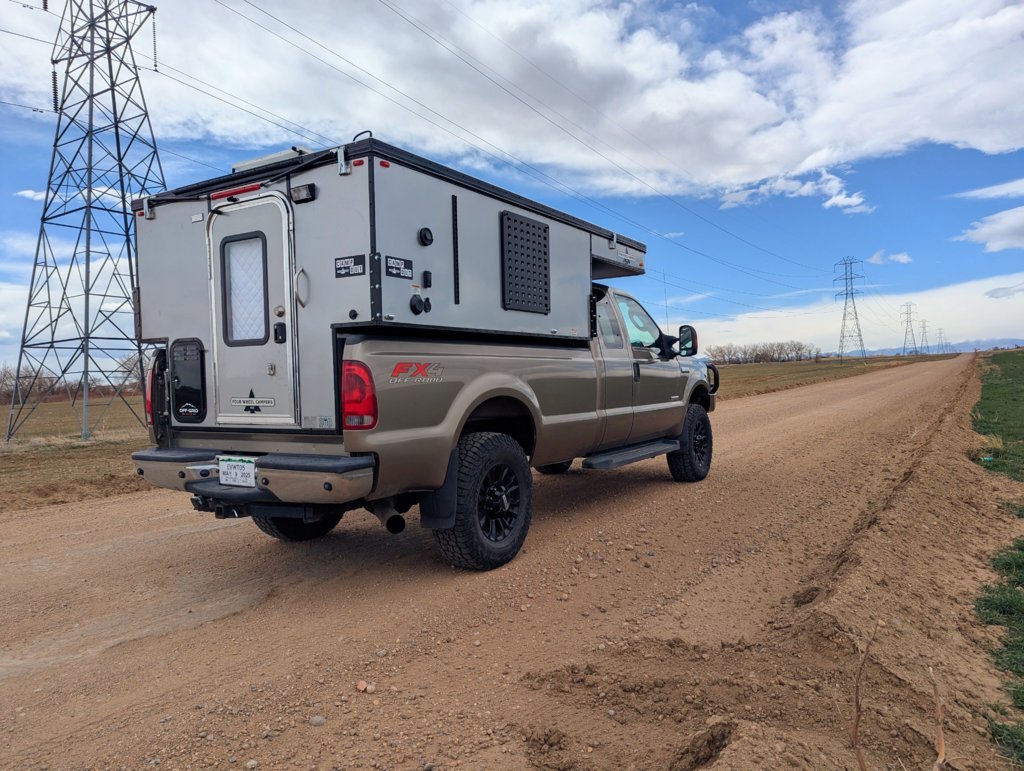

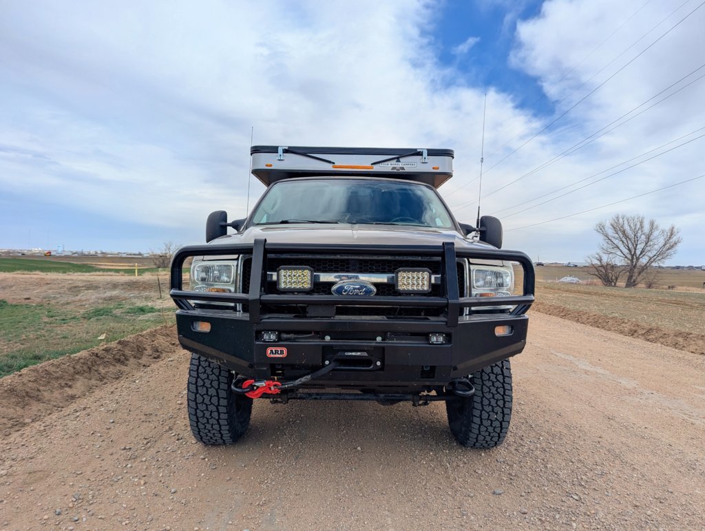

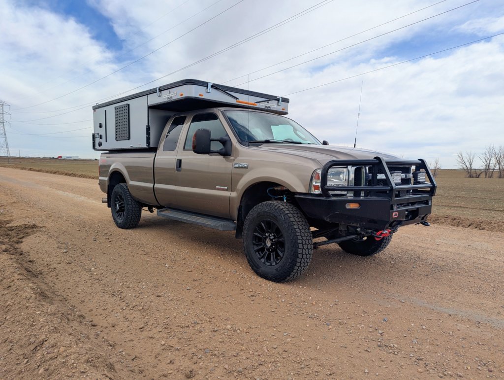

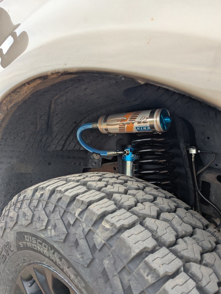

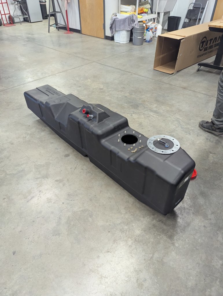

    Daryl's all wrapped up. A late night yesterday to get the 60 gallon tank in place, install longer diff breather, brake bleed/flush, and an alignment has it ready for 6 days in Utah.
    The Carli kit is AMAZING. It makes a 10K truck handle better than my Tacoma and Ranger Combined. The harder to push it the smoother it gets.
    PXL_20250320_201346049.MP-EDIT.jpg PXL_20250320_201350202.MP-EDIT.jpgPXL_20250320_201410034.MP-EDIT.jpg PXL_20250320_201323948.MP-EDIT.jpgPXL_20250320_201334341.MP-EDIT.jpgPXL_20250320_201339602.MP.jpg
    No installed pictures but the new tank is 22" longer than the previous one. It's massive.

    Looks great! That tank is huuuge holy shit!
