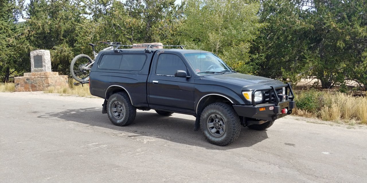

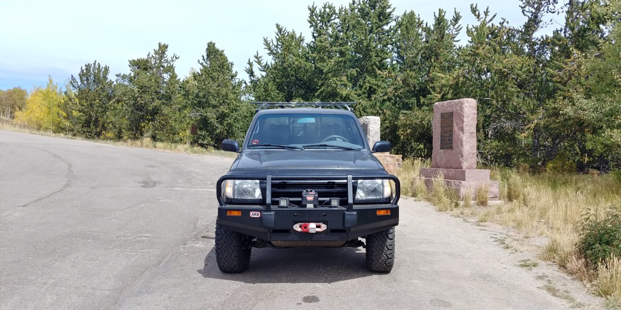

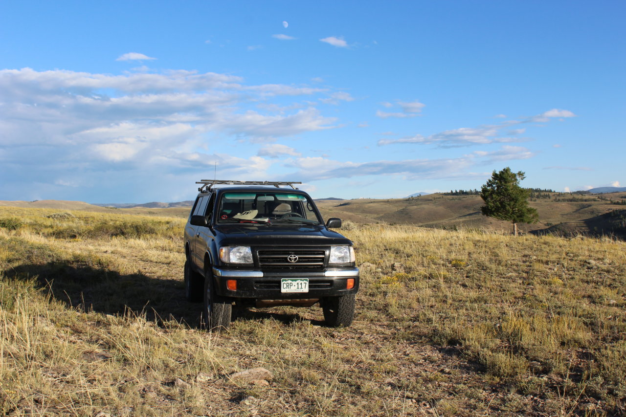

    Hit another milestone while out camping and fishing this weekend. Here's some mild phone pictures since I haven't taken the photos off my camera yet.

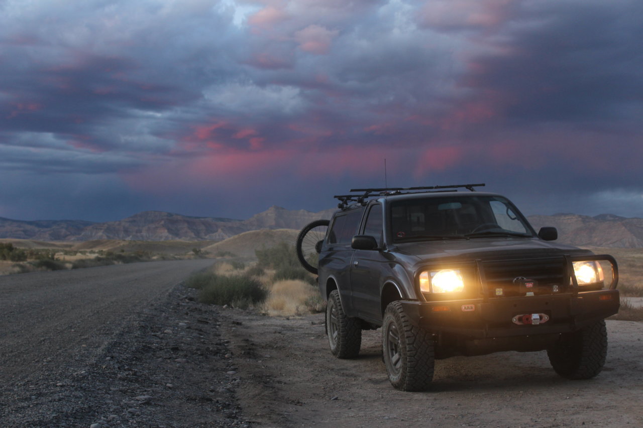

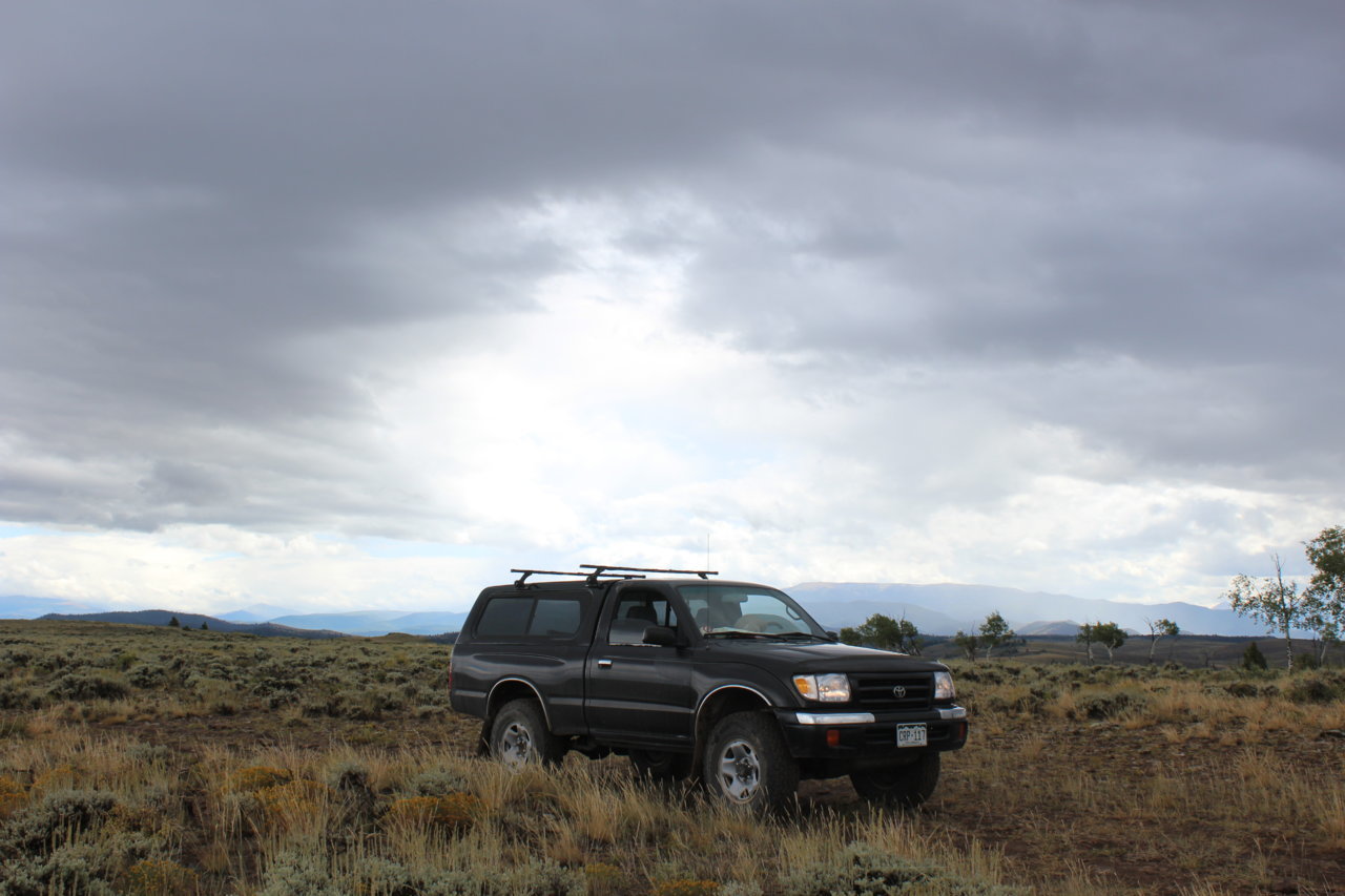

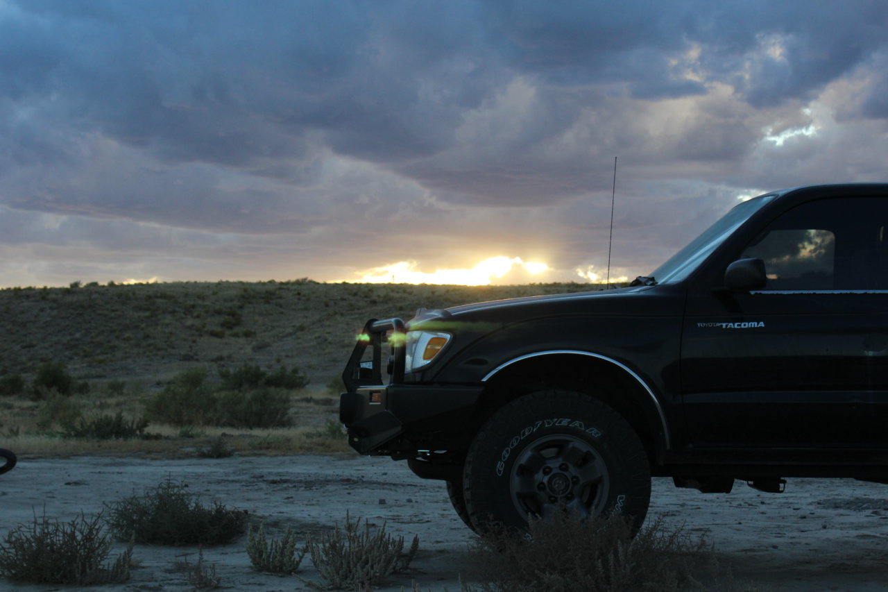

    Finally got around to grabbing a few photos off my camera from the last weekend of fishing and camping with my dad. IMG_5100.jpg IMG_5096.jpg IMG_5093 (1).jpg
    In other news, the new tires have been delivered, ARB Bumper has been delivered. I am making the trip back to the front range this weekend to install them.

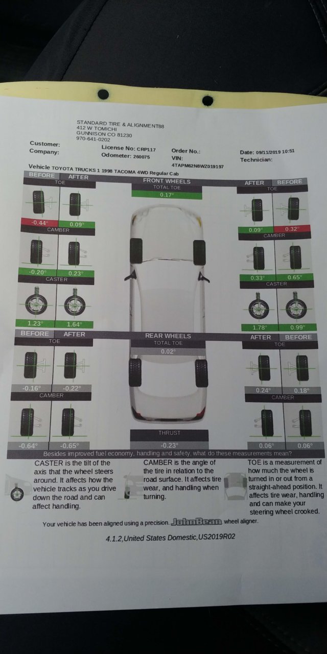

    Quick alignment was done this week in prep for the new tires. I had done an eye ball alignment about an year ago when I put the 5100s on, since them I have taken the front end apart a couple time and so the alignment ended up being pretty sub par.

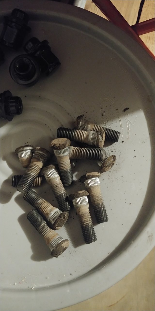

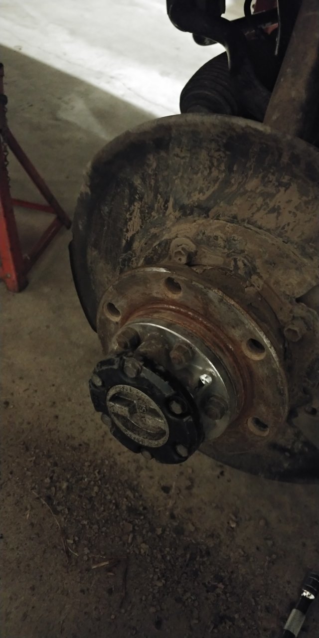

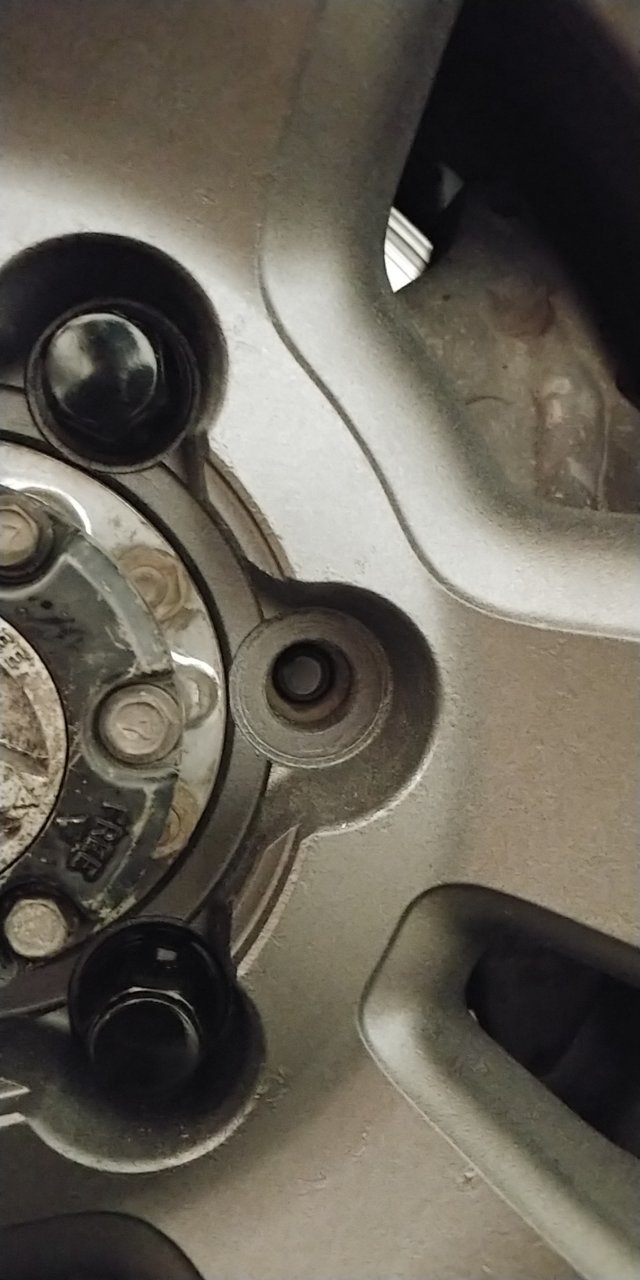

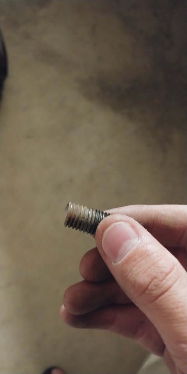

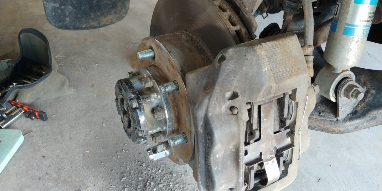

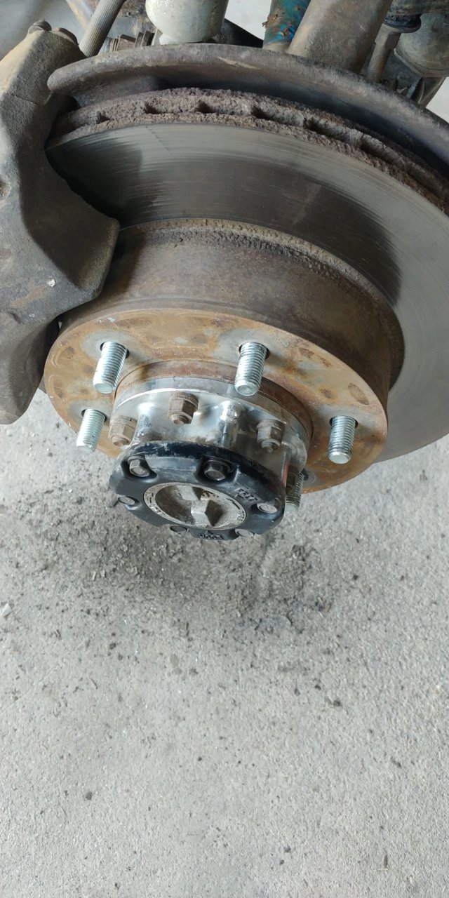

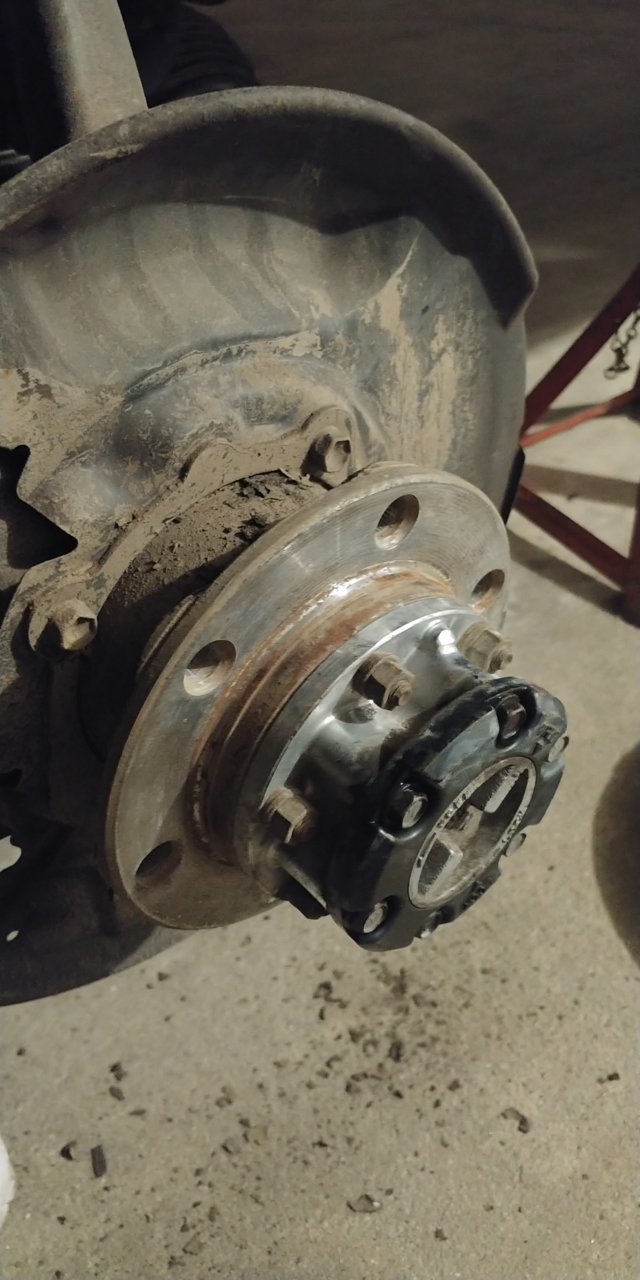

    First things first, the first broken bolt...
    A lug stud. At 10pm with a tire change scheduled for 9am the next morning.
    Last tire, last lug, just hand tightened and it snapped. 0919192103.jpg 0919192107a_HDR.jpg
    Upon further inspection, it had be over tightened at some point. It has been stretched and cracked long enough for a nice bit of rust to from inside. I check all the other front studs and found 8/12 were also stretched.
    I went ahead and knocked them all out in prep for the morning when I would run out and try to find some new studs.
    0919192202_HDR.jpg 0919192202a_HDR.jpg Got lucky and Mountain Truck and Equipment in Longmont had 14 so I bought them all since it's always good to have spares. 0920190848_HDR.jpg 0920190848b_HDR.jpgAnd just like that I could get the wheels mounted and make it to the tire appointment with a few minutes to spare.

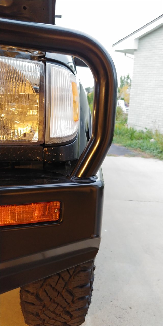

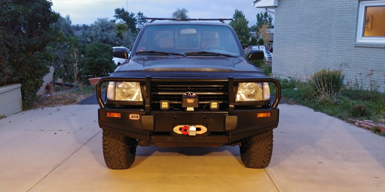

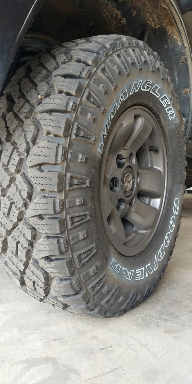

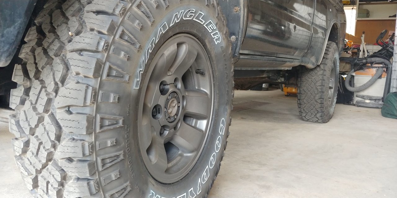

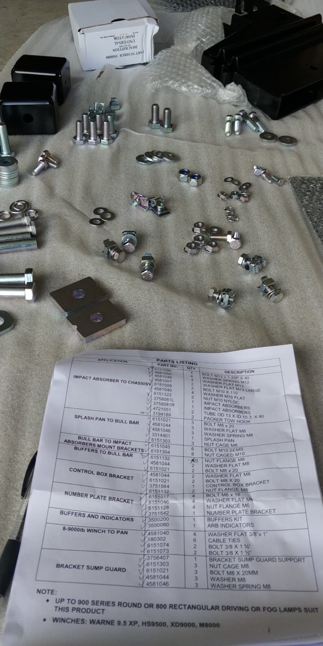

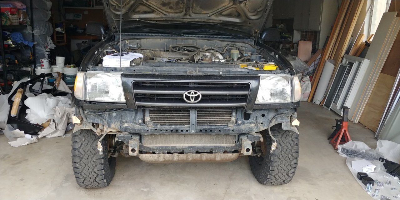

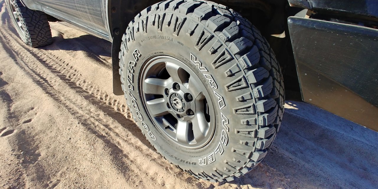

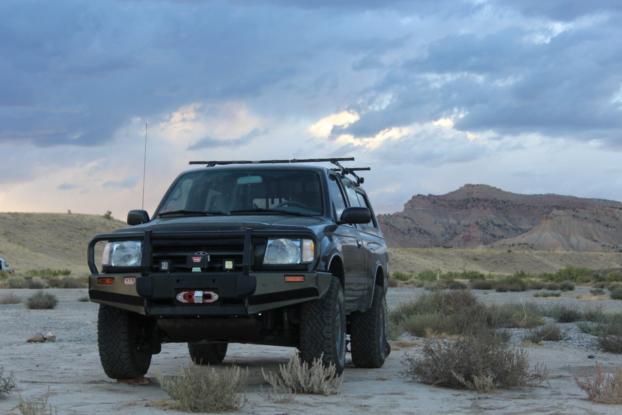

    Burt 2.0!
    After a couple weeks of waiting and a few hours of wrenching Burt has been transformed.

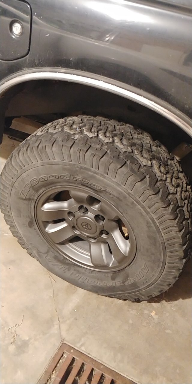

    First up Friday morning was getting tire mounted. As I had that snafu with the lug studs I woke up early and got it done with only about 15 minutes to spare before I had to leave for the appointment.
    It came out perfectly, the wheel color was exactly what I wanted.
    I am very excited to try these out and see if they live up to all the claims of snow traction.

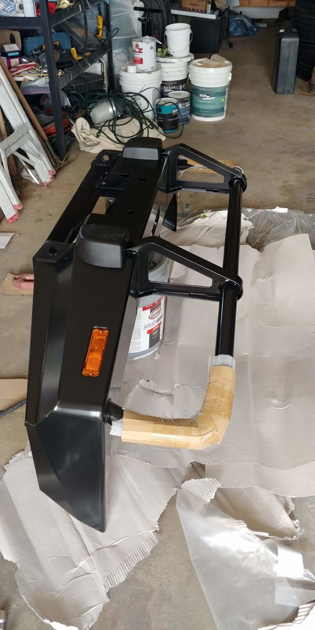

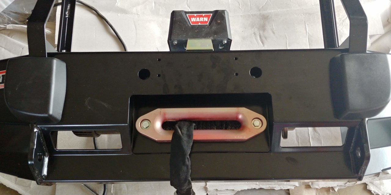

    Next up was the bumper.

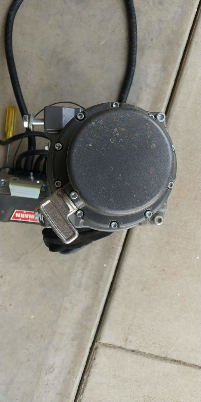

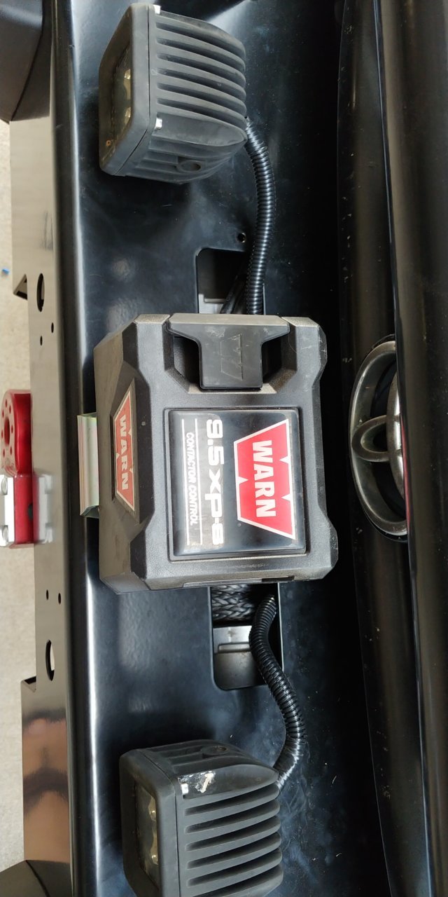

    As my last arb bumper came with a hardware pack that seemed like a handful of bolts out of a random drawer I decided to organize it first.
    Then it was time to start,
    Step one remove all the things!! :sawzall:
    Then the assemble all the things!:welder:
    Then it was time to clock the winch again, Because ARB can't just have the cutouts be the same.
    Then it is time to mount it, I don't know who many of you have tried to install a winch into an
    ARB bumper on your own but it sucks. Until the directs had this tip, Place the winch on a bench and lower the bar onto it. Well I didn't have the spare for that but I tried a bucket and it worked perfectly.
    Once that was done I got it mounted up with a little help from my dad.
    90% done 90% to go.

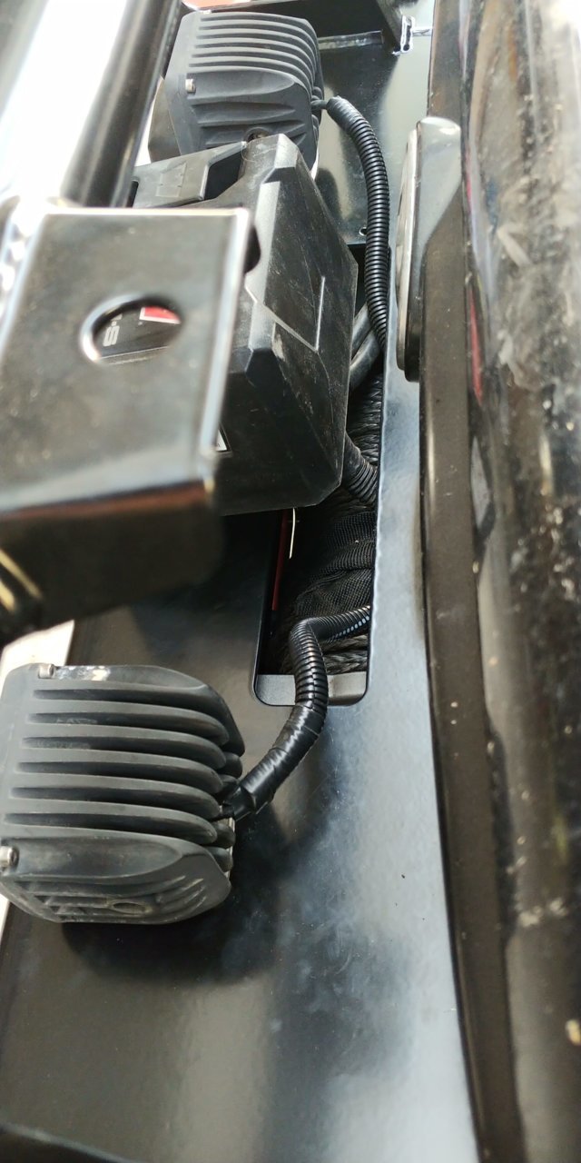

    I wired up the winch, turn signals and had time to throw on some LED pods I had laying around from a previous build. They are nothing special and not the lights I plan to run forever but for now they look good and add a little bit of light.
    And just like that its complete. Just in time for the sun to go down and photos to look like Crap.:puke:

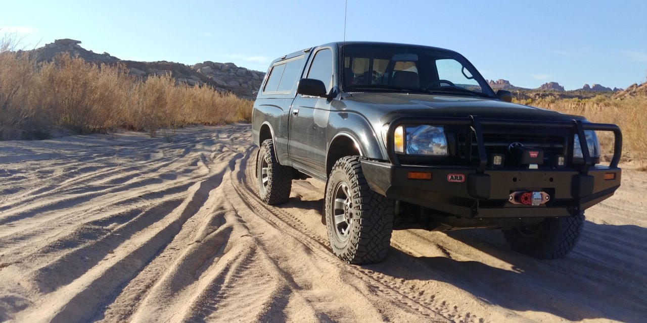

    Here are some higher quality photos.
    0922191503_HDR.jpg 0922191712a_HDR.jpg 0922191856b_HDR.jpg 0923191309b_HDR.jpg 0923191309a_HDR.jpg 0923191309_HDR.jpg 0923191307_HDR.jpg

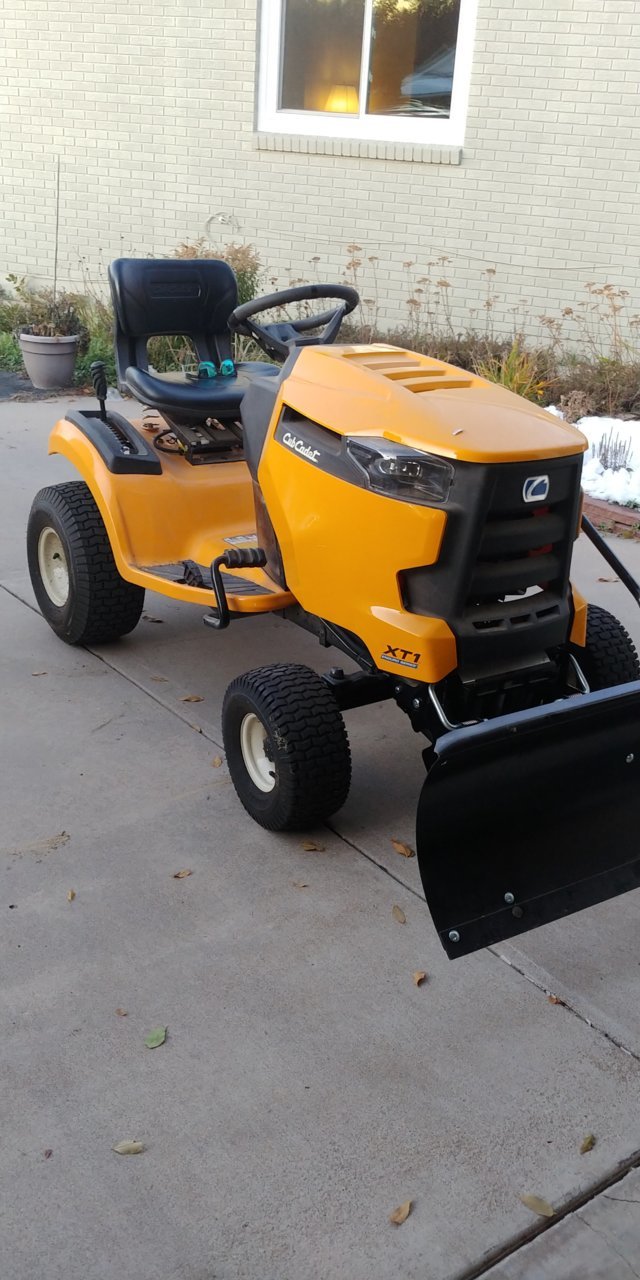

    Ran home this weekend to do a couple things at home before winter starts.

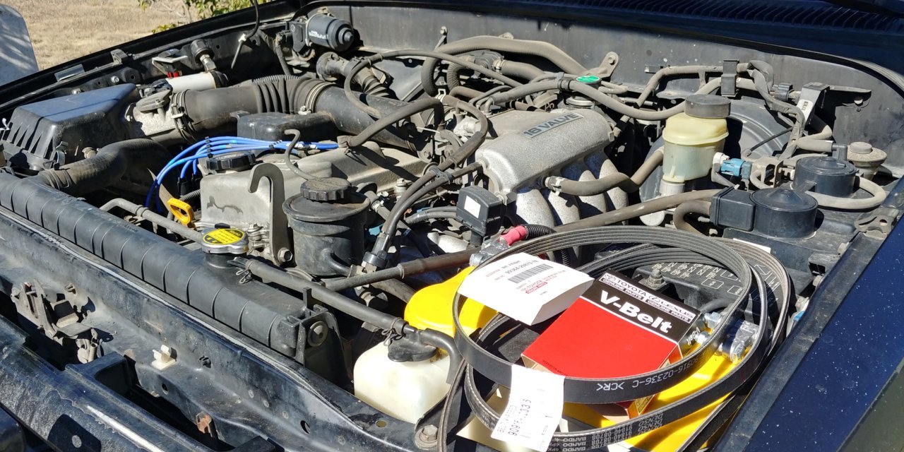

    Burt got new belts, well 2/3 since Camelback Toyota sent me the wrong belt for the power steering but it will be resolved tomorrow hopefully.1012191304a_HDR.jpg
    Visited the Jeep and it's new owner of the Jeep to give him a couple extra parts.
    I had to get the lawn tractor set up for the plow and reteach my dad how to use it again.
    Rolled 262,000 miles at the top of Monarch pass. Which is now I think the 3rd time I've rolled a milestone at the top of the Monarch this year. So here's my current favorite picture of Burt.
    Turns out fitting a 90lbs lap dog fills up the single cab more than expected.

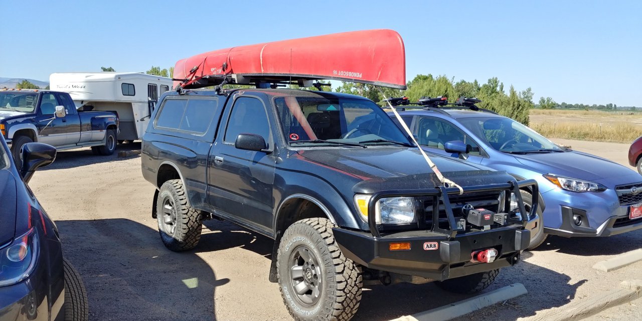

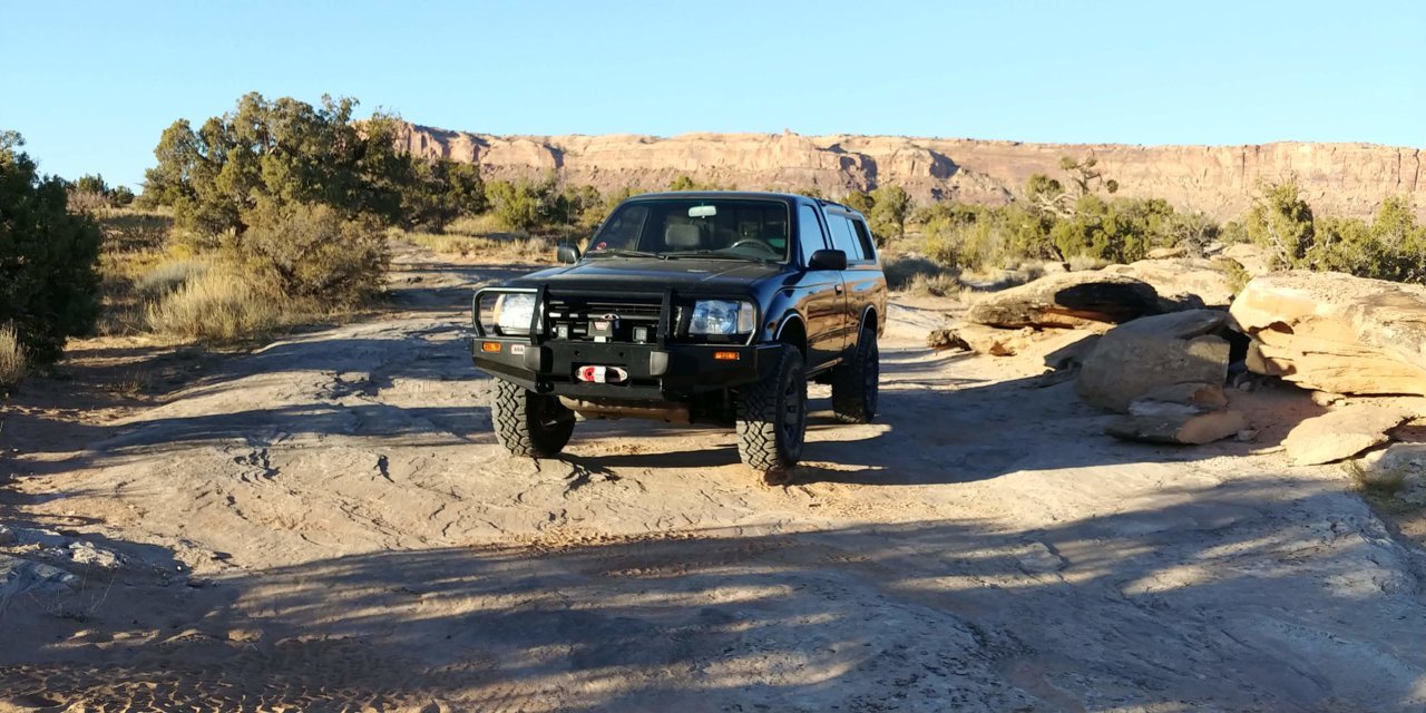

    Ripped out to Moab for the weekend to ride some trails with friends, but not without testing the truck in some sand as I don't get to drive in it too often. Burt did great in the sand, pretty soon it will be time for a snow test.

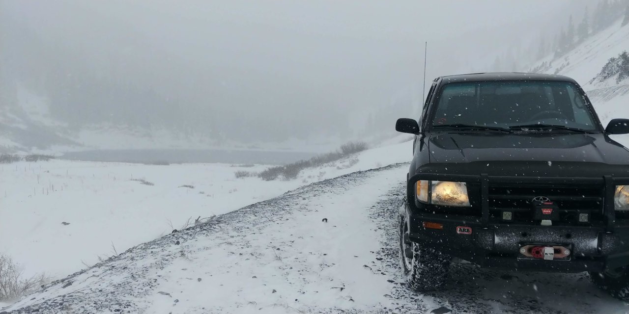

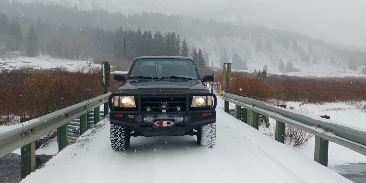

    Monday Snow! First snow of the season up here in the high country, I ran up to Crested Butt to go see what was still open and what was closed. To my surprise the road to Gothic wasn't closed yet nor was Schofield pass so I decided to see how far up I could get.
    First stop to Air down just after leaving CB.
    Past the town of Gothic the snow got heavier as the storm continued to roll in.
    As the road climbed higher I passed a few hunting camps and the tire tracks started to disappear and the snow got deeper, now in the 8-9" range.
    This made the shelf section very sketchy. A small waterfall that normally run across the road caused some nice slick ice under the snow.
    Once I hit emerald lake the one track in front of mine stopped up against a 2' snow drift that was at the start of the next narrow shelf section. I took this as my time to turn around. Could someone push through to the top yes, could you make it over Schofield No, Devils punch bowl is not doable with the level of snow on the pass.
    First trip out in the snow in Burt was awesome, last year I got to drive in the snow for maybe 3 days but only in town so I am excited to have it up here for the winter.

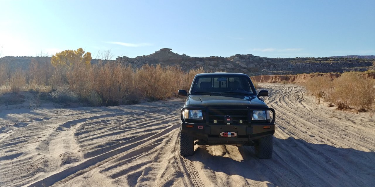

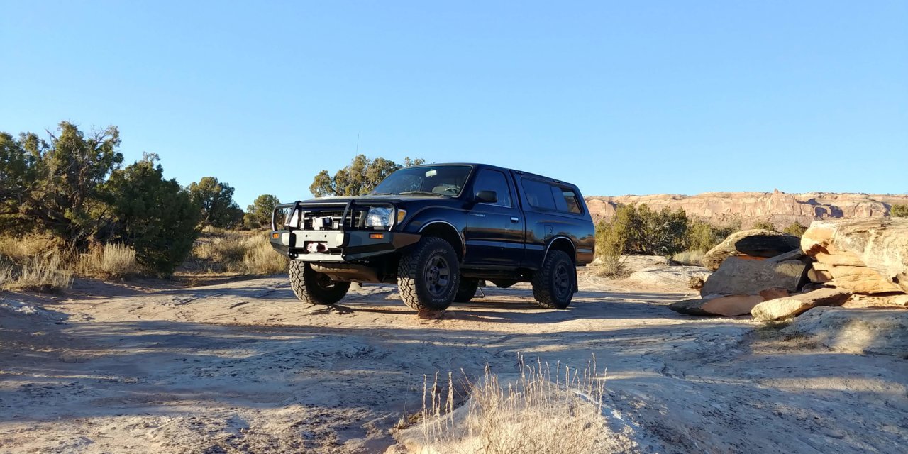

    And back from another Moab trip, seems to be a weekly occurrence, I guess living 4 hours away. 1025190820a_HDR.jpg
    1025190900_HDR.jpg 1025190847_HDR.jpg 1025190847a.jpg 1026191419b.jpg 1025191025_HDR.jpg

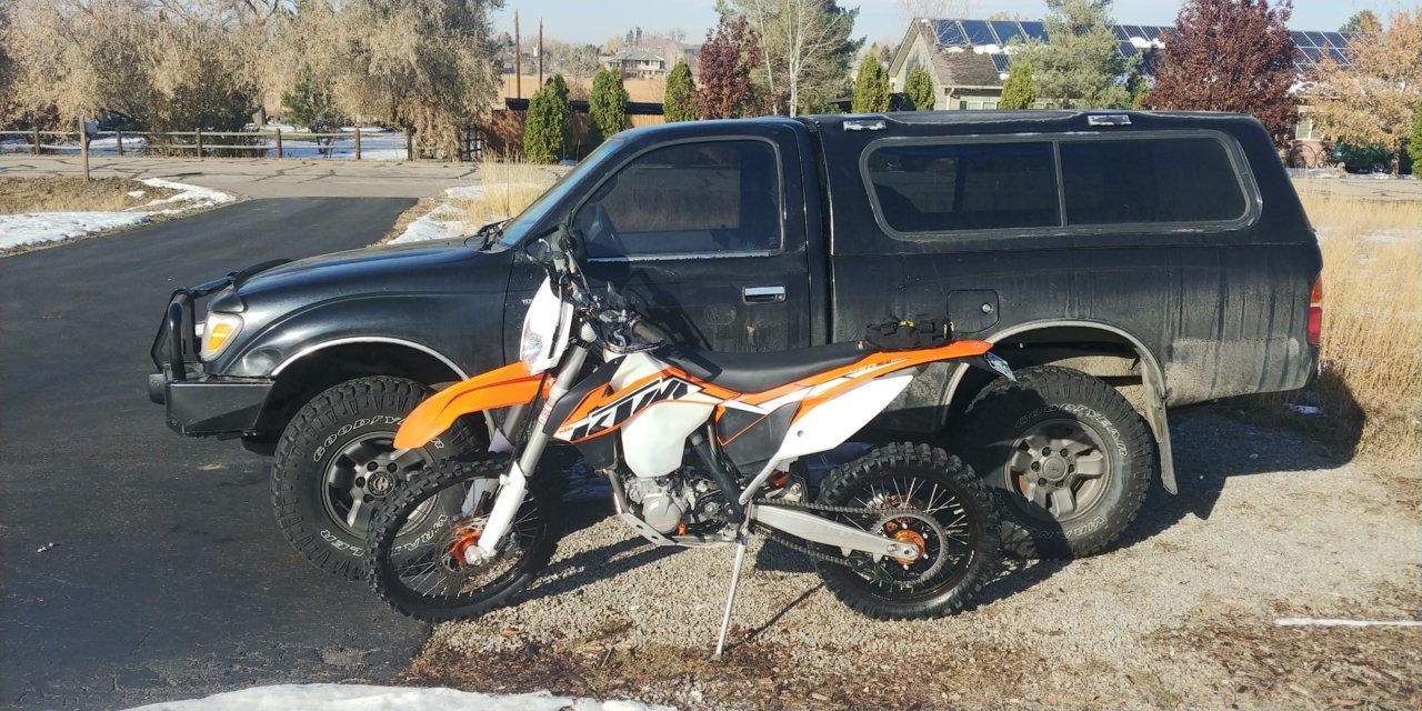

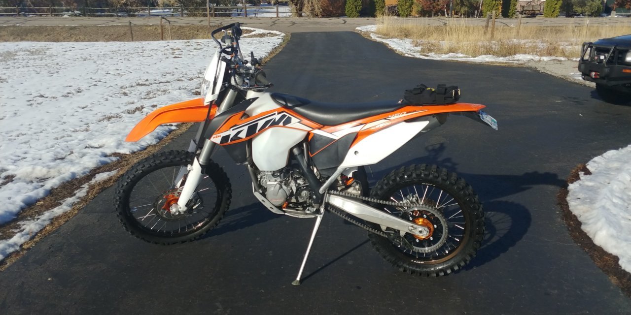

    Got the new (to me) KTM home and prepped for the winter. Burt on the other hand needs a good wash after this last trip to the front range, I got stuck behind a Plow spraying for 15 miles so its sufficiently covered in road grime.
