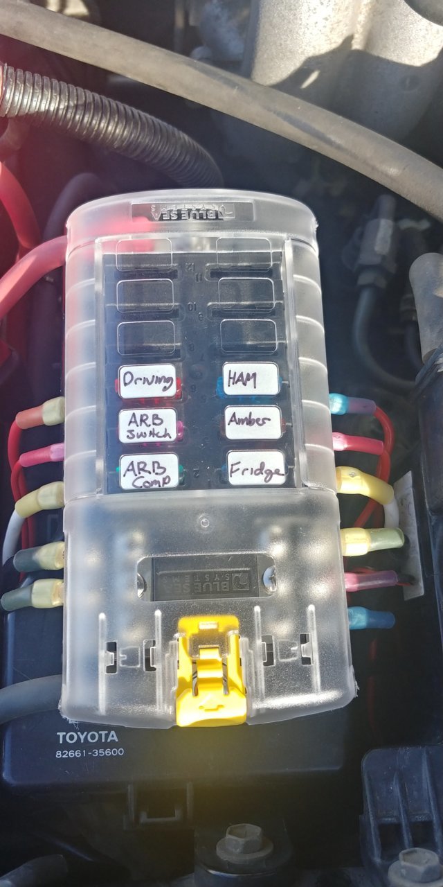

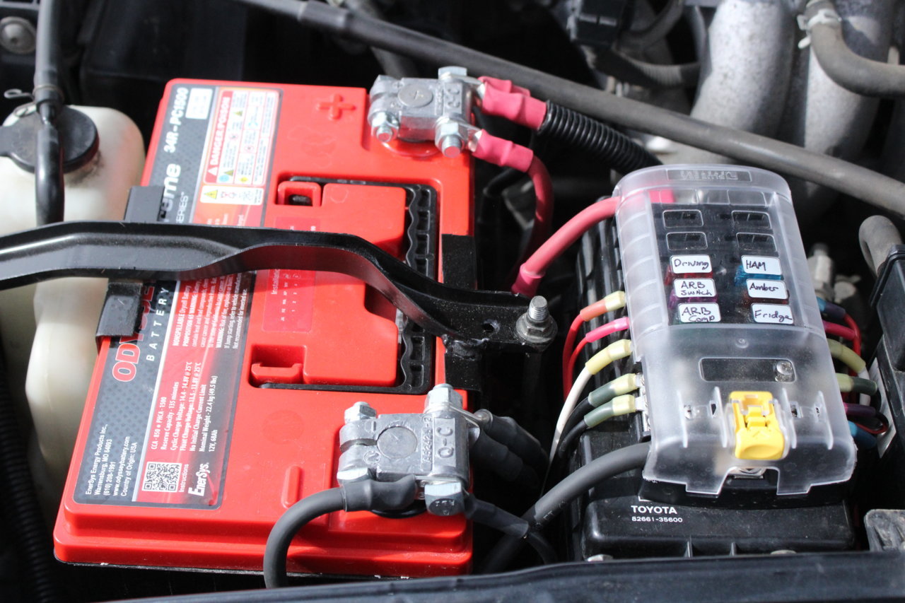

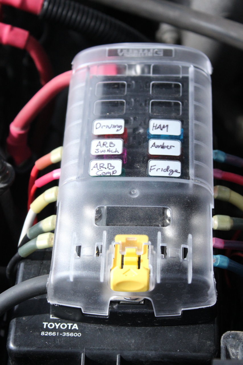

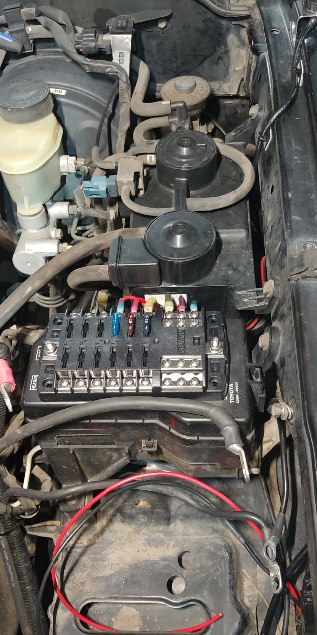

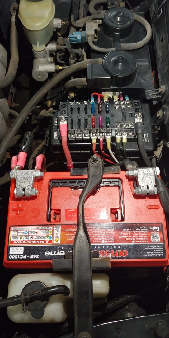

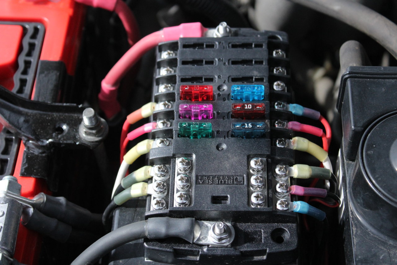

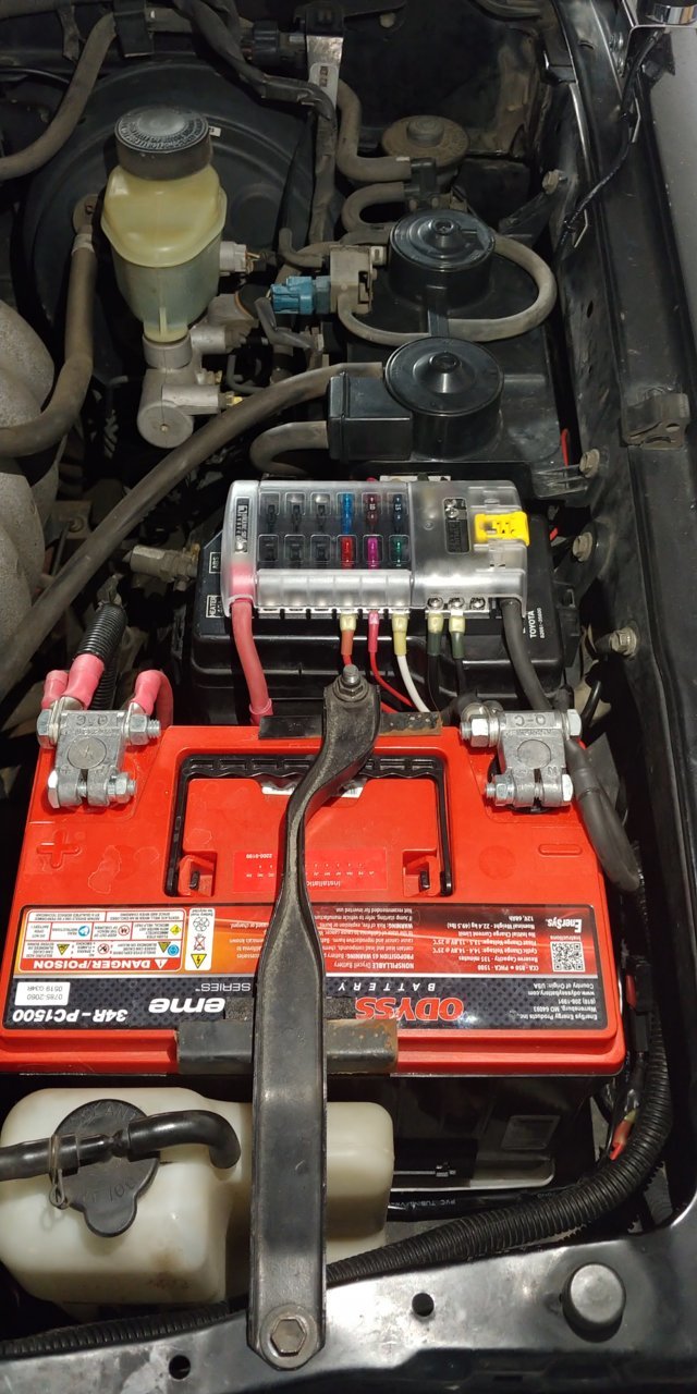

    I thought about mounting mine aux panel on the fuse panel lid, decided to try the other side, that monstrosity of a charcoal canister is just too effing big!

    Yea I wish we didn't have the charcoal canister in the engine bay. Jealous of the space that the 01-04's have in that spot since it's under the bed on theirs.

    The ARB is definitely the right fit for the early first gen Tacoma’s.

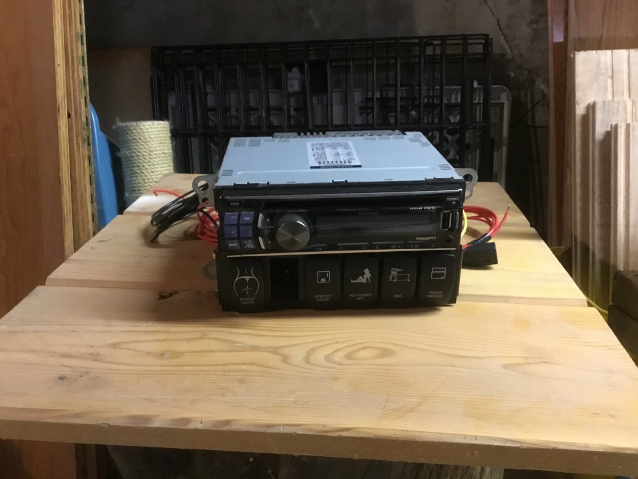

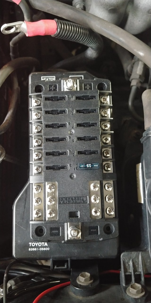

    Hey Wyatt, I have a semi stupid question, are your switches hooked up to the dimmer-dash lights rheostat? Did you need to run a separate ground for that? I am hoping to get neck deep in my switch plate finalizing later this month:
    and for the fog lights and moose lights:

    That first pic looks like Many Parks overlook, so the rest were of Fall River rd? It has been awhile since I worked there- summer of 82’ Lawn Lake flood, that was quite a mess. Still a great place to check out, probably getting harder to find a time frame when it isn’t overrun with people though.
    Burt is looking good..

    So as far as I know, Toyota dash lights dim via a voltage changing GROUND, not a positive. I haven't had first hand experience but from what others have said about adding dimming switches to the factory dash rheostat as a ground. Double check that first but that's what I remember hearing from a couple people. So no my switches are not dimming, the light is only on when the switch is activated which is what I prefer.

    Thanks Wyatt,
    I am in the same boat, I only want the lights on the switches when they are on, too many things lit up in the dash area as it is.

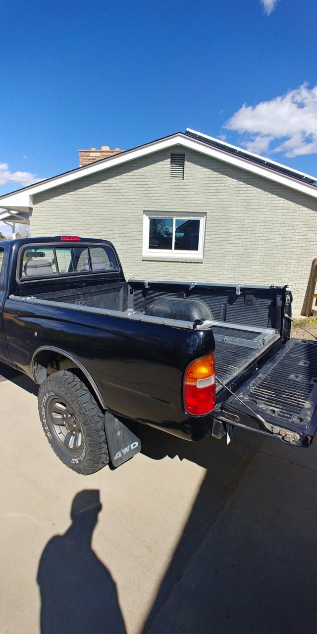

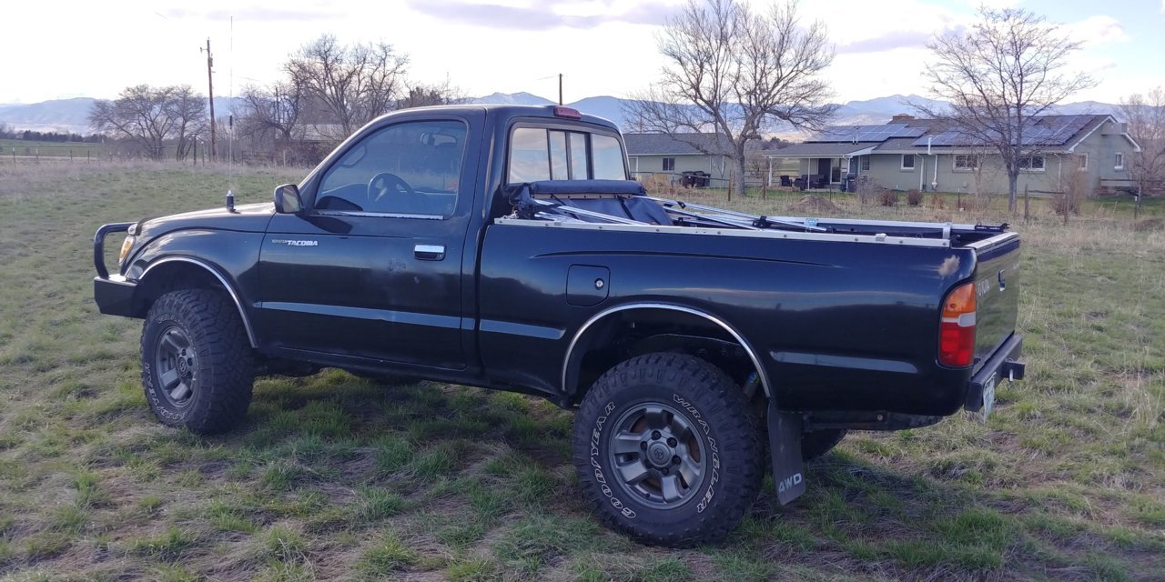

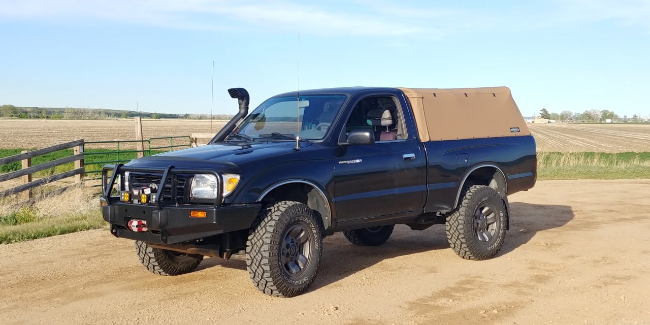

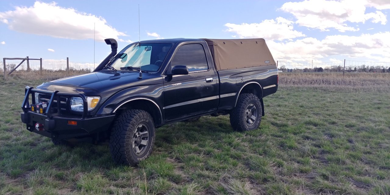

    Damn, looks like I once again forgot about a build thread. Shocker :bananadance:

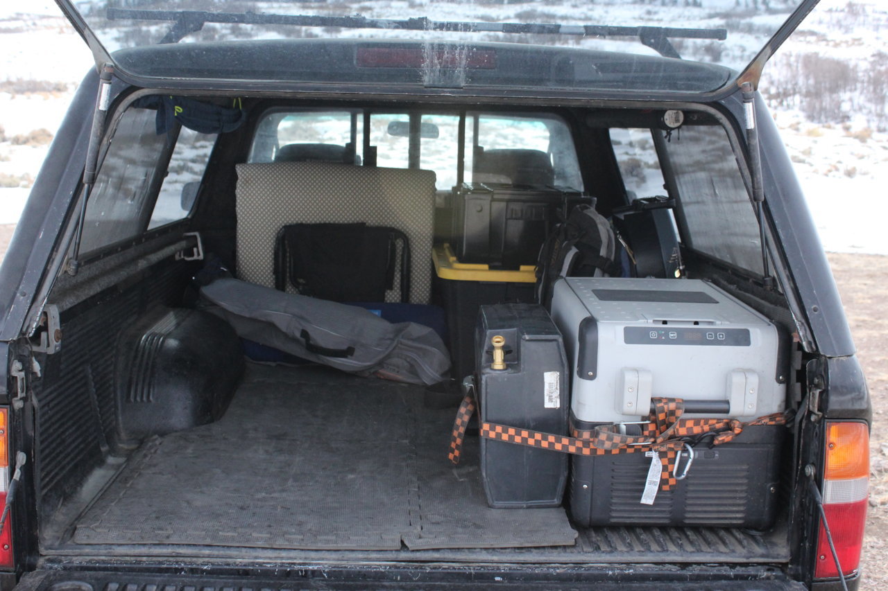

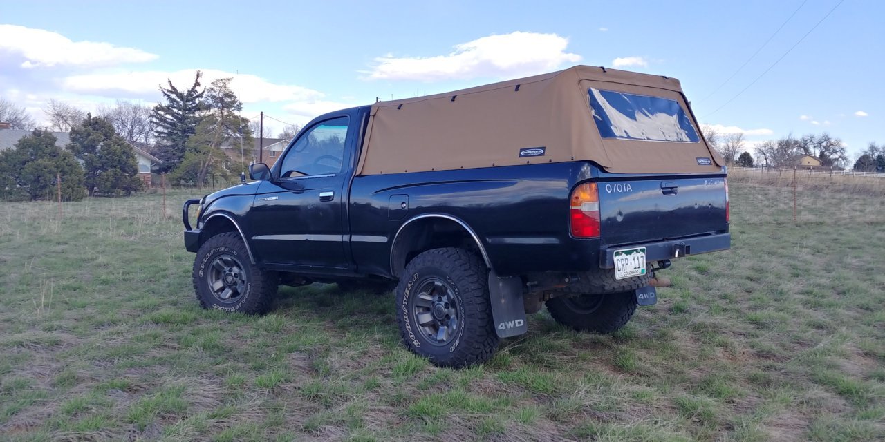

    Well I looks like last time I left off, I had just installed my fridge slide in the bed in April. So the fiberglass topper sold almost instantly upon posting a photo of the truck on instagram without it. As far as the replace well, Here it is!
    0331201607_HDR.jpg 0331201608d_HDR.jpg 0331201608a_HDR.jpg 0331201615_HDR.jpg 0331201615a_HDR.jpg 0331201630_HDR.jpg 0331201630a_HDR.jpg

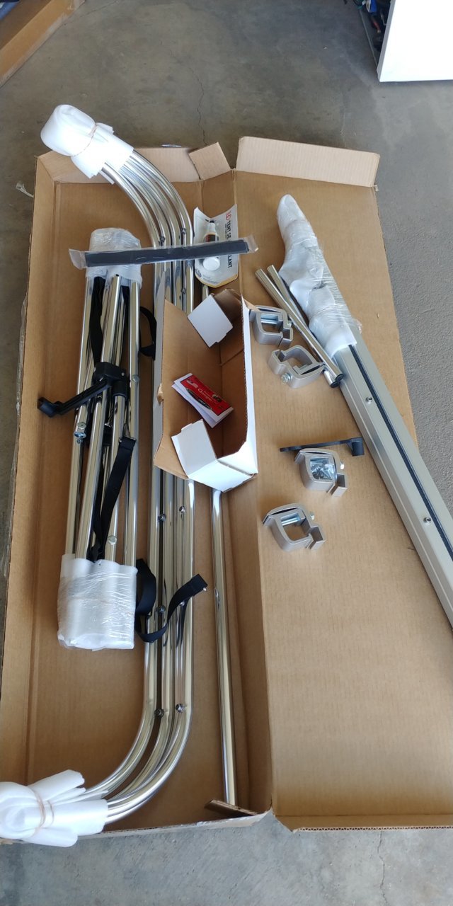

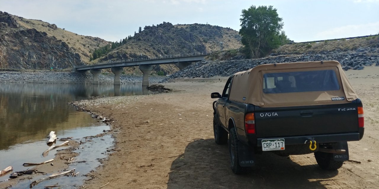

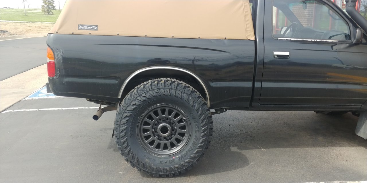

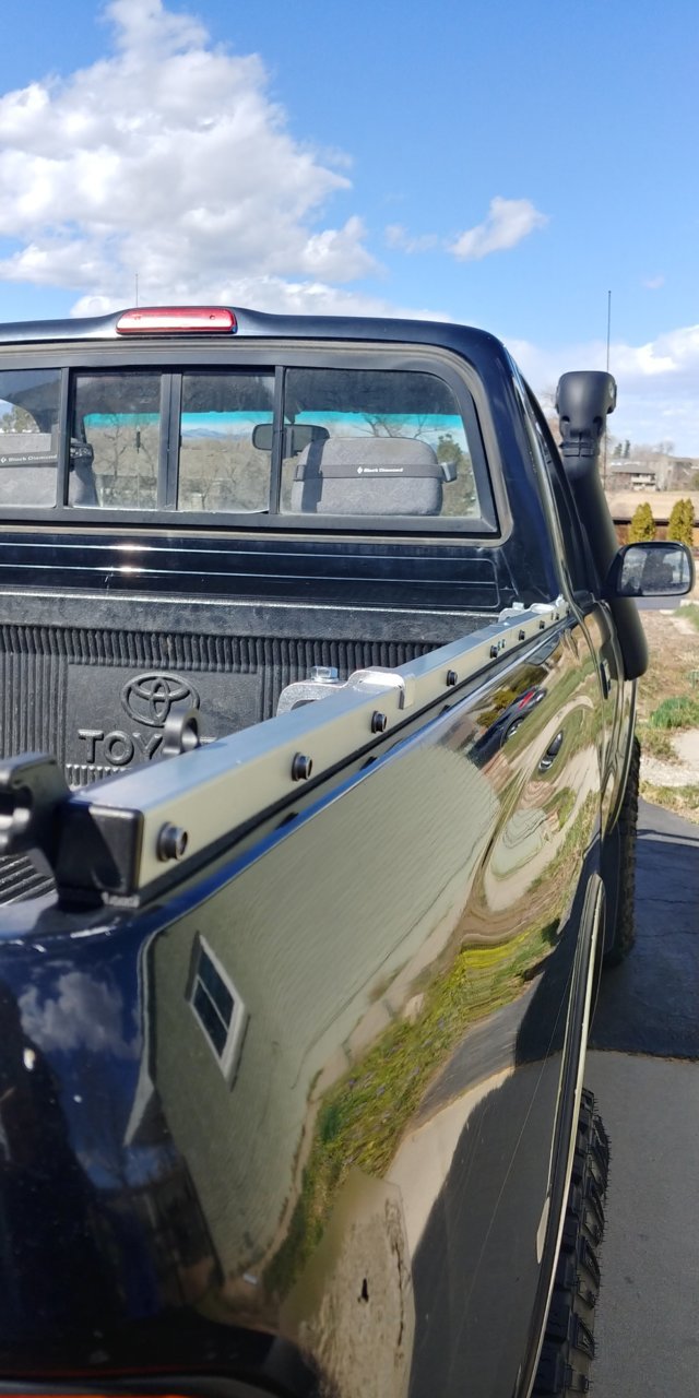

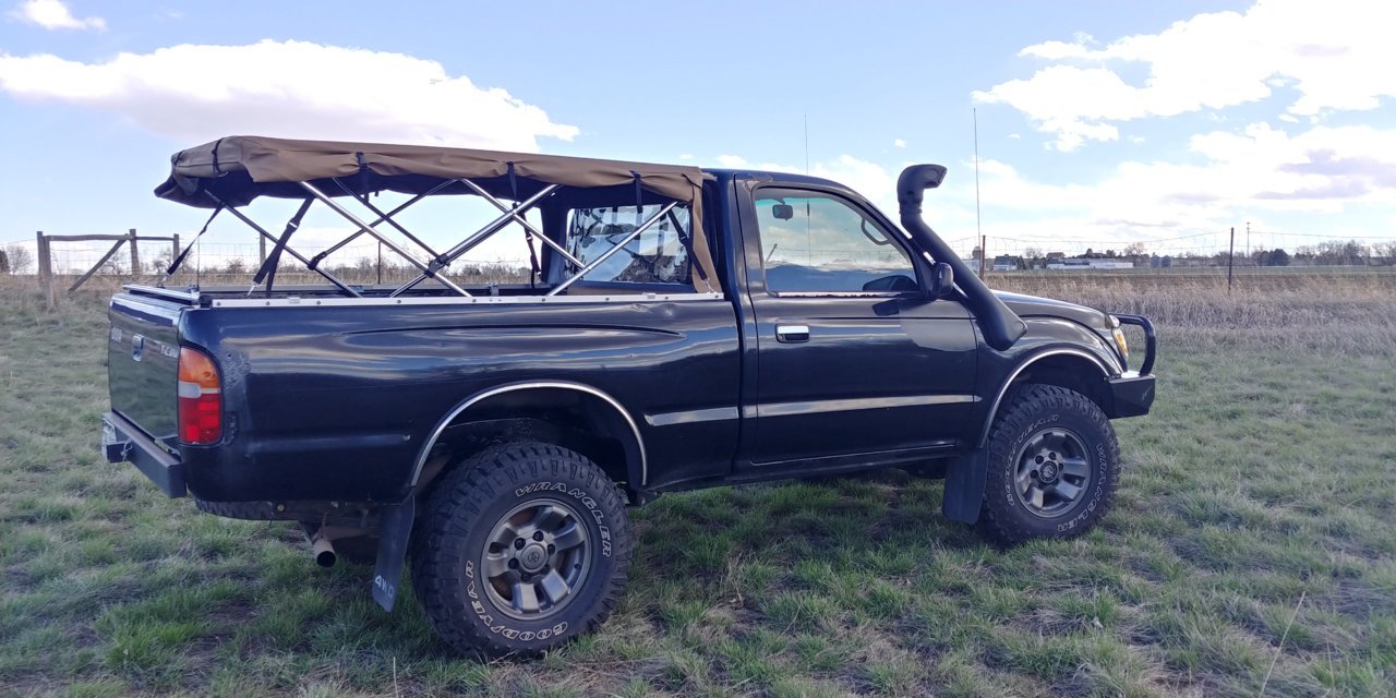

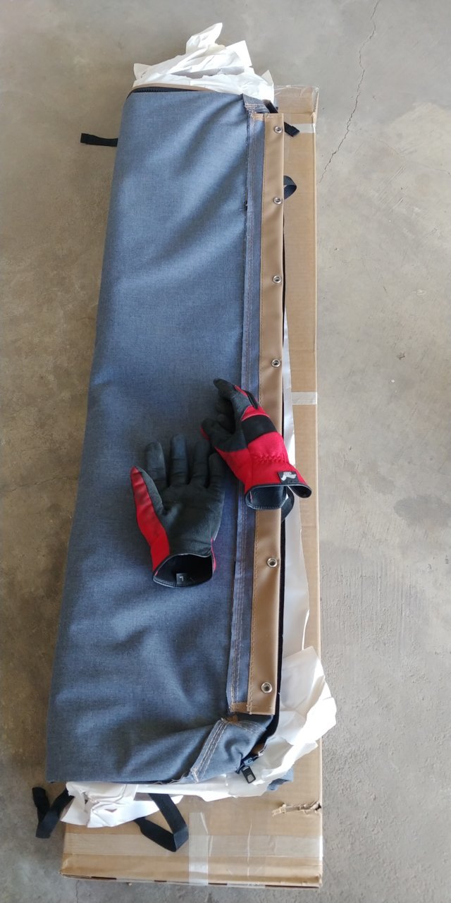

    A ditched the fiberglass topper for a soft topper.
    Where's why:
    Weight savings, The fiberglass topper with 3 sliding windows, carpet, and rear glass was in the 175-220lbs range. At 8k feet and a 4cyl its a very very noticeable amount of weight. So having a 20lbs topper is a huge weight saving.
    Functionality, The ability to go from having a topper to having an open bed in less than 2 minutes anytime, anywhere, without having to grab the tools, I couldn't be happier. with my choice to switch.
    Once I have it for about a year I'll write a bit of an update review, especially after the winter.

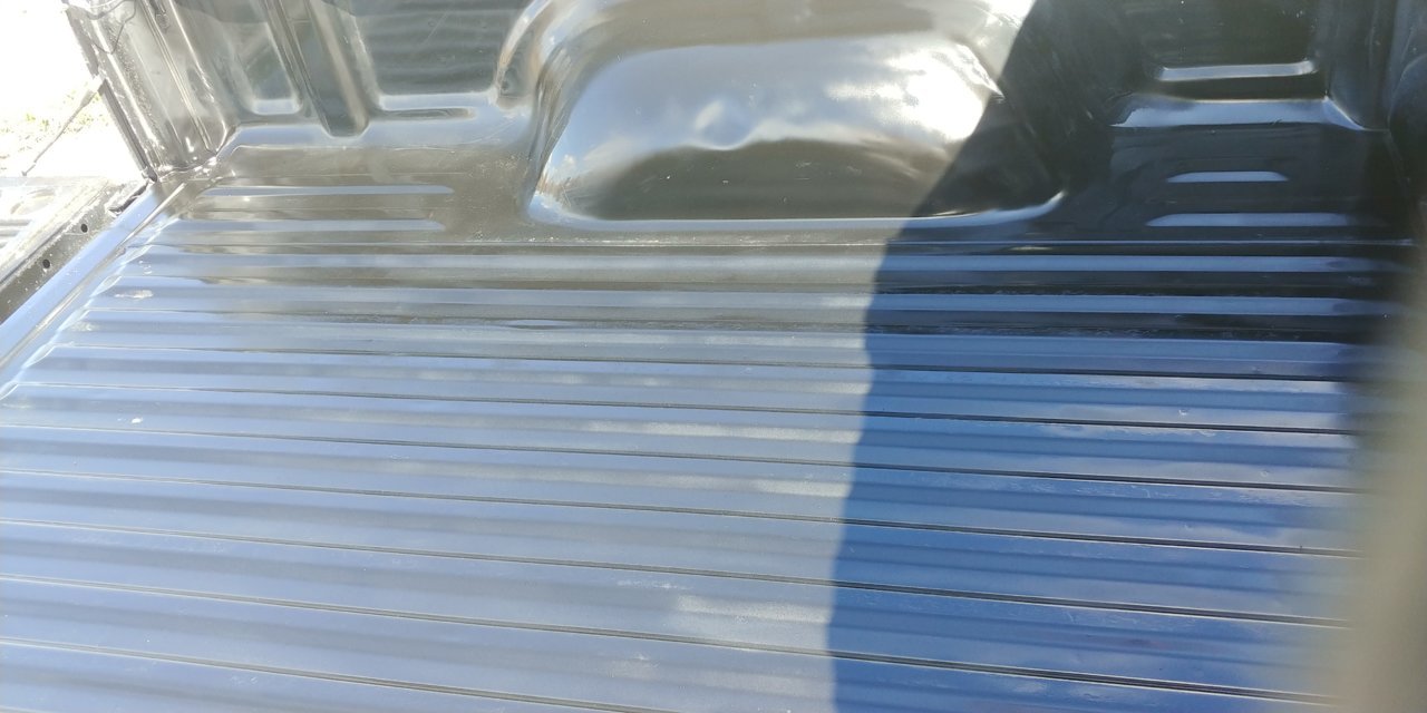

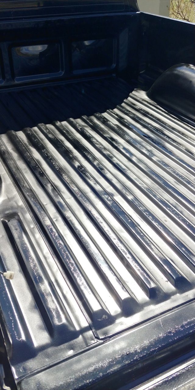

    In preparation for the soft topper install I wanted to pull the be liner out and paint the spots on the bed that had been rubbed off by the liner. well that just turned into me painting the entire interior of the bed. But now I wont have to worry about water getting under it and rusting any time soon.

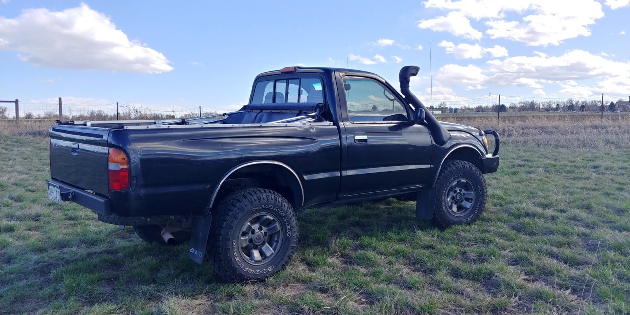

    Some random photos from quarantine.
    Probably could fit with a sawsall :sawzall::welder:

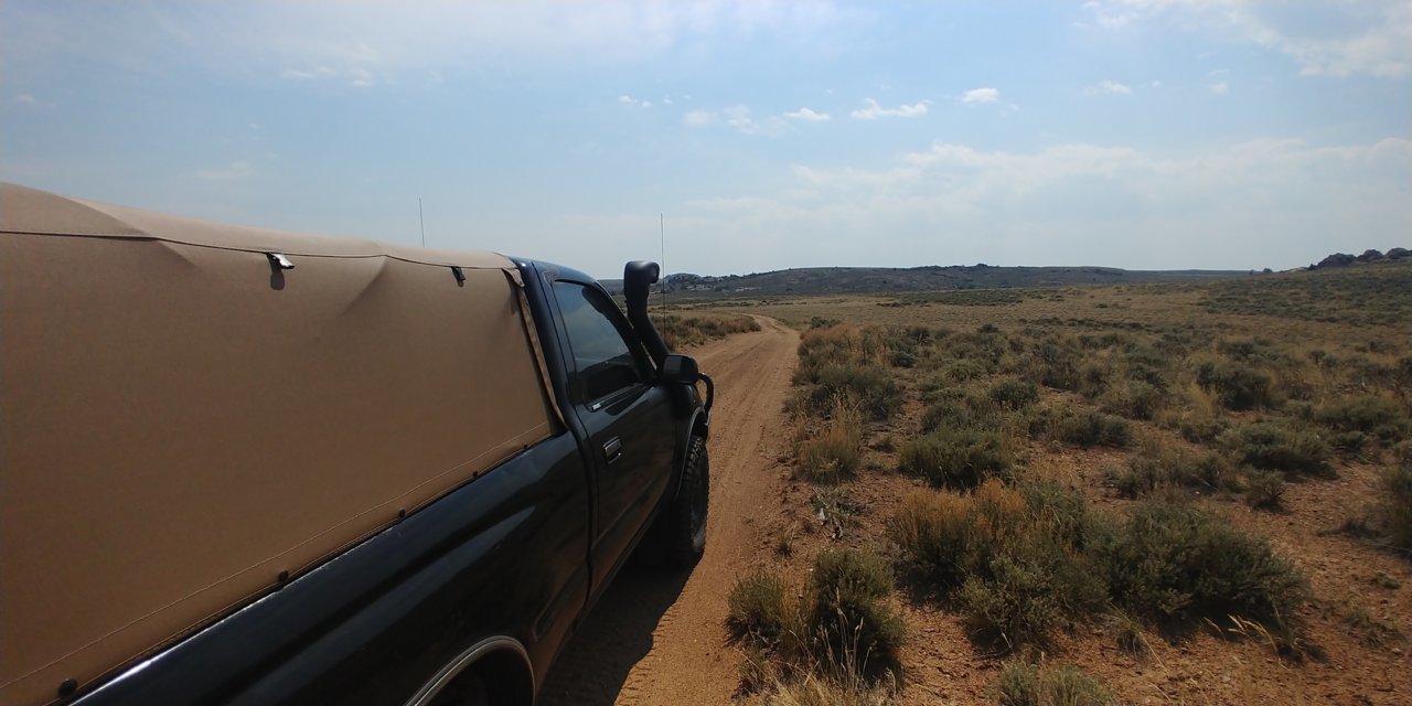

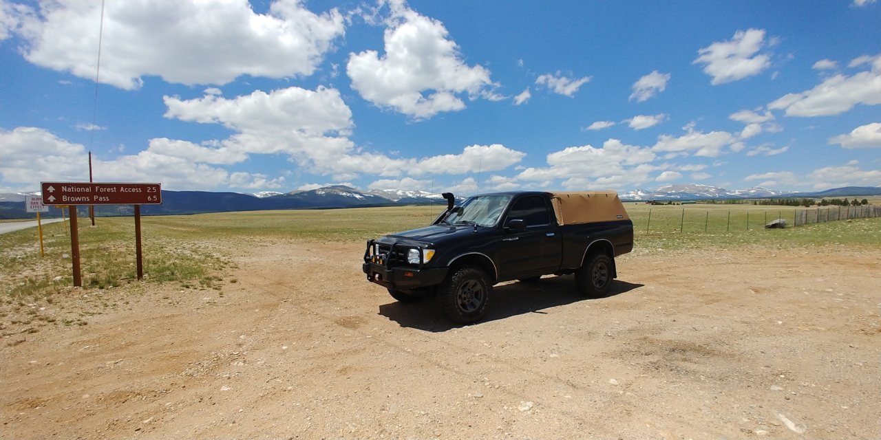

    A few nice photos down some dirt roads near where I was staying.
    0516201828.jpg 0516201828_HDR.jpg 0516201833b.jpg 0516201834b (1).jpg 0516201834.jpg

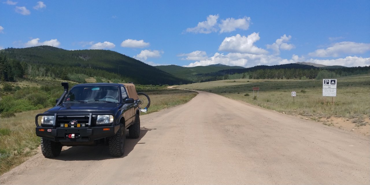

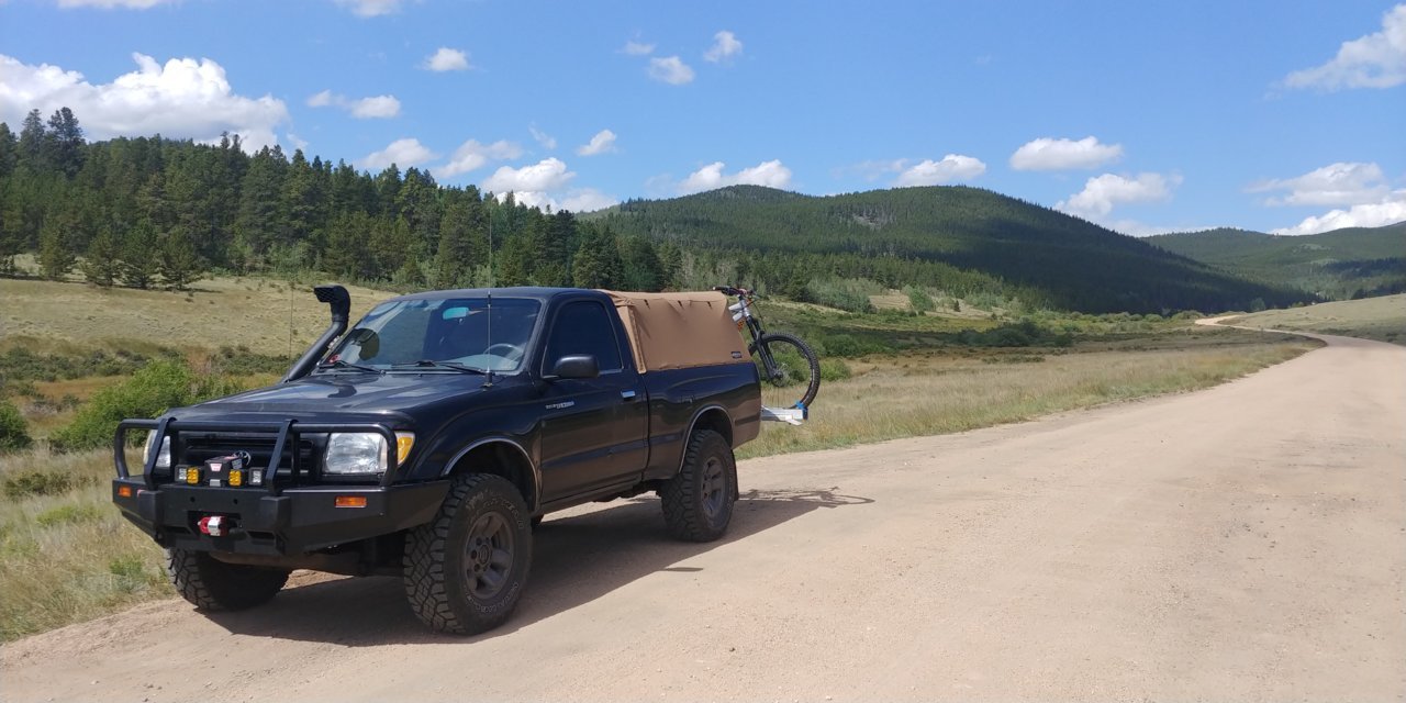

    Mid June I finally got out camping in Burt again. Before that I just was staying in a RTT that we have mounted on a utility trailer that hauls the dirt bikes on riding trips.
    I do like the new topper but the sliding windows with screens were nice for camping with the fiberglass topper, but even in a pretty good wind storm I was able to get some good sleep with the softopper.
    0614201307a_HDR.jpg 0614201308_HDR.jpg 0614201307b_HDR.jpg 0614200935a_HDR.jpg

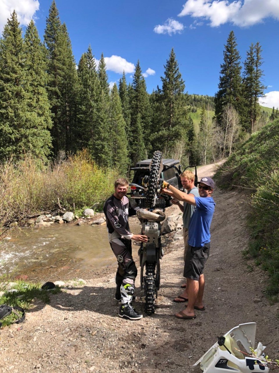

    Did a bunch of dirt bike trips during this time as well. Here are some of the better photos from those trips in no real order.
    0428201955_HDR.jpg 0527201932.jpg 0527202019.jpg 0528200929_HDR.jpg 0529201518b_HDR_2.jpg 0530201250a_HDR.jpg 0530201251_HDR.jpg 0530201317b_HDR.jpg IMG_20200602_205241_727.jpg IMG_20200602_205246_467.jpg 0616202117_HDR.jpg 0626201325_HDR.jpg 0722202021_HDR.jpg IMG_20200724_204704_267.jpg IMG_20200724_204706_250.jpg IMG_20200724_204709_471.jpg 0730201236_HDR.jpg 0812201419_HDR.jpg

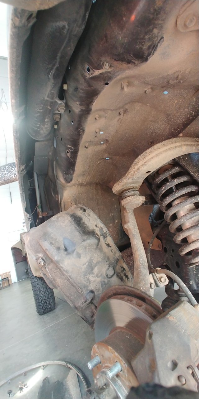

    Burt has started to have a couple little issues so I have the things on order to fix him back up after the last year of abuse.
    Basic maintenance things plus a fuel filter, coolant for a full flush, thermostat, and a new exhaust system since the muffler has been falling apart since I bought the truck, and I think its gotten bad enough to be blocking a considerable amount of flow.
    I am in the process of sea foaming the truck, I have half a bottle in the tank currently and I did a 1/4 bottle through the intake, and it definitely feels much smoother, and brought my idle up from 600 to 750 with a better overall ability to start and doesn't drop down to 350-400 when I push the clutch in while driving. I throw the rest of the bottle into the oil about a hundred miles before I change it just to clean everything out.
    But I have gotten out a but lately exploring Gunnison more and my girlfriend and I took a drive to Gothic this morning while looking at the leaves changing.
