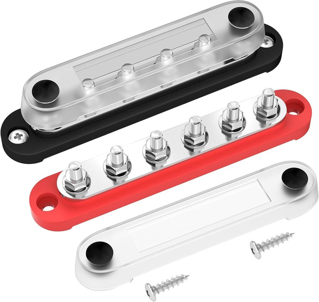

    Currently, I have two light bars and will be installing some reverse pods and possibly under the hood lighting. Looking to clean up the wiring in the engine bay. I have the negative bus bar sorted but looking for guidance on the positive bus bar.
    Do I simply run a wire from the positive battery terminal and connect it to the positive bus bar then add all the positives from the accessories?
    What gauge wire from the battery to the bus bar?
    Where would be a good place for the positive bus bar? On top of fuse box? other?

    Yes, run a larger wire from the battery to any terminal on the bus bar, same as your ground. Just make sure you have a fuse and relay in-between your bus bar and accessory. It would also be smart to put a circuit breaker or fuse rated for the sum of your accessories in between the battery and the bus bar just incase something shorts the bus bar or your main power wire.

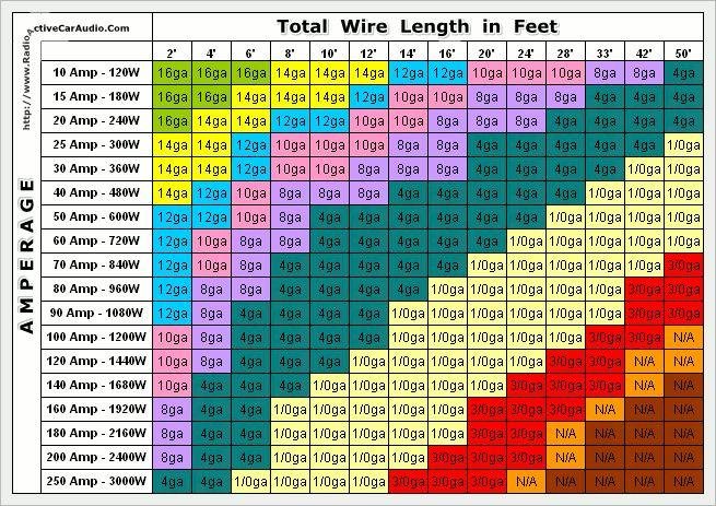

    The gauge depends entirely on wire length and expected amperage draw. Just follow a table like this:

    So gauge appropriate wire from neg terminal to neg bus bar. Gauge appropriate wire from positive terminal to positive bus bar with a fuse or circuit breaker in between.

    The way those charts work is by determining percent voltage loss, like 1, 3, or maybe 5% depending where you find it. So if you break up your entire cable run and size each segment using the chart, you'll end up losing more than the specified percent. That's why it says total run. I have a calculator I made for sizing wire without the guesswork, but you should just oversize the leads going from your battery terminals to the bus bars, then use use the chart as intended for your accessory runs. If you know your amperage loads and wire lengths I could tell you exactly what I'd use.

    Yes, I understood the chart (thank you for that). I just needed to figure out the total amps of the lights which is 21.17.

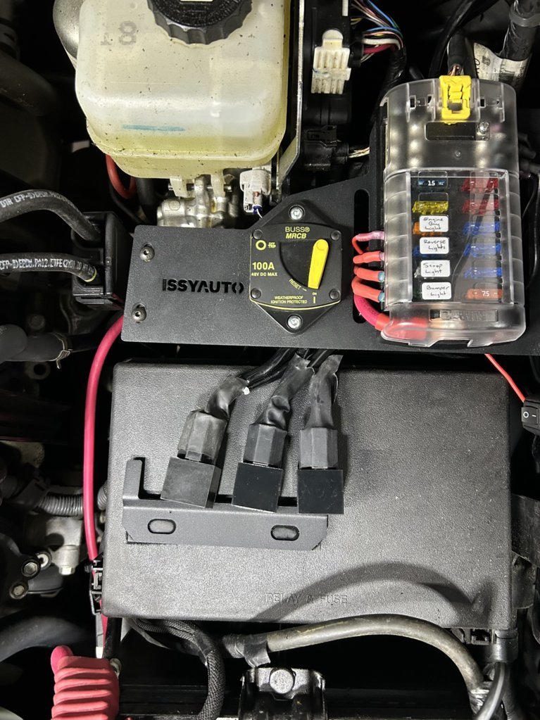

    For anyone following or for future searches, I decided not to do the bus bars and went with a fuse block.
