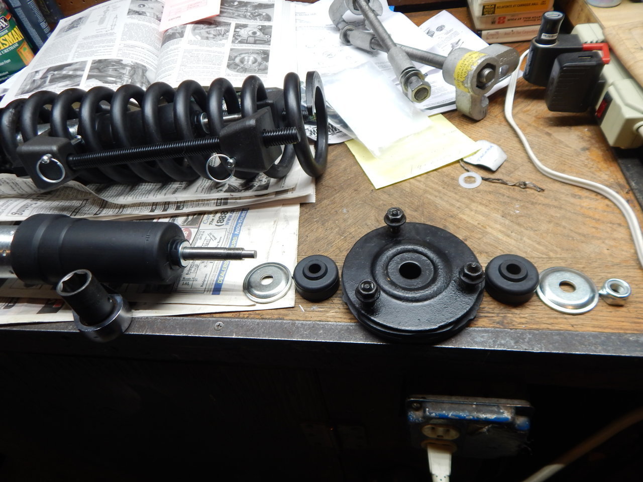

    Here’s what I had ordered when I had 5100’s and got the same shock of it not having all the necessary parts for install.
    Dick4x4[OP] likes this.

    Thanks man, that seem to be exactly what I'm looking for or at least the best real solution. I ordered them and I will see. Thanks again for your input, that is greatly appreciated. You give me my faith back into forums! ;)
