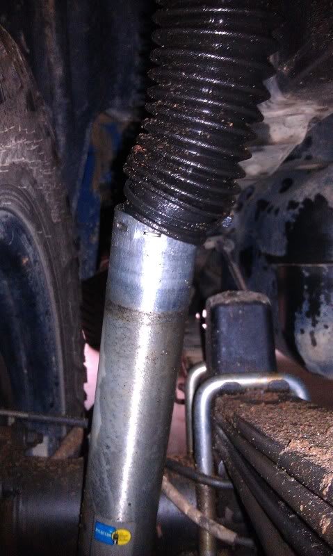

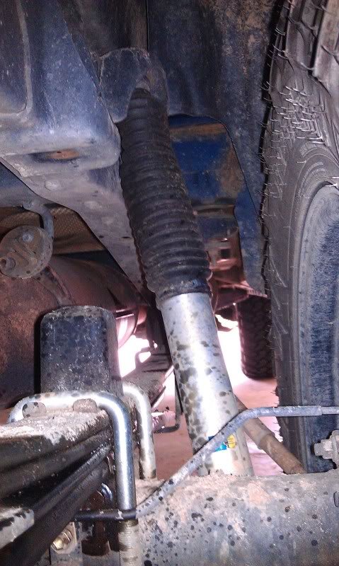

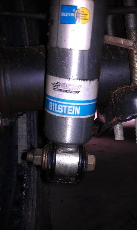

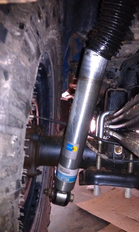

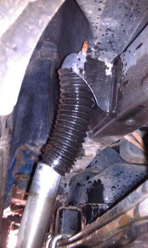

    So, I kept hearing a "clunking" noise from the rear today when I was out and about. Here's what I found. Busted rear shock. I went wheeling about two days ago, and that's probably when it happened. When I wheel, I don't do anything hardcore. . . climb a few hills, cross a few creeks, and trail ride. The ONLY reason I can think of is my 2" AAL. I thought the rear 5100's could handle a 2" lift? What do you guys think? Here's a video of the sound, and a few pics.
    http://www.youtube.com/watch?v=9HautmivO7U
    Driver side 5100
    Passenger side 5100(normal) Just sprayed some WD40 is why there's some residue.

    dbronzo recently busted his as well...over extended the shock more than likely.

    I agree with Jamie it look like you might have topped out the shock, that would cause the shock to break, and the boot to slip off like it did.

    That's what it looked like you did the 5100 are not long enough to let your springs fully droop with out maxing out.

    Downsouth is working with RCD who has the 5100's "made for them". What I understood is RCD had their own numbers, but the shock was the same from RCD or Bilstein. Not sure now, but from what I read on the Blistein site it seems they are designed for stock applications. :confused:
