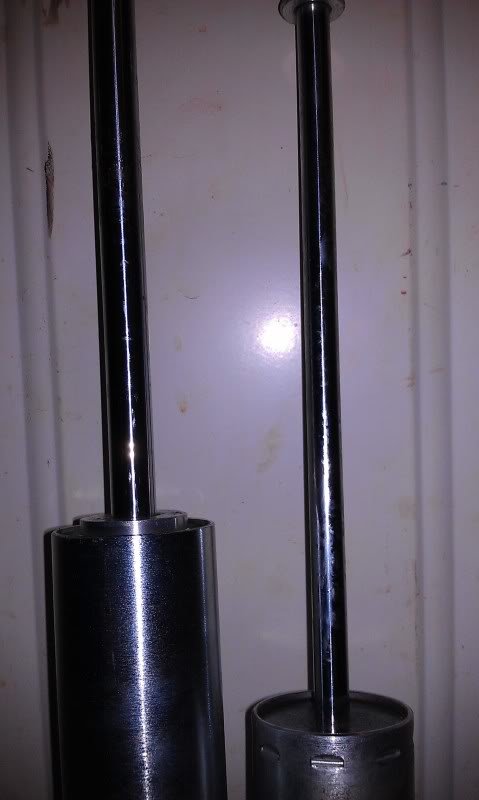

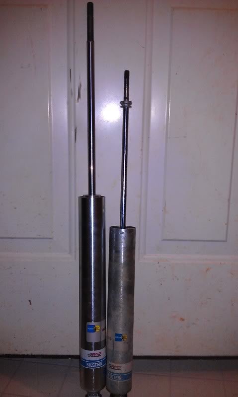

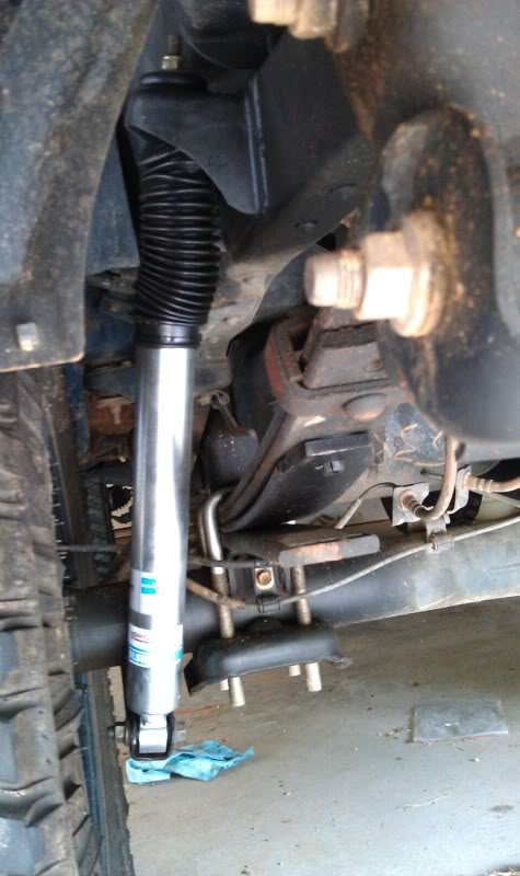

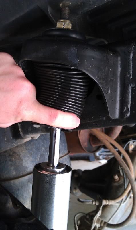

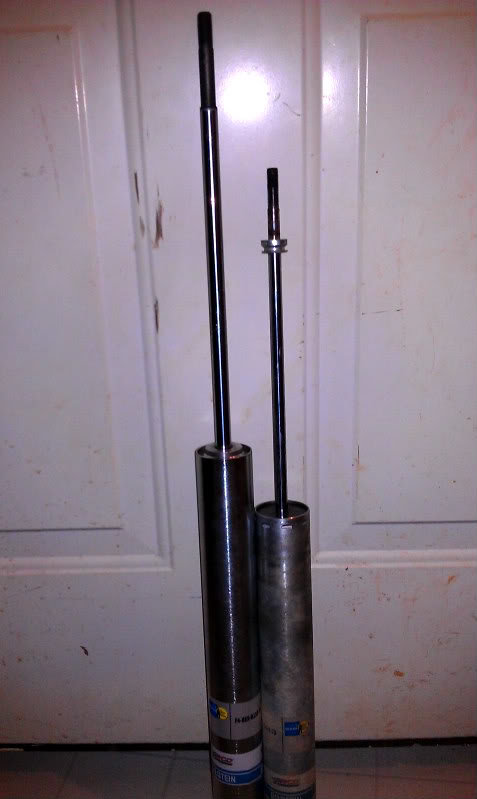

    UPDATE:
    So I finally got the chance to take some pics of the new 5100's. I haven't had time to wheel with them yet, so I don't know for sure yet if they're collapsed length is too much, and I don't have any measurements/pics of flex. The new, longer, 5100's are much beefier than my old ones. They even require larger bushings/washers. The old hardware DOES NOT fit the stem of the new ones. Here are some pics.
    Thanks again DSM for your excellent customer service. I didn't make this thread expecting any sort of refund, but you stood up and made things right w/o question. I work in retail, and know about customer service. Y'all are top of the line!
