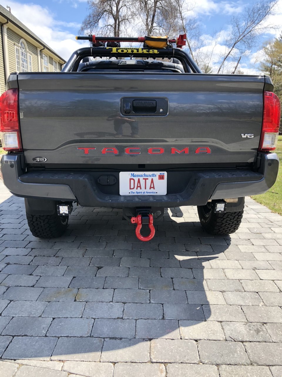

    Nice plate! :D

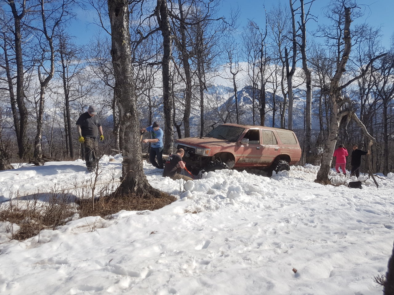

    Yup, having maxed out an 8000 pound winch and using a snatch block this weekend, that's a big deal for me.
    Here's a pic of the 4runner we had to use the snatch block on and even then barely moved.
