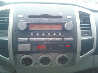

    If youe are talking about the trim peice around the 3 AC control knobs, it is so easy to pop off with a flathead screwdriver and paint it black, thats what I did. Ill try to get some pics on later

    Sweet man. That's exactly what I was looking to do. I thought I had to swap out the entire a/c controls and stuff. I hope the color match was right on. I already have the black side vents and when the stereo gets replaced with a nav/touch screen, I was going to have a black backing as well.

    Yeah, thats gonna look sweet man and should be a piece of cake! I just poked a pocketknife above the trim piece between the 2nd and 3rd knobs and pried down a little bit then was able to just pull it out with my hands. You have to do this to get at the bolts that hold on the headunit anyway for when you swap it. Then you just unscrew the trim piece from the AC control box thing from the back and paint:D The silver rings around the three knobs will still be silver though:( i don't think there is a way to get them black and still have the symbols

    I love how mine turned out don't worry about not doing it right I just gave it two coats of Krylon fusion thats it!
    Also painted the shift area black and a pillar handles (only downside is that dust does show a lot more)

    I didn't like that little chrome trim thats why I painted that peice in the first place. I just used satin Krylon fusion spray paint from walmart about $4

    ^ very nice. I shall consider that. I guess there's no need to swap a/c controls. Haha.
    Lesson: Take the plate off and spray paint it.
    Case Closed!
