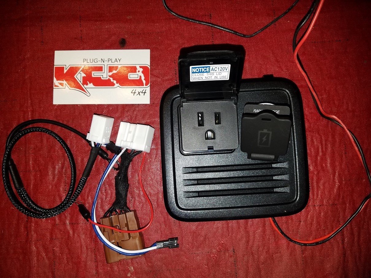

    For us non-electricians can someone explain how to wire? I am cutting the plug off of one of the recommended desk/grommet receptacles and will have three bare wires to connect to...what, exactly?

    You can do it with no cutting.
    Unplug the vehicle harness.
    Insert the plug and play harness.
    Connect the two JST connector
    Take the remaining white connector and plug it into the back of the Toyota AC outlet https://www.amazon.com/dp/B00SHGJ1BS

    I am using the Toyota bezel shown on the first page. I am cutting a hole in the back of the center console, for the rear passengers to have access.

    Sorry, I just re-read your post. I misread. Which outlet are planning to use? Do you have a picture?

    I gotcha. But then you don't have any USB connections. I guess the other way is to cut off the smaller white plug and use those three wires (blue, white and black) to connect to the wires coming from a 3 prong outlet, right?

  8. Oct 22, 2019 at 12:52 PM
    #268
    fatboyfirebass
    fatboyfirebass Well-Known Member
    Mar 24, 2018
    #248258
    1,064
    2018 Blk TRD OR DCSB MT6 Prem/Tech Pkgs
    OV Tuned, S&B Intake, MBRP Dual black Cat-back, accumulator delete, URD SS, 2LM, SSO Hybrid bumper/Warn 10kSynthetic, Custom Car Grille, MESO Ultimate Turn Signal in KTJO Power Folding Mirrors, Genesis Dual Battery, BHLM with LED upgrade, Fog delete, Geko Bed & Underhood lighting, Rear camera anytime, Nav Block Override, 400W anytime w/ interior outlets, USB charging stations, DE-badged, TVD blackout kit, HiLux interior door handles, Hybrid SS/Delrin Shift Knob, Cali-Raised bed Stiffeners, Ultimate Tailgate Seal, "El Dorado" Dual-quad horns, Diamondback HD cover, Mobtown engine/trans skid plates, RCI control arm skids, JLT oil catch can, Meso overhead Hex rack.
    I have a second port for the USB. I am direct wiring that to the DC outlet already in the console.
    Here are all my parts laid out
    KTJO 4x4[OP] likes this.

    You'd just have to make sure you get them to the correct terminals.

    Right. Now I'm thinking I don't even need to smaller harness--just cut the small black plug off the blue and white wires and solder them to the cord from the plug.
