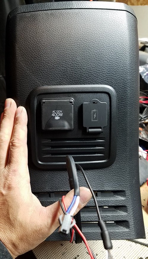

    I got my center console torn out and started to play with the wiring, but it got a little dark in the driveway. So, I decided to spend my time tonight working on the bezel and outlet. I'll get back to hooking up the wires tomorrow.

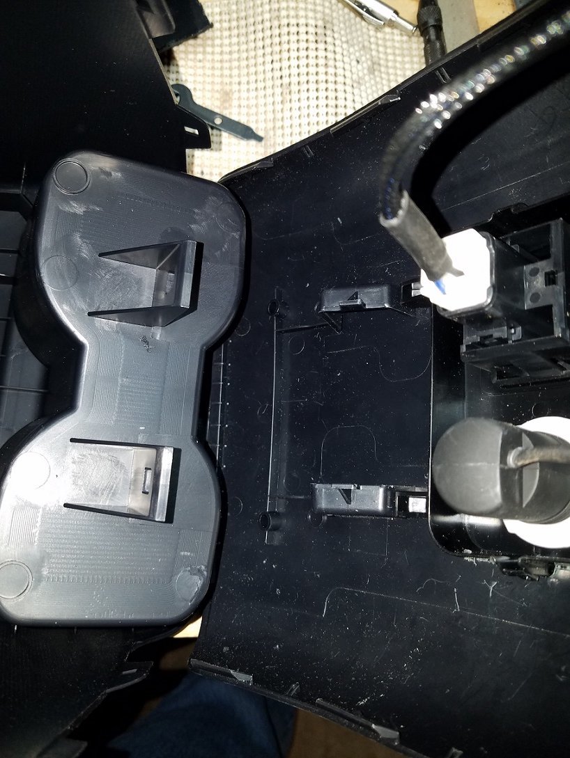

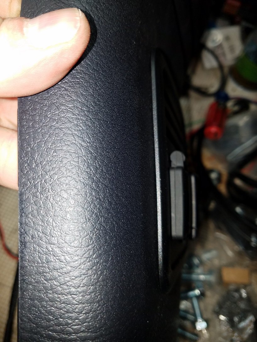

    I did end up cutting away the entire "shelf?" on the backside of the console panel.

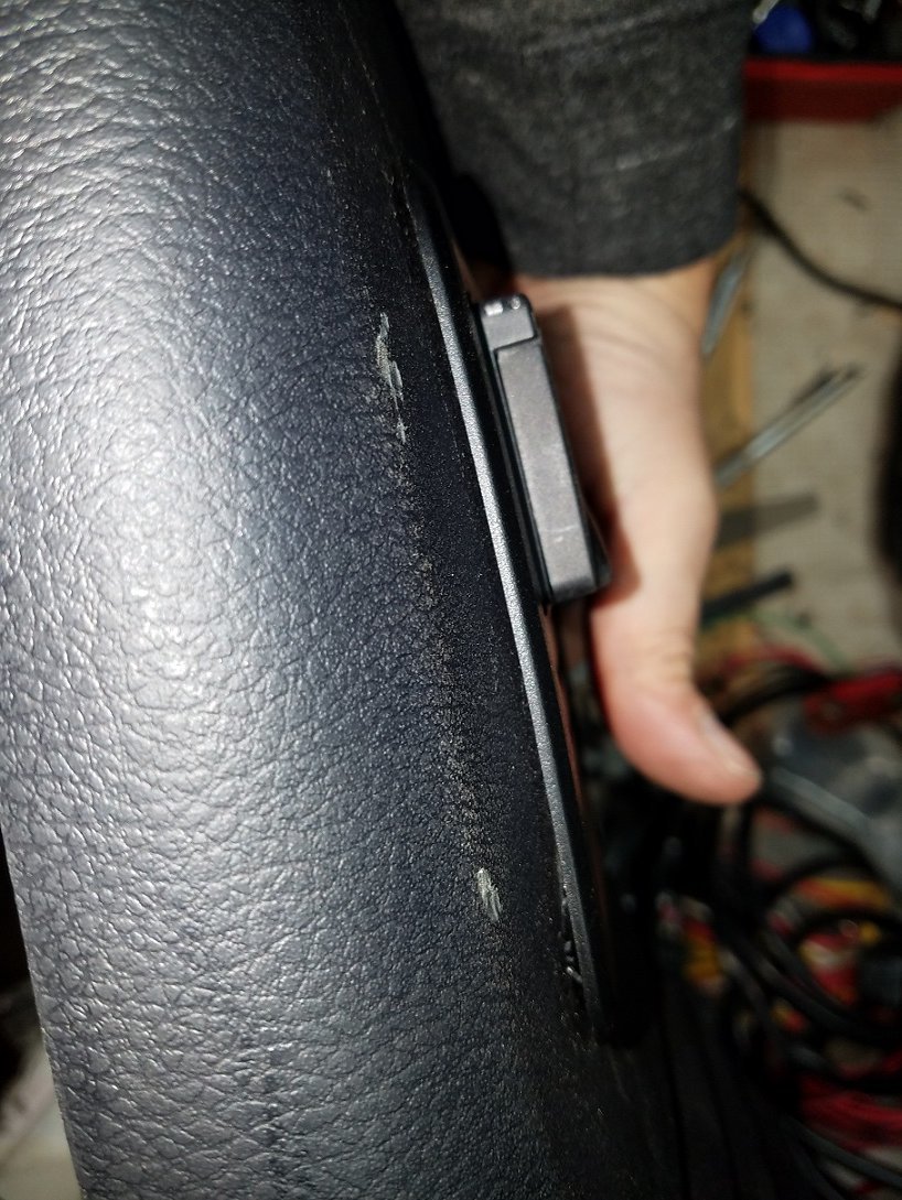

    Pro tip: put painters tape on the ENTIRE panel before you start in with the dremel. 2 layers if you can. My hand is covering 2 small blemishes from the lock collar on the dremel tool.
    I did not cover enough of the panel before I started.
    It's not bad and a little back sharpie and some dirt from rear passengers and it will bend away into history.
    But, if you are looking for pristine... cover the whole thing before your start

  4. Oct 25, 2019 at 6:19 PM
    #284
    Pyrotech
    Pyrotech Well-Known Member
    Nov 25, 2018
    #273741
    3,013
    how well does the panel fit the curve on the console?
  5. Oct 25, 2019 at 6:37 PM
    #285
    fatboyfirebass
    fatboyfirebass Well-Known Member
    Mar 24, 2018
    #248258
    1,064
    2018 Blk TRD OR DCSB MT6 Prem/Tech Pkgs
    OV Tuned, S&B Intake, MBRP Dual black Cat-back, accumulator delete, URD SS, 2LM, SSO Hybrid bumper/Warn 10kSynthetic, Custom Car Grille, MESO Ultimate Turn Signal in KTJO Power Folding Mirrors, Genesis Dual Battery, BHLM with LED upgrade, Fog delete, Geko Bed & Underhood lighting, Rear camera anytime, Nav Block Override, 400W anytime w/ interior outlets, USB charging stations, DE-badged, TVD blackout kit, HiLux interior door handles, Hybrid SS/Delrin Shift Knob, Cali-Raised bed Stiffeners, Ultimate Tailgate Seal, "El Dorado" Dual-quad horns, Diamondback HD cover, Mobtown engine/trans skid plates, RCI control arm skids, JLT oil catch can, Meso overhead Hex rack.

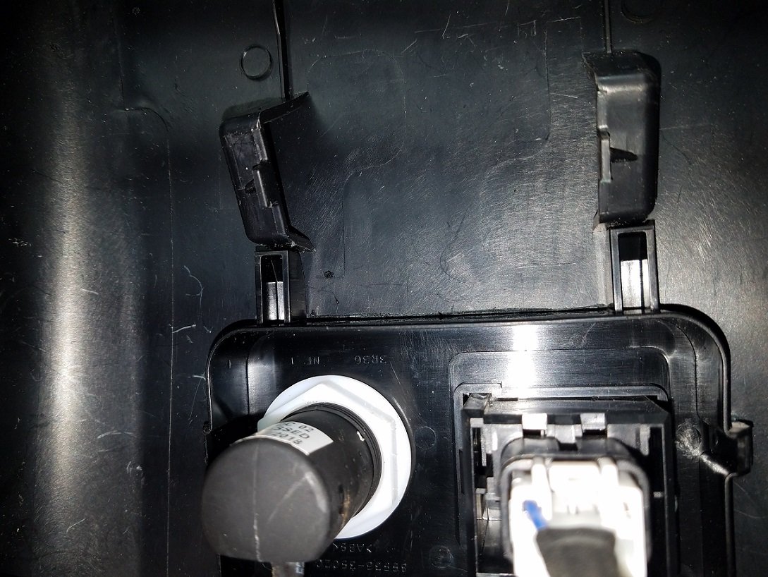

    pretty well.There is a small gap when the curvature of the panel changes. if you star with a small opening and trim to fit, you can get a pretty nice fit. You will have to press hard to get the snap features to full engage.
    When you start laying it out, You have to be careful because the bezel has "horns" on the top, that slide back behind the panel when you mount it. You have to center the bezel so they sit below a couple of snap features on the back of the panel. Don't cut the snap features off. You need them when you snap the panel back into place with the center cubby. The latch to the rear cup holder feature. I will post up a few pics in a couple minutes.

    I literally just tried mine without trimming the backside. I fit it in between the protrusions on the back. It did not like the curve. I think I may just mount the stuff on its own straight through that piece.
    The wiring though is about 30 seconds.

    I have some extra work with the manual transmission. That's why I am waiting till tomorrow to start into it.
    EDIT: After a quick test drive, no extra wiring needs. Make sure you get a good ground on the red wire, and everything else is taken care of in the PNP harness.
    It's all good: in neutral or in gear, clutch in or out, open driving or with cruise control. 400 Watts on demand. Thanks again @KTJO 4x4

    It turned out nice. Maybe I'll try again. I would've cut all that crap on the back, but I wasn't sure if it was needed.

    yeah the latches at the top are needed. I have no idea what that goofy angled shelf is for. But it definitely interfered with the bottom of the bezel. I started out trimming a little at a time, but in the end, it's all gone.

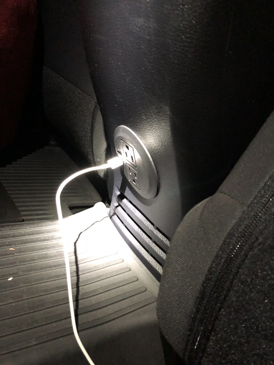

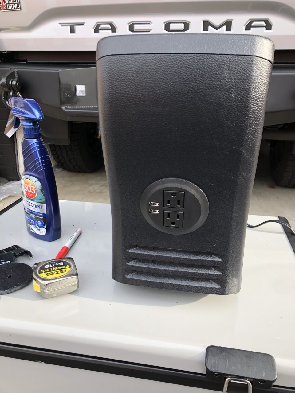

    That has a built in transformer/converter for USB outlets? No need to tap into the power outlet in the storage compartment for the DC?
  13. Oct 26, 2019 at 8:26 AM
    #293
    Grossomotto
    Grossomotto Complete 3rd Member
    Mar 13, 2018
    #247175
    8,446
    39.9526° N, 75.1652° W
    2017 4WDV6LB6MT
    Yeah the USB runs from the AC in the grommet

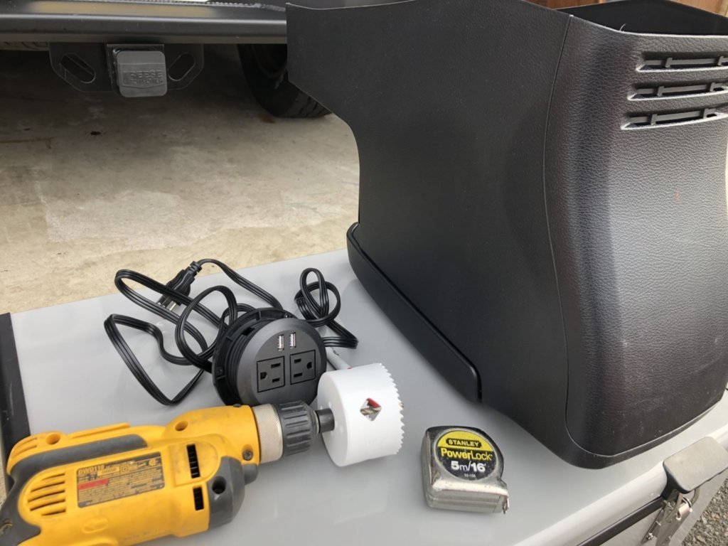

    I agree. This one only took a 2" hole. Other than requiring a little splicing I think it comes out better than the factory parts.

    Where did yours come from? It's a little different from the first one.
