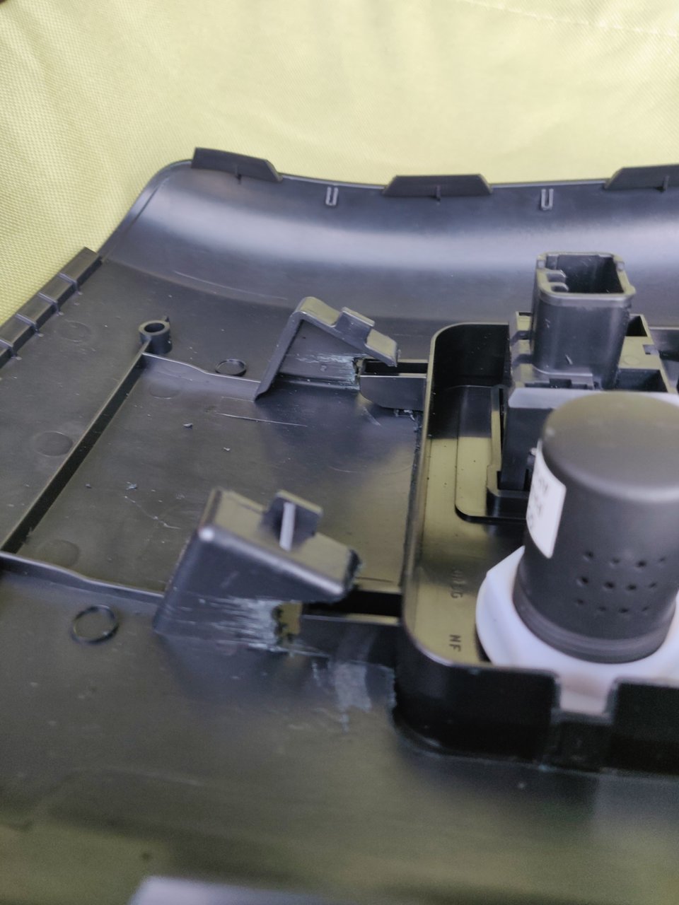

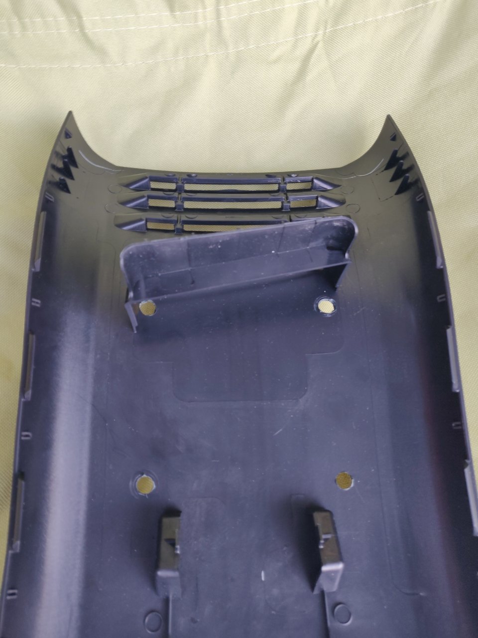

    Mounted mine on the back of the middle console:
    I just barely missed the bottom protrusion so that didn't need trimming, but I did trim just a tiny bit of the top protrusions. @fatboyfirebass mentioned the top ones are needed, so I left them mostly intact. I'm not necessarily sure that they actually are needed, but why not err on the side of caution?
    Right now, it's a very tight pressure fit but I might go back and plastic epoxy it in since plugs are subjected to pushing and pulling. It is really easy to get that back piece of the middle console off without removing anything else. It just pops out!

    Care to expound on this...

    180
    Yes...please.

    Move floor mat, pull from bottom first, then swing it out with the top as the hinge.

    Yep exactly. There are clips every 2 to 3 inches. Push in at the seems while pulling out working your way up. Don't be afraid to push kind of hard while levering it out with the top as the hinge. There is a lip at the top of that panel that holds it in, so keep on levering until all the clips are undone, then pull it down/away at a 30° or so angle.
    You might be able to see some of the clips in this image.
    sfcacique and SliMbo4.0 like this.

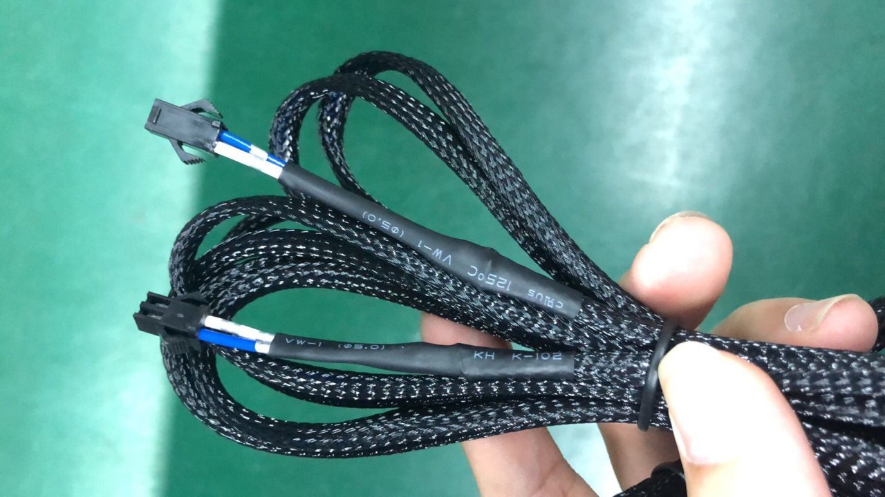

    UPDATE:
    Well my vendor has made the test Extension Harnesses for the 5ft and the 10ft. They will be sending them to me with some other testing Harnesses as well as my order of 30 SR5 Power Folding Mirror Harnesses. They will just be the Blue and White Wire. Remember you can ground the Black Wire anywhere on the Truck so that’s not an issue. The Blue and White Wire will always go back to the Harness unless you change it up yourself. Here’s just a quick shot of them.

    I hope you don’t mind but I used your picture on post #2 :D if you do I can remove but I thought it was a great example to show everyone.
