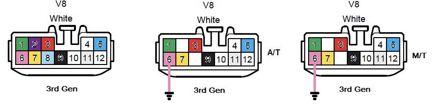

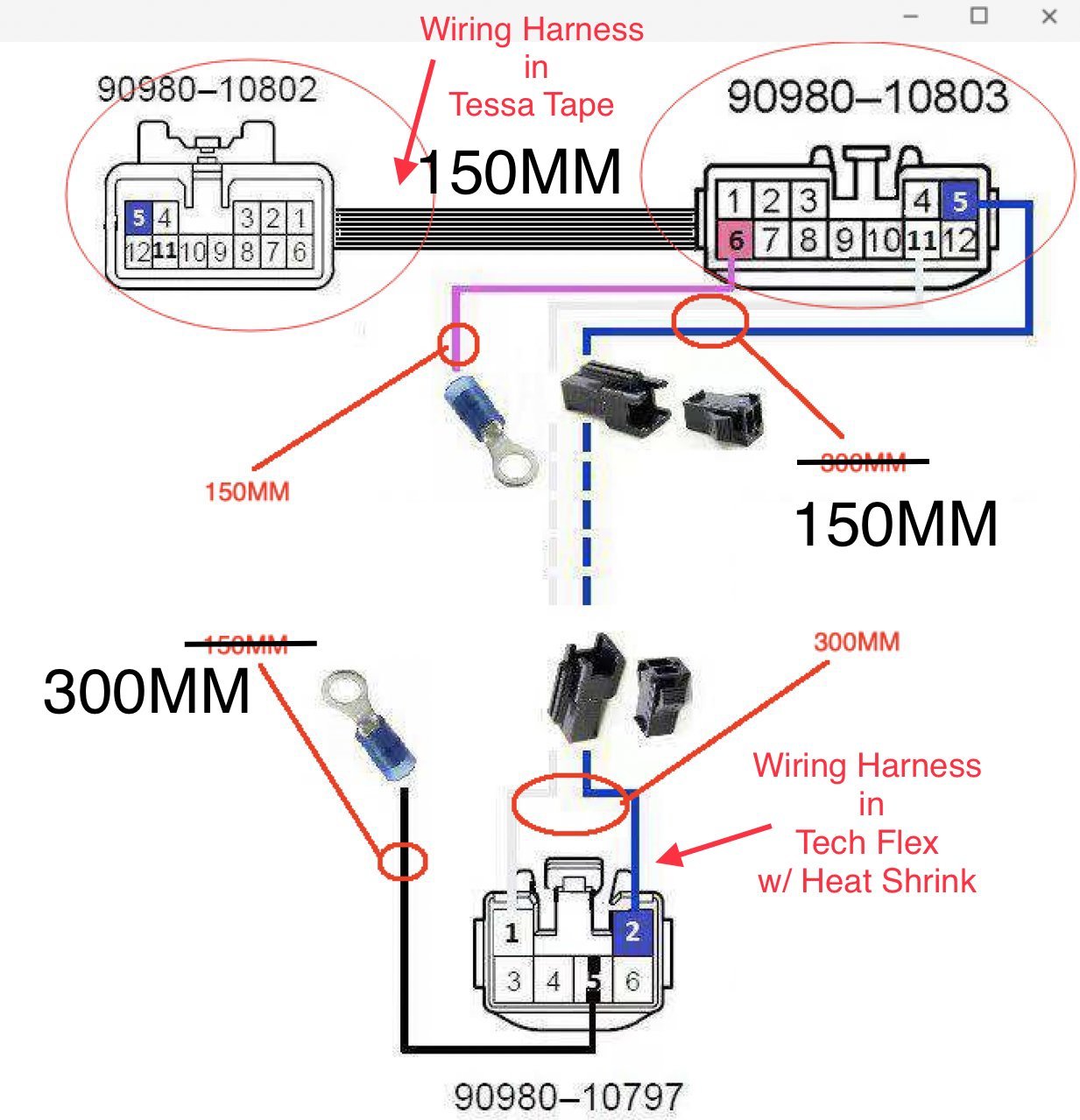

    RECAP FOR PNP HARNESS & OPTION 1:
    Here is the breakdown for the Inverter Connector from OEM to the Conversion Connector that I will have in the Inverter PNP Harness for the AC Outlet/400w Anytime Mod:
    I will be removing the #2 PURPLE Wire, the #6 PINK Wire is getting Grounded from the Inverter Side, and there is no #8 LIGHT BLUE Wire. Therefore, in the V8, the following Pin Slots will be empty without any Black 20/22ga Wires coming out of them: #2, #4, #8, #10, and #12.
    Here is the Wire Diagram:
    The wires coming from the Inverter PNP Harness will all be 150MM in length that are each 20/22ga and matching the OEM wires wrapped with Tessa Tape. These will be similar to my PNP Harnesses for the Tailgate Lock Kit. They will have two 6” “V” Wires that are 18ga coming out of Pin Slots #5 (BLUE Wire) & #11 (WHITE Wire) with a mating JST Connector on the end and one 6” PINK Wire coming out of it with a Ring Terminal on the end with Heat Shrink to seal the Ring Terminal. The JST Connector will make it easy to convert to any OPTION: 1, 2 or 3. There may also be an OPTION 4 developed later on that allows for OPTION 1 and 3 in a way for a total of 4 OUTLETS.

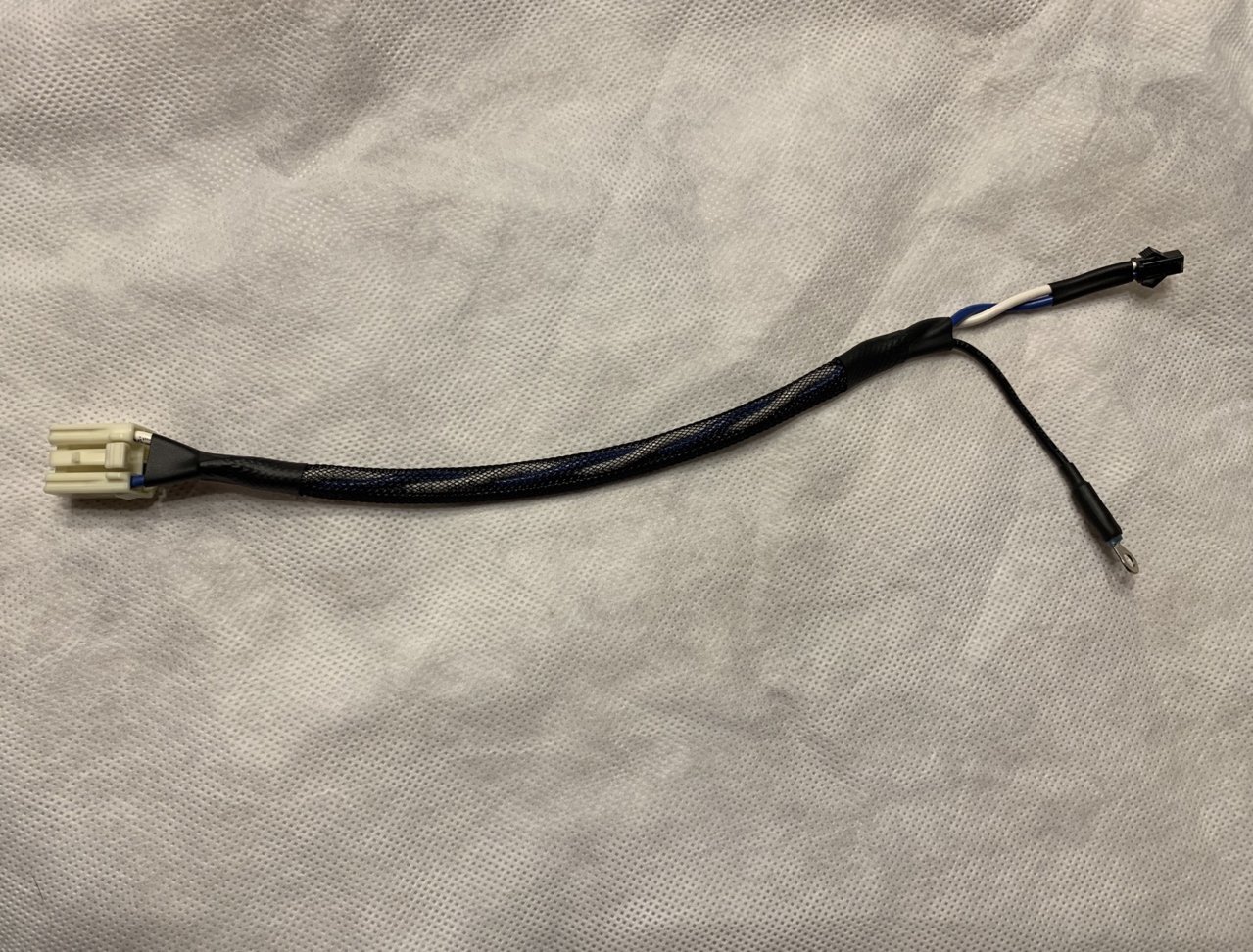

    Now for OPTION 1 KIT:
    This Wire Harness will have two 12” Wires that are 18ga coming out of Pin Slots #2 (BLUE Wire) & #1 (WHITE Wire) with a mating JST Connector on the end and one 12” BLACK Wire coming out of it with a Ring Terminal on the end with Heat Shrink to seal the Ring Terminal. The JST Connector will connect to the JST Connector from the Inverter PNP Harness.

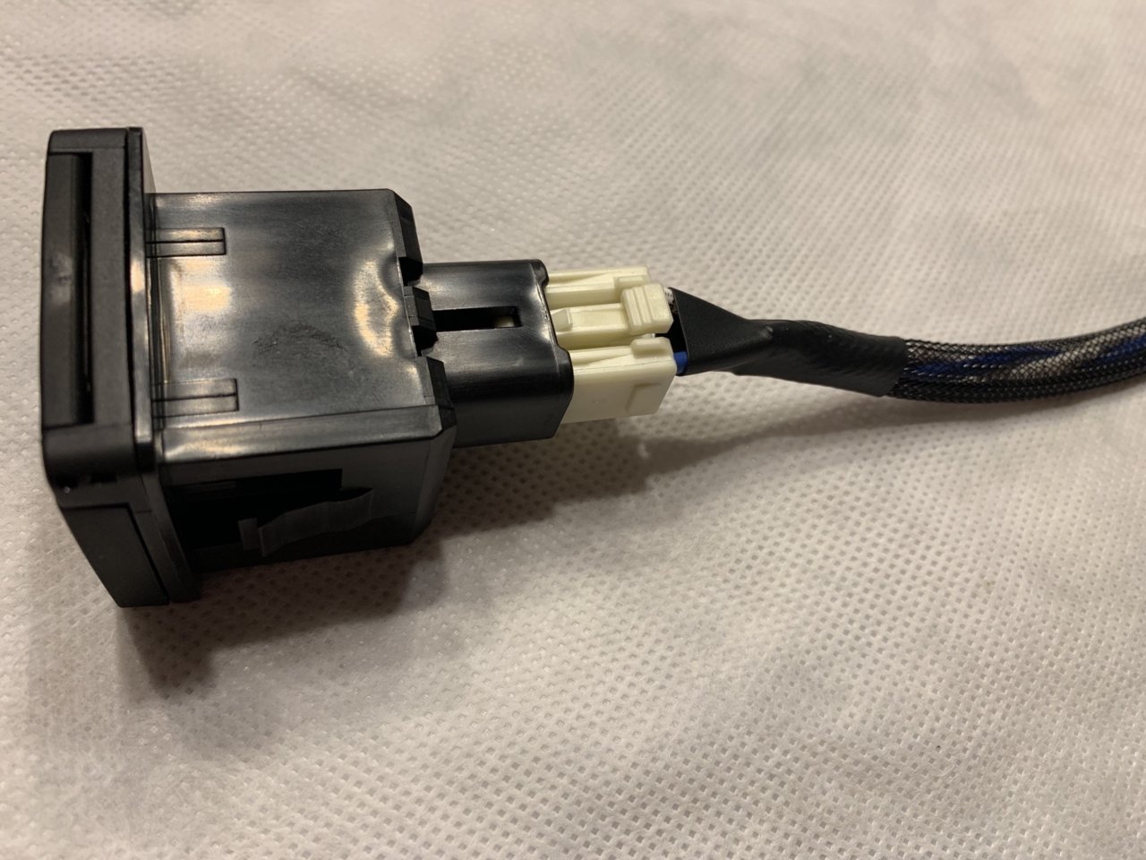

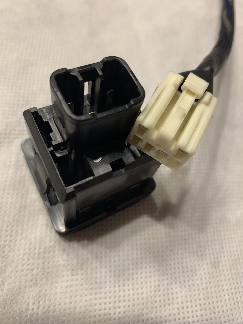

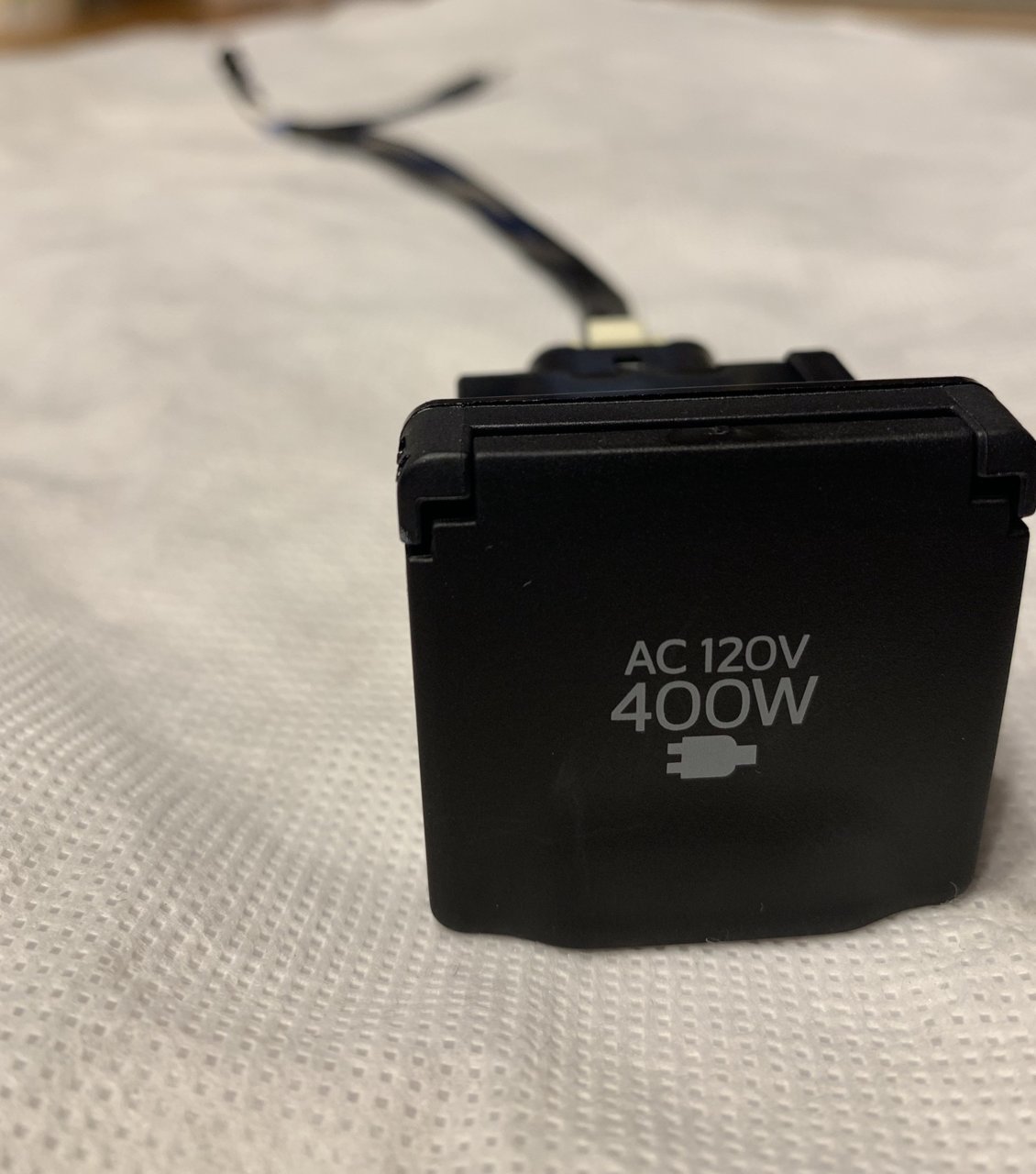

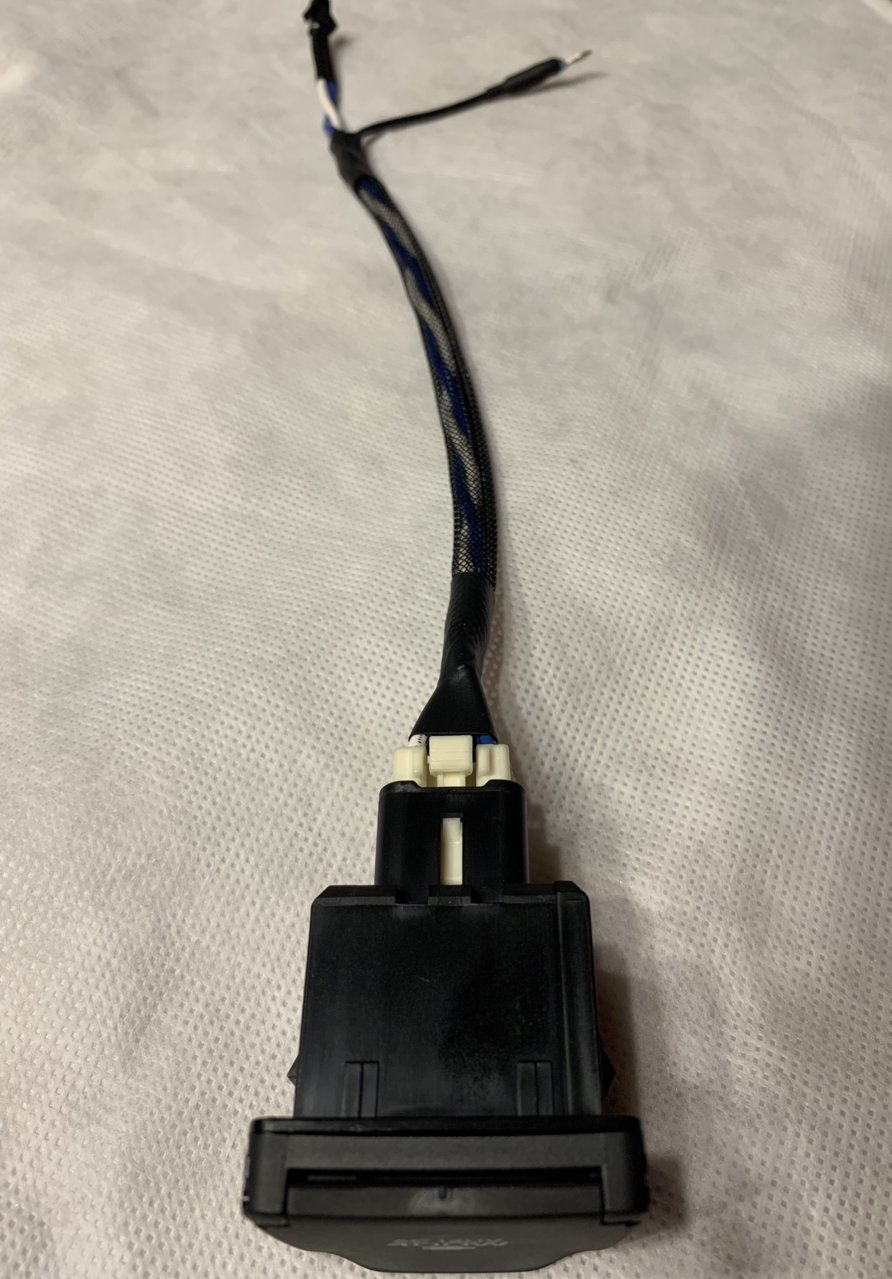

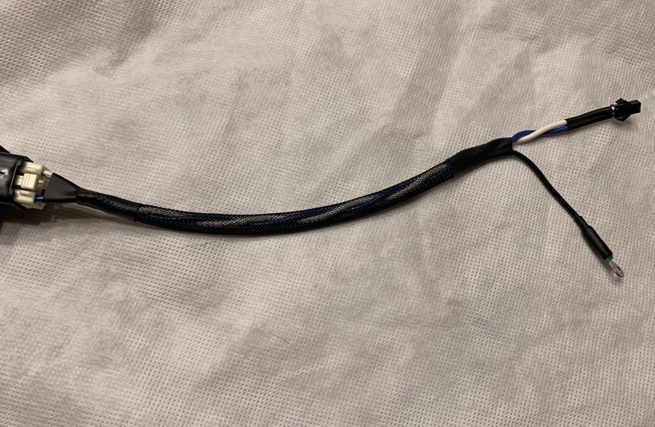

    Whipped up a Sample of OPTION 1 WIRE HARNESS last night when I received the Connectors and Terminals from Japan.
    This Wire Harness measures exactly 12” in length. I just wanted to see what exactly it is going to look like. Plus this weekend I will be making sure that the Harness Length. With fit perfectly from the back of the center console to the front for the AC Outlet to be installed properly with no issues.
