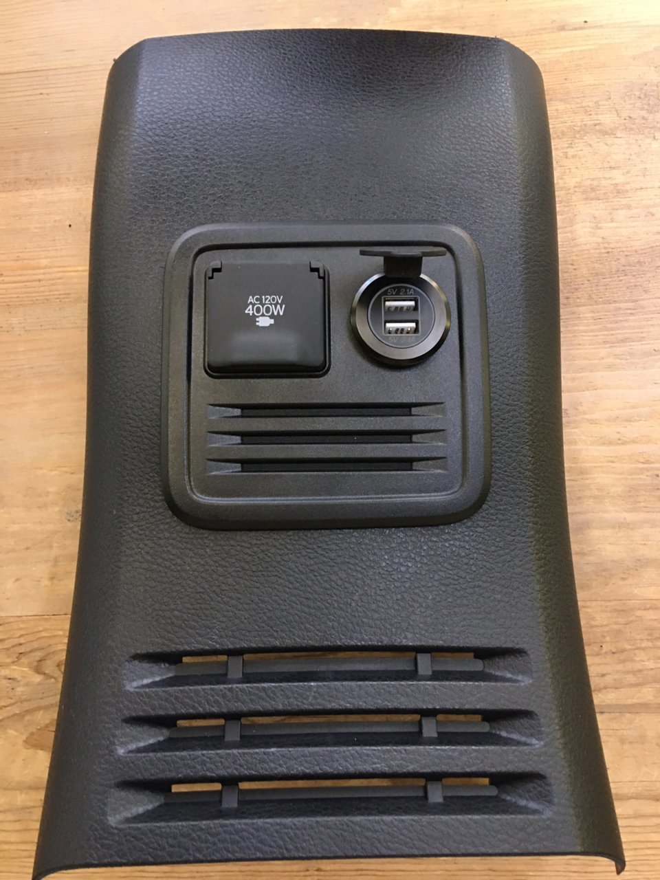

    brentano
    brentano Well-Known Member
    Oct 4, 2016
    #198952
    166
    2017 TRD OR AC SSM
    Thanks @KTJO 4x4 for the harness and @kecknj for the clean OEM-like install inspiration! Top of the lower vent upper hole to the bottom of the bezel: 42mm.
    jjkj and kecknj like this.
  7. Apr 14, 2020 at 10:57 AM
    #427
    kecknj
    kecknj Well-Known Member
    Oct 19, 2018
    #269900
    225
    Nick
    '19 TRD Off-Road
    That looks fantastic! Good job!

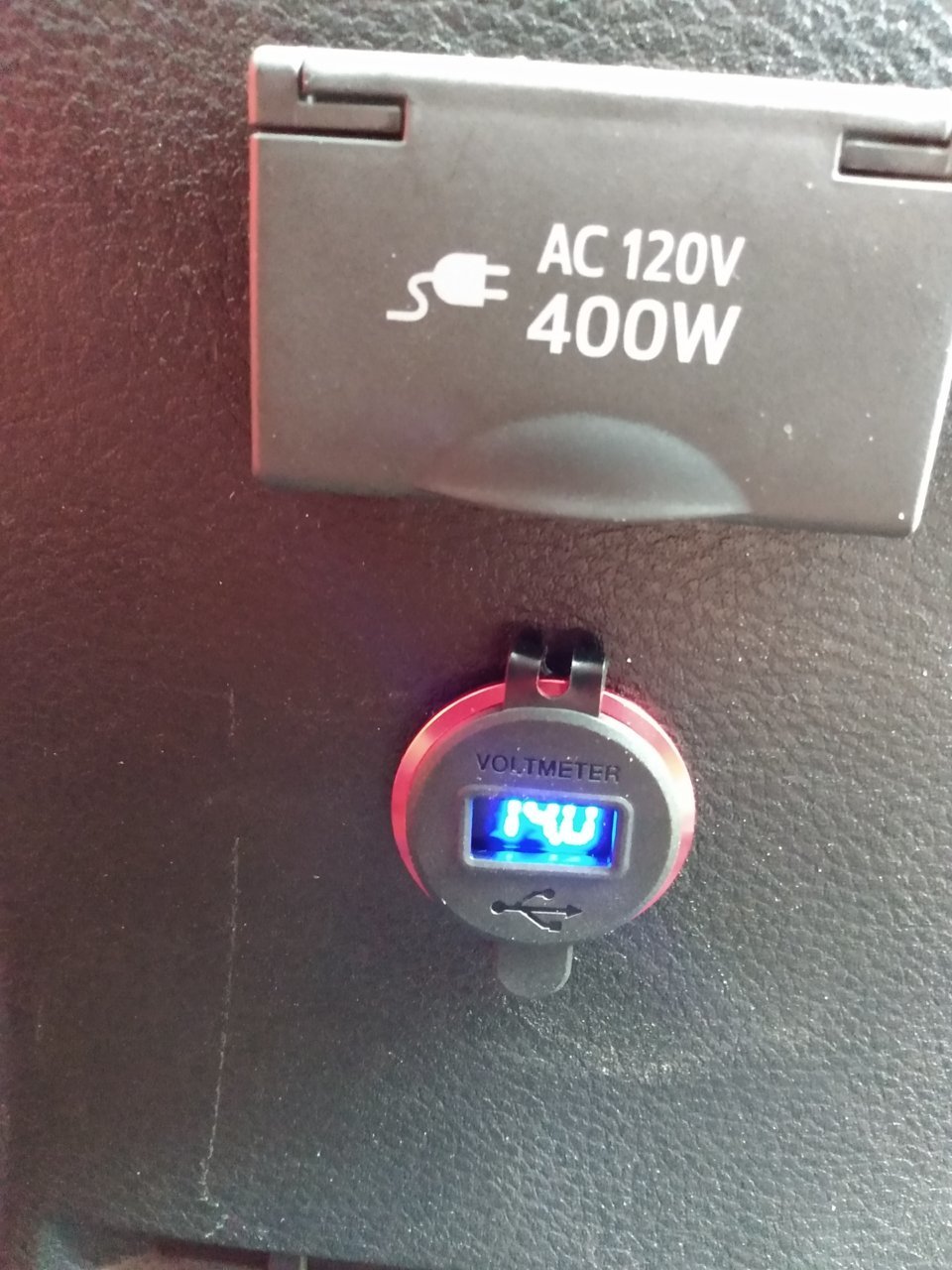

    Has anyone installed Package #1 with the 85530-35050-C0 outlet on the back of the console WITHOUT the bezel? If you did, can you post up some pictures?
    @KTJO 4x4 - if I mount the outlet to the outside of the console, will there be any wires showing inside the console?
    David
  9. Apr 19, 2020 at 5:59 PM
    #429
    kecknj
    Oct 19, 2018
    #269900
    225
    Nick
    '19 TRD Off-Road
    You will not see wires on the interior of the middle console if you install it that way. I have not seen anyone install the plugs without the bezel though.

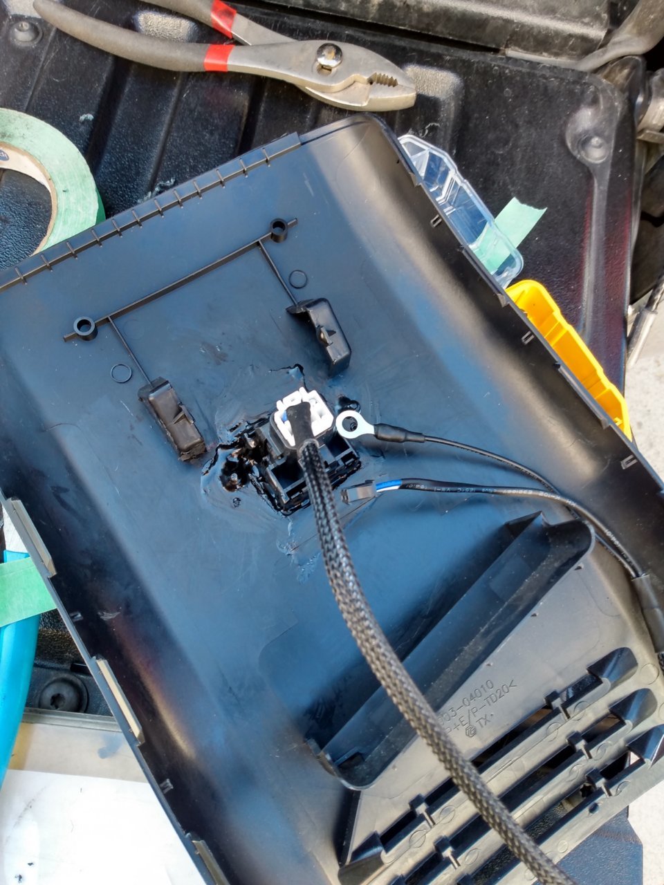

    #430
    SSG (03)TACOMA
    SSG (03)TACOMA SSG TACOMA
    Dec 17, 2016
    #205045
    448
    2023 DOUBLE CAB V6 TRD SPORT 4x4
    IMG_20200411_154606014.jpg her you go bud
  11. Apr 20, 2020 at 9:26 AM
    #431
    SSG (03)TACOMA
    Dec 17, 2016
    #205045
    448
  12. Apr 20, 2020 at 9:30 AM
    #432
    SSG (03)TACOMA
    Dec 17, 2016
    #205045
    448
    IMG_20200406_160115442_HDR.jpg no wire show when installed ,there in the center counsel in the back walls of it.

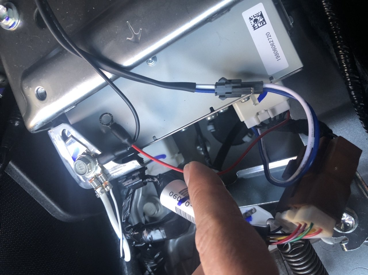

    Looks like this is a ground from the diagram. KTJO harness. Any idea? The red wire.....BE555FED-CF1B-4C12-B938-B723A095A6CB.jpg

    Yes. see below

    Thanks! Wasn’t sure cause it won’t reach that location. I’ll have to extend it with some extra wire.

    It looks like it should reach. You should be able to fit it between the ring connectors of the black wire and the two white wires.
    ETA: BUT, only after you have the large white connector plugged into the inverter.

    correct! It reached.
    Now to figure out where to tap power for the USB’s and I’m done.

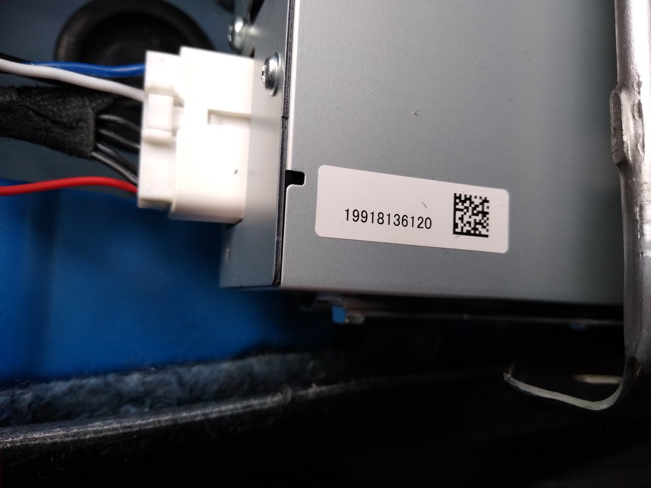

  20. May 23, 2020 at 8:01 PM
    #440
    10ptXtreme
    10ptXtreme Well-Known Member
    Apr 11, 2014
    #127443
    242
    NJ
    2020 DCSB TRD Sport Voodoo Blue
    The red wire that is attached to the main harness is a ground wire. I attached mine to the nut on the side of the metal bracket that the inverter sits below. Here's a picture of the nut I used.
    David
