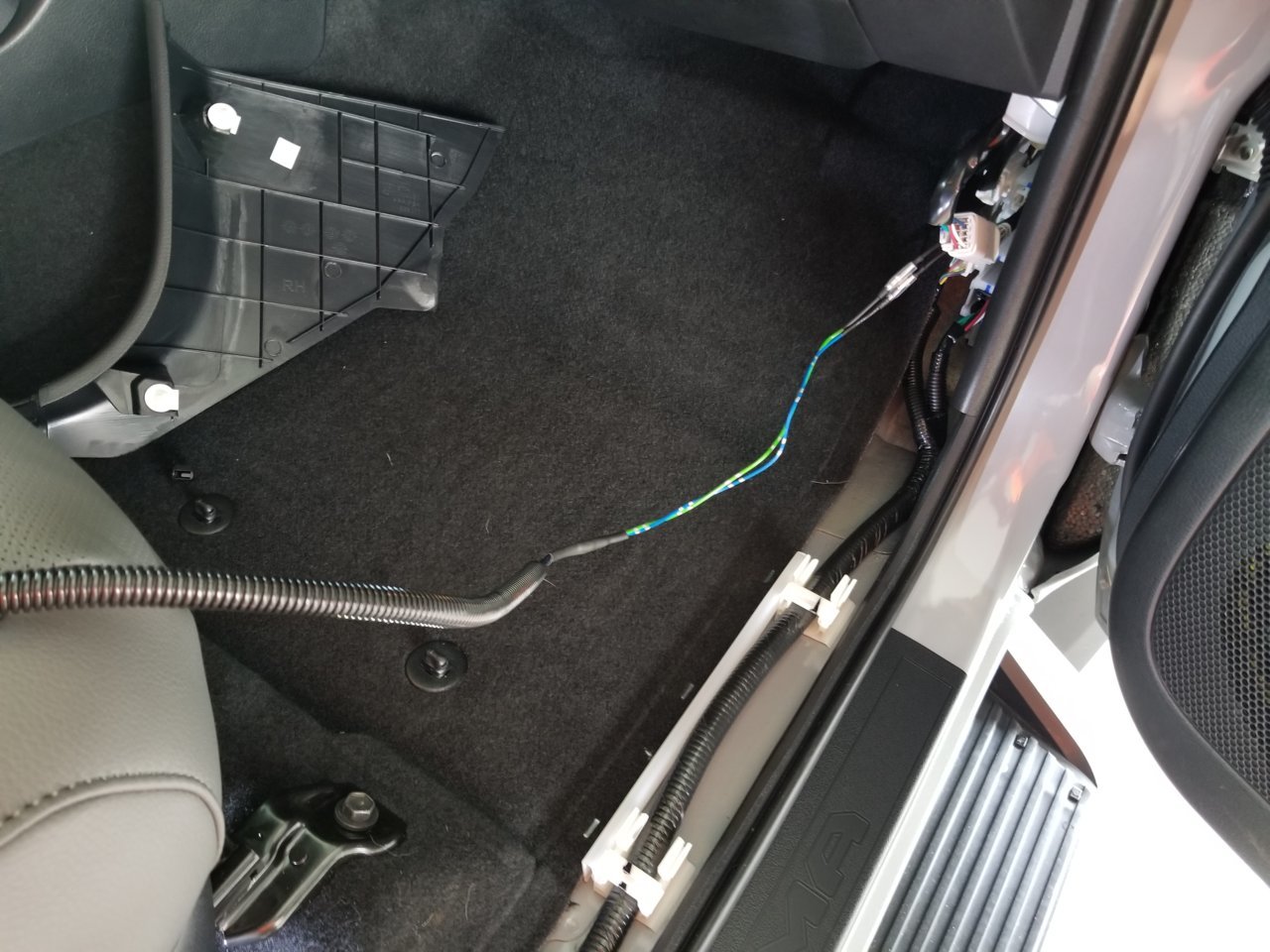

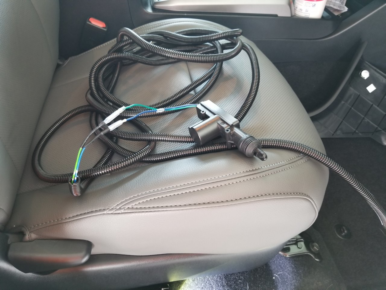

    Installed this weekend. Started from the front passenger kick panel. Katie's plug and play made it easy to confirm the actuator worked with the key fob before actual install.

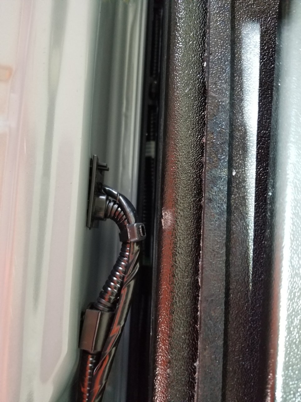

    My SR5 didnt have the wire bundle along the passenger side frame, but still works with holes in frame. Here's the wire loom (not included in the kit) going thru the plug.20191109_154115.jpg

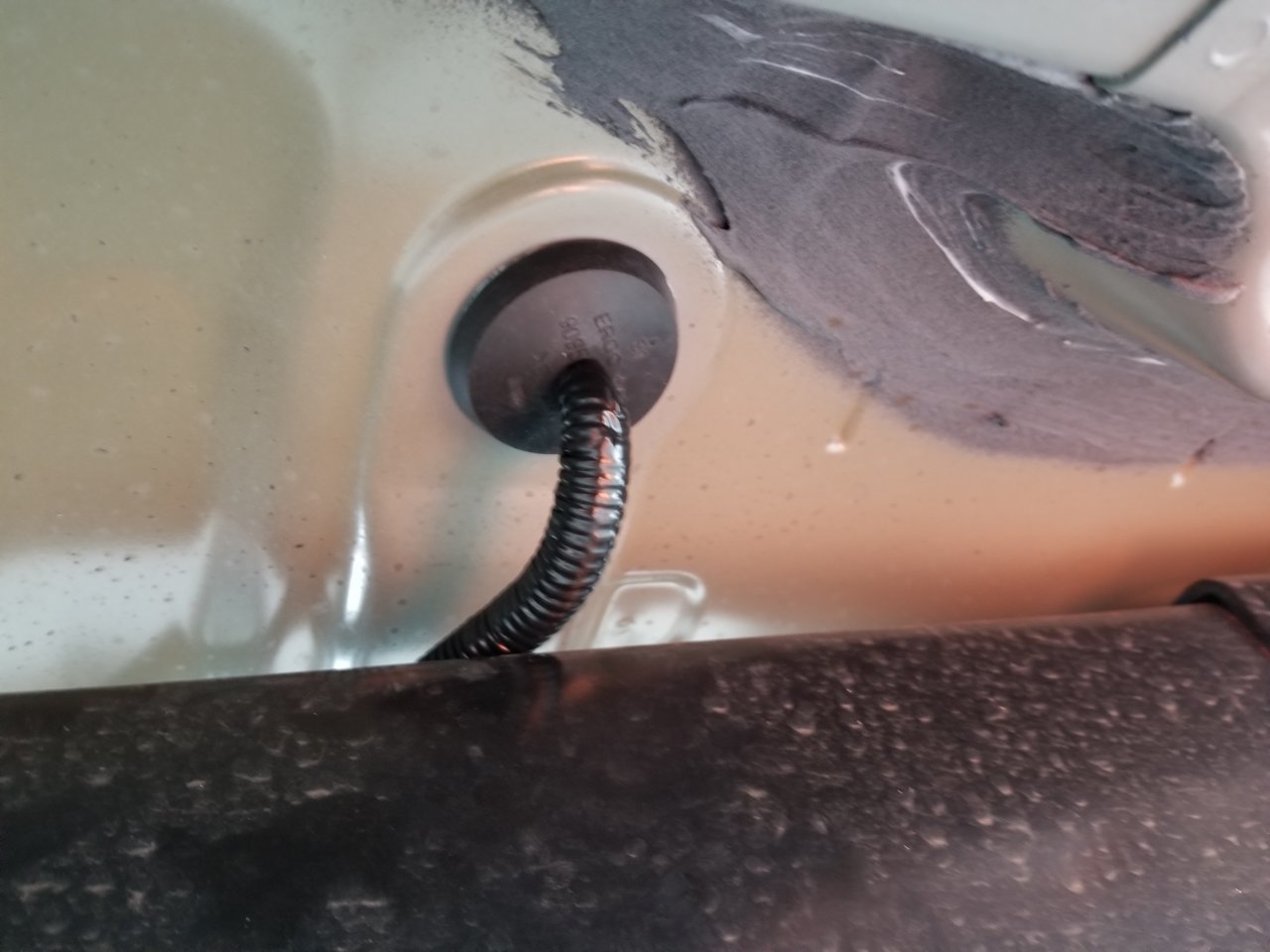

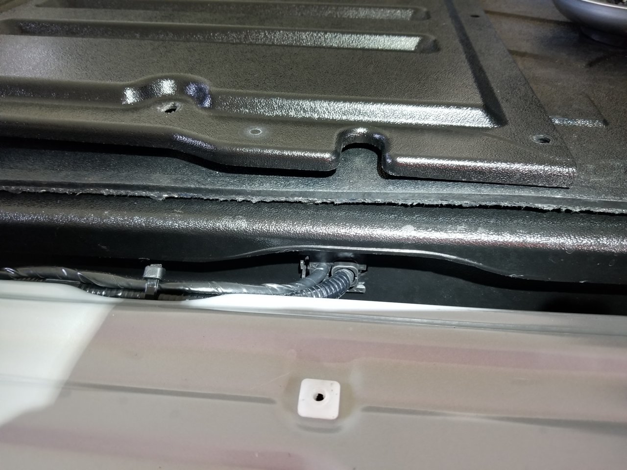

    Drilled holes in the bracket thingies below the bed and bottom of tailgate. Wrapped the wires in electrical tape.

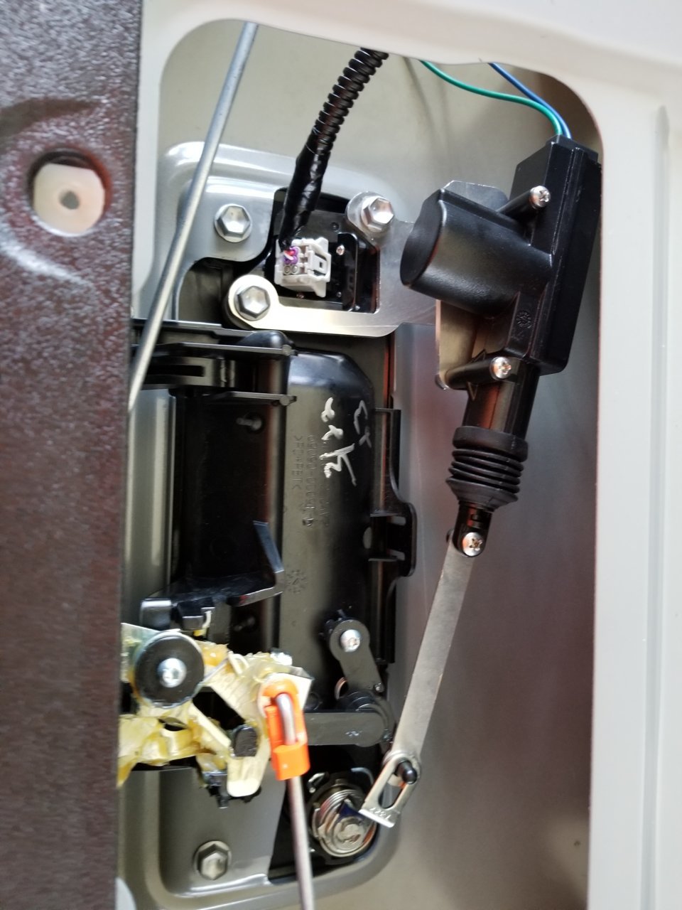

    Installing the actuator and bracket is fairly straightforward. You'll need philips screwdriver, T15 torx bit, 10, 9 and 8mm sockets, an 8mm open end wrench or small crescent will work too. Need a T30 torx to remove the plastic tailgate cover screws also.
