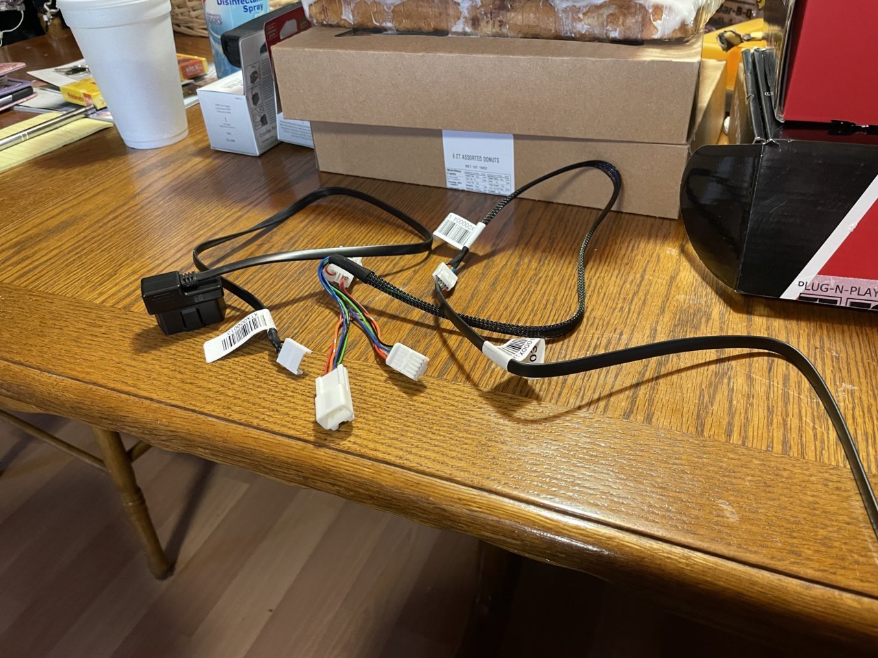

    So I got my HUD today. Anyone that has been successful in hooking it up, please let me know what the extra wire harness is for.
  10. Jan 18, 2022 at 11:57 AM
    #5530
    mtip
    mtip Go Outside & Play!!!
    Aug 22, 2017
    #227695
    2,876
    South Louisiana
    18 TRD Sport 6MT 00 Tundra 5MT
    Could it be the extra harness/adapter that's needed for the newer model Tacomas? Does the harness from the HUD plug directly into your OBD port?
    Just guessing here

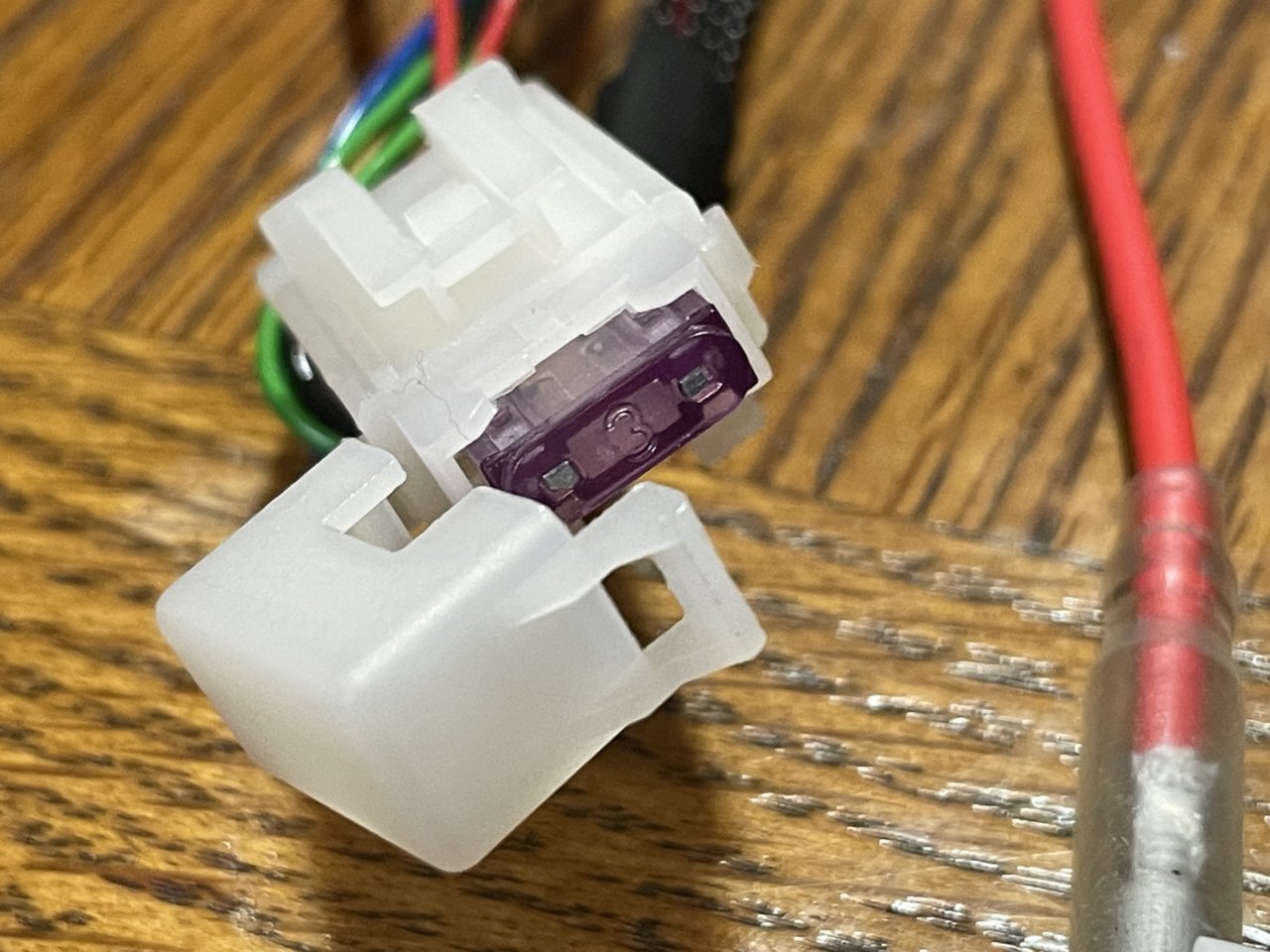

    EEE17D77-938B-4352-9C3C-5D13AFDA13C6.jpg 5F83D0ED-02A6-4990-BED4-5C297F4C3A79.jpg CF2BFAF8-BA5D-4137-8422-6368DDCD63B5.jpg D6B612E5-2EAB-408F-97D4-94D3A1A16302.jpg HUD did not work on 2018. Hope the new harness works once figured out.

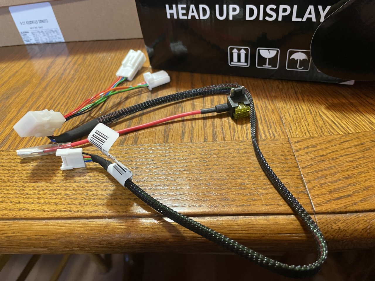

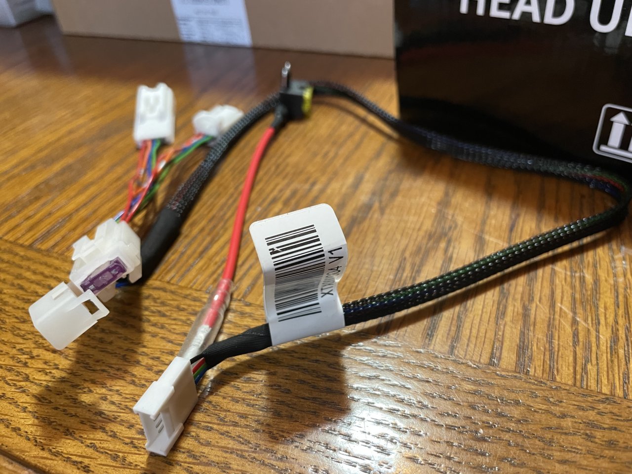

    CB2E333D-B9D5-497C-96D5-8A591DEF1C34.jpg A640B26B-8DEE-441C-AE23-57D6D18D1E65.jpg Nope
    It appears the harness I have does not use the OBD connector. Looks like a pass through connection. Maybe LH foot panel. Also has 3 amp fuse attached.

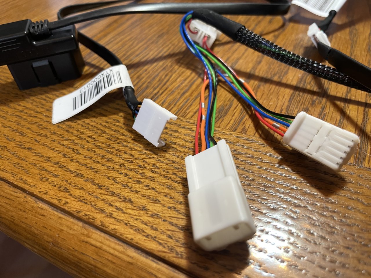

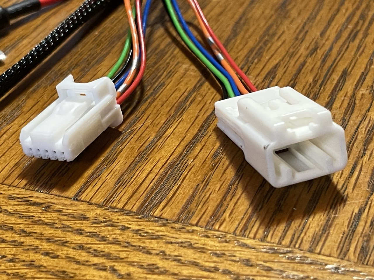

    Here's Today's update from "the vendor" with directions for the new harness:
    We have asked our vendor for the second install but it's really easy. If you turn your steering wheel sideways you will see two screws that go to your steering column cover panel. Remove those screws. That will allow you to remove the two piece covers. Under the steering wheel you will see a oem connector that looks like the new harness we just sent out. Disconnect that from underneath. Plug the new harness in and then the oem one into the new harness. Then just follow the rest of the other install guide that is on the HUD product page
    @caribe makaira can you help find a reference for this plug?
    babelfishinmyear and BOMBS like this.

    If I had a crystal ball...what is this "new harness we just sent out"?
  20. Jan 18, 2022 at 4:10 PM
    #5540
    RyanDCLB
    RyanDCLB Well-Known Member
    Jun 13, 2019
    #296235
    3,543
    4/19 DCLBOR
    Yeah, we're lost... The new harness is the one without the OBD port reader:
