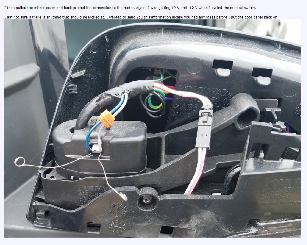

    I did a couple years go. I had a small issue with installing the pins to the connector. I got it straightened out on one pin and had to do a little splicing on another. ensuring the proper orientation and making sure it is fully seated are key.
    The driver's side motor did go out on me after 1 year, and I had to replace it. I am not sure if it just went out on its own, or if an icy winter over worked it. So, i went ahead and put a manual switch under the arm rest to kill the circuit in the winter. During the winter, I turn off power to the system. The mirrors don't fold up, but the motors don't get over worked either. I just turn it back on in the spring.

    Where did you get the other motor from?

    Short answer I had to buy one from the seller.
    I made contact with the seller and explained the situation. I did a full diagnostic, (I documented with pictures for anyone else who runs into this issue), to be sure it was the motor, not a broken wire or bad fuse.
    I have the entire exchange saved. Her response was: "I have sent this to my vendor as well. I’m not sure what you could have done to be honest. I’ve had mine on since the beginning doing all the testing I’ve even doing and haven’t had one issue so I’m not sure. A new drivers side motor to replace that motor is $20...".
    The implication that I did something did sting a bit, as I hadn't done anything since install. But I needed the part more than I needed an argument.
    The install was a bit involved. I had to cut the wires feeding through the folding arm of the housing. Then splice in the new ones. I had to be careful to stager all the splices to be sure there wasn't a big knot in the middle of the bundle that would be in the barrel of the folding arm. It would have been too large to fit through. If anyone else ever has to do this, I recommend paste flux, solder and heat shrink. Crimped butt joints will just be too large to fit comfortably inside the housing. You can see the bundle of wires going down through the arm of the motor in the second picture below.
    Here is a picture of what it looks like when the motor fails, and screen shot of a portion of the information I sent her of what and how I tested when I was tracking it down. 1.jpg

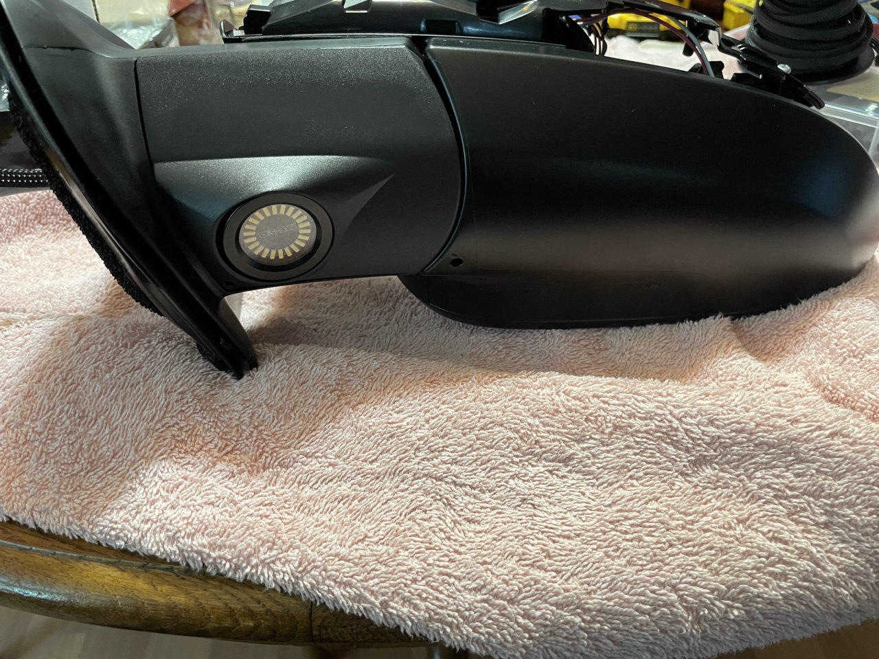

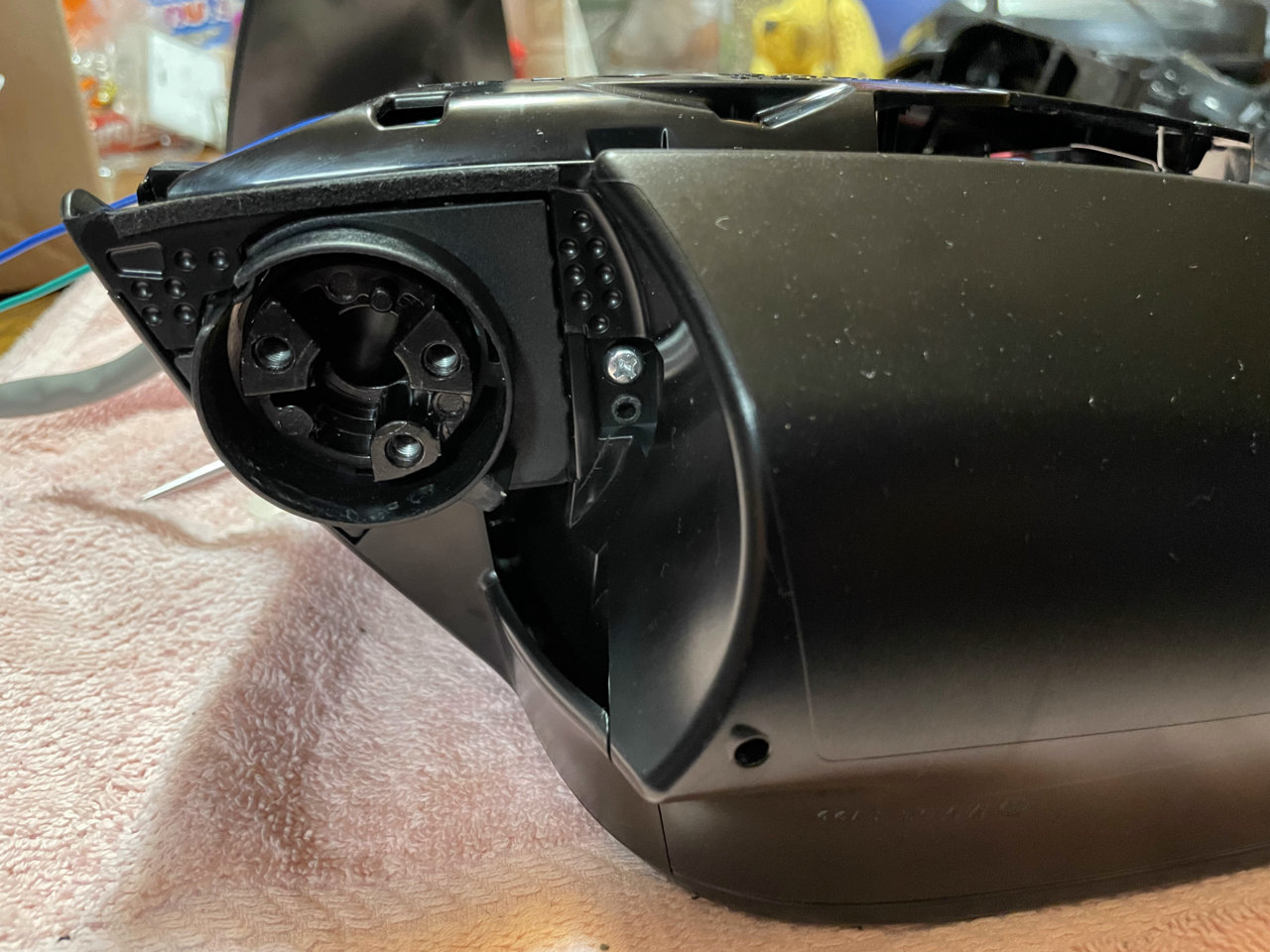

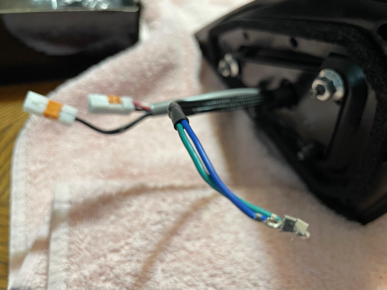

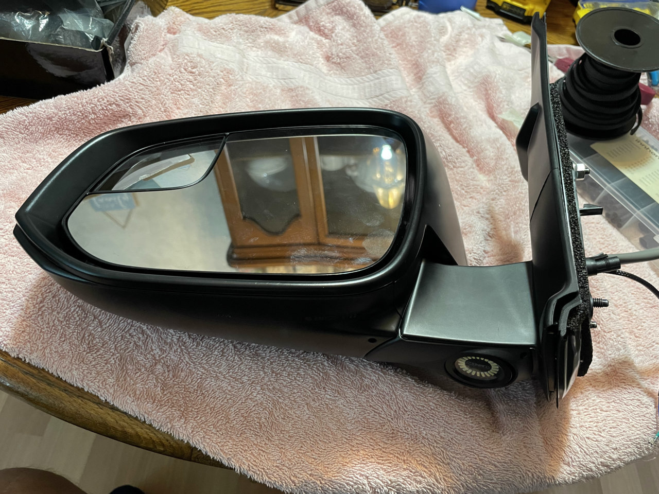

    Started on the drivers side power folding mirror. With the Rav4 BlindSpot mirrors and MESO Puddle Pods and V5 Signal Lamps

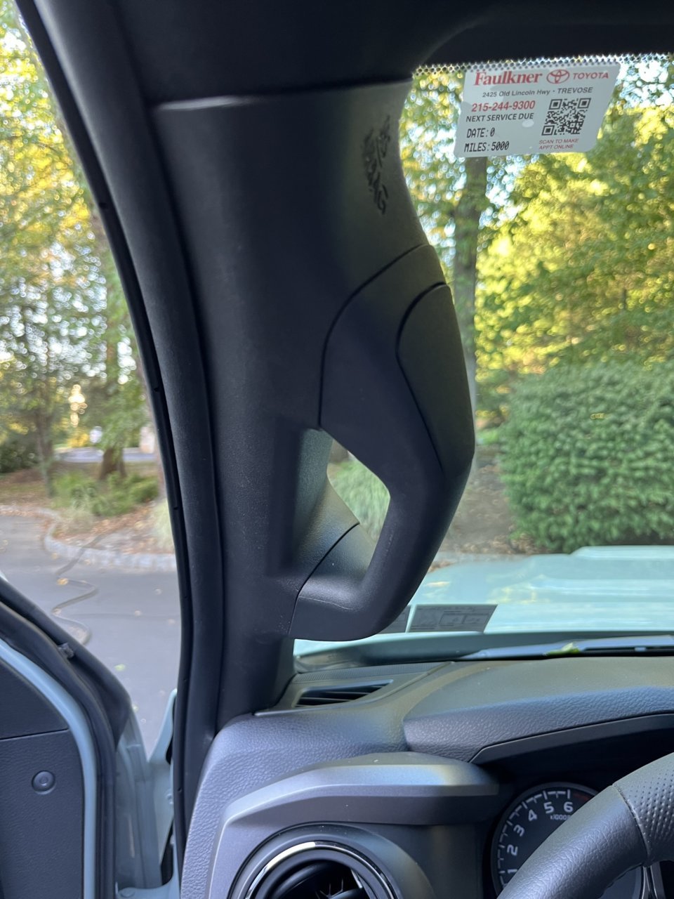

    With much trepidation, I placed an order for the KTJO drivers side grab handle last Sunday night. Arrived today via USPS, one day earlier than expected. Popped it on in less than 15 min, using supplied hardware. Only “mod” was to smush the speednut a bit with plyers to fit snugly on the lower bracket. The handle fits better than I expected after reading many of the posts and reviews, and actually is pretty nice! I’d say she’s got this dialed in at this point.
    My install tips:
    Be sure the lower plastic tabs are lined up before seating the panel, it’s easy to miss align one of them.
    Center the lower speednut with an awl and be sure both bolts will begin to thread in before trying to install the handle. Gives you a idea of the strange angle they will need to be for final assembly.
    Use a 1/4” drive socket and a small ratchet, too easy to crack a windshield swinging a 3/8” ratchet!
