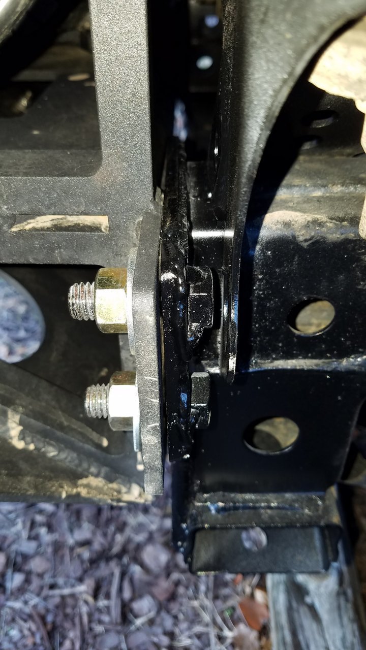

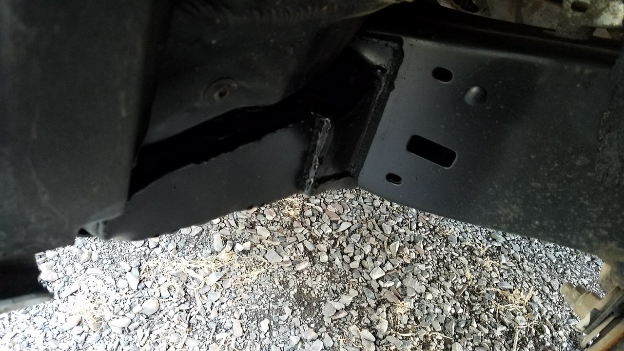

    Cab mount chop
    Frame horn reinforcement

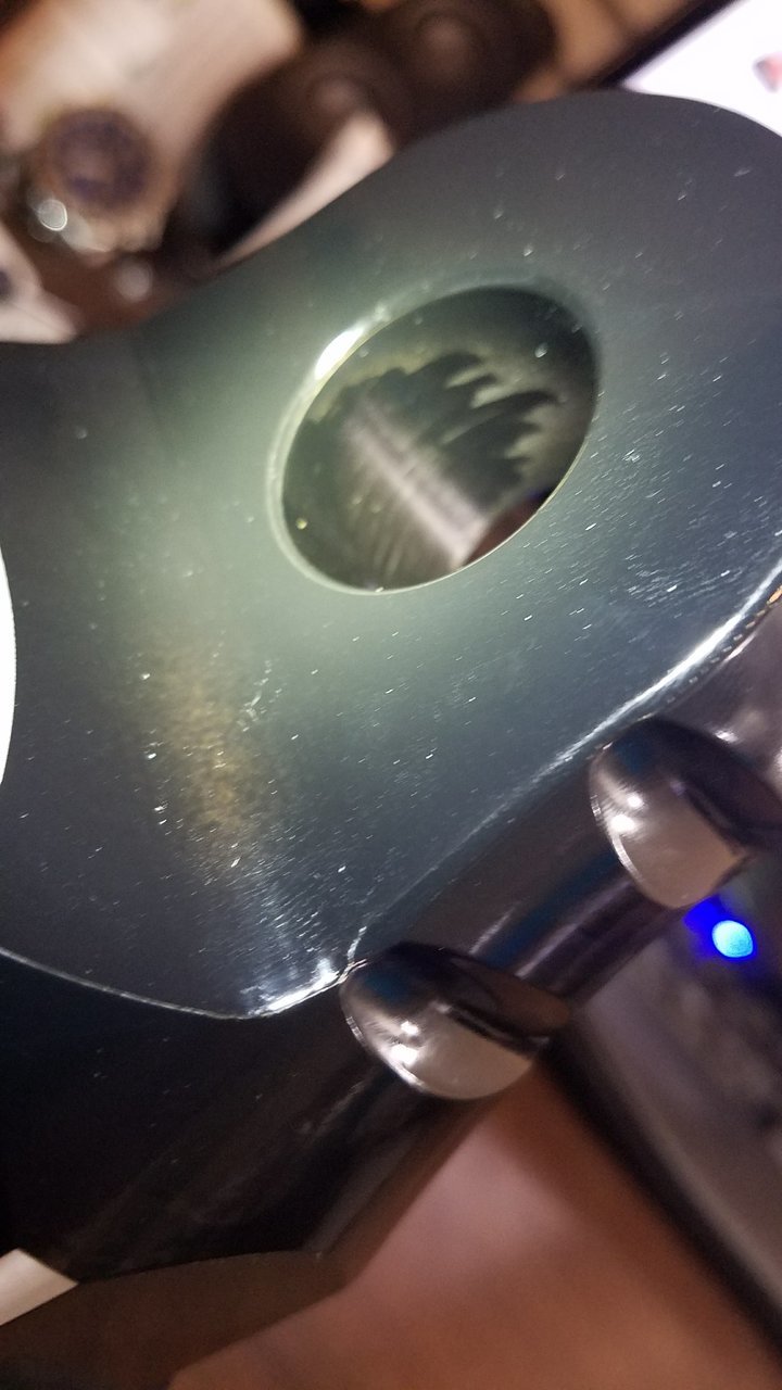

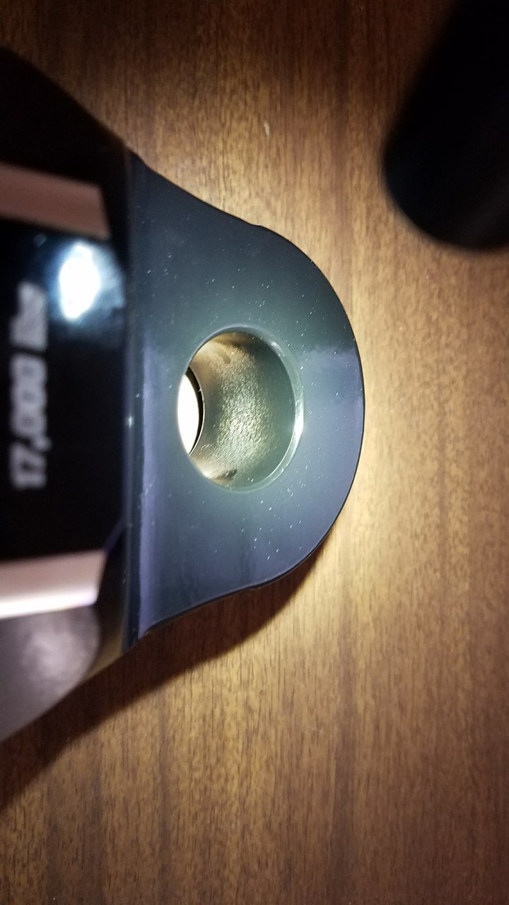

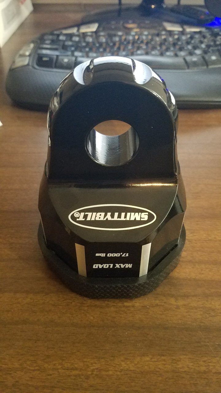

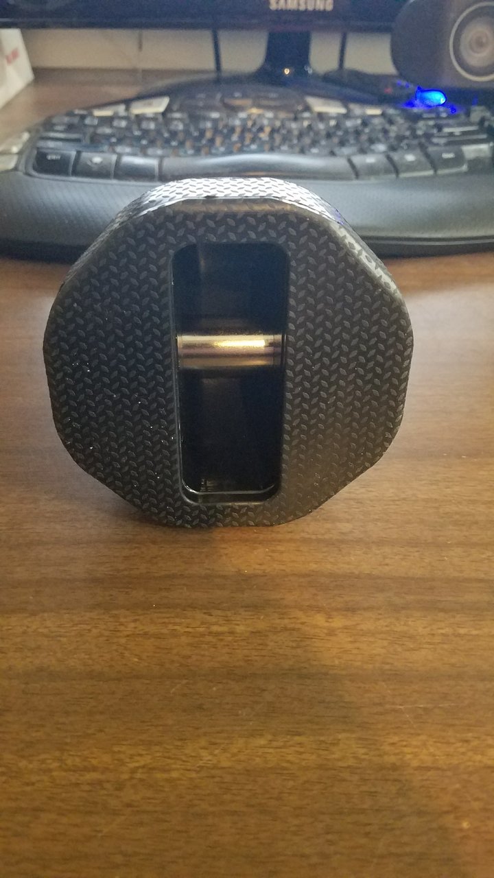

    After a 3 month back order wait, I received my Smittybilt AWS yesterday. Everything looked great initially. Closer inspection revealed coating issues inside the shackle pin hole. The coating is very thin/non-existant on the top of the shackle pin hole, where the shackle pin would bear against when under load. The bottom of the shackle pin hole looks to have been colored in with sharpie. I've emailed Smittybilt CS about this, so hopefully there will be a quick resolution. Their CS has been good the couple times I've contacted them in the past, but that was product questions and not product issues.

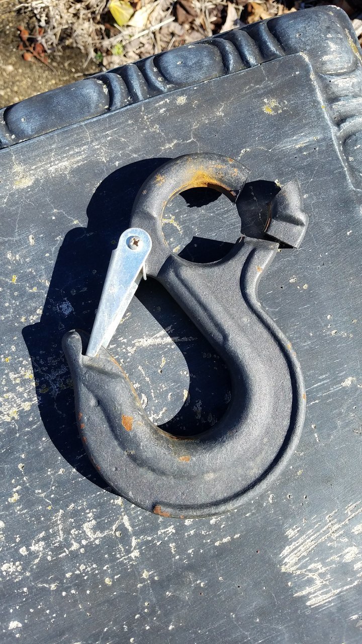

    The weather is really nice today, so I went out and mounted my Smittybilt AWS. It looks nearly identical to a Factor 55 Prolink but costs half as much. I ordered it back during Black Friday, but it was back ordered until recently.
    I cut off the existing hook with my grinder and mounted it up. I cut a small hole in the line guard and used a couple of zip ties to keep it up at the rope eye. This way hopefully, I won't have the issue that I had when I was out back in December, and the line guard got stuck behind the fairlead. It took a good 15-30 minutes to get it out, so I could use the winch.

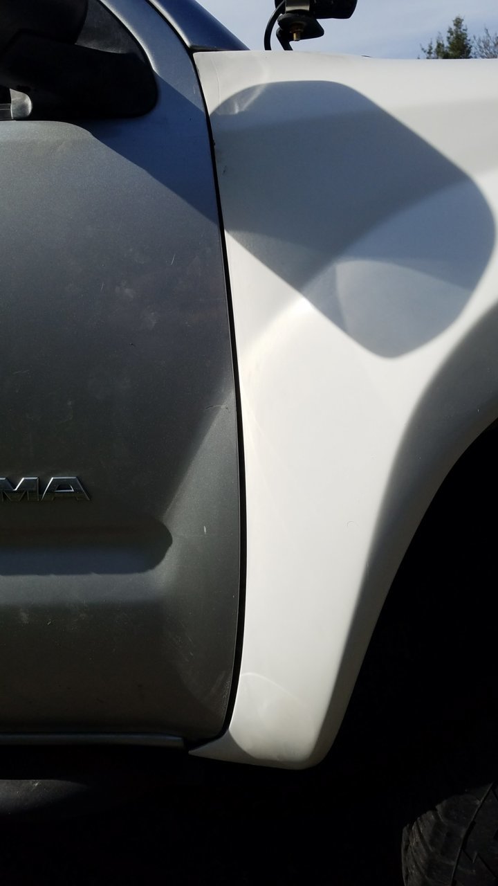

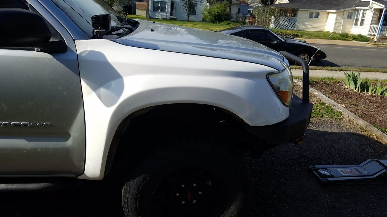

    I started the fiberglass install today. A friend of mine came down, and we spent the day fitting the passenger side fender. It isn't completely finished yet, but it's about 90% there. I'm having issues around the headlight, and I've got a few more holes to drill to get everything to bolt up in the headlight area.
    Here's a picture of the overall fitment so far. The top corner where the fender and A pillar meet took a lot of work. It still needs a little bit more to make it so nothing is touching/rubbing.

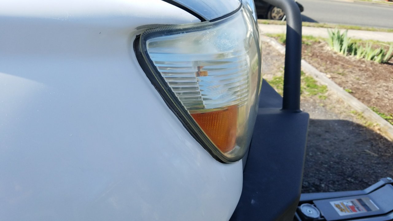

    Here's a closeup of the headlight fitment problems. The fender is hitting the headlight at the top. I can get the light bolted in but it's pushed toward the driver side and is rubbing on the grill. I need to do more work here to get the clearance to move it over. I'm going to have a little gap in the end.
    Here's the door gap. It gets bigger as you go down, but it isn't horrible. However, the fender doesn't naturally fall that way. I have to push it over 1/2"+ to get the gap the way it is in this photo.

    That's actually not a bad fit for fiberglass fenders...pretty common issue with aftermarket body parts. Best just to get it as good as you can get it and let it go

    Yeah. My buddy was fussing about the gap at the headlight, and I kept telling him that I'm fine with some gap. It's not ideal but I'll live with it. If I'm motivated, I'll work on it in the evenings after work next week to try to get a better fit at the headlight and the touching part at the a pillar. There's always next weekend if I'm not motivated. :rofl:

    Pretty much this...if you can maintain a good lineup with the hood when closed I would rather tighten up the headlight personally. I have a little more gap in my fenders to door jams, but mine initially rubbed on install and had to be sanded in a few spots.
    Glass for the most part is somewhat of a compromise. You will forget the discrepancies in time...did you sand any of the headlight area? Normally they have a little excess material there so you can mold it just right to fit your ride.

    The door jam up near the a pillar was tight but not touching. I did sand it some to open it up and get a more even gap. Where the fender and a pillar meet has taken the most work and still needs a little more.
    I have sanded some around the headlight. Mostly at the bottom as it was hitting there. Now that the light is going in further, it is hitting at the top. It is hitting in a weird spot though, so I need the best way to clearance it.

    That's what happened around my headlight, I had to trim the very upper and lower lips of the headlight cavity. I used a dremel for this which I would recommend if you have and just keep checking it as you go.

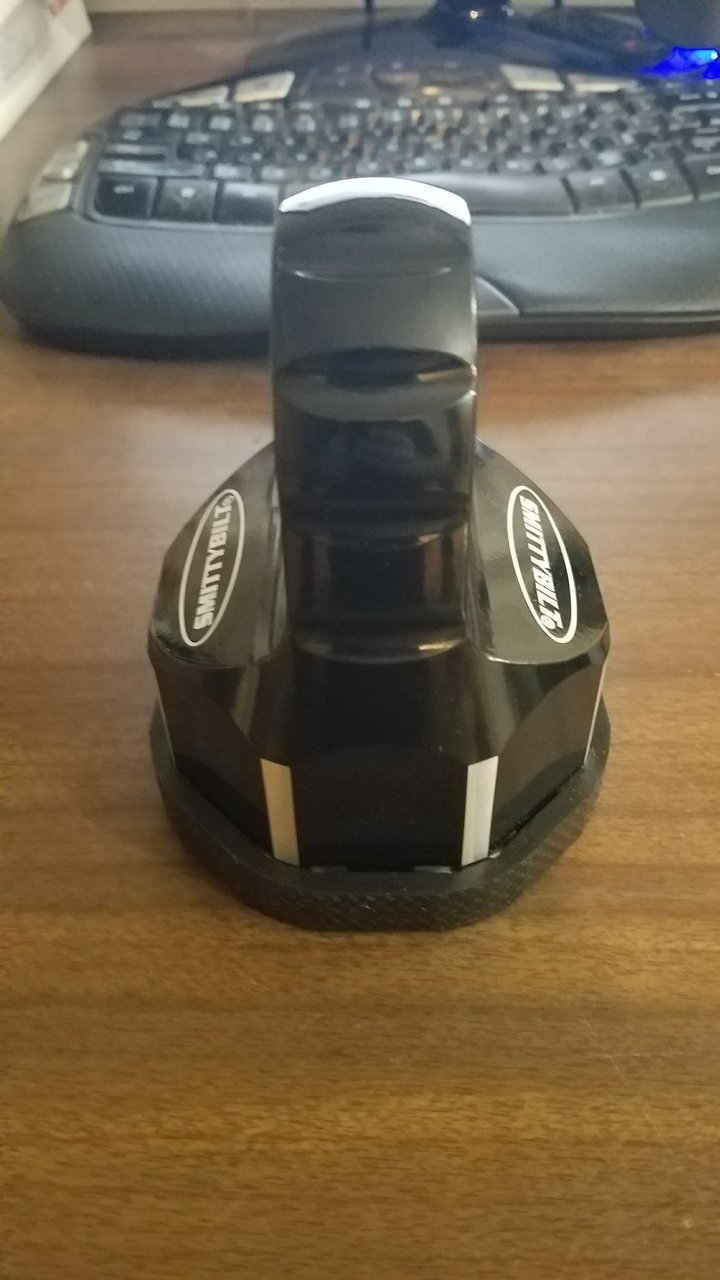

    I didn't use my Dremel at all. This is the sander I was using.
    That triangular piece is Velcro on the bottom and the sandpaper sticks to it. I've go 60, 80, 150(?), and 220 grit for it.
