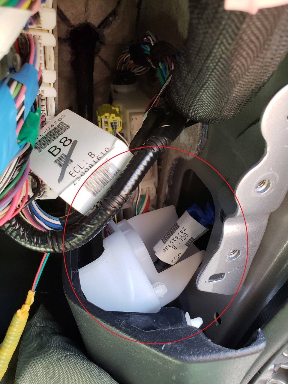

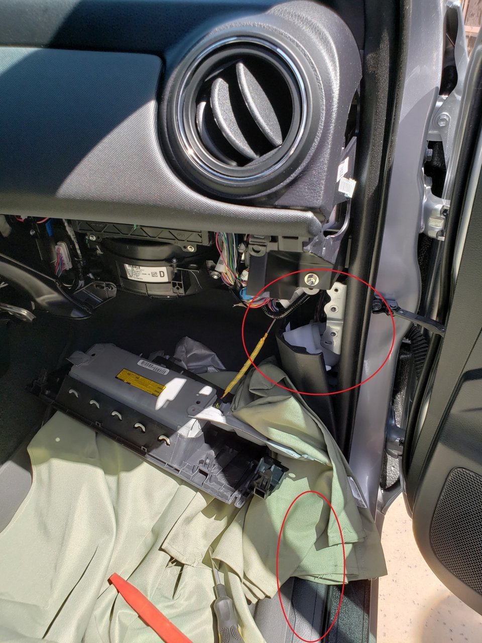

    I took a stab at fixing this last weekend and seem to have had success. For anyone comparing symptoms, it sounded like a fly buzzing around around down by my passenger side speaker.
    I went after the ECM mounts like the above linked thread mentioned, but everything seemed pretty tight so I left it alone. I did notice some plastic pieces that were very loose and could possibly vibrate, so I snugged them up with some thin, adhesive backed rubber.

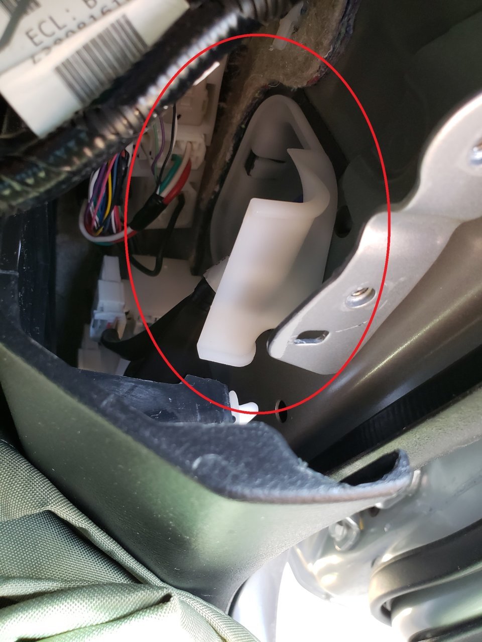

    These are the trouble makers. The first one was up against the sidewall and the other were some plastic clips underneath the door sill trim.
    Closeup of the side wall noise maker:

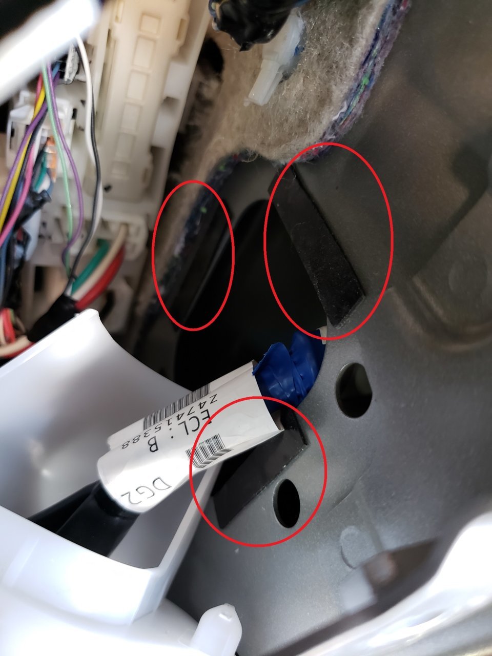

    I added some then adhesive backed rubber underneath to dampen vibration and make things snug:
    Here it is put back together:

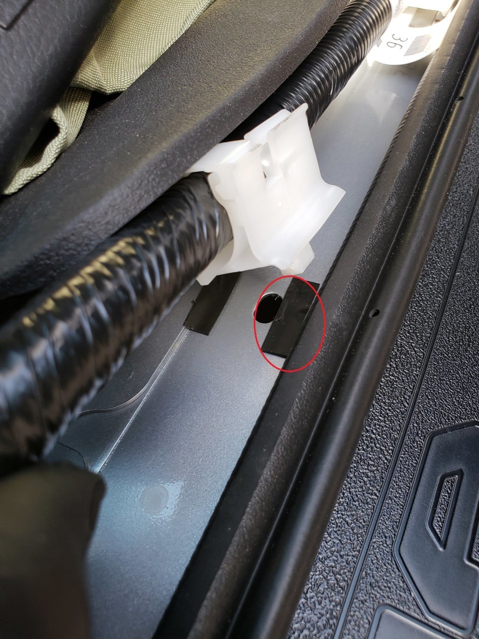

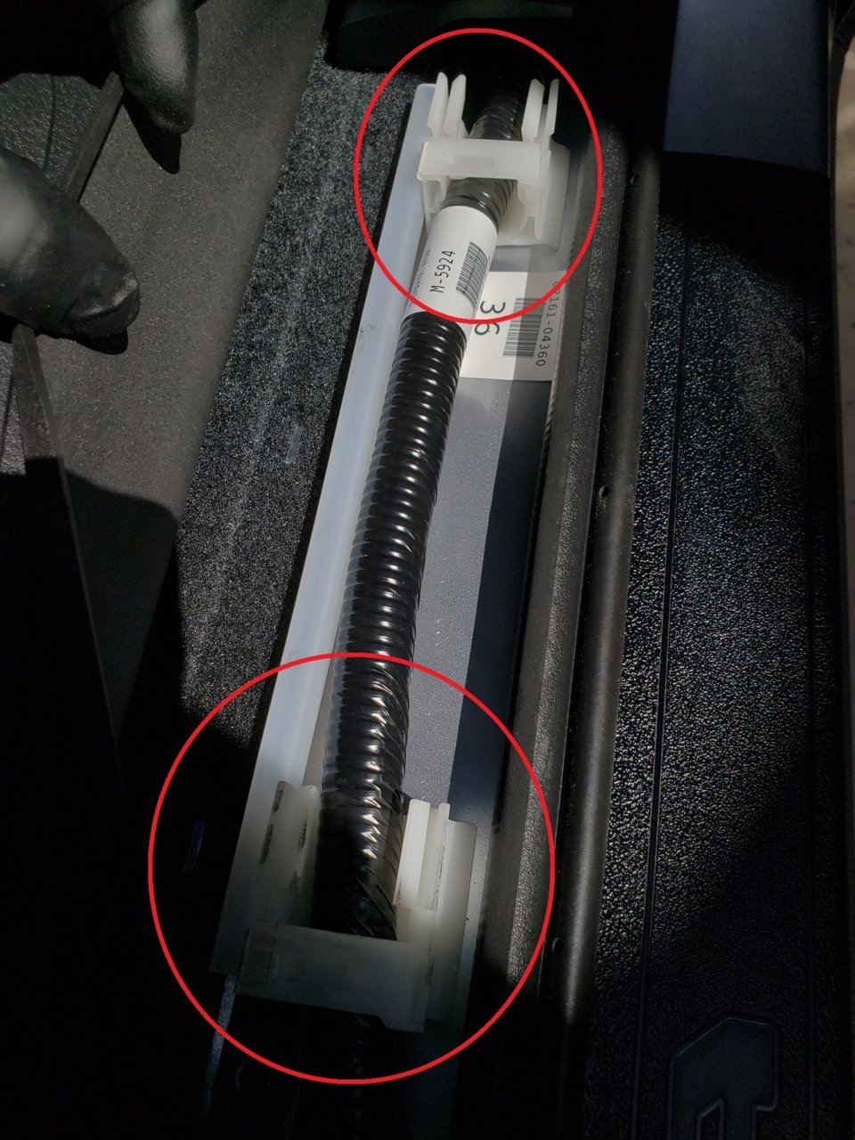

    Here are the plastic clips I was talking about. They are pretty easy to get to, just pull up the plastic trip that runs along the door seal.
    I put some rubber underneath and along the sides to dampen vibration.
    I've been driving around for about a week after doing this and haven't heard the buzzing since. I can't say for sure these were actually causing the noise, but so far so good.
