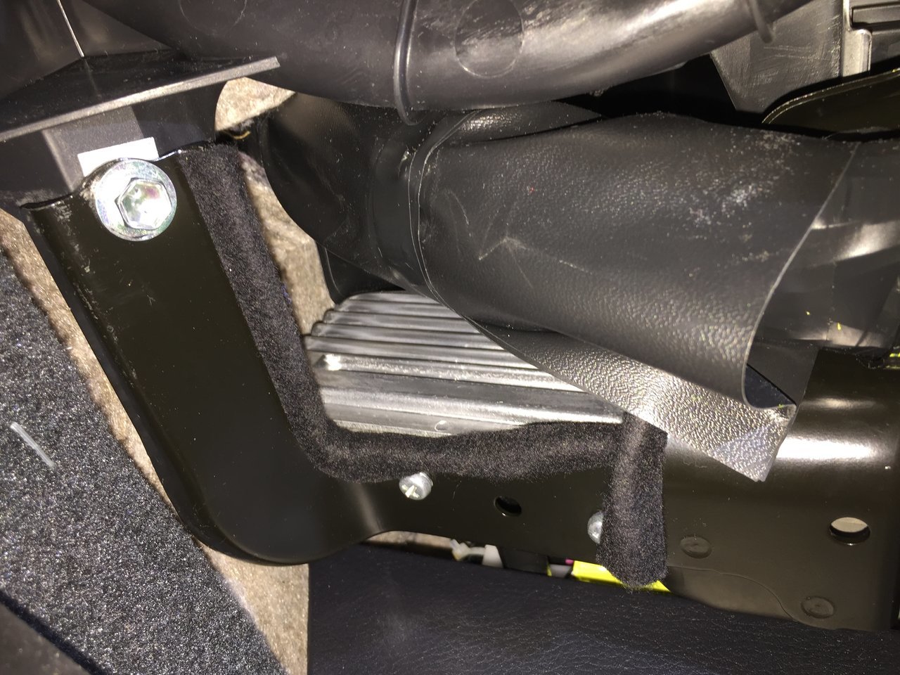

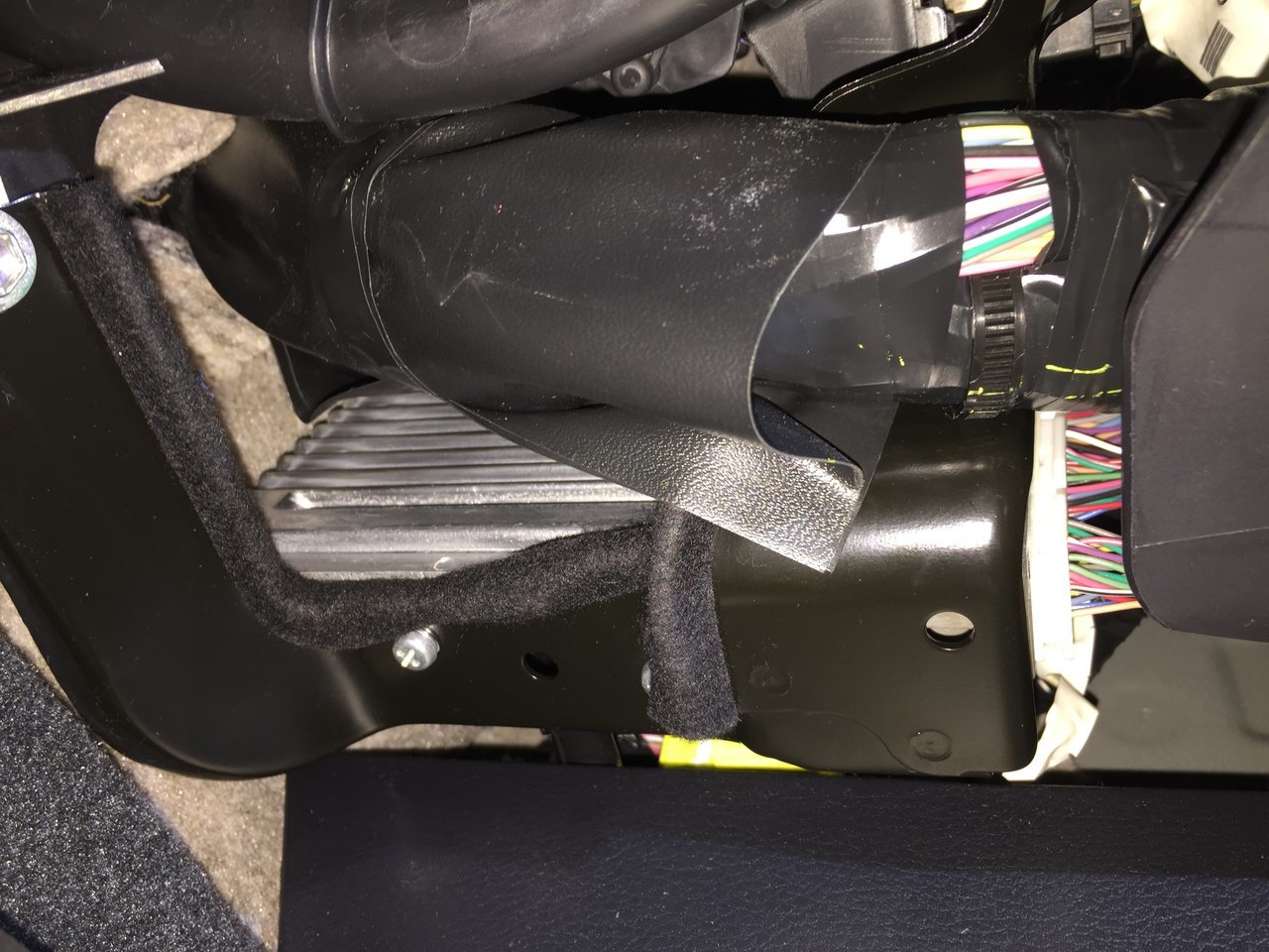

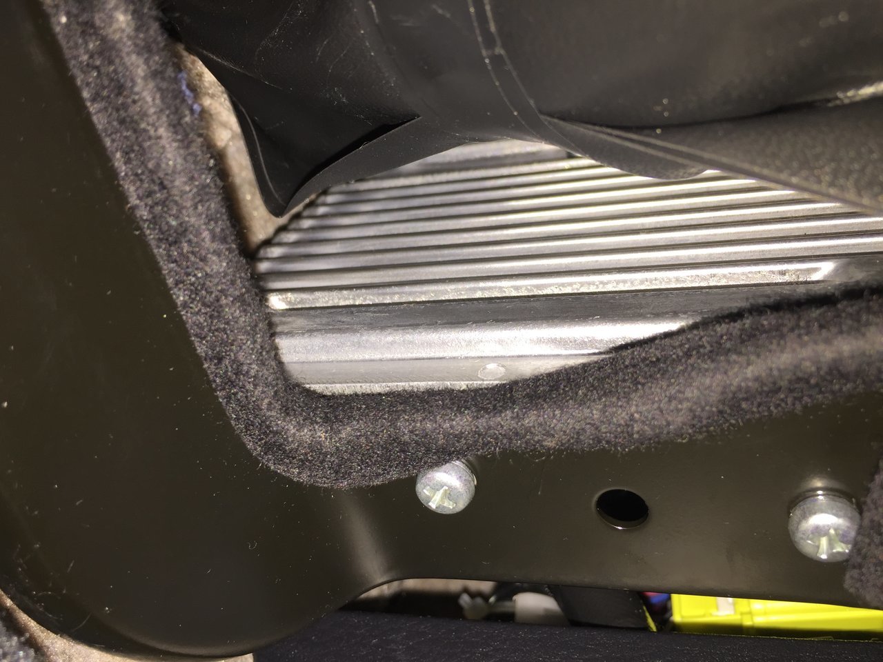

    Noticed a very minor feedback from a silver unit under the glovebox dash area when the accelerator is applied. Most detectable when air and sound are off and it is quiet. Occurs when the audio is completely turned off as well. See pics in below responses of where it's coming from.
    Anyone experienced and/or remedied this in 3rd gens?

    Have narrowed it down a bit. It's not the head unit. Noise is coming from under the front passenger leg area directly under the glove box on the right side, nearly adjacent to the door speaker, but it's not from the speaker. Noise frequency is directly proportional to RPMs. Area noise is coming from has several wiring harnesses and electrical connections. Noise is not noticeable until vehicle is 'warmed up'.

    It's a ticking coming from this silver electrical unit which I don't know what exactly it is. It is under the front passenger foot area under the dash/glovebox. It is warm and close to the door.

    SO you're saying it's changes in frequency with RPM.. does it get louder when you work the engine harder and quieter when you lift of the gas? A buzz perhaps?

    Is that the "instant" heat electric heater? Some models had an additional heating element for supplying heat before the engine actually warms up.

    JUst checked the service manual to be sure.. that's the ECM guys. The buzzing is likely two plastic parts vibrating and in contact with each other in that area. I've had a similar buzz in that area that comes and goes since day 1. Acts pretty much as OP described it.

    Yes, absolutely. Direct correlation to RPMs.

    ECM is Electronic Control Module, correct? AKA the computer brains?

    Yessir. I wouldn't mess with it personally (ie f@ck with connectors n such).
    See that vinyl looking shyte wrapped around the wiring bundle? I'm almost positive I read a post where a TW member had a buzz noise fixed and the problem was something rubbing around the ECM. Try a search and see. Oh and let us know if you fix it!!!
