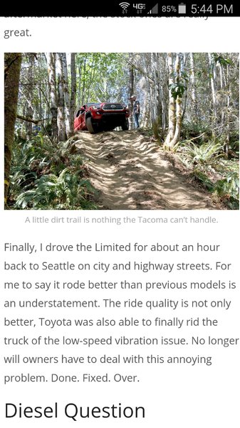

    Screenshot_2016-02-19-17-44-28.jpg If only they knew what was waiting hundreds of miles down the road . . . . :eek:
    Article from Aug 2015 TacomaHQ.com

    I found that article a while back and think the author was probably writing about the driveline shudder. Granted, that still seems to be present on some 2016s. I know it’s slightly there on mine. Nonetheless, it is still not good that some trucks now have both the buzzing vibrations and the driveline vibrations. Perhaps the author hadn’t put enough miles on for it to start. Yet the two Limiteds I drove recently, brand new, had it right off the bat?
    I did read another thread poll in which the OP reached out to his Toyota engineering friend: https://www.tacomaworld.com/threads/poll-are-you-having-transmission-vibration-issues.415712/page-3. The conversation mentioned that the direct injection fuel pump may be the culprit, which contradicts the exhaust manifold hypothesis offered by the product engineers that spoke with @Doobiewah. Of note, though, is that the engineer in this other thread said they are getting the feedback and the sales push to re-design this on future models—not fix it on current models. Who knows.
    I remain perplexed by the variance in owner experiences on this. Some don't seem to have it, some have it minor, and some have it bad—across all trims. If I could have a career "do-over," I would have been a mechanical engineer. Would have enjoyed tackling stuff like this on cars—especially investigating the source and coming up with engineering solutions.
