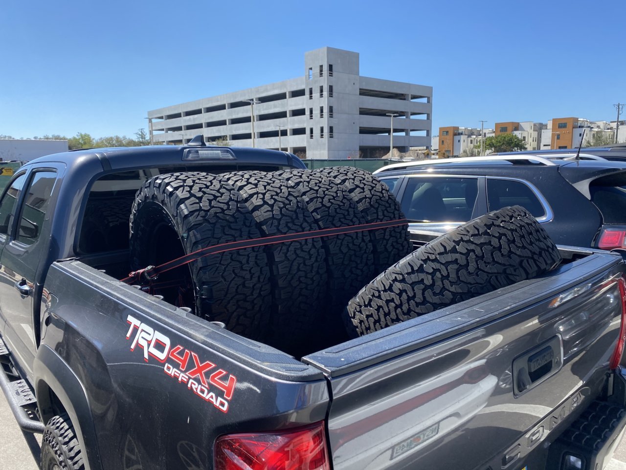

    Update: Picked them up this morning. Guy said he’s got tons of em, if anyone is in the Tampa area.
    They seem exactly like any other C load KO2, full tread depth. Fresh off a wrangler rubicon.
    Now to make them fit with no lift!

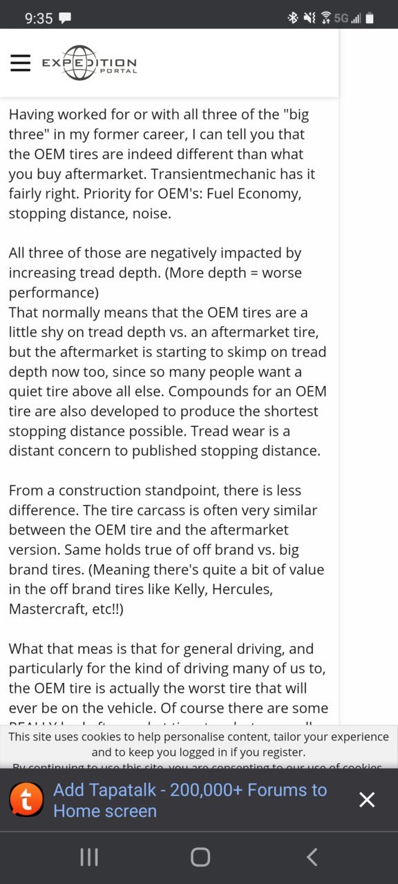

    Yep, this. This is the same as the 315 KO2 Raptor take-offs. Usually these take-offs can be had for a great deal so I would still do it, but something to be aware of.
