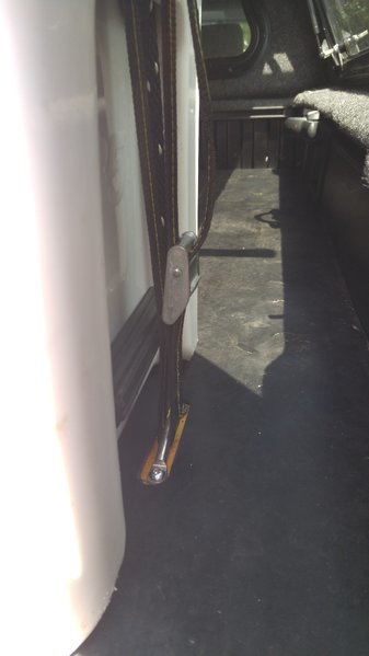

    Cooler Tie Down
    I didn't like the idea of the cooler (Yeti 35 Qt) bouncing around, so I found some stainless steal security bars from some broken kayaks I had, and bolted those to the bed platform. I used some T-nuts on the underside. There is a possibility that something could come lose, but I don't expect it.
    The final result:
    A close up of the tie downs:
    The cooler I have is the Yeti Tundra 35 Qt.

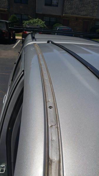

    So...I read the thread here about how to get under the rain gutter guards and find the factory mounting holes. With just a little bit of feeling around, I was able to find the factory mount holes.
    I used my leatherman and cut the vinyl protector out on just the holes I needed. The factory rack has many more attachment points.
    On my daily driver I had (as in it was on the car when I started, and was migrated to the truck as I was doing this) a yakima rack that bolted to the factory mounting points on that car. Funny enough, the Mazda 3 has factory holes that are hidden in a similar fashion as the Tacoma, so I had practice with this before.
    It turns out that the bolts for the Yakima mounts were not long enough to go through the rain gutter guard and into the factory mount points, so a trip to Home Depot solved my problems.
    I cut the vinyl to get to the factory holes, and I butchered the rain gutter guards to allow the bolts to pass through. There is a little bit of metal in the rain gutter guards to give the guards something. It wasn't that big of a deal, but it did cause some issues when I was trying to go right through.
    I coated the bolts liberally with some aquaseal (I had it laying around to repair some skits I use for kayaking, so I just used what I had on hand). We have had MANY serious storms since I did the install and no noticeable leaks yet.
    Here is what the holes look like when everything has been cut away:

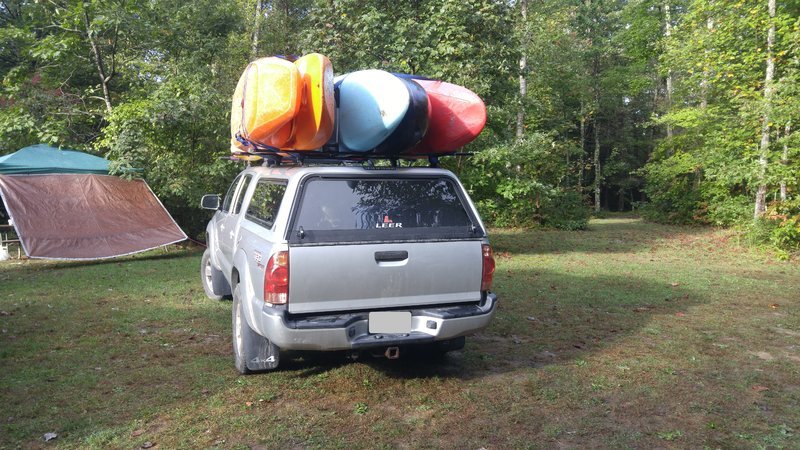

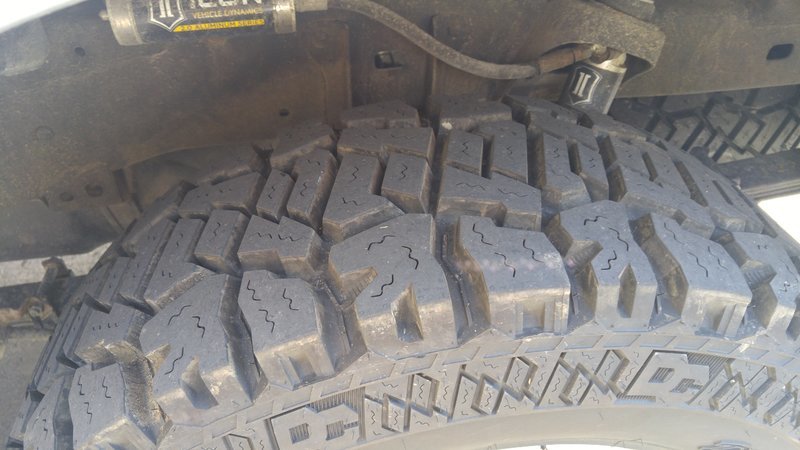

    Had the rear leaf springs replaced with Dakars. At the same time had the tires replaced with Dick Cepek Fun Country 265/70r17. There is a little bit of rubbing on the lower control arms (though there was rubbing with the previous tires as well). I will want to get that taken care of at some point.
    The truck is now level, and I am much happier with the stance.
    The speedometer is now reading true, but the odometer is off (haven't done the math to figure out how much). It appeared that I lost some mpg, but with the odometer off, I am not sure by how much. With the heavier wheels there is a definite impact on power going up hill.
    The truck sitting level (and a shot of the dog mod, best one out there).
    Close up of the tread on the Fun Country tires.

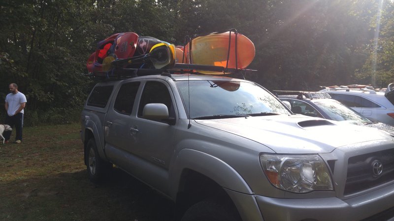

    Shot of the truck loaded up with 6 kayaks during Gauley season. I am sure I can fit more up there, but it is what it is (this is also prior to the leaf spring changes and new tires).

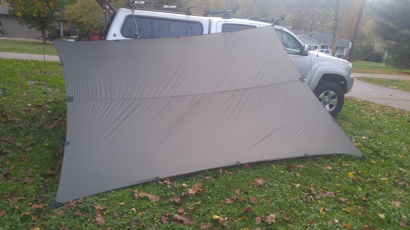

    Truck Wing shaped Tarp Update
    I ordered the Hex12 Tarp Kit from RipstopByTheRoll. The kit is for a hex shaped tarp, but I would rather have a wing shape, so I veered from their design.
    I will have some pictures to show the tarp in the near future, but I finished the sewing last night. I still have to seal the seam, and I have to check to see how it fits. There is a good possibility that the tarp is going to be bigger than what I want for going off the truck itself. If that happens...I get to make a 2nd tarp (and possibly a 3rd that is bigger than what I just made). The goal is to be able to attach the tarp (and get some tension) to the racks on the front cab and rear cap. I will then get some poles and draw tension from the truck to the poles and have rain go away from the truck. I worry that the tarp is too big to draw tension between the racks on the truck.
    This tarp packs down super small. I should be able to easily have 3 tarps that will be easily stored in the truck for all of my needs.
    The rough dimensions of the tarp is 10'x12'.
    I was able to get better at sewing through this project, so that is a bonus. I still have a few other sewing projects that I am going to kick off soon.

    I did a quick fit test of the Wing Tarp to the truck, and even when I go with the short side attached to the truck racks, it is too wide for my taste. I will not be able to get good tension on the side attached to the truck to keep things taut. But...I do have a good medium sized tarp for other uses.
    The tarp itself does have some flaws, but for a first attempt I am happy. I learned a lot with this project and I will be able to use what I learned and make some better tarps in the future.
    The test fitting looked something like this.

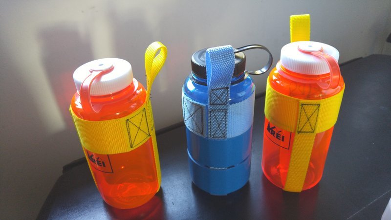

    Since I had some time and some Nalgene bottles laying around, I decided to create some harnesses for them so that you can clip them to things. To keep things secure, I wrap duct tape around them (because you always need extra duct tape). I am gearing up for a Grand Canyon trip in January, so I am going to get some other sewing projects worked on between now and then. These bottles are specifically for that trip. Good way to carry liquor.
    I took some measurements of the racks on the truck. I have 8' to work with. If I make the tarp 7', then I will have some room to get the tension I want. So...looks like another tarp (or two) is in the future.
