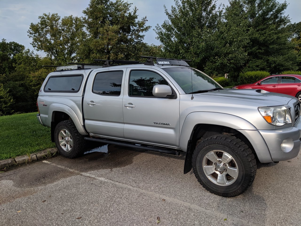

    Current Pic (9/5/2019):

    Truck Cap Install
    Leer 100RCC with lots of options. I had intended to get the vented windoors, but there was a miscommunication and I ended with with just windoors. We will be discussing switching them out at some point.
    I asked for the longest Thule bars they could get their hands on. Turns out the longest bars are about 79" long. It also turns out that is longer than I really wanted, but it is pretty easy to cut them down. Initial pictures are with the longer bars. I did cut them down to be 68" long (as seen in later pictures).
    Height before install (can't remember if passenger side or driver side, but the order of the pictures is the same for the before and after):
    Height after the install (lost about an inch):
    Windoors:
    You can see how far out 79" bars stick out here:
    General truck shot:
    After I cut the bars down, this is how it finally turned out:
    Final shot (with the dog):
