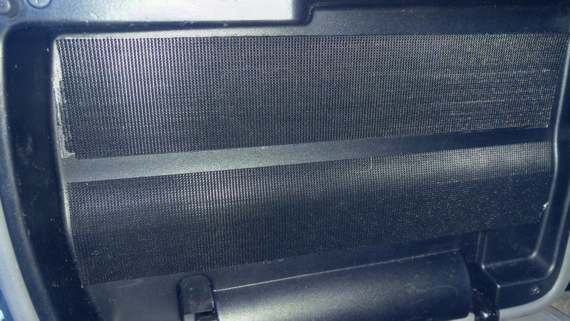

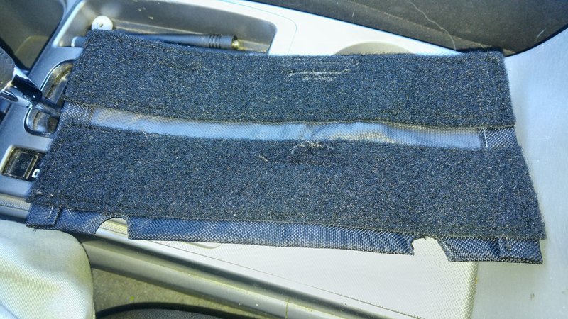

    Grid-It replacement
    I finally took some pictures. I continued to have issues with the Grid-It where it would not stay where I wanted it to. In an effort to solve the problem I tried to sew the velcro to the organizer, and ended up breaking my sewing machine. The sewing machine was eventually fixed (and it didn't cost a fortune).
    The space where the Grid-it was valuable to me, so a new solution was needed. Since I only have 1 or two things I would like to store in that location, I figured I could sew up something that was purpose built. In the end I did just that.
    Here are the pics.
    Top of the center console
    Back of what I sewed up.
    Organizer installed
    Drainbung likes this.

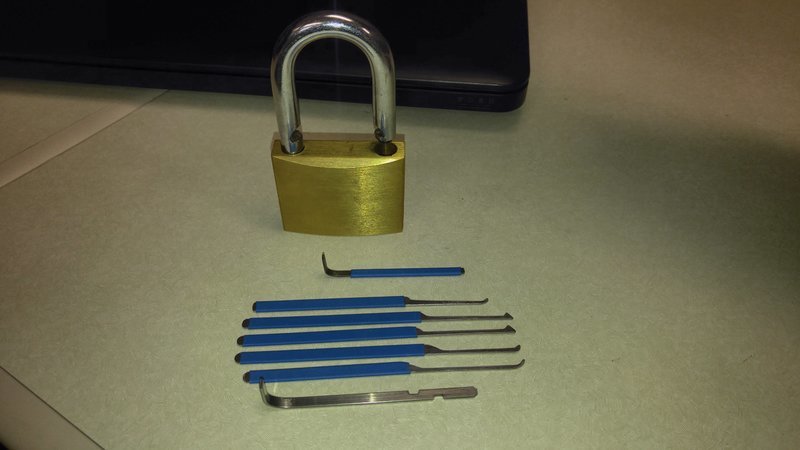

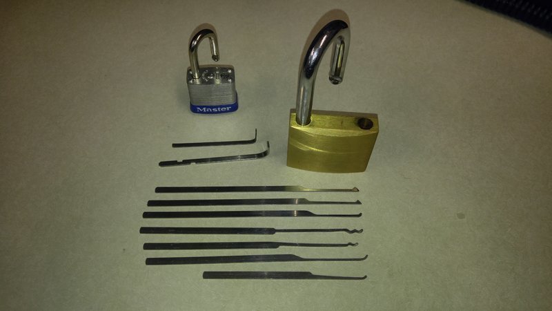

    Homemade lock picks
    I have some purchased lock picks from Toool, but they lacked a few shapes that I wanted. I watched a video where a guy talks about making picks from the metal found in windshield wiper blades, and I thought...yea...I could do that. So, I made a few. Then talking to a co-worker, he mentioned wrapping them with shrink wrap to be easier on the fingers, and that was a much easier solution than what I was thinking.
    So...I have a small set of picks to keep in the truck (so...yea...it can be classified as a tuck project). I still have a few more shapes to make, but I have some of the basic shapes for most general purpose locks.

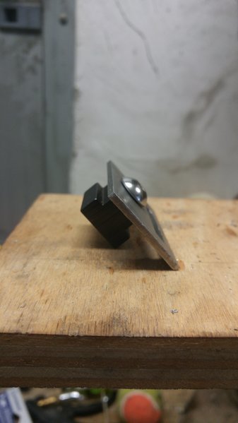

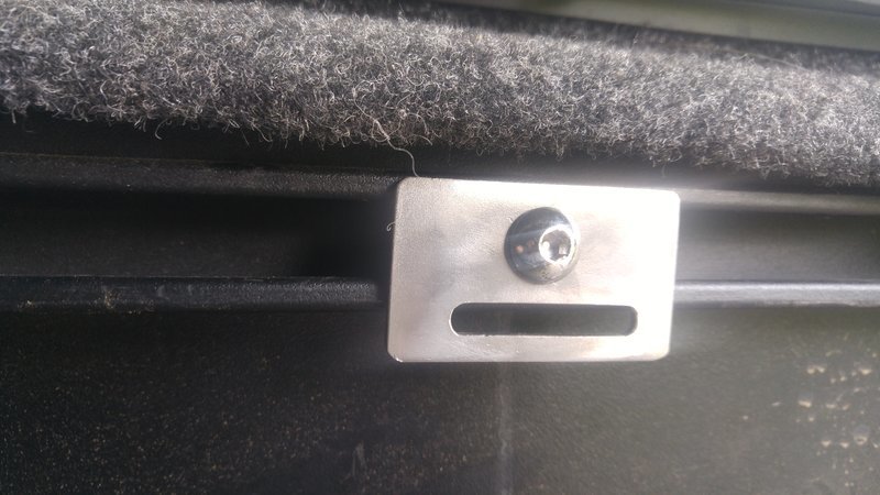

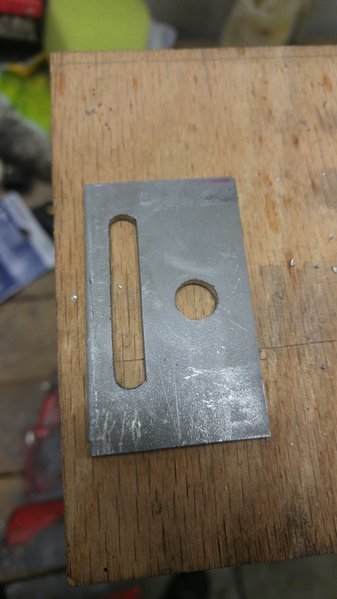

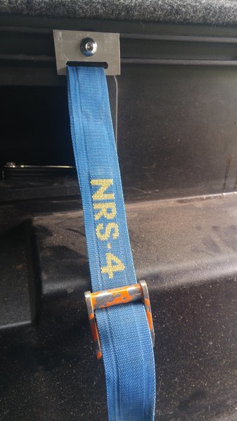

    Bed Rail Tie Downs
    When evaluating additional tie down options for the bed platform, I realized that I will need some lower profile tie downs at the bed rails.
    I am using T-nuts (used in another project), and cheap steel found at Lowes. I am sure there are easier ways to make these, but I used the drill press, files and a grinder to put this all together. I initially forgot to paint these, and then noticed they were beginning to rust some...so they are currently sitting with the primer drying (last picture). I will finish them up with some paint soon.
    Pics (which are pretty self explanatory):
    This was before I smoothed down the corners with the grinder
    Primed and drying
    Materials used:

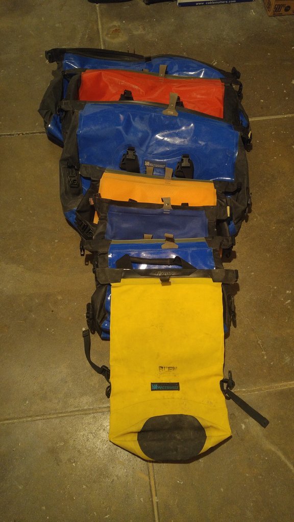

    Gear storage (Watershed and Pelican cases):
    Over the years I have accumulated lots of pelican cases and Watershed bags. The pelican cases are all quite old, and the Watershed bags vary on their respective ages. I tend to pick up Watershed bags at Gauley Fest and save quite a bit of money. These bags are damn durable. The ones I use have survived a couple of Grand Canyon multi-day river trips. In fact, the Watershed bags were purchased specifically for those trips (and more have been picked up because they work so great).
    My selection of Pelican Cases:
    • Pelican 1400
    • Pelican 1200
    • Pelican 1150
    • Pelican 1120
    My selection of Watershed bags:
    • Colorado
    • Yukon x2
    • Chattooga
    • Ocoee x2
    • really old small duffel (small yellow one in the picture)
    • for kayaking (not good for the truck) I have:
      • futa x2
      • salmon
    The Watershed bags are good for the soft gear I pack, and I have a liner for the Chattooga and Ocoee that I can pack my camera equipment in. The Pelican cases are being re-purposed for some of my various electronics that I find myself carrying more and more. I have (and probably will continue) to designate one of the pelican cases for first aid.
    If you haven't checked out watershed bags, you really should. These things are hard to beat for keeping stuff dry, and they have proven to be surprisingly durable on Grand Canyon expedition trips.

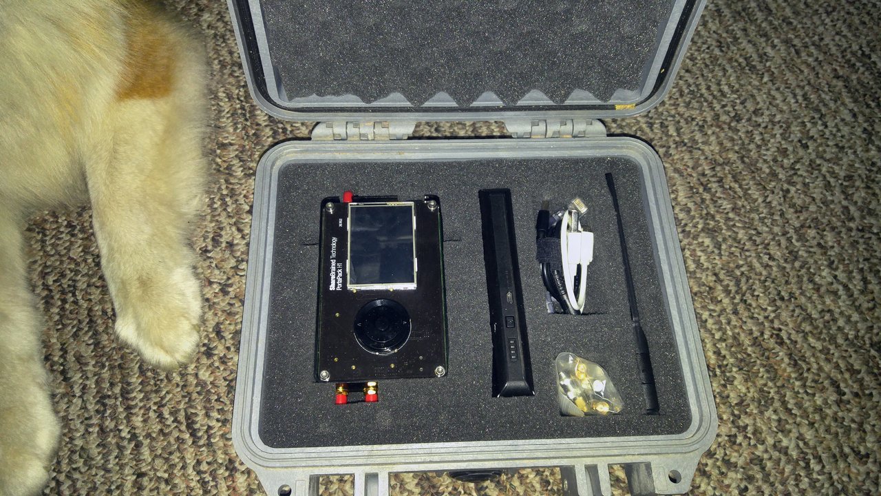

    Wardriving update

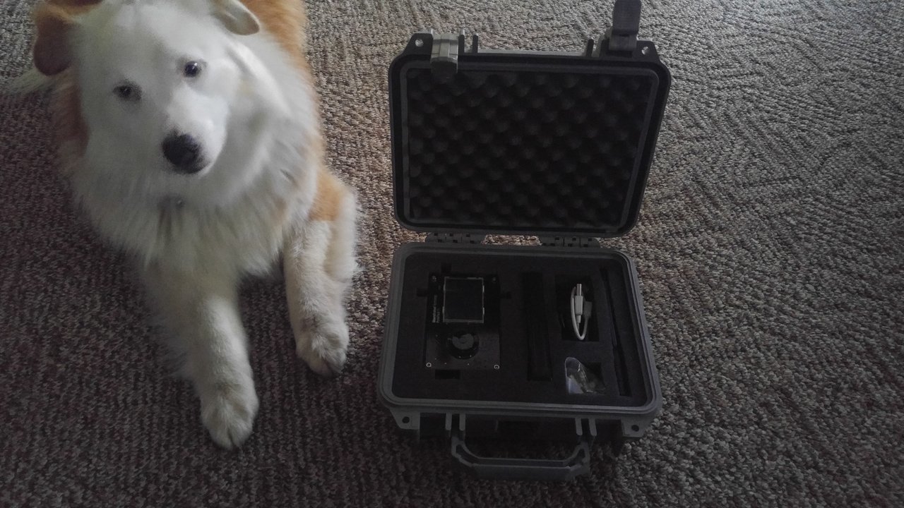

    Wigle is running, and I did pick up a Mob Armor mount. The suction cup mount works okay, but I am going to use the double sided tape mount instead. I have found that using a dedicated GPS device for mapping, and a dedicated device for Wigle works best, but Wigle does provide a nice map feature.
    Wireless shenanigans
    I took a pelican 1200, and dedicated it to the HackRF (with portapack) and the Pineapple Mark V. Everything is nice and tidy. I also went ahead and picked up a new antenna for the HackRF.
