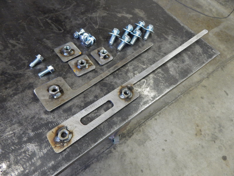

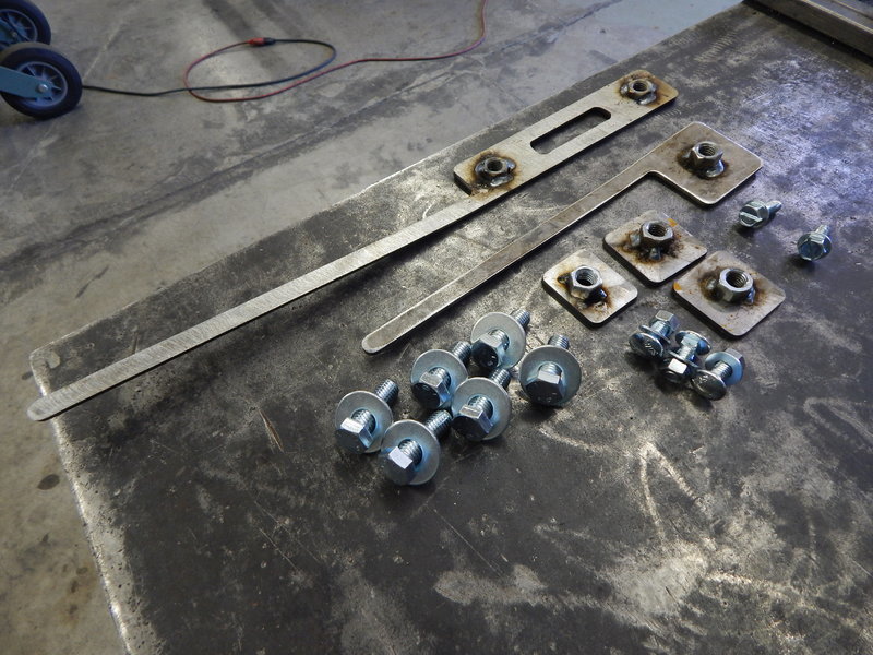

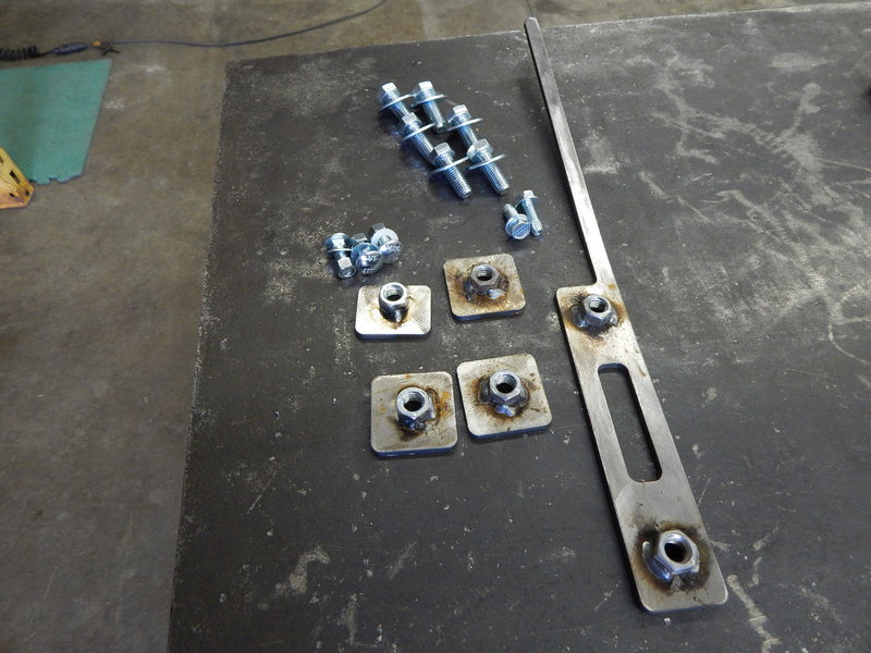

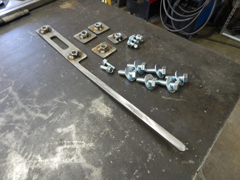

    Hardware included:
    -8) 1/2" x 1 1/2" Flange bolts
    -4) 1/2" Flange nuts

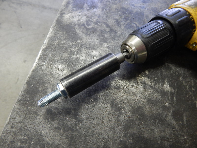

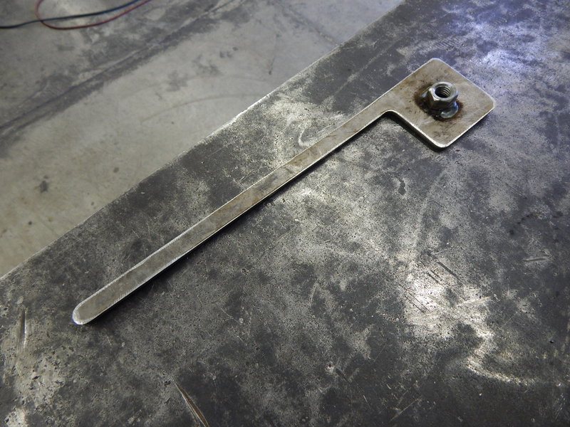

    -1) nuts on a stick, front driver side (reaches inside boxed portion of frame rail)
    -1) nuts on a stick, front passenger side (reaches inside boxed portion of frame rail)

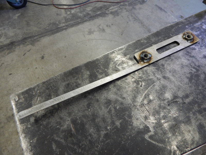

    -2) square nut plates (2" x 2" plate)
    -2) rectangle nut plates (2" x 1 1/2" plate)
    -4) 3/8" x 1" Grade 8 bolts
    -4) 3/8" Grade 8 nuts
    -4) 3/8" x 1" thread cutting screws
    -6) 3/8" x 1" carriage head bolts
    -6) 3/8" flange nuts
    -14) 3/8" flat washers

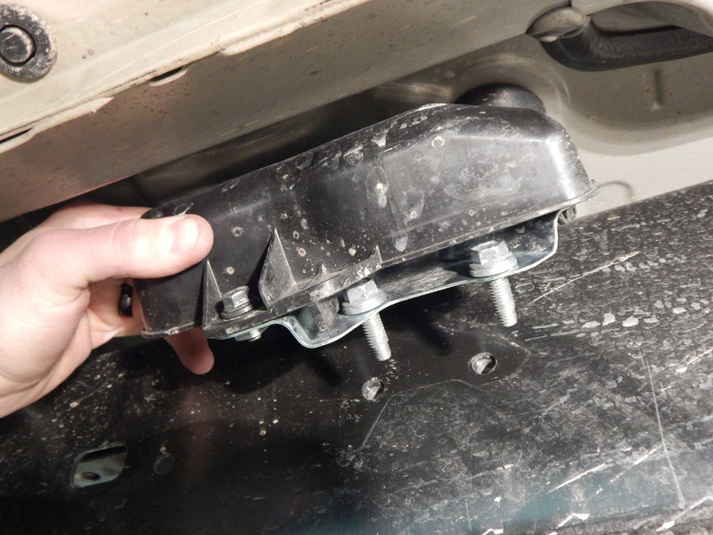

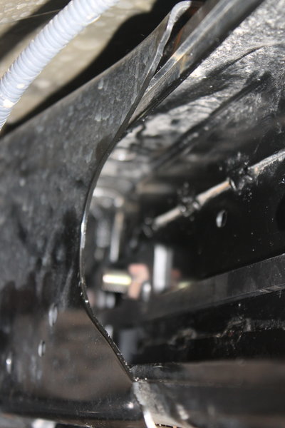

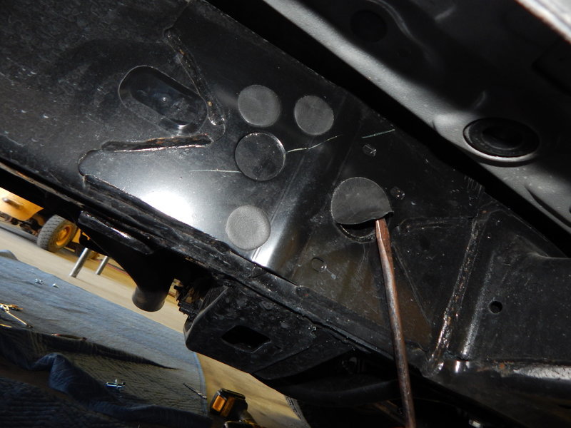

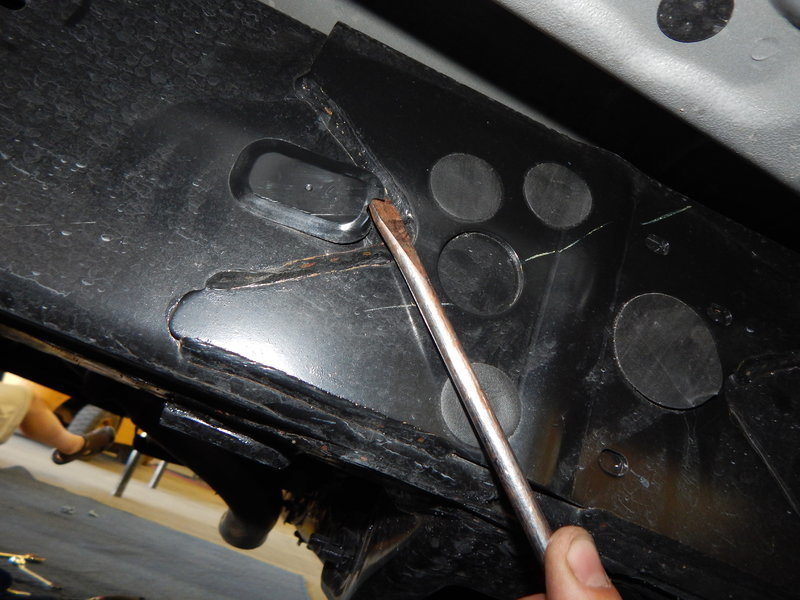

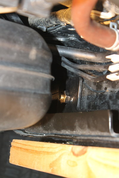

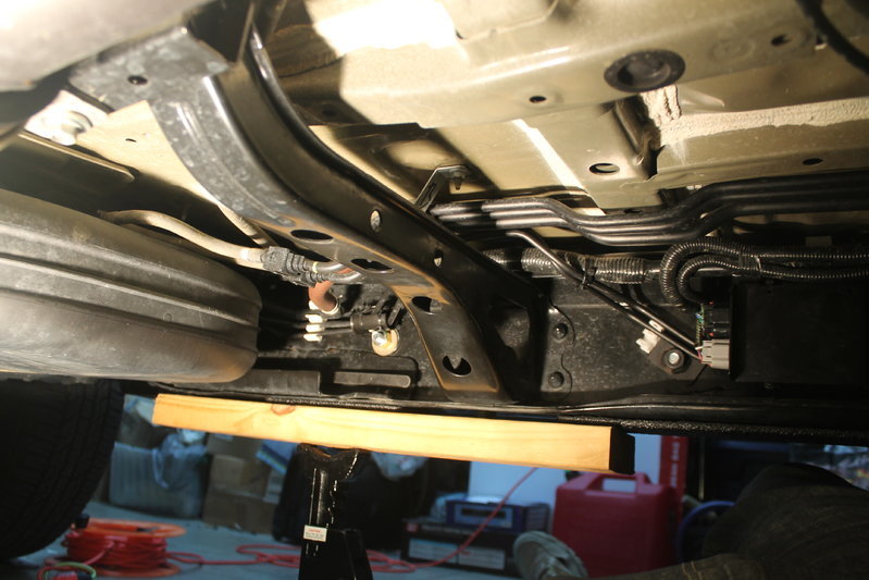

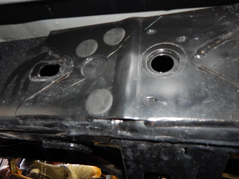

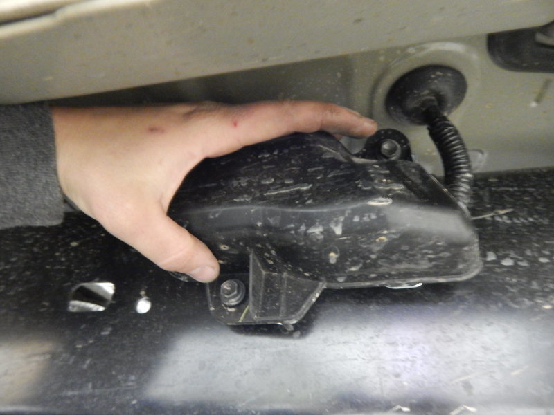

    1) First off you will need to remove the round rubber cover and the rectangle plastic cap covering the holes in the frame rail on both sides near the large body mount bracket. Not all models have these covers, so some of you may not need to do this. Use the flat head screw driver to get under the edge and pry the covers off.
    2) Remove these two nuts from the driver side using the 12mm wrench or socket.
    3) Pull the bracket away from the inside of the frame rail on the driver side.

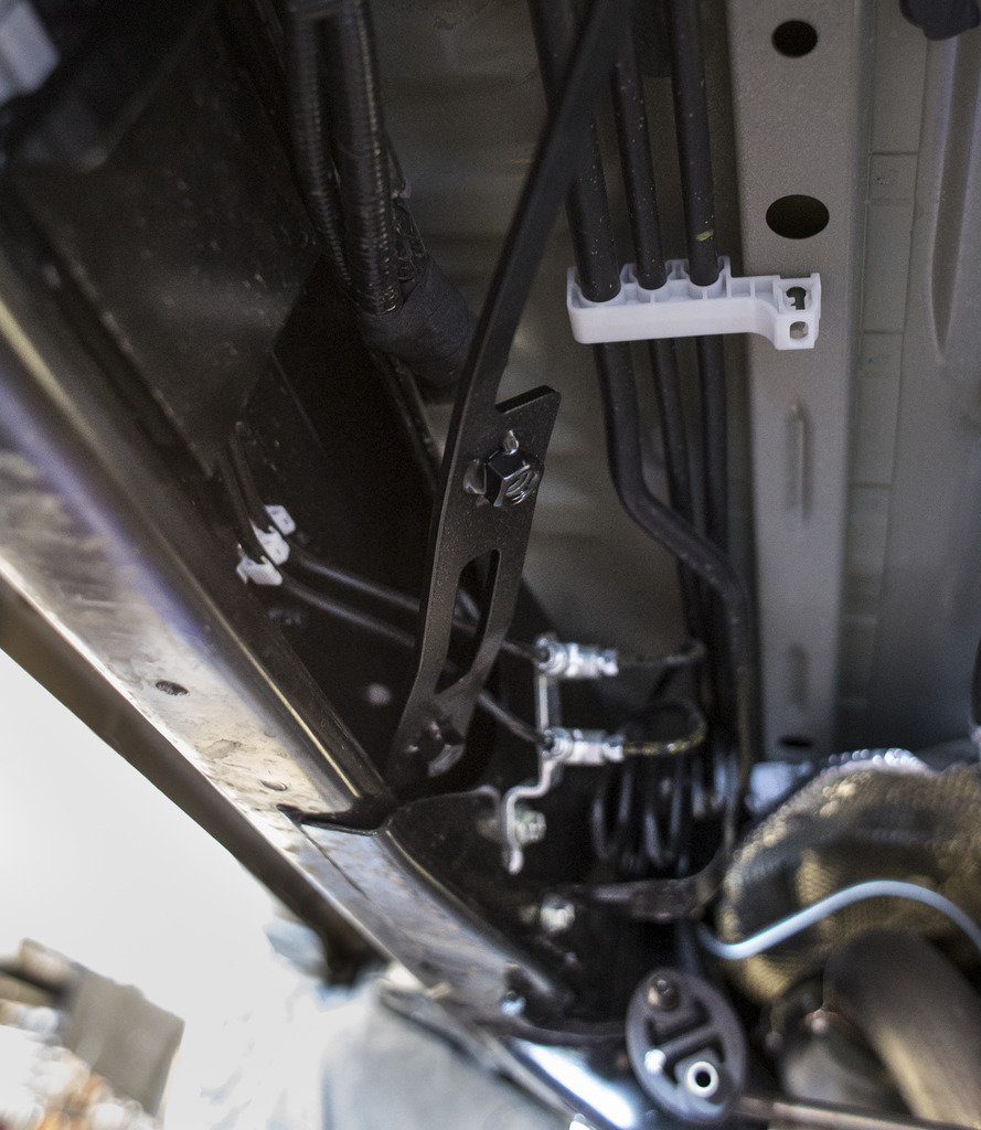

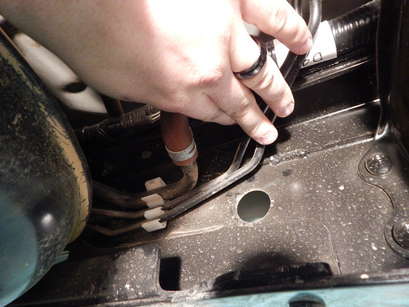

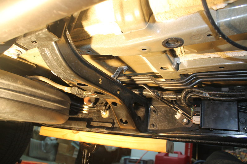

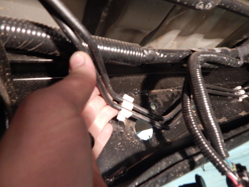

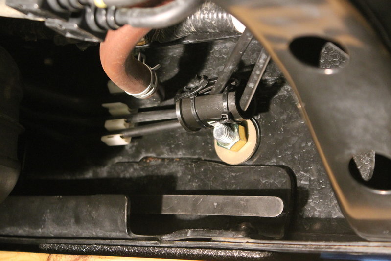

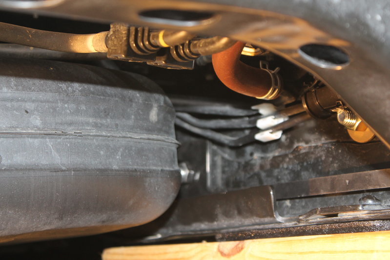

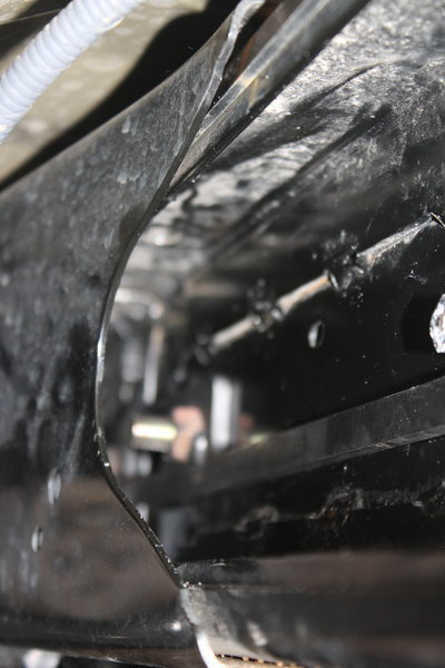

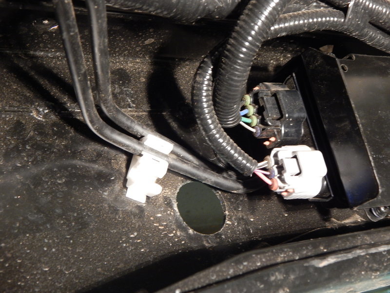

    4) Pry the hard steel lines out of the plastic clip. Move the lines up so that the bottom line clips into the top plastic clip. The top line will be fine above it without a mounting clip. These lines need to be moved away from the hole in the frame so that a bolt can pass through.
    5) Adjust the lines near the fuel tank up and away from this hole so another bolt can pass through.

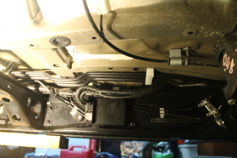

    6) Remove the bolt for the wiring harness bracket on the driver side. The slider mounting plate will fit up behind this bracket.
    7) I must have forgotten to get a picture of this step, but you will need to also pop the plastic clip out of the frame on the driver side for the same wiring harness as the above step. The wiring harness needs to be pushed up to the top of the frame so that it does not interfere with the slider mounts.

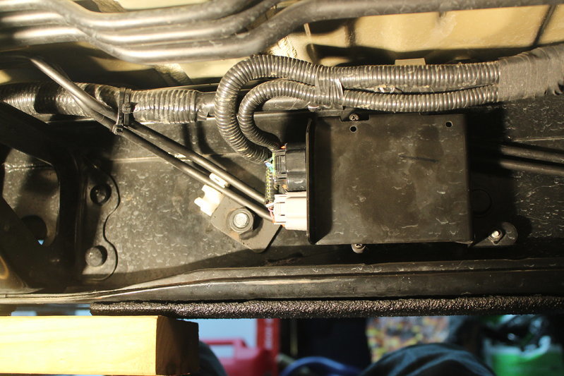

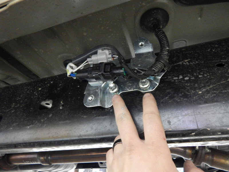

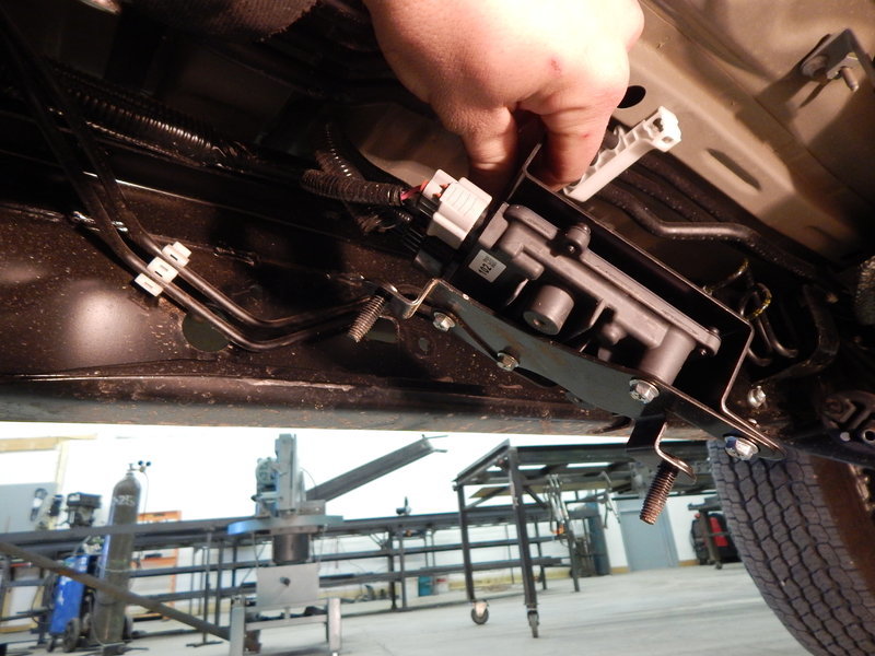

    8) Move to the passenger side and remove this wiring harness bracket cover using the 10mm wrench or socket.
    9) Then remove the two bolts holding the bracket to the frame using the 12mm wrench or socket.
    10) I know this photo shows both bolts still in the bracket, but you only need to leave the bolt on the right in the hole on the metal bracket. Then re-install the plastic cover to the bracket.
    Leave the bracket hanging from the frame for now. It will get re-installed after the sliders are in place.

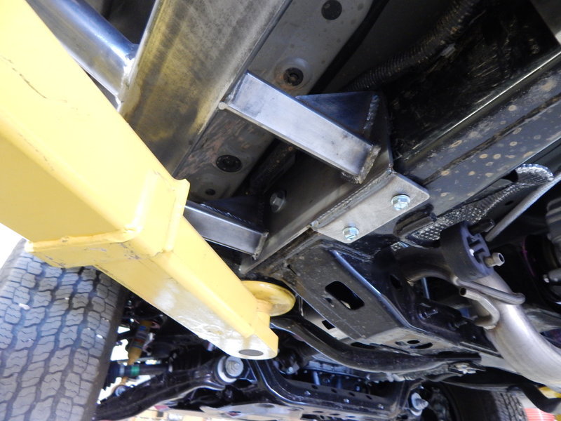

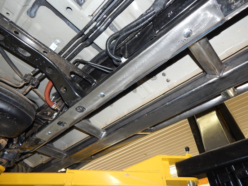

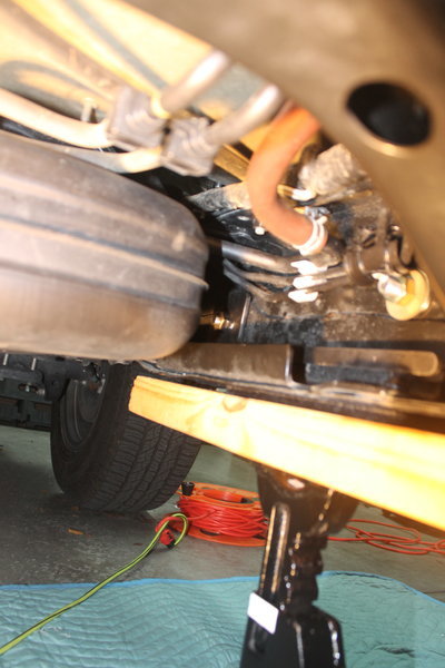

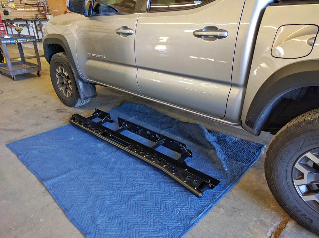

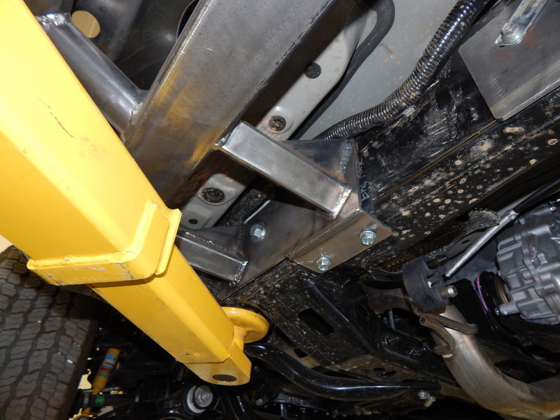

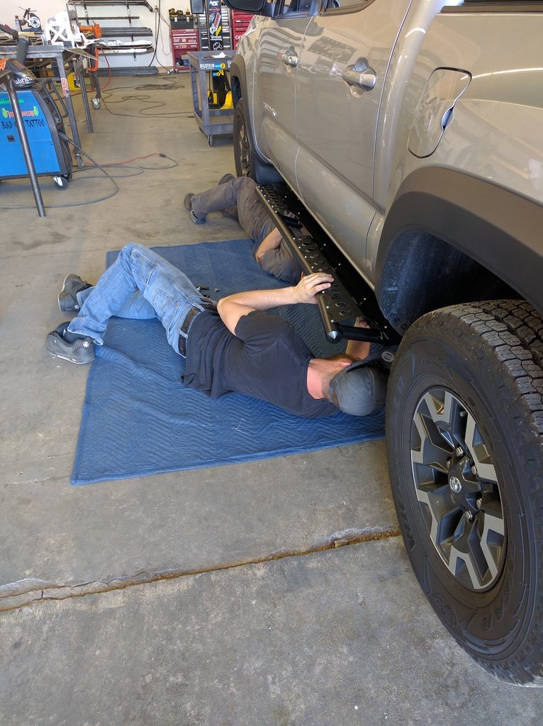

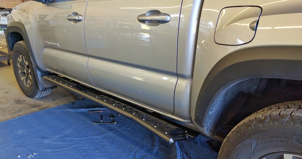

    11) Lay the sliders in position on each side of the truck.
    12) Lift the sliders up into position. Once they are close to the correct position, they can be set on jack stands to help support the weight while you get some of the bolts started.
    13) We recommend getting the electrical box in position on the driver side first and putting these two nuts in place to help hold the slider in position. Do not tighten any of the nuts or bolts until all of the hardware is in position!

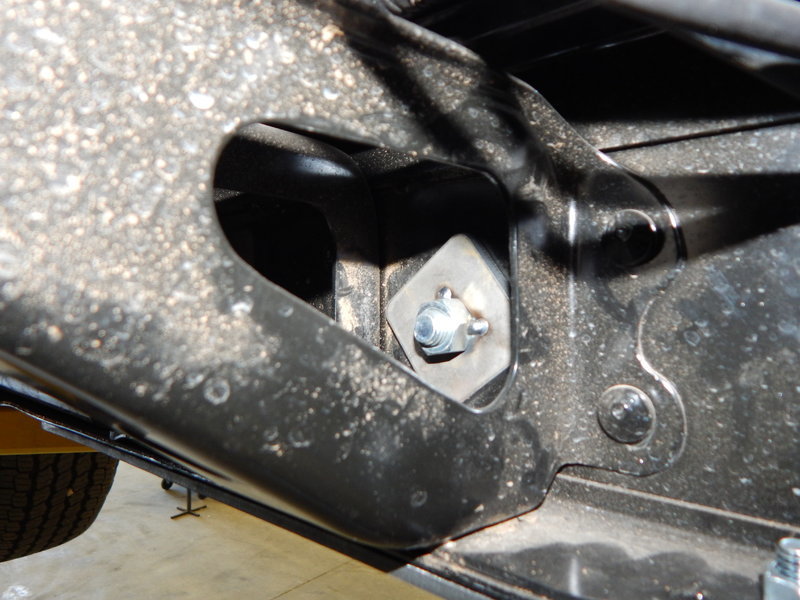

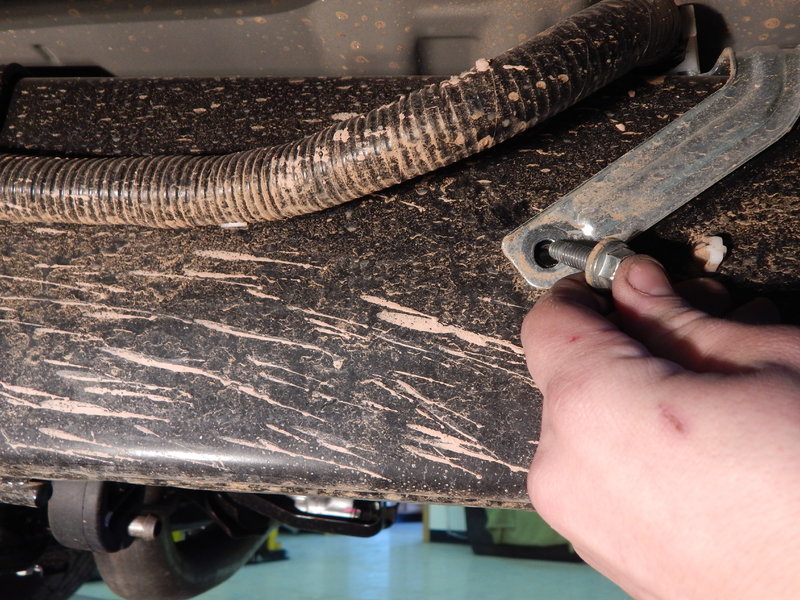

    14) Then install the 1/2" x 1 1/2" flange bolts through the large holes in the frame rail where the steel fuel lines were re-positioned earlier.

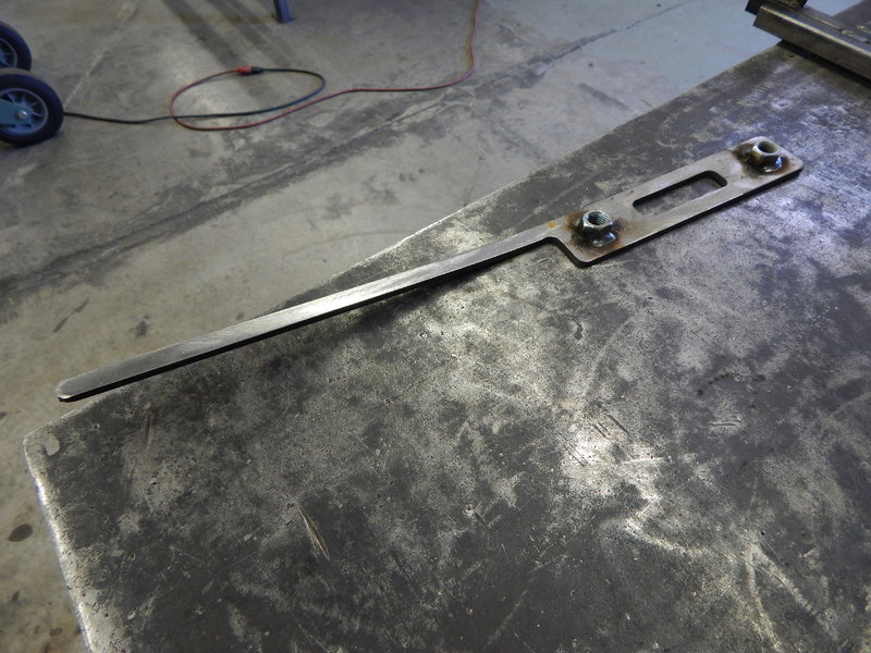

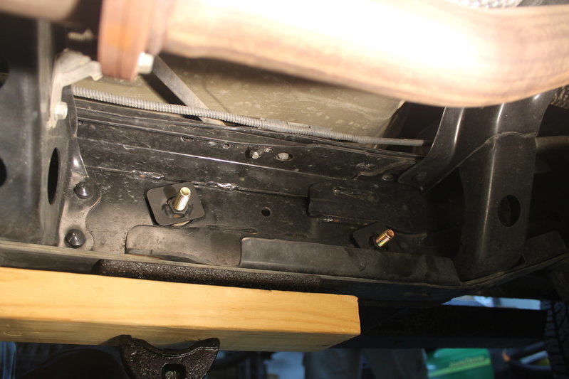

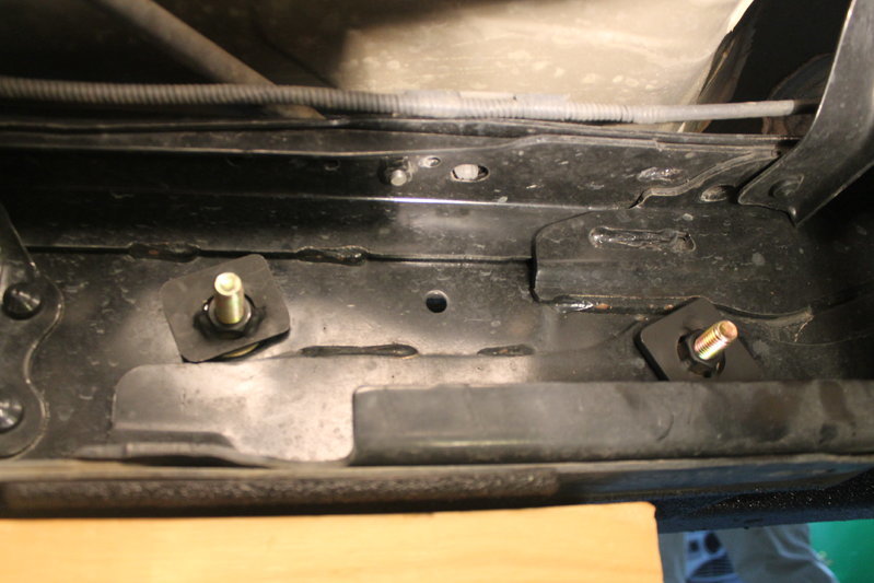

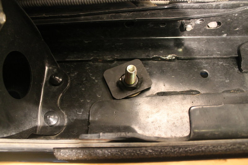

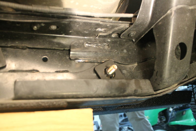

    Install the nut plates and flange nuts on the back side of the bolts. These pictures show where all of the 1/2" bolts go through the rock slider plate and frame. (please note that there are not as many holes in the side of the frame on the 2017 and up tacomas so not all the bolts shown in these photos will get installed if you have a 2017 and up model.) The photos also show the 8mm nuts and the 10mm bolt that get re-attached to the frame in their original position. We now send gold colored grade 8 flat washers that can be installed first before the 8mm nuts go back in place on the electrical box mounting studs.
    These photos show where the captured nuts go on the back side of the frame. 2017 and up will not use all of these holes.
    Use these captured nuts on a stick to reach into the boxed portion of the frame rail at the front of the rock slider. The 1/2" x 1 1/2" flange bolts will fit through the holes in the frame where the plastic and rubber plugs were removed at the beginning of the instructions.
    15) The installation process is the same on the passenger side. Use these captured nuts on a stick to reach into the boxed portion of the frame rail at the front of the rock sliders.

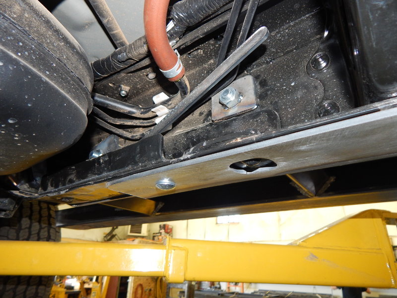

    16) Once you have all of the 1/2" bolts and captured nuts in place, you can tighten them just enough to hold the slider up so that it doesnt tilt away from the frame, but loose enough that you can still slightly adjust the slider.

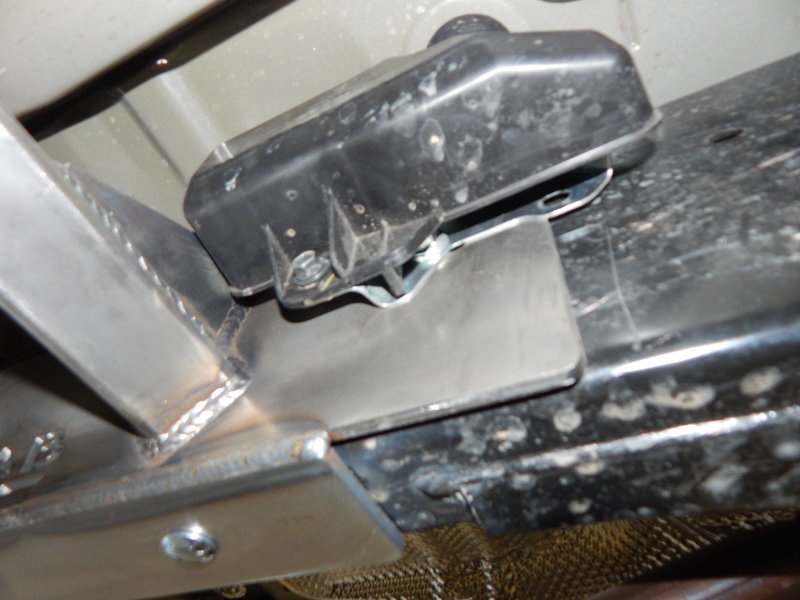

    Now the electrical connector bracket and cover need to be re-installed on the passenger side. When re-installing the bracket, you will only use one of the original two mounting bolts (the one on the left side that we left in the bracket before putting the plastic cover on earlier).
    Push the bracket over to the right (towards the front of the vehicle) enough so that the one bolt can be installed in the original hole that is on the right side (closest to front of the vehicle). Use a 12mm wrench to install the bolt and hold the bracket in place.

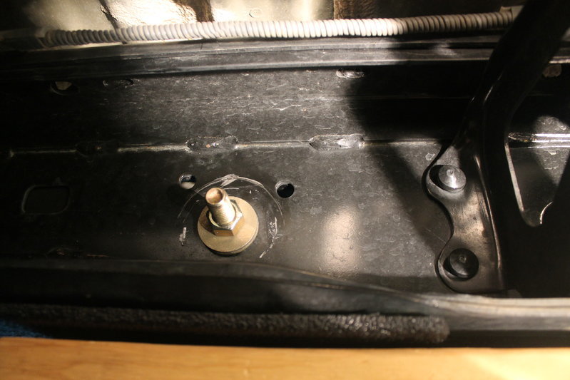

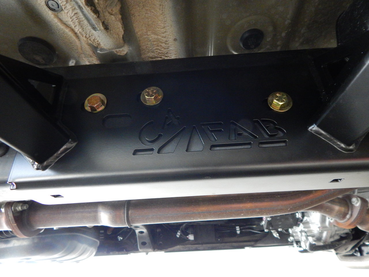

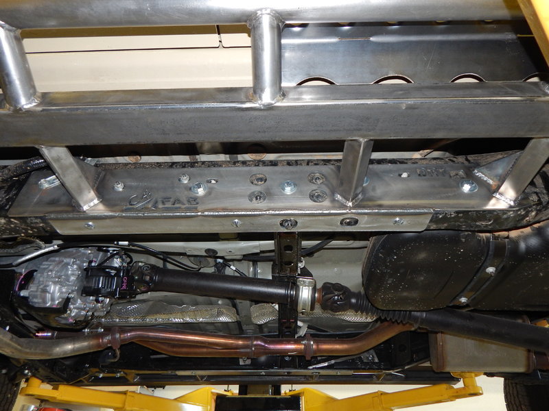

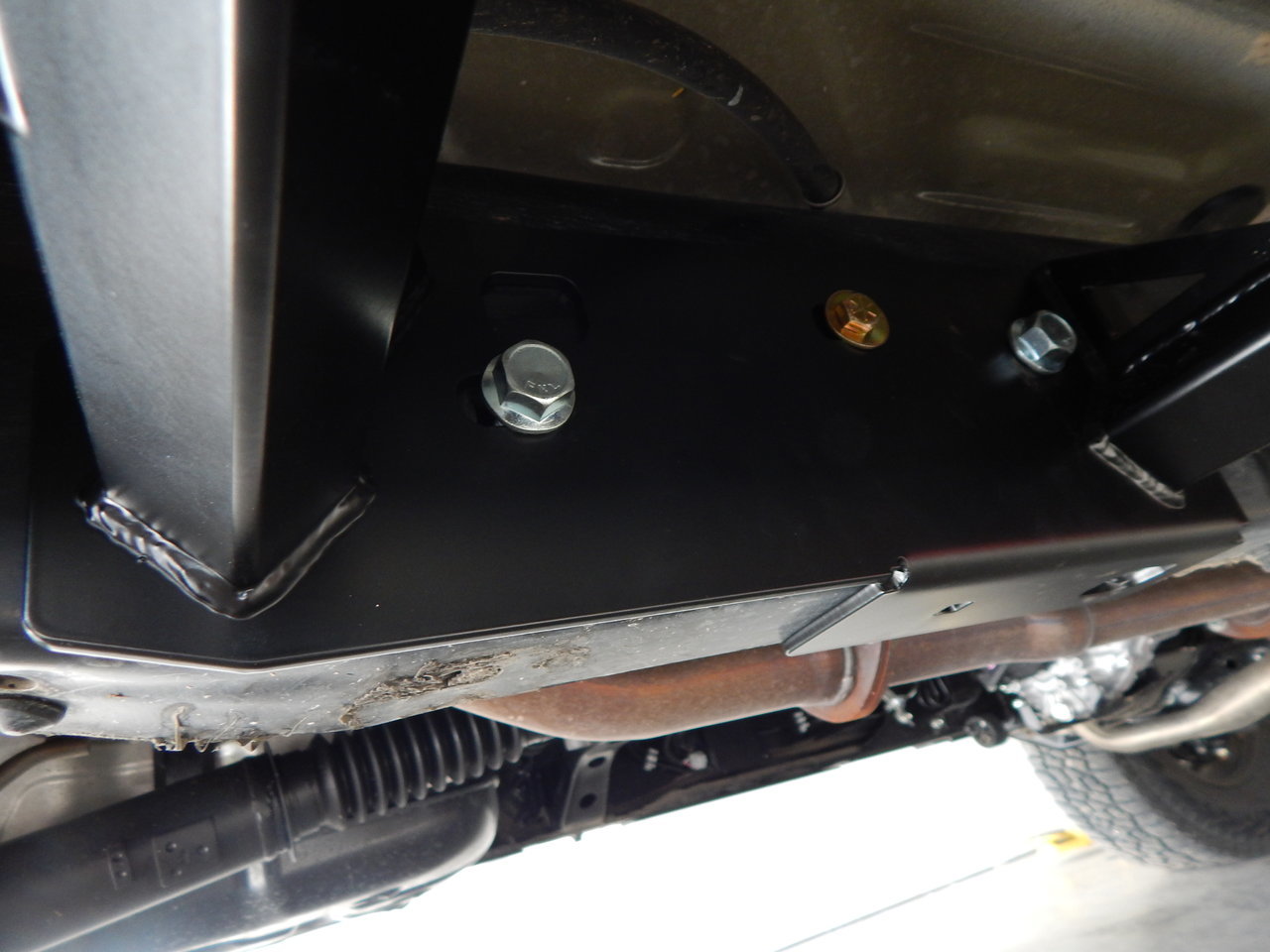

    17) Now install the 3/8" x 1" gold grade 8 bolts through the remaining holes that line up on the passenger side middle section of the frame mounting plates. Use flat washers on both sides and a split lock washer on the nut side.
    There is also one more grade eight 3/8" x 1" bolt that can go through the frame on the rear most frame mounting plate of the slider.
    18) Now that all of your hardware on the vertical portion of the frame rail is installed, lift up on the sliders at the frame mounting points on the bottom of the frame to make sure the sliders are sitting tight up against the bottom of the frame rail.
    Fully tighten all of the hardware that is currently installed.

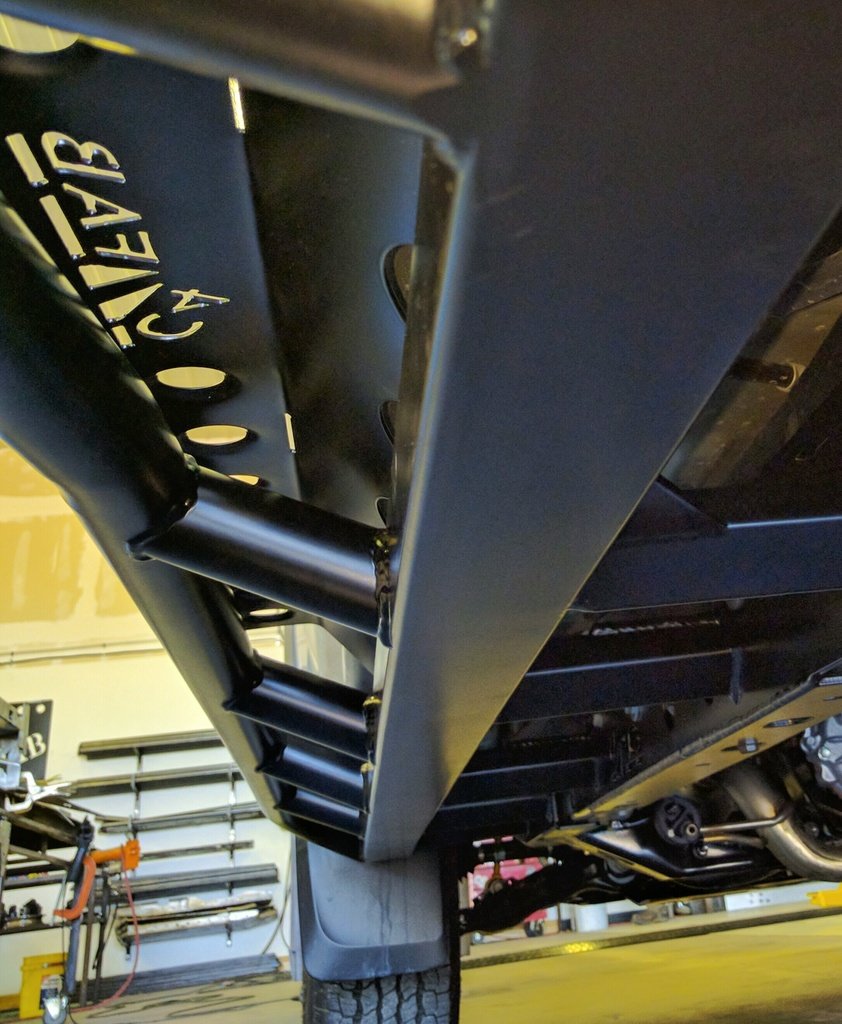

    This is the extra hardware install portion that is highly recommended/required for heavy off-road use.
    We recommend wearing long sleeves, gloves and obviously safety glasses to protect from the hot metal shavings while drilling through the frame rails!

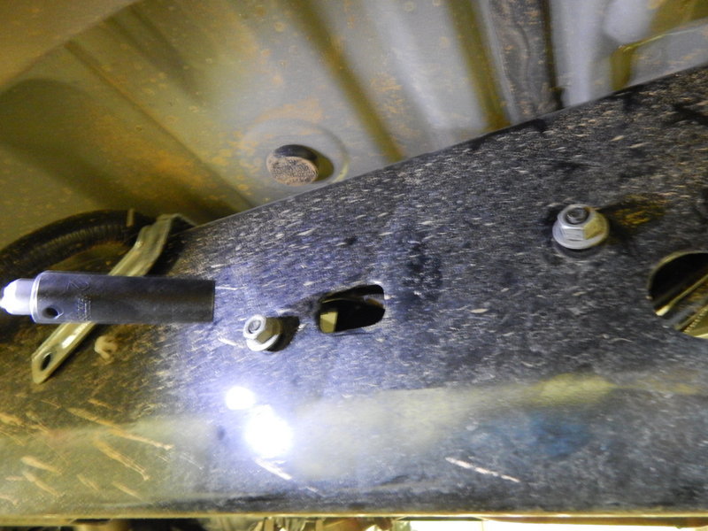

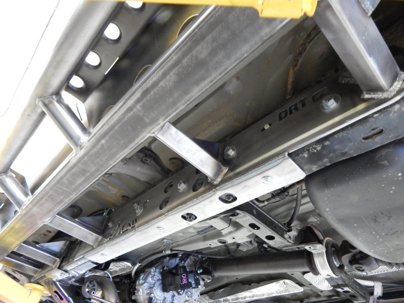

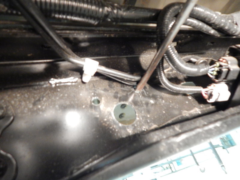

    20) Use the drill and 5/16" drill bit to drill up through the bottom of the frame rails at the forward mounting bracket of the rock sliders. There are two holes on both the driver and passenger side.

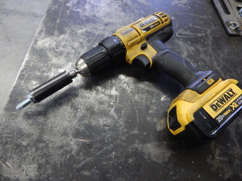

    21) Install a socket driver into your drill (do not use an impact drill) and attach a 9/16" socket to the socket driver.
    22) Apply a small amount of WD-40 or drill/tap lube to the 3/8" thread cutting screws. Use the drill to power tap the thread cutting bolts right up into the bottom of the frame rail. Hold the drill perpendicular to the frame and use even pressure with the drill on a low speed setting. The thread cutting screws will thread themselves into the frame rail. If your drill is not powerful enough to thread the screws in by itself, you can finish the job with a socket wrench.
    Here is where the thread cutting screws get installed on each side
    23) Next you will drill a 3/8" hole up through the bottom of the frame rails on both sides where each square hole is located in the rock slider frame mounting plate. After the holes are drilled through, you can install the 6) 3/8" x 1" carriage head bolts with washers and nuts on the inside of the frame rail.
    You can see the carriage head bolts installed here:
    Perform a final check that all bolts are tight and your install is complete!

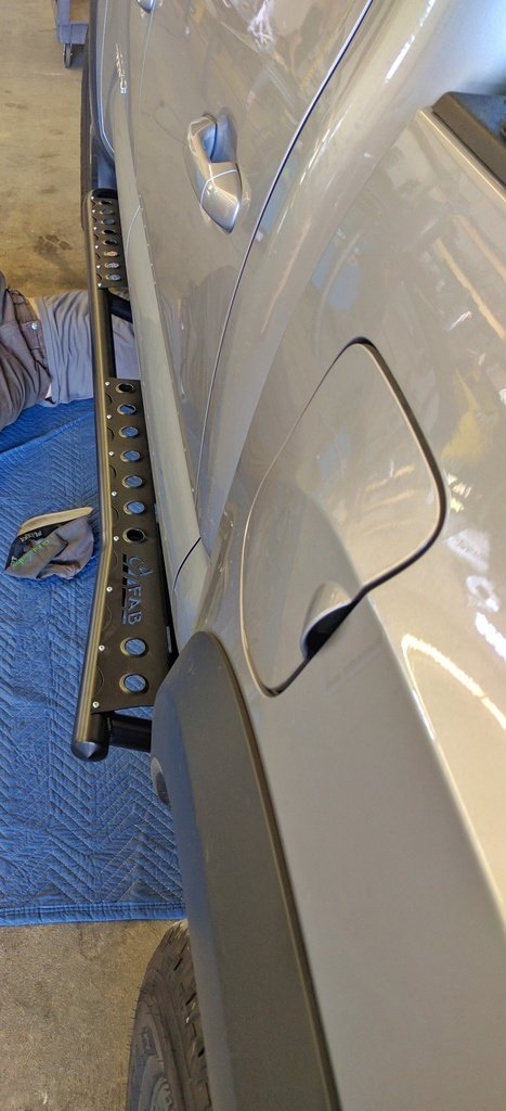

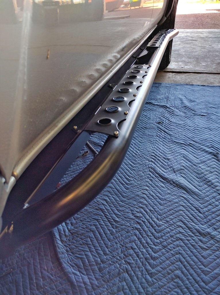

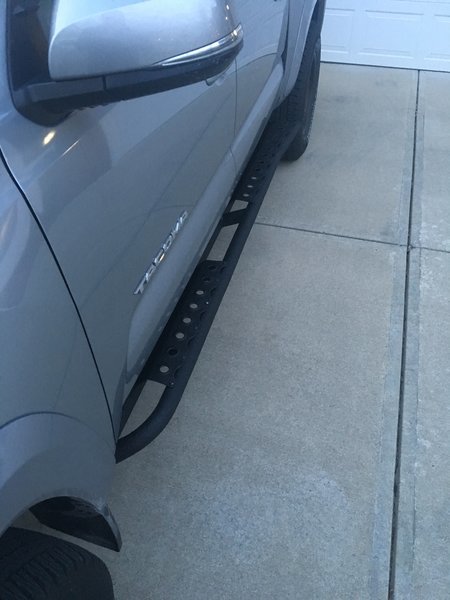

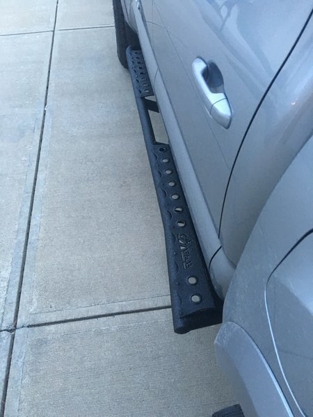

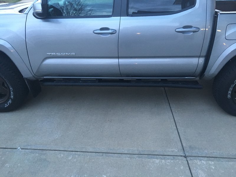

    Here are a couple pics of what your sliders will look like all installed. Thanks to @infamous_6969 for posting up a few nice ones on his build thread.

    i did have some minor issues with the quality of the mounting hardware i received which was another reason i went to grade 8 over the grade 5 included but i called and brought it to C4's attention and was told that the issue would be resolved moving forward so that you fine customers will not have the same concerns moving forward :) (VERY GOOD CUSTOMER SERVICE)
    overall the install was easy-ish
    it took me 14 hours over all to do but 90% of that was issues caused by the LINEX so let me stress again DONT DO LINEX (or rhinoliner)
    had i not had that crap on these the install would have taken less than 1-2 hours MAX
    overall i am VERY pleased with my products and will be ordering the front and rear bumpers shortly.
    Highly recommend their products and hope you guys find my words and pictures helpful.
    *;IGY6 BUILD TACOMA*
    IMG_3589.jpg IMG_3590.jpg IMG_3591.jpg IMG_2013.jpg IMG_2014.jpg IMG_2015.jpg IMG_2017.jpg IMG_2018.jpg IMG_2019.jpg IMG_2020.jpg IMG_2021.jpg IMG_2022.jpg IMG_2023.jpg IMG_2024.jpg IMG_2025.jpg IMG_2026.jpg IMG_2027.jpg IMG_2028.jpg IMG_2029.jpg

    Thank you for posting up your experience with the install and the helpful hints and pictures! Other potential customers like to read info from first hand experiences with the product. Also thank you for being understanding about the hardware issue we encountered, this has been resolved for all future customers. @Caboose117

    I just installed my sliders on my 3rd gen. I ended up rattle canning the slider portion, and having the step plates line-x'd. I figured it was the best way to have the grip on the steps and still be able to repair paint scrapes etc. from rocks. Instead of drilling the extra holes I plan to weld the holes instead in those locations. It may not be something I'd wish to do everyday but I ended up installing mine solo. A couple of 5 gallon buckets were used in place of buddies (who wants to install truck stuff at 4am) and it turned out to almost be in a perfect position. Once they were secured, I used a jack to insure they were against the frame. Overall I found the install to be a lot less hassle than I had originally had planed. Thanks for a good product!

    Thats great to hear! Glad the install went well. Post up a pic of the Line-x steps with painted sliders when you get a chance. I havnt seen that combo done yet.
