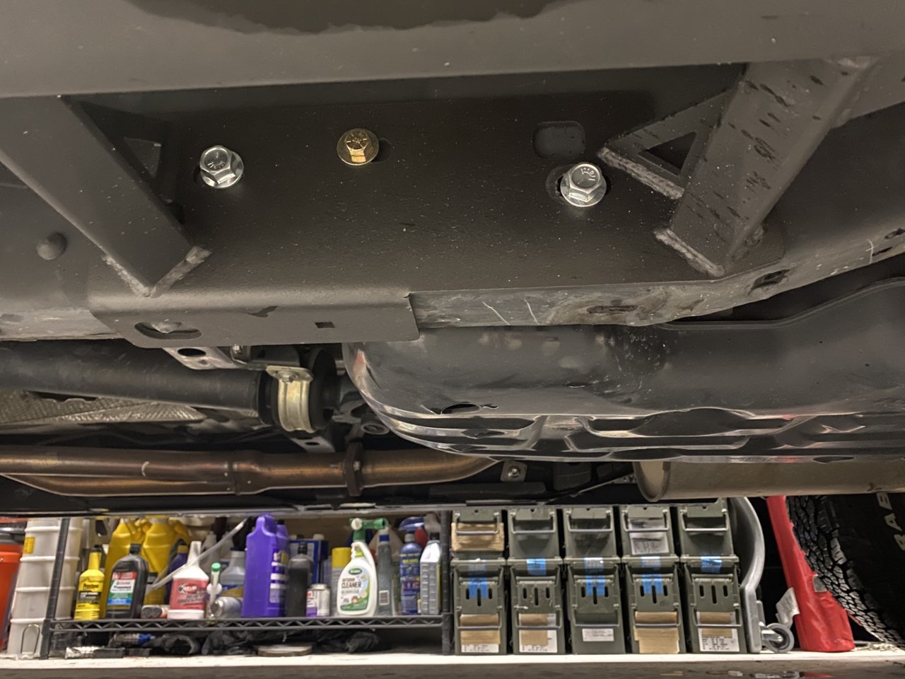

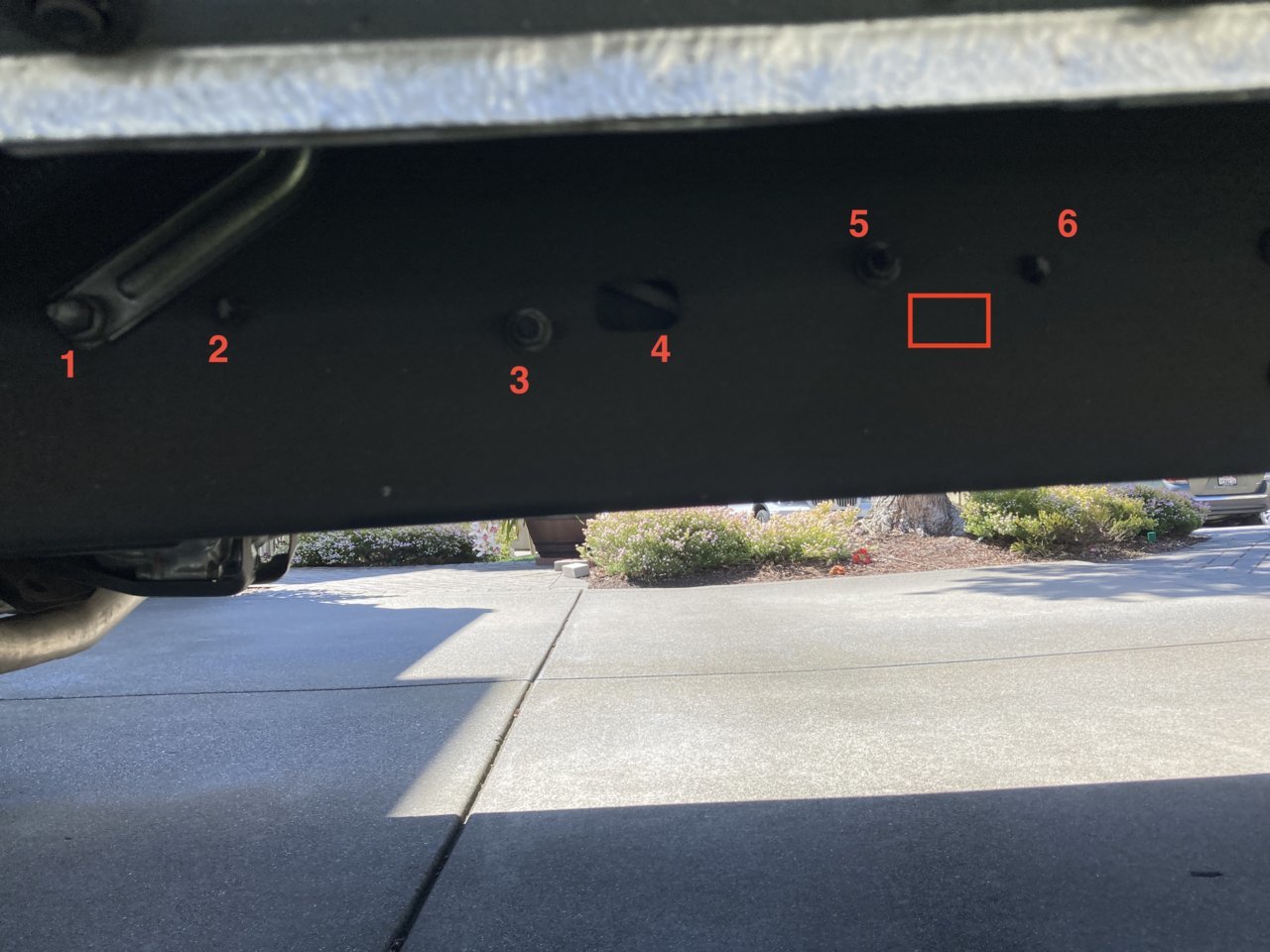

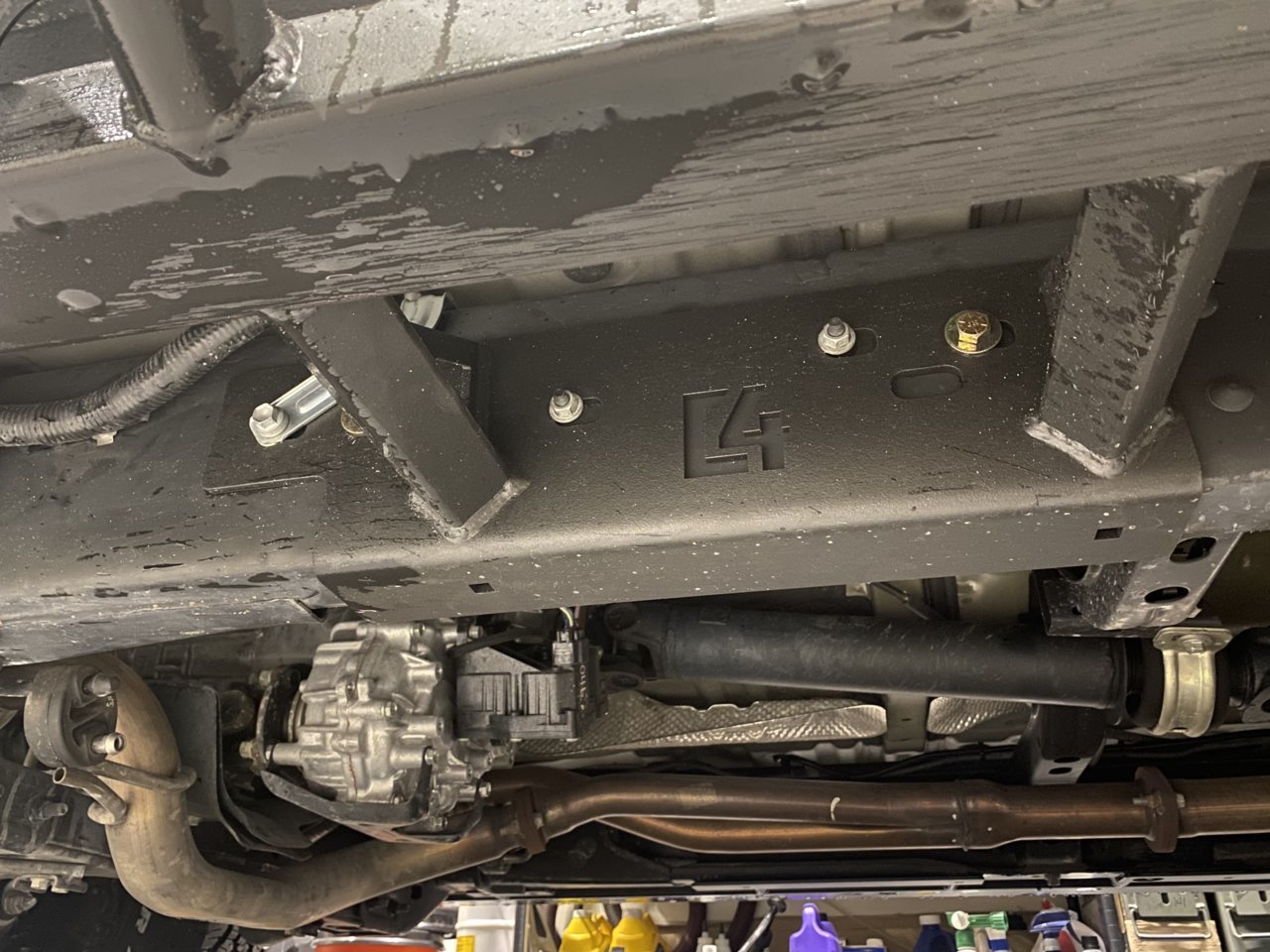

    @SpensirG On the driver side where the electrical box had to be removed, the hole for the 1/2" bolt doesn't line up with the hole on the slider, did you end up drilling a hole on the slider or drilled into the frame to line up the existing hole on the slider?

    Uh, All my holes lined up. I didn’t drill anything.

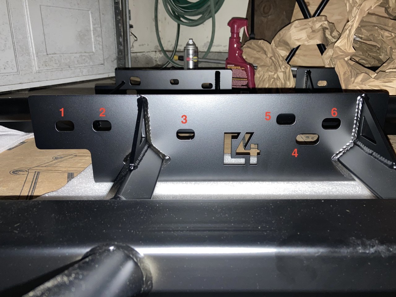

    @SpensirG @C4 Fabrication Here is what it looks on my driver side vs the slider. See how #4 hole on the truck is shifted to the left from the red rectangle which is where the hole is on the slider.IMG_1453.jpg IMG_1464.jpg

    Nothing is utililized in the #4 hole.
    The larger mounting bolts are used in the forward and aft plates. The two forward ones utilize the “nuts on a stick” while the aft ones use the nut plates.
    And here is the center plate.

    Thanks for clearing that up @SpensirG ! Very helpful!

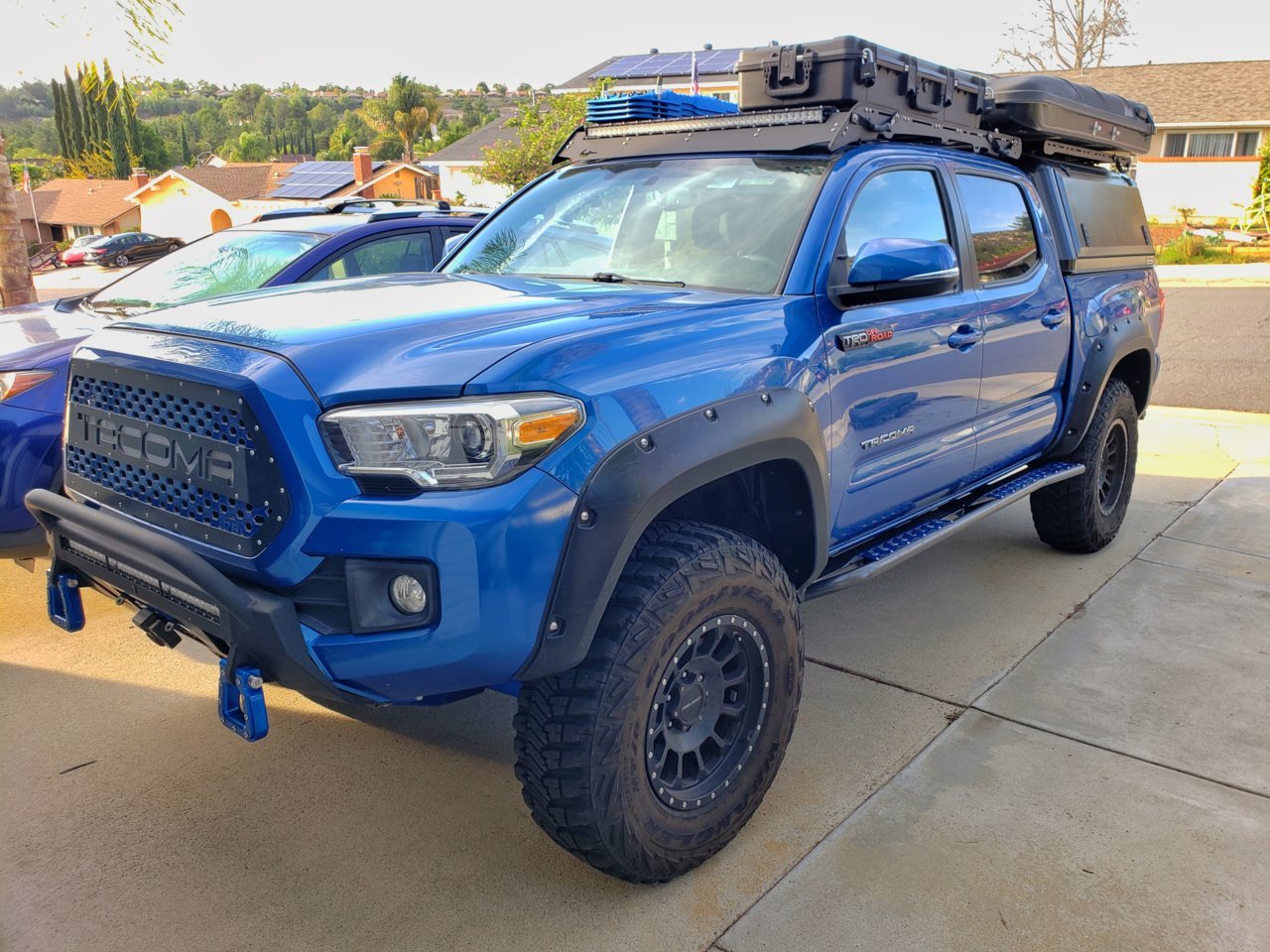

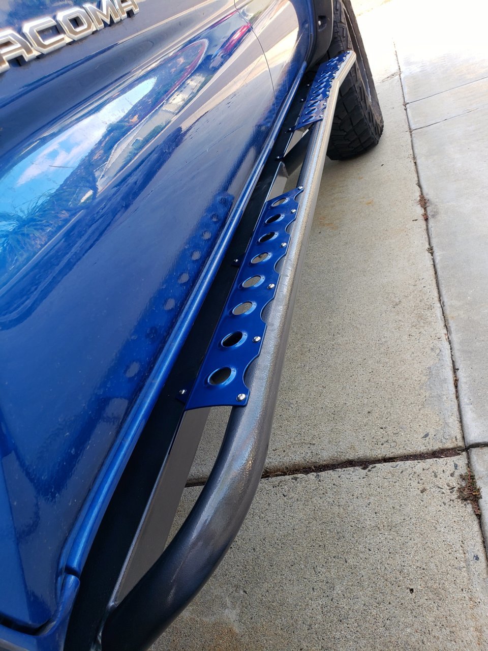

    Once these Sliders are installed, are the Step Plates easy to remove and fasten back to the Sliders? Seems like the Screws along the 2x3 would be difficult or require the help of someone with small hands.

    It was a pain to do, but it's accomplished now. Those inner screws took a lot of time.

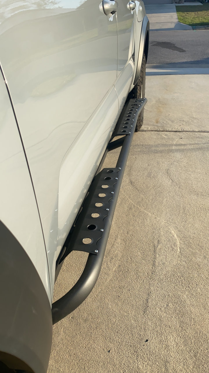

    Finished wet sanding, polishing and installing the Step Plates for my C4 Sliders.

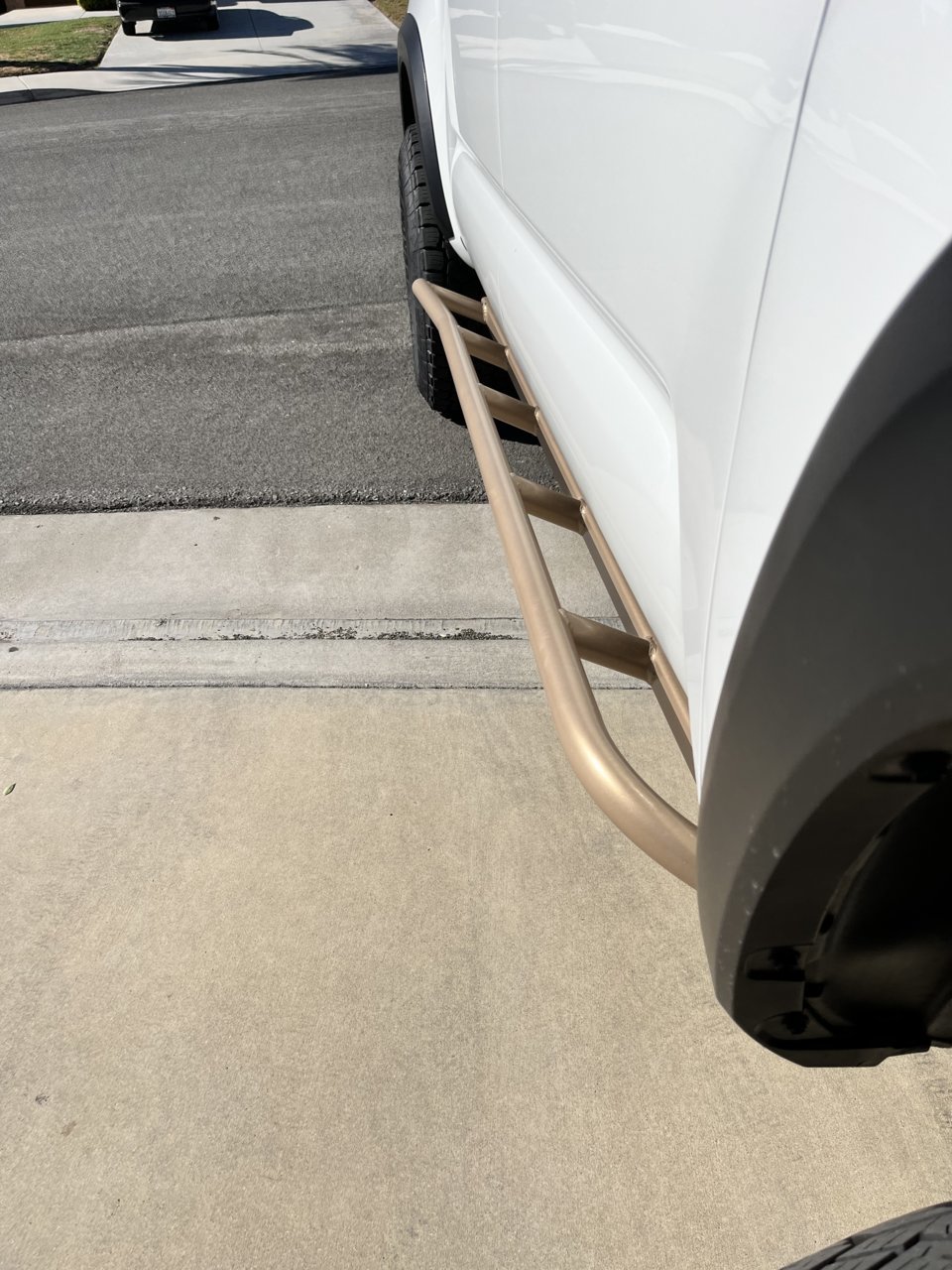

    D50B7D39-0166-4BD4-81B9-706E4911D773.jpg My c4 sliders!
