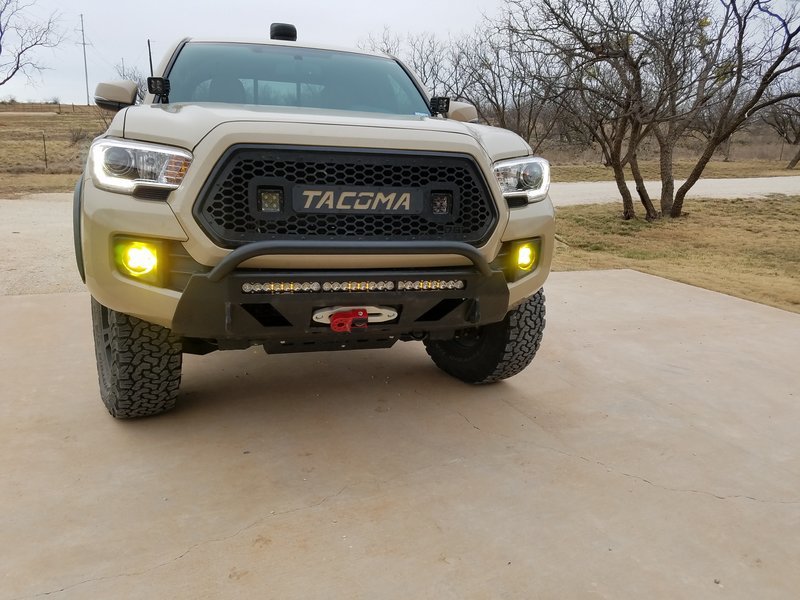

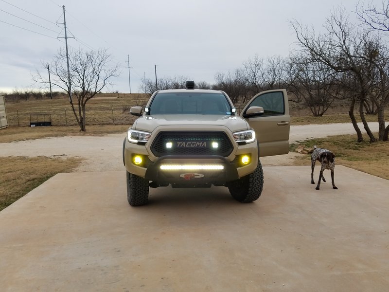

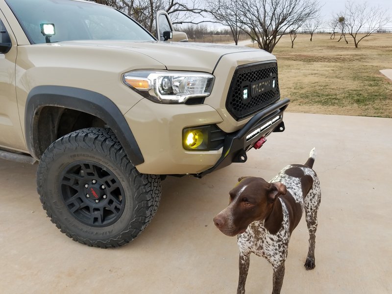

    Thanks for posting up pictures, the bumper looks awesome!

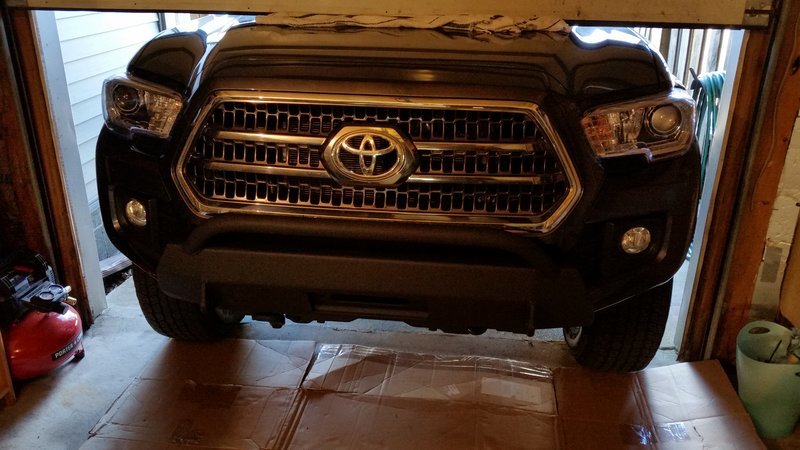

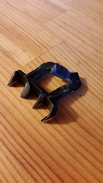

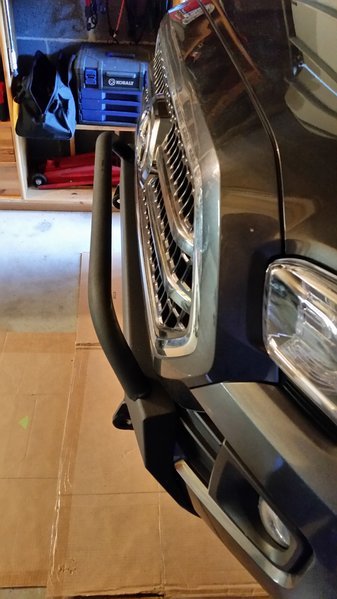

    Got it powder coated and installed. Took me about 4 hours to install. Really easy. The only thing I had trouble with was the fender clips. I snapped them off on the drivers side... They didn't just pop loose by pulling, I had to get behind the ones on the passengers side and work them loose carefully.
    And here is the snapped off clip from the fender. If you don't want yours to look like this, don't just pull the fender flares out, get behind them and work them out from the back side.

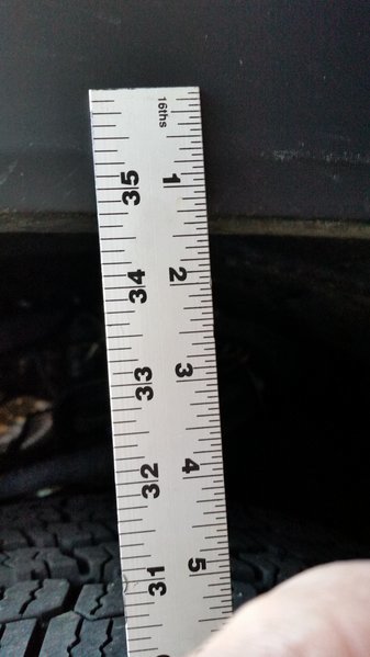

    I didn't lose hardly any clearance. I measured from the ground to the fender prior to install and it was at 35". After install it was at 34 3/4" so I only lost 1/4".
    I like it way better than the stock bumper. And it is very sturdy. I cut about 1/4" less off the bumper when cutting out the shapes and tucked the excess in behind the bumper. So no need for door trim, it looks really clean that way.

    Looks awesome! Thanks for posting up pics and a review!

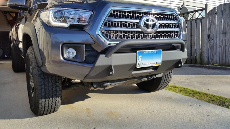

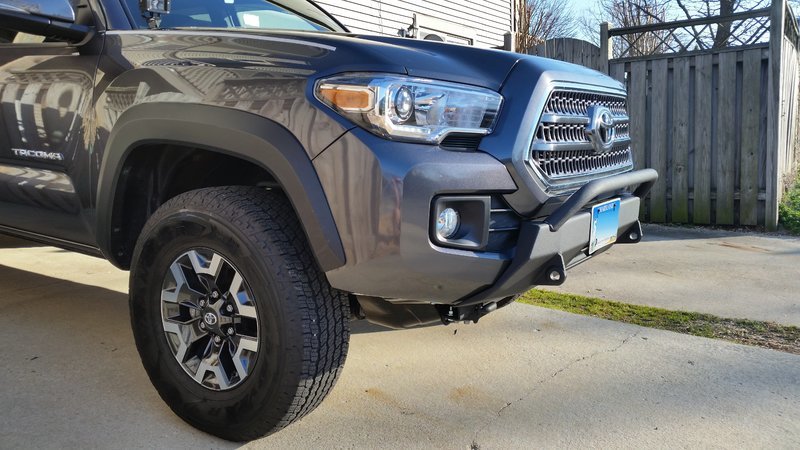

    Here's some better pictures. I think it looks good as matte black textured powdercoat on the metallic grey truck.
    Got the plates on with zip-ties right now. I'll figure out a better method of mounting them later. Probably when I get the winch.

    Those pictures look great, I like the color for sure!
