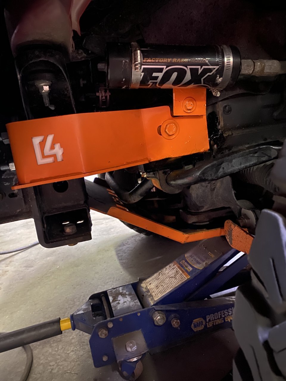

    Just a heads up I finally mounted my c4 brackets and I have the fox resi as well. I did a little cutting to the brackets and they will fit. These are mounted to a sso bumper. Changed the studs as the bumper is thick.

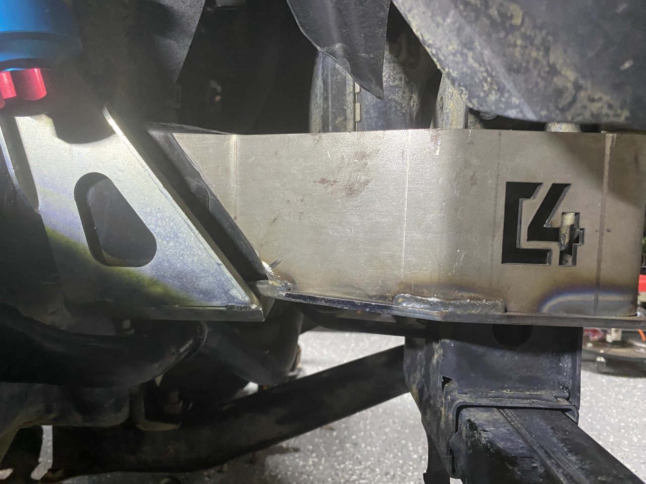

    My hope is to install the C4 low pro this weekend and will be attempting to modify these brackets to fit with the Kings resi set up. My plan is to make a diagonal cut to the vertical section which would follow/ butt up to the Kings resi mount. I would be losing the large horizontal bolt that goes through the frame but retain the 2 bolts that tie into the sway bar mount. I'm ok with losing the horizontal frame tie in bolt as it can not be made too tight or it will start to deform the frame. However, I do believe when it comes to winching/ pulling the more tie-ins you have the better. This seems to be the best option for me with what I have installed.
    I will be trying my best to film the fab work and install of the brackets for my channel and plaining on separating that from the bumper install as its a decent amount of work to get the brackets to fit just right.

    Got them ready tonight.

    Here is the process I went through to make the bumper support brackets work with the Kings Reservoir mounts. It took a decent amount of work.

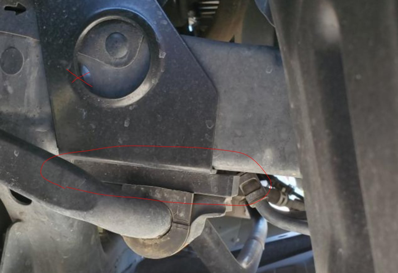

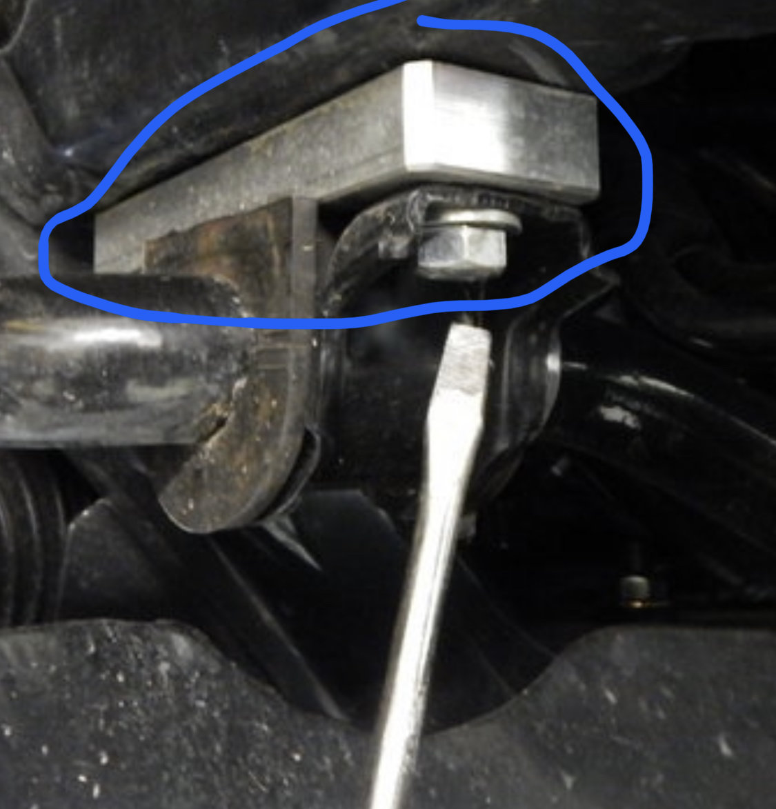

    My question is, do I remove that metal piece circled and put the bracket then put the metal piece back, or do I leave the metal piece and put the bracket over it? Thanks.

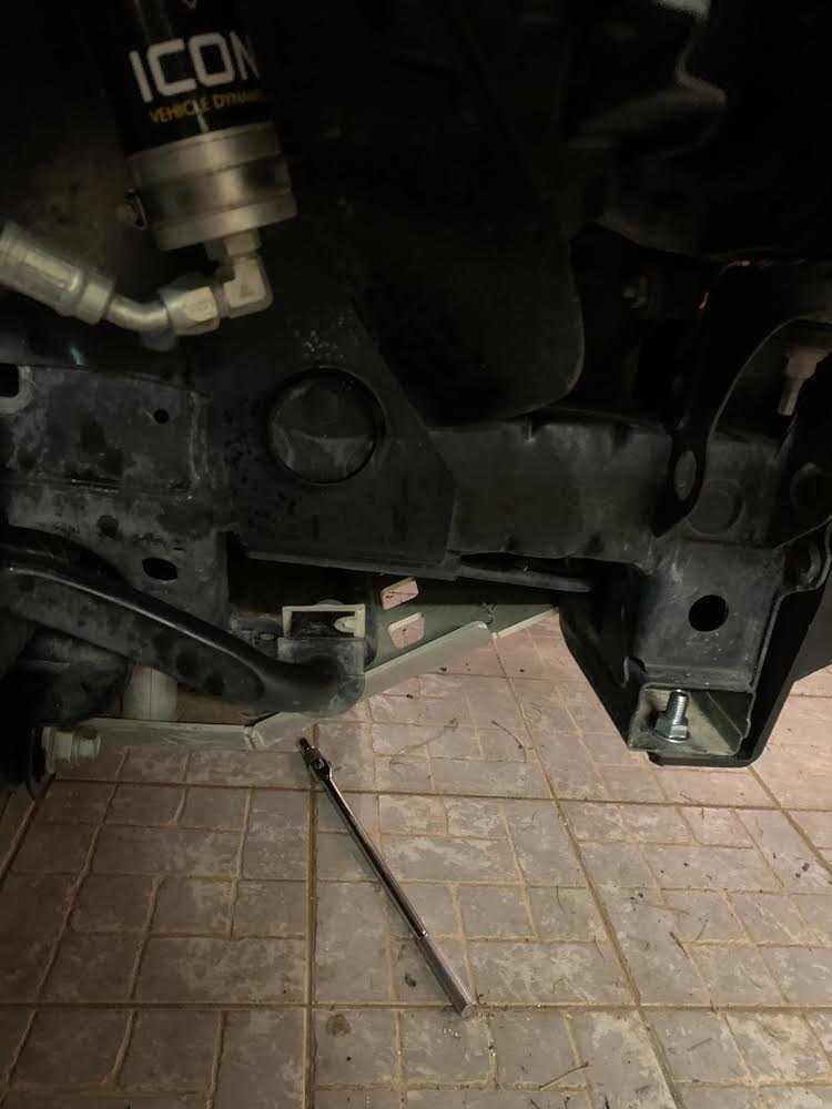

    Anyone have success with mounting these brackets with their resi mounts?

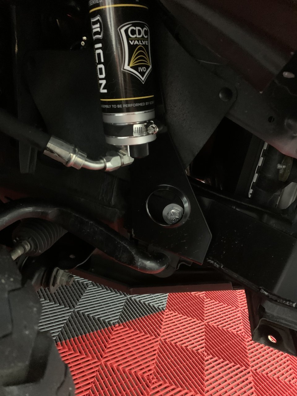

    For Icon users, chatted with C4
    "icon resi mounts will work, you need to mount them (frame support bracket) on the outside of the resi support bracket. You will have to drill a 1/2" hole through the resi bracket for the 1/2" bolt to go through that and the frame".
    X is where you'll drill the hole out. Another thing you'll also have to think about are the bolts that mount the sway bar brackets and for those that icons sway bar relocation brackets. You might need longer bolts to compensate for the added thickness of the frame support brackets. Then you would bolt back up the sway bar brackets. I have not tried this yet as I only install the lo pro winch bumper the the other but do plan to mount up the frame support brackets.

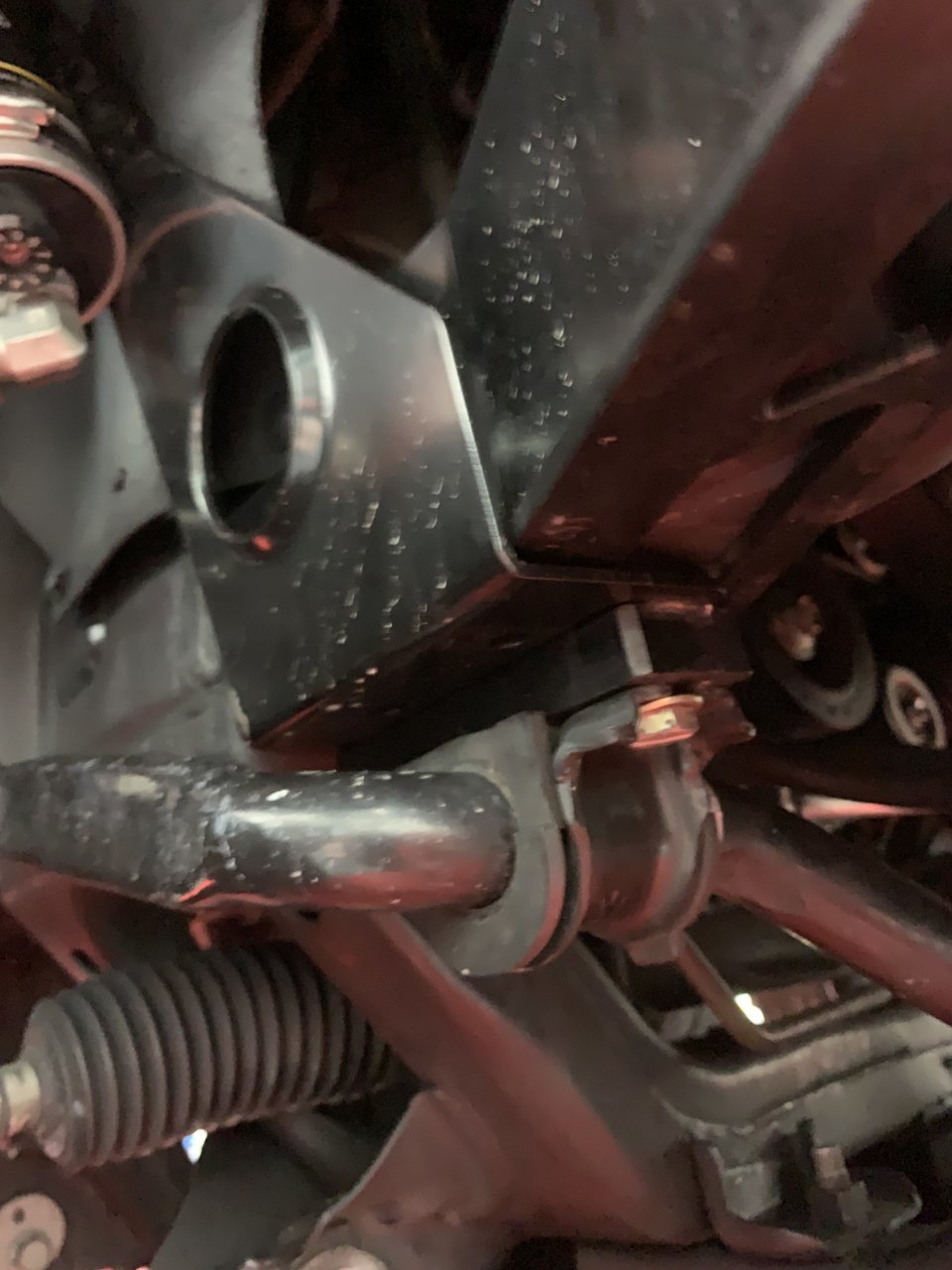

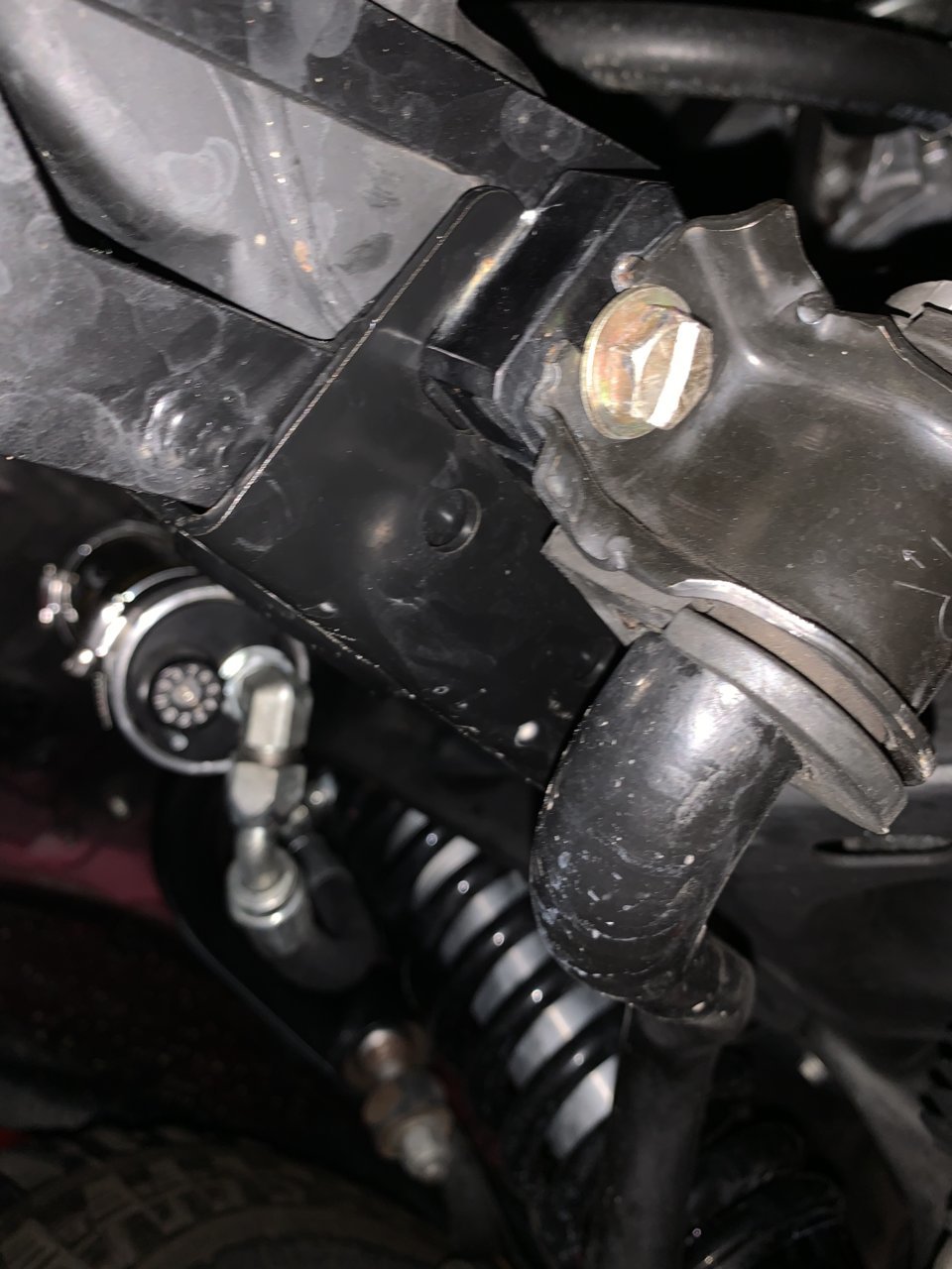

    When i get home tonight i will try to take some photos. I had a shop install my resi mounts and he had to modify the mount to fit my bumper.

  14. May 27, 2021 at 1:56 PM
    #34
    Goose8651
    Goose8651 Well-Known Member
    Mar 16, 2013
    #99870
    1,048
    DFW
    2013 Double Cab
    So i just looked at mine and I don't have any holes as you referenced. Mine are bolted through where the sway bar bracket is located. I tried moving the brackets around and they are solid, not moving at all where they are located.
    let me know if you would like any other photos and I can try to help out

  15. May 27, 2021 at 2:13 PM
    #35
    _gray_knight_
    _gray_knight_ Well-Known Member
    Aug 10, 2010
    #41508
    1,705
    SoCal
    '18 Mall Crawler
    Just washed
    I see you have the resi brackets on the outside and fit as is without issue. The frame support brackets, you have that 1/2" bolt through the frame as mentioned in the original post installed?

  17. May 27, 2021 at 7:02 PM
    #37
    Goose8651
    Mar 16, 2013
    #99870
    1,048
    DFW
    2013 Double Cab
    Yes, I do have that. Looking at the original album photos. The mounts on mine look to have been bent to add some additional clearance for that bolt. My bracket is not sitting flush to the frame. I have a slight gap between the two.
    Did not notice any difference.
    _gray_knight_[QUOTED] likes this.
