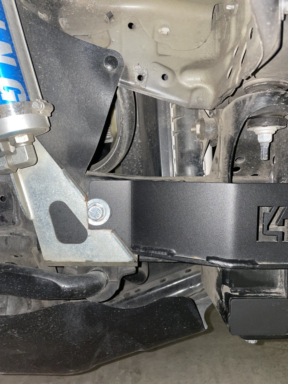

    image.jpg Late reply but it seems no one got their picture as requested for mounting these with King Resi mounts. Here’s a picture of how I got them mounted which does not require any altering of the C4 brackets but does require cutting of the resi mount. Personally I’d rather sacrifice the support of the resi mount vs the bracket as it’s intended to be abused and altering it would affect said use.

    Did you have modify the BAMF bracket to get it to fit the C4 bumper?
